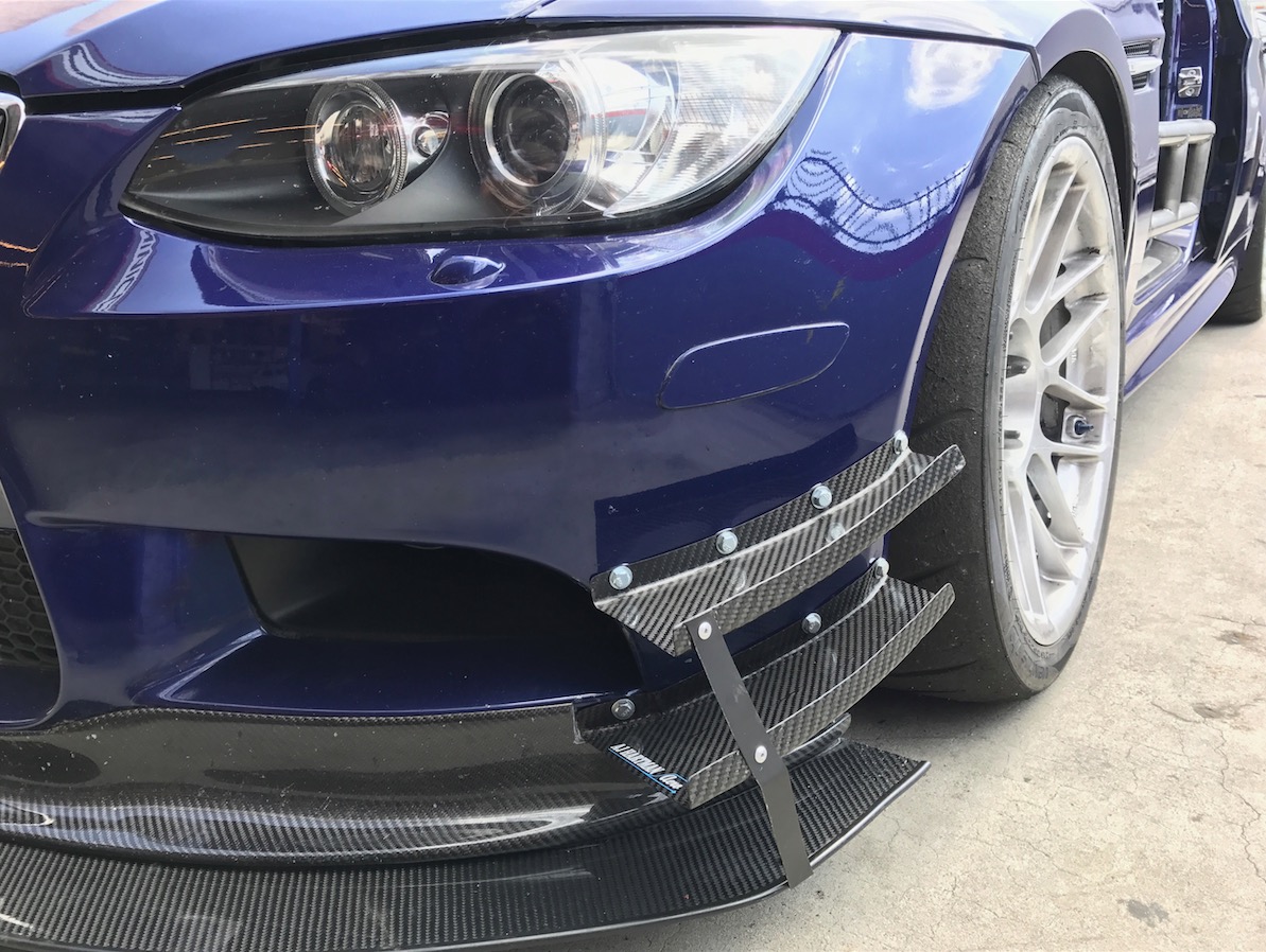

One minor update to note: After the initial install of the canards, it seemed that they were extremely flexible. It took no effort at all to move them up and down. So, I asked Racewerkz to figure out how to make them more rigid. This is the result and I'm quite happy with the canard setup now. This brace that they made out of Inconel makes the canards VERY stiff.
To be honest, I don't really feel the canards up there. I drove them like this at Buttonwillow last week. But I will say, the front of the car is feeling pretty good---nice and grippy overall at the moment. I will get another crack at it in a couple weeks at Chuckwalla. I may even experiment with putting more Angle of Attack on the rear wing.

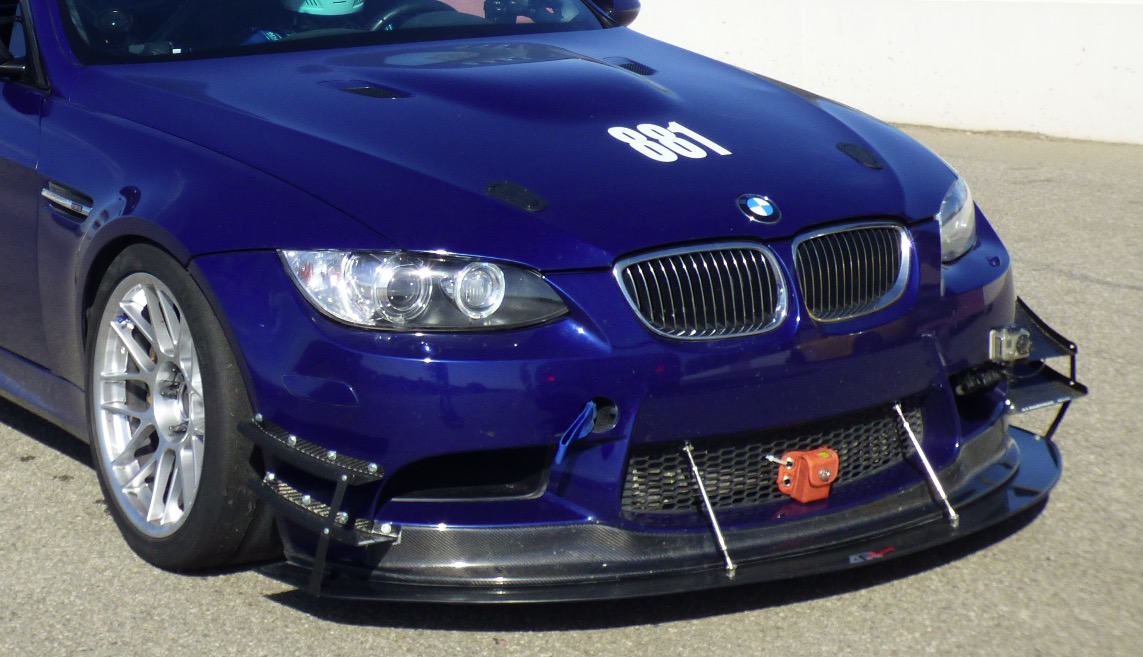

What kind of splitter is that? Looks like you added some kind of extension to the regular splitter. Can you clarify how is it done?
I have a front splitter now but its not really functional.
looks like yours but without extension.
The first item below the bumper is a carbon lip. It's a generic brand piece I found on the forum. The lip is there for two reasons:
-fill in the bottom of the bumper
-provide a flat bottom for the Splitter to attach to.
The thin flat carbon piece that sticks out on the bottom is an APR splitter. It's attached to both the carbon lip and the bottom side of the car. The splitter is also stabilized by the metal arms that come from the bumper. They prevent the splitter from deflecting under high wind loads. The setup is QUITE effective. I drove the car with the wing, but without the front lip/splitter combo. The car would understeer like crazy on high speed rounders. Now the car feels very very stable on high speed rounders. The canards are mostly flavor, but I am starting to believe that at high speeds, they have a small positive effect, which honestly was all I was hoping for. Let me tell you, any small positive effect at the limit is welcome!
APR makes two kinds of splitters:
-the one I got which is fairly reasonably priced. It's ability to resist flex is only moderate at best. The stabilizing arms are very necessary.
-a honeycomb splitter. That thing is quite expensive. But you could stand on it once installed without issue. Very stiff.
I've seen homemade plywood splitters that are super stiff. Cheap and stiff. Good combo for what many consider to be a consumable piece if you go off hard enough. I've been lucky with my splitter so far. I've been off half a dozen times and it's been fine.
Here's another angle on the front to help show my setup:

Thanks Dogbone. Here it is:
http://moddiction.com/apr-performanc...i-1797863.aspx
APR front wind splitter/undertray
I was going to buy gt4 splitter that is functional but expensive.
This is great as its relatively cheap, comes with supportive rods and also as an undertray allows for smoother air flow below the front bumper.

Regarding the canards, I was scrounging around through my AIM data from the Speed District Buttonwillow day on 9/23. It turns out I rolled through the apex of Riverside on one lap at 101.7mph. That's 1.4mph faster than I've ever gone through that section. And it was 80ºF and I was on 12th heat cycle R1S. And I never remember feeling like I was over pushing the car---meaning it wasn't massively understeering away from me. Previously, it took all the courage I had to get through that apex at 100.3mph.
So, I have to update my initial thoughts on the canards and say, I think on high speed rounders, the canards are doing something positive.

Yup that's the one. I am very happy with my APR splitter. It transformed the front end of the car.

dogbone, how did you attach those support rods on the bumper side?
Looks like bumper cover needs to be removed for this job...
"Racing is life. Anything before or after is just waiting." Steve MCQueen
I decided that the two canards on the side of the bumper were too flexible. I didn't think they would hold up properly under 140mph winds. I wanted them to be stiffer. So the race shop created those metal support straps to make the canards very solid. It works very well. The canards are very solid now.
As far as how----they look riveted in.

Not on the side. Metal rods that support the APR splitter I am talking about How are they attached on the bumper side?
To be honest, I didn't see the connecting hardware before it was installed. Racewerkz Engineering has done all the aero work on the car. Perhaps they can answer your questions.
