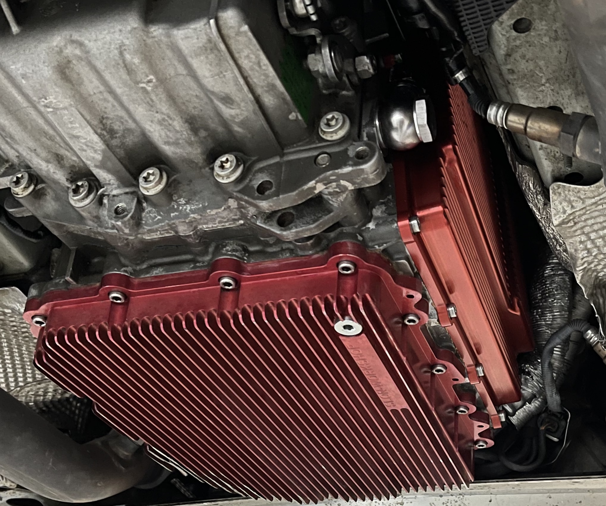

Last minute, I added one more job today—-I’ve had the Slon Workshop CNC aluminum DCT side pan sitting here for a long time waiting for install. We’re putting that in on this round as well. It may necessitate partially dropping the transmission……there’s just no good time to do it because I don’t have any future plans to pull the transmission, so…..I guess we just do it now.
I also received the silicone filler strip to seal the gap at the top of the radiator. I squeezed that in there. Looks real nice! Thanks again for the heads up on that material!

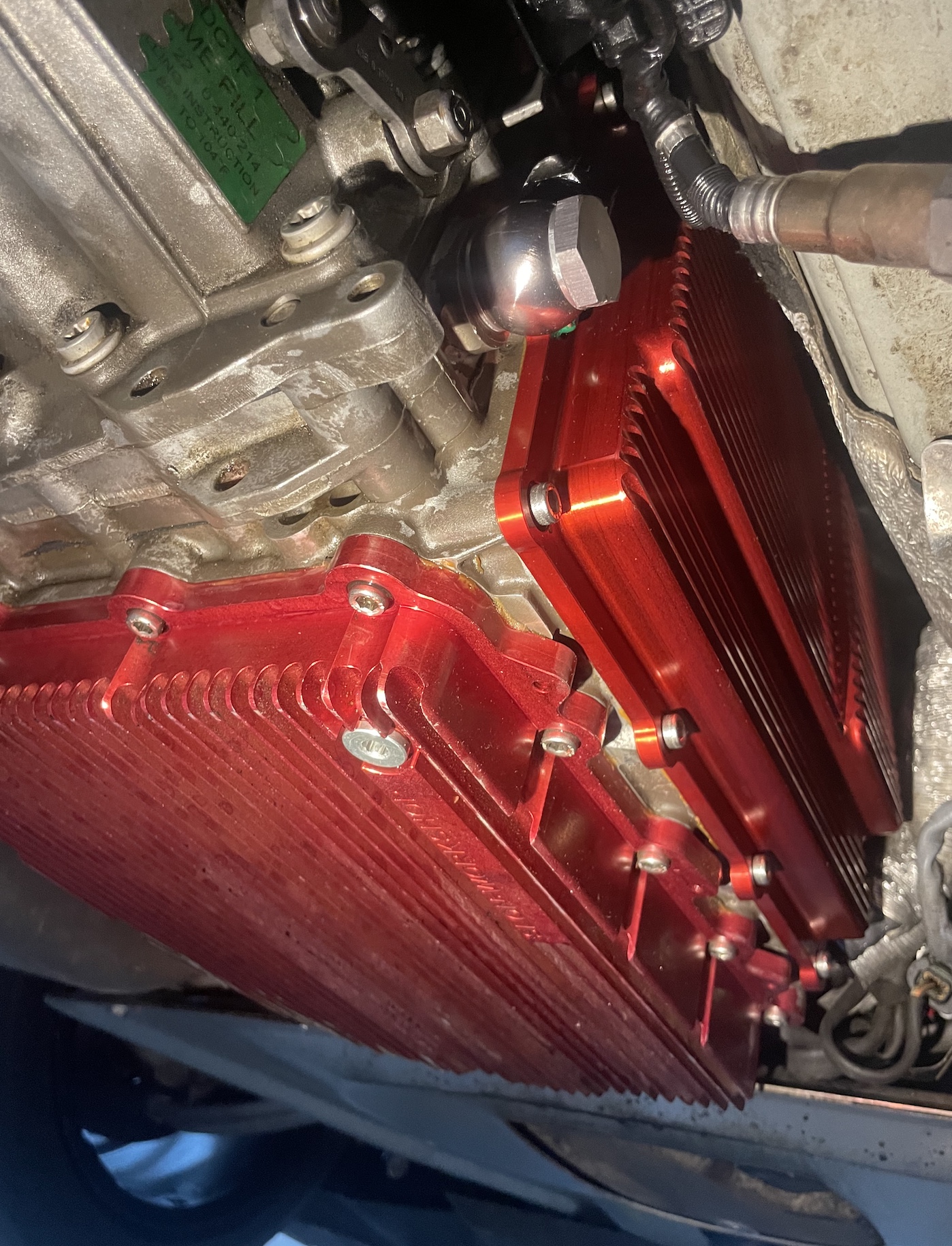

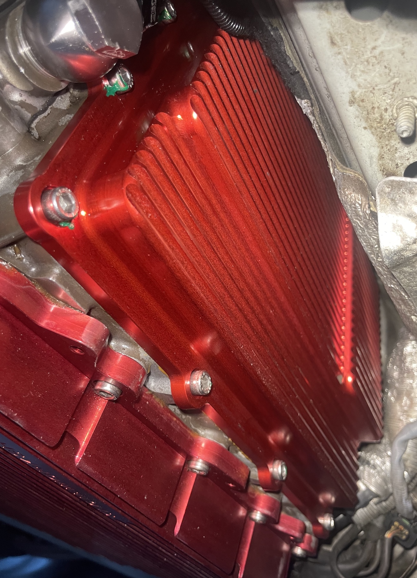

Got the car back today. The throttle actuators and the Slon DCT side pan installs were a success.
The Slon side pan install was a last minute decision, but I'm glad it's on there. It is an involved install because you need to partially drop the transmission. There's just not a lot of room in there to put that thing on the side of the transmission, especially considering you're working with a goopy gasket maker liquid. Thanks to the Honest Assembly guys for getting everything done.
Looks very colorful on the transmission now!
Anyway, I'm glad to be rid of the leaky BMW rubber gaskets on the trans pans. Man, those leaked a lot.
