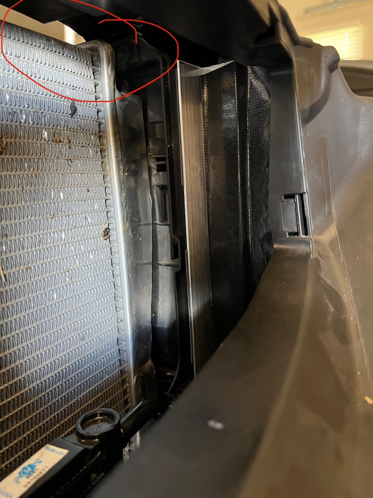

This week, I decided to dig in and see if I could close off some of the escape paths for the air before it gets to the main radiator. I'm no expert on this topic, but here's how fsmtnbiker and Ryan from Zebulon explained it to me: Air will take the path of least resistance, and that path is NOT through the cooling fins of the radiator. You need to force the air through there by giving it no other choice but to go through there, which means closing off all the gaps between the nose of the car and the face of the radiator.
So, I sat down on Thursday and stared at it for awhile, and there are a number of ways air can escape before ever getting to the radiator. So, I slowly started figuring out how to close the gaps on-by-one. I used aluminum 1x1" edging and taped it in there. I used plexiglass to cover the two gaping holes above the kidneys. After awhile, I thought I was done. But then I got on the phone with DRLane and he was mentioning that that there's a gap at the top of the radiator. But that's obviously a high temperature zone so you can't just stick anything on the top of the radiator. He had ordered some high temp silicone rubber material from ebay that he jammed on top of the radiator in the gap. He had some left over and offered it to me. So, I jumped in the car like any good junkie would do and ran up to his house in rush hour traffic over an hour away. (I was in a hurry to do all this on Thursday because HPR had an open lapping day on Friday.)
The piece he had leftover wasn't the proper thickness to really jam tightly in the gap above the radiator, so I folded it in half and wrapped it in HVAC tape to make it thicker. It jammed in there pretty good.
Friday, I went to HPR to see if my efforts had any effect on the massive overheating I've been experiencing since I got the car back. I mean in 90ºF air temps, I could barely get one lap. It's never been that bad before.
I'm happy to say that it worked! It is noticeably better now. I can get more laps in.
Interestingly, the piece that was jammed in at the top of the radiator was being pushed back while on track. I was talking to fsmtnbiker about it today, and he was saying that for that piece to push back was an indicator that there was good positive pressure building in front of the radiator, which is good for air flow through it. (I'm going to have to order the proper thickness for the high temp silicone stuff, but the vendor DRLane used isn't taking orders at the moment. They're on vacation.......hahaha)
Anyway, I left the track today satisfied that this initial effort of this project has been a success. There are more places at the bottom to close off, but I may have a shop look at that later. I'm not sure closing off the bottom is going to be as easy. We'll see.

I have 3 days at WGI coming up and the esses overheat my car every time

Here's the Silicone rubber I used, 20mm x 30mm 1 meter strip. You'll need to find an alternative given the seller is unavailable until Sep 25 and it takes 3-4 weeks to get this from China.
Probably find something similar on Alibaba, just not sure about the MOQ.
Goes in the gap circled.
