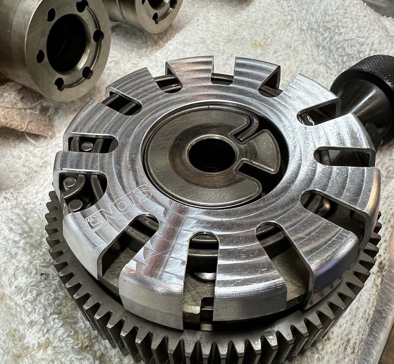

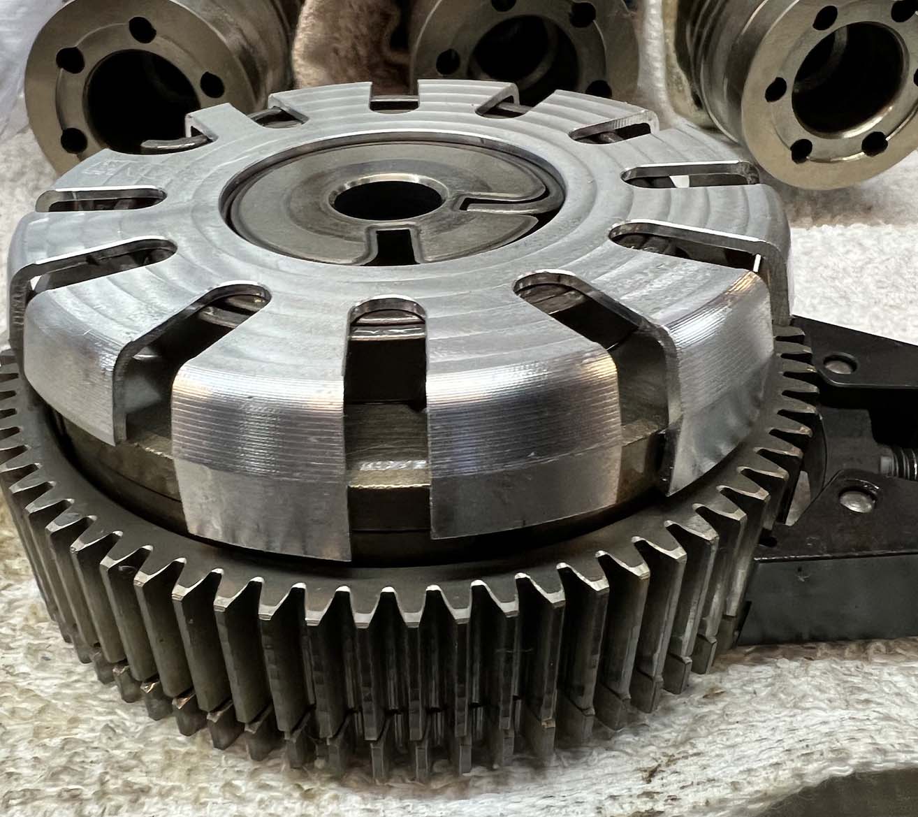

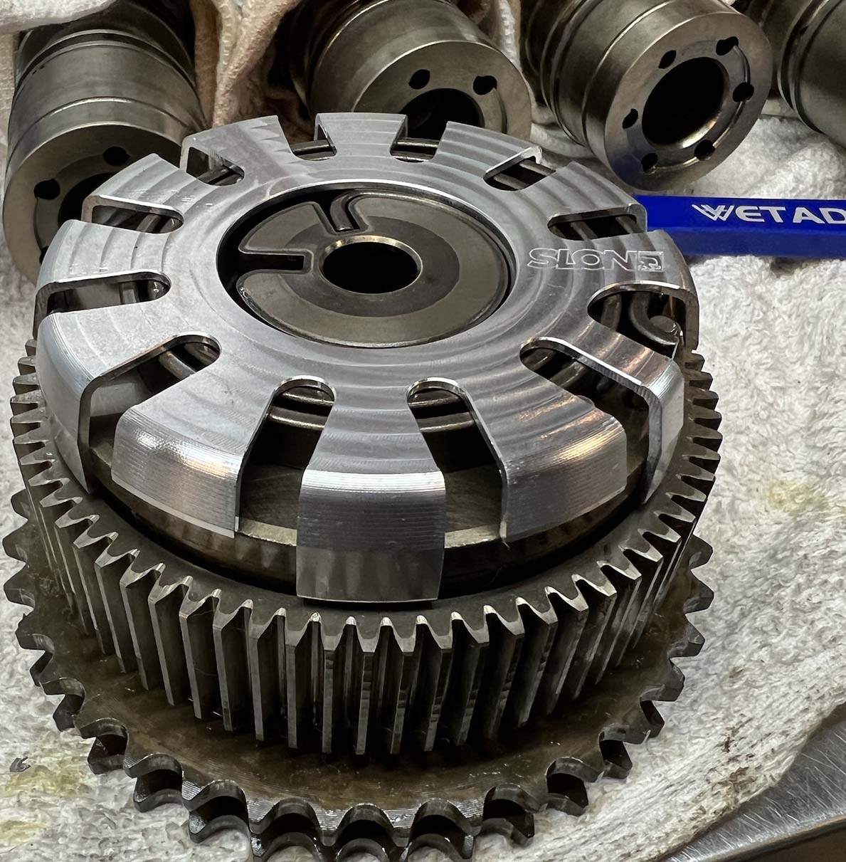

My original E90 motor is being put back together. The topic of Vanos covers came up and I had just seen that Slon Workshop made some interesting looking skeletal aluminum Vanos covers. Got a set of them and took them up to the shop today. They fit great! Clicked very nicely into place. The shop was impressed with them. So, I'm happy to get the 13 year-old plastic covers off.
Billet aluminum vanos covers = win!
These are also going into my engine next time valve covers come off
Shame we can't get them anymore with sanctions. They look great though.
Yes you can. Move Over Alex can get them to you directly.
I got you!

roastbeef has some ideas on lightening up that vanos cover.
[IMG]http://www.epicscore.com/online/Slon-Vanos-Cover-01.jpg[/IMG]
[IMG]http://www.epicscore.com/online/Slon-Vanos-Cover-02.jpg[/IMG]
[IMG]http://www.epicscore.com/online/Slon-Vanos-Cover-03.jpg[/IMG]
I looked at your original covers a couple weeks ago. That motor has been sitting in pieces for ages I will say the originals looked pretty stellar. No cracks or signs or stress which was cool to see.
I too have his covers as part of a complete valve cover replacement to install. Man, I have endless work to complete and only get a handful of hours each week. Maybe it's time to accept defeat and pay for labor. 😖

I agree mine looked fine. But they were 13 years old and we were re-assembling the engine and closing it up for who knows how long. Do they last 15,18, 20 years? Didn’t seem like an experiment worth doing. Just replace them and hopefully be done.

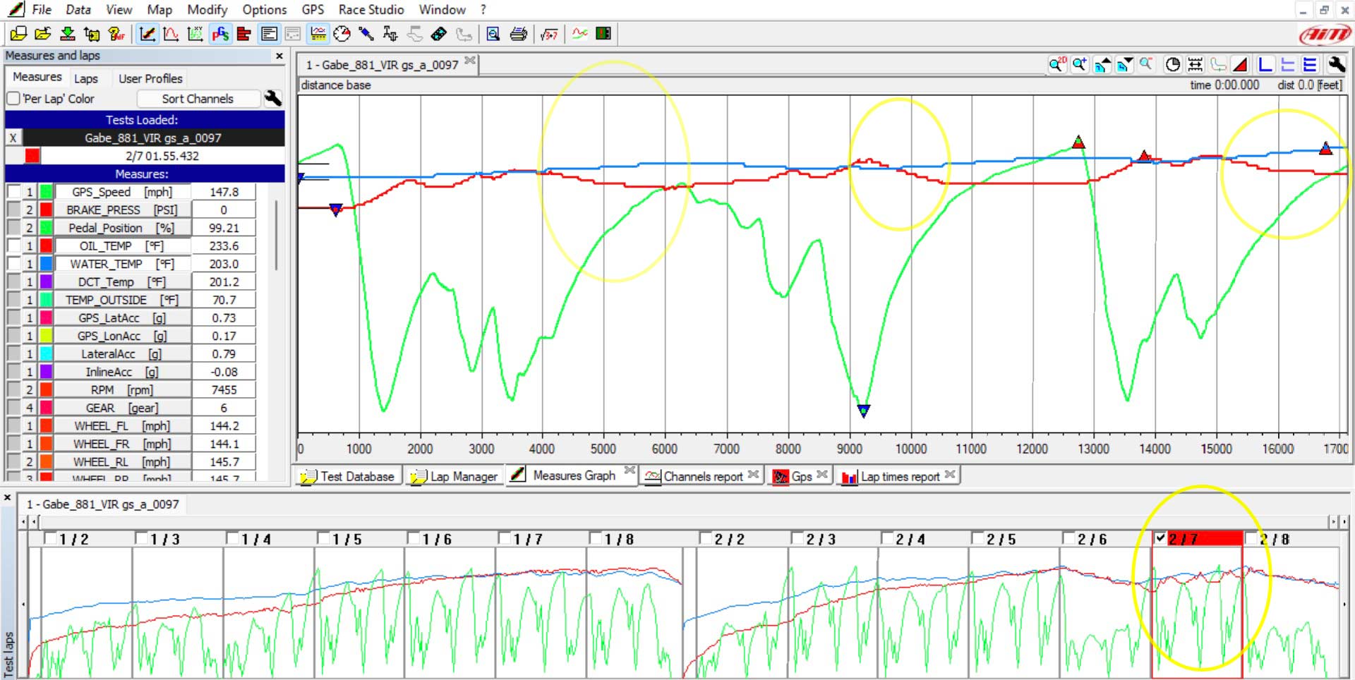

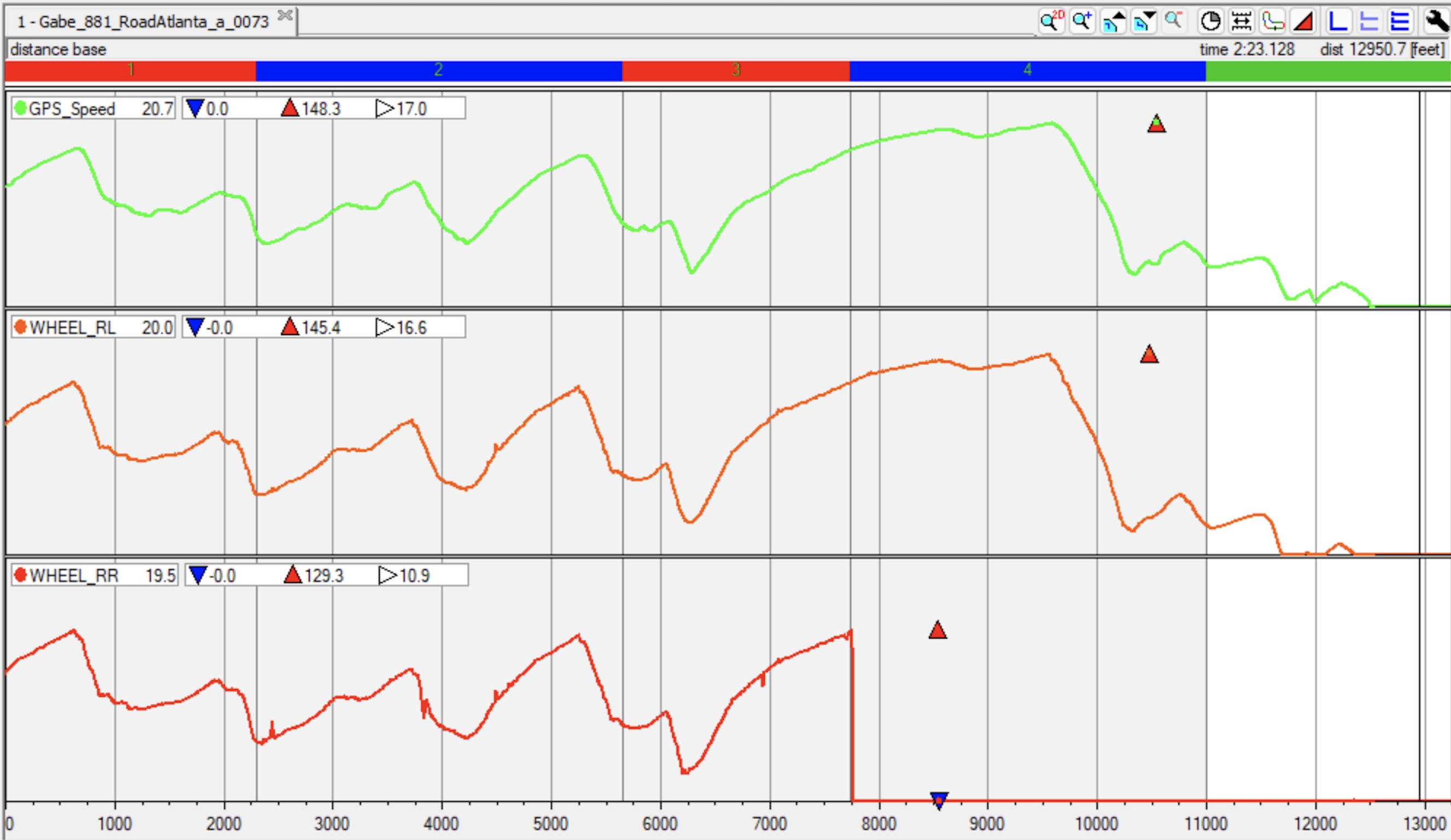

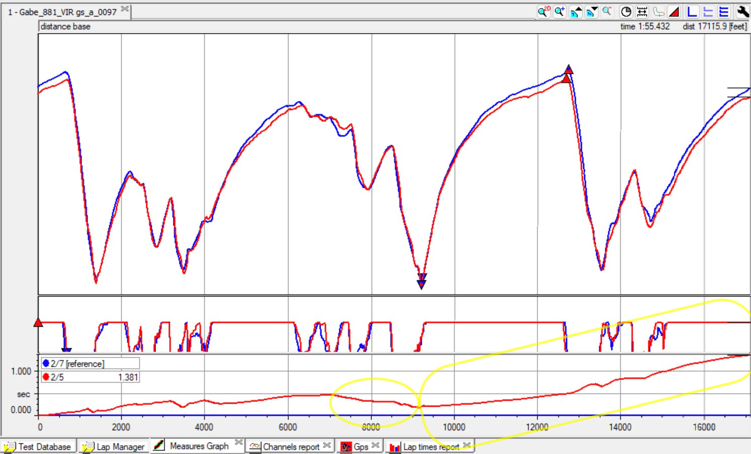

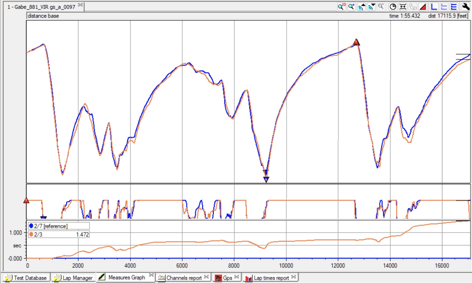

I think I've mentioned that I've been going through data from the East Coast trip. There's a few minor things that are worth sharing. I'll do it over separate posts.
First up: Road Atlanta, I had a wheel bearing go bad that allowed the rear hub to wiggle which caused an ABS warning on the dash. Turns out the AIM Solo was able to see exactly when the error happened as well.
I'll give you exactly one guess to tell me where it happened.
A bit down the back straight!!..Oh wait I wasn’t actually supposed to guess right?
haha yes!

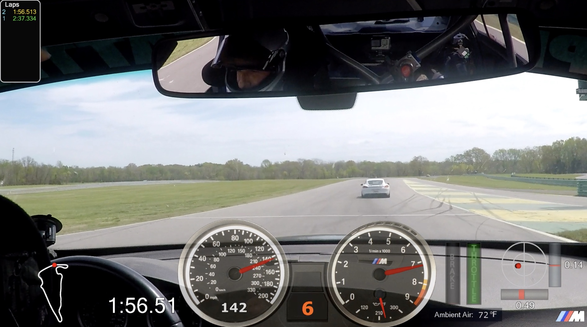

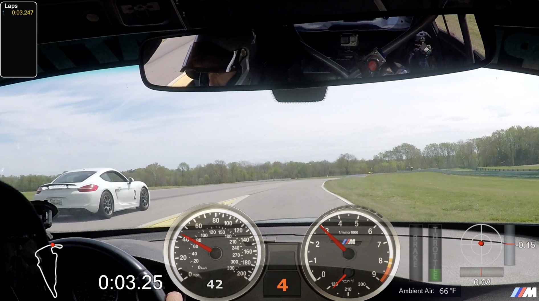

I noted on the first day at VIR that I caught a white Porsche at the end of my 1:57 PB hot lap and had to back off the throttle before the finish line. Well, on Day 2, on my first hot lap that was, at the time, a new PB of 1:56.9, I caught the same car again at the same spot----right before the finish line! How crazy is that? You catch the same car in the same place on a PB lap? Twice in 2 days? Crazy. On the second day, he was just a few feet further away which allowed me to stay full throttle.
I made a gif (my first gif!) that shows the difference between the two days.

I noted on the first day at VIR that I caught a white Porsche at the end of my 1:57 PB hot lap and had to back off the throttle before the finish line. Well, on Day 2, on my first hot lap that was, at the time, a new PB of 1:56.9.
Wow. Now that's wild. I wonder if the Cayman dude was watching and waiting for you somehow (or trying to pace you). Is the telemetry clock wrong? The video and .gif show 1.54s as opposed to the PB times mentioned of 1.57 and 1.56? Just wondering...

In response to your questions:
-Yes, timing in the videos is accurate. I'm not at the finish line yet. See the little triangle roof that's popping up over the trees? The finish line is right after that. So, I'm still a few seconds away. The two gif images are from the exact same place on the track and the two times are slightly different because I was slightly faster on Day2. I just picked that spot on track because it was easy to identify as the same spot, and that's where I let off the gas pedal on Day 1 when I was getting too close.
-As far as whether he was watching or pacing me---with a little math, we can approximate where the Porsche was on the track when I started my hot lap. Ironically, he blew past me right as I was coming onto the track. This is useful because the Start/Finish line was right there where he passed me. So in essence, we both crossed the Start/Finish Line at the same time-----I was in the pit lane coming onto the track, and he was on the front straight.
Here he is passing me as I'm coming out of pit lane.
And here's where the Start/Finish line is in relation to the pit lane exit.
So, this gives us an easy starting point---we both crossed the Start/Finish line around the same time when I came out on track, and then two laps later we both cross the Start/Finish line again at the same time.
My out lap was a 2:37 and my hot lap was a 1:56.9 (let's just say 1:57 for conversation purposes.) It also took him the same time (274 seconds) to complete those laps. Let's assume he was on hot laps both laps, that means his average lap time was 2:17. Since, I did a 2:37 and he did a 2:17, then he was around 20 seconds ahead of me on the track when I started my hot lap. When I look at my video to see where I am at 20 seconds into a lap at VIR, I'm approaching Turn 4. There's no way he could have seen me at the Start/Finish line if he was even in the middle of Turn 3.
So, all of that to say, I think it was just random. I first caught a glimpse of a car in front of me as I was rounding Turn 10 and he was going around Oak Tree, but I didn't know who it was. Once I turned onto the back straight, I was like----wait----didn't I just see this guy in the same place yesterday?! Talk about déja-vu!! hahahaha

Alright, so let's look at some data.
The first thing to look at is oil temps. The picture below presents a bit of data that I can't explain. For some reason on the 1:55 lap, the oil is being cooled on every major full throttle straight. The car never really does that. I mean, here and there, you can find the car cooling a bit on a straight, but it was so obvious on this lap, it stuck out like a sore thumb.
In the picture below, at the bottom is an overall history chart that shows parameters across a whole session. In that bottom chart, there are three parameters to look at: Oil (red), coolant (blue) and GPS Speed (fluorescent green). So, we can track these parameters across the entire session. The first session of the day shows laps 1/2 thru 1/8. The second session shows laps 2/2 thru 2/8.
As we look at the behavior of the oil throughout the whole first session, we basically see that it climbs the whole time except for one moment in lap 1/4 where it takes a brief dip. And I would call that normal behavior for the car. Temps seem to generally climb consistently throughout a session. And in the second session, we see the same thing thru lap 2/5. It climbs consistently from 2/2 thru 2/5. My 1:56.9 lap was lap 2/3. The 1:56.8 lap was lap 2/5. The 1:55 fast lap is 2/7. Lap 2/6 was the true cool down and we see temps go down. Then, on lap 2/7, the 3rd hot lap, I get going, annnnnd the oil cools down three separate times throughout out the lap when I'm accelerating! What the heck?! It didn't do that in the first two hot laps or pretty much anywhere else in my data from other tracks. Why is it doing it now? Can't explain it.
So, does it mean anything? Well all I can tell you is that on lap 2/7, the car was out-accelerating all the other laps. Let's take a look.
First we'll compare the 1:55 fast lap (Blue) to the 1:56.9 1st hot lap (Orange). In theory, the car should accelerate best on the first hot lap. The blue lap at the very least matches the orange lap and in several cases is out-accelerating the Orange lap. What? Makes no sense.
The final turn onto the front straight was kind of a sad moment for the 1:56.9 lap. Took the corner slow and the acceleration wasn't any better than the blue lap. Maybe I was distracted by the white Porsche. Who knows.
Now let's look at the 1:56.8 2nd hot lap (Red) vs the 1:55 3rd hot lap (Blue). In the picture below, there are several things to look at. First we can see that on every major accelerating period, the Red lap is suffering compared to the Blue lap. However, I want to point to the yellow circle that highlights from 7000-9000ft in the time delta chart. In that 2000 ft, the Red lap gained 0.28 sec on my fast lap. ouch! I did that section better on the Red lap than at any other time. Anyway, by the time I was accelerating onto the back straight, the Red lap was only 0.2 sec slower than the 1:55.4 lap. Annnnnnnd then the back straight starts, and the Red lap just couldn't keep up. Looking at the yellow-highlighted section from 9000 ft (Oak Tree) to the end of the lap, the Red lap sadly just loses time consistently for the rest of the lap.
So, I don't know what was going on, but the engine and tires just had something good going on during that Blue lap. Wish it drove like that all the time! I guess what I'm taking away from this is that a true cool down lap can give you a shot at a good lap even late in a session. But I'm still walking away from this confused about how the car was able to cool the oil only on that lap......
