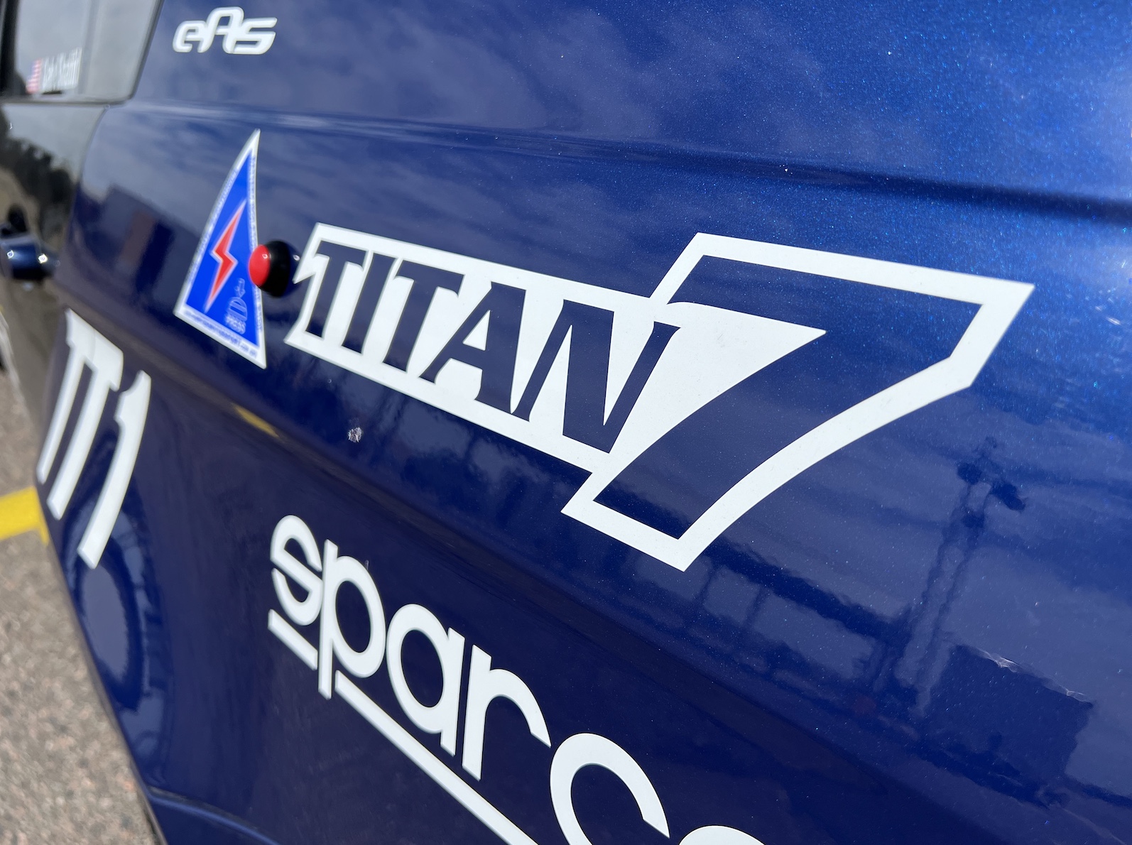

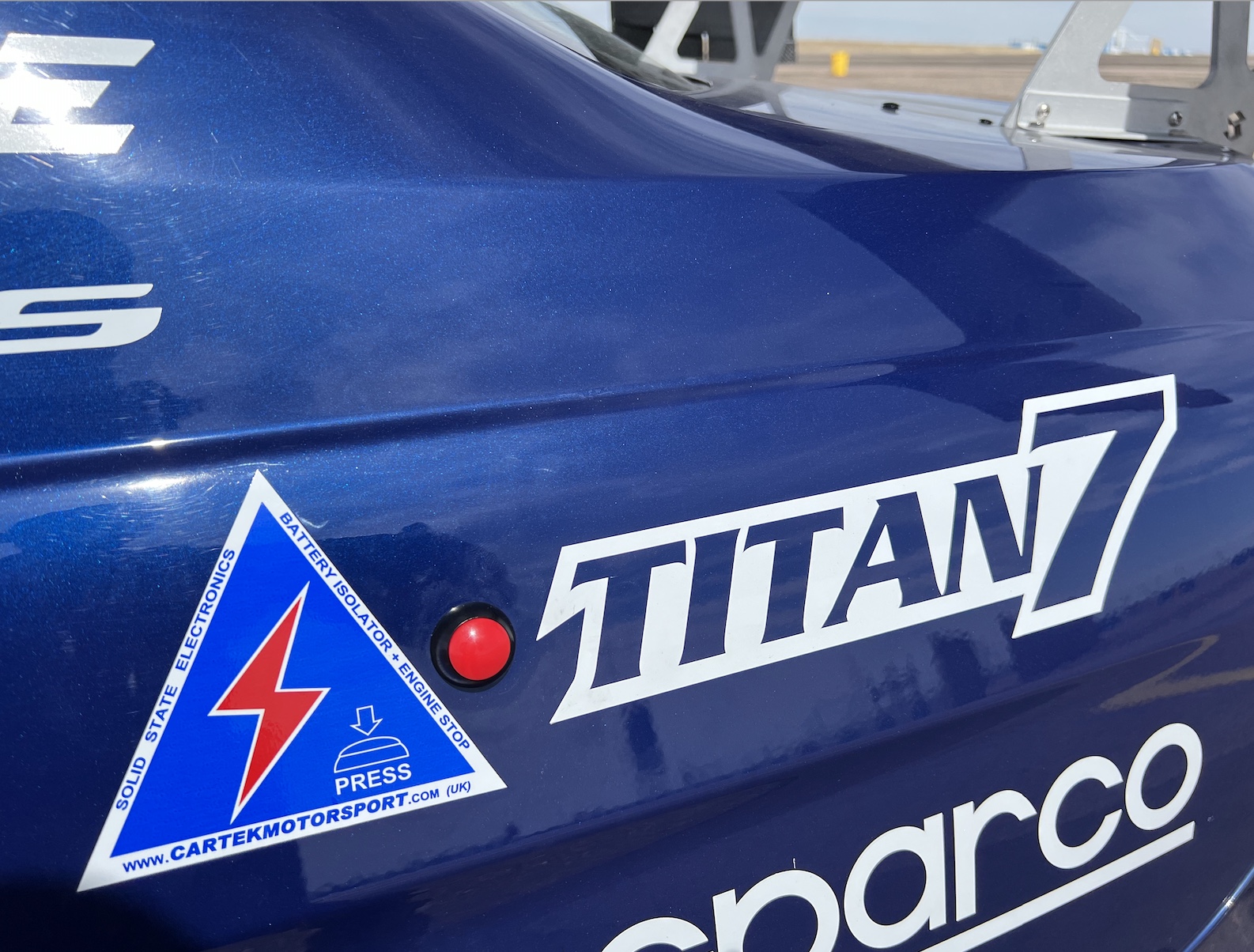

After a large round of maintenance, I went to High Plains Raceway to test the car on Monday.
What was done to the car:
-Vortech blower was completely rebuilt. Literally everything inside it replaced. All good.
-Blower belt replaced.
-Three lines in the DCT system were replaced. And the side cover replaced. All good.
-A line in the power steering system was replaced. All good.
-The power steering reservoir was replaced. All good.
-We tried to remedy the engine oil leaking from the filler cap......still leaking.....such an annoying issue.....I've had two shops look at it. I've bought a new cap....what the heck.....
-Replaced spark plugs.
-The kill switch is in. It's not just a battery kill switch----it's a full kill switch that cuts power to the spark plugs and fuel pump and cuts the negative/ground. It was quite the process to install it. In my second session, the car lost all power and the whole dash went black. After some investigation, I found that a crimp on a positive wire to the kill switch was bad and the cable was loose. Fixed the crimp and the car ran fine after that. So, now I have a power button on my dash and there's a kill button on the outside of the car on the rear quarter panel on the driver side.
Stock battery is still in the car, and I believe it will stay there for the East Coast trip. I just got word today that the new VoltPhreaks battery is on the way, but I don't think I have time to get it in the car.....I would want to test that anyway....
Looking forward to heading East on Saturday!
