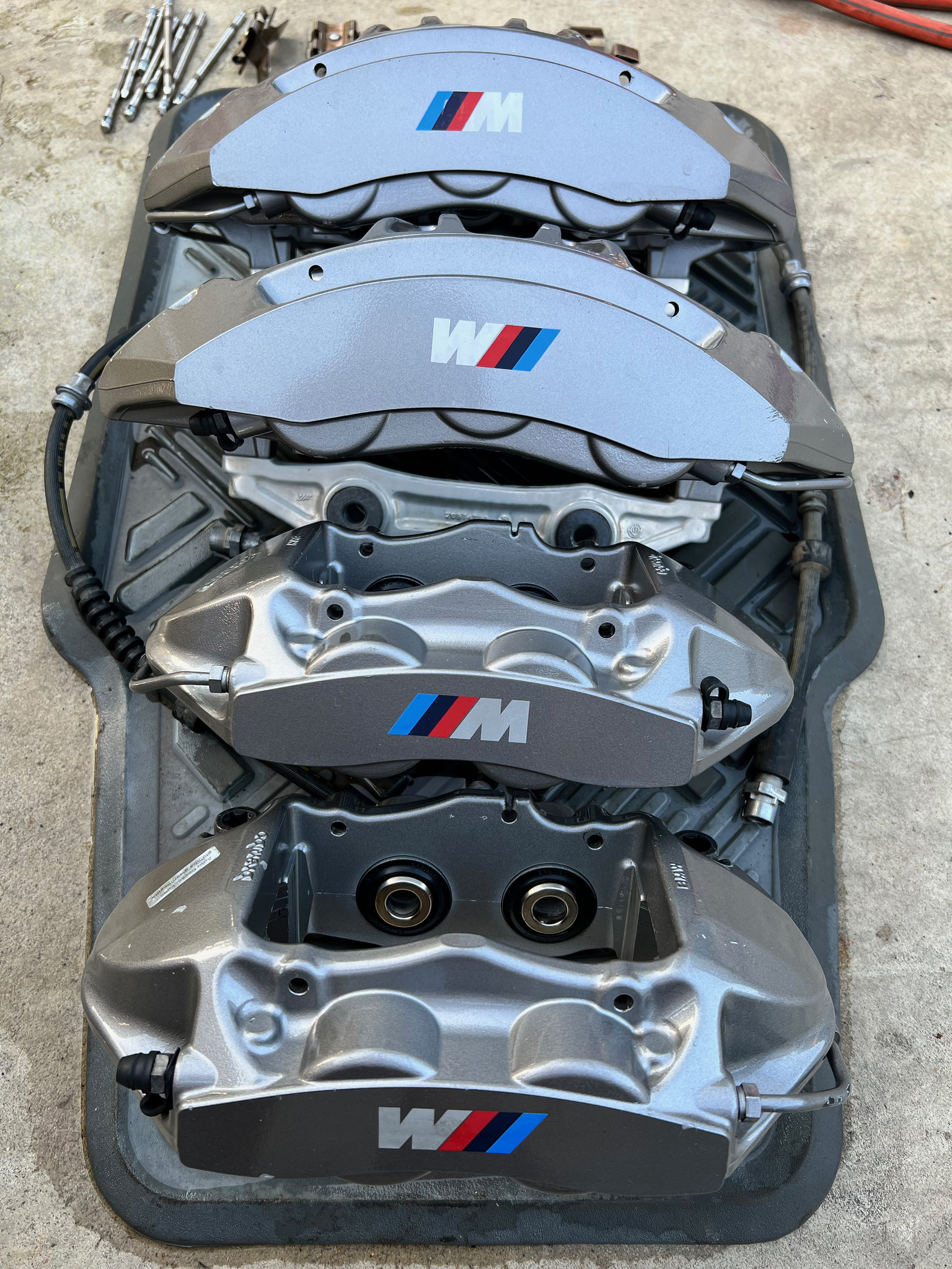

The brake calipers have just arrived.
The 400mm and 380mm discs will arrive tomorrow.
A front clamp adapter has also been ordered.
I want to replace the brake hoses with a braided cable. Will the standard M3 length be ok? Maybe they should be longer?

What are these?

What are these?
These are M2C calipers
They look perfect, 6 pot and 4 pot right? How to get these on the e92?
