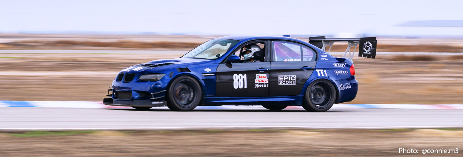

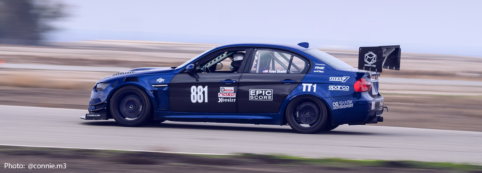

Wanna thank @connie.m3 (Instagram) for taking some cool photos this weekend at Buttonwillow. Check her Instagram out. She's got a super clean E46.
