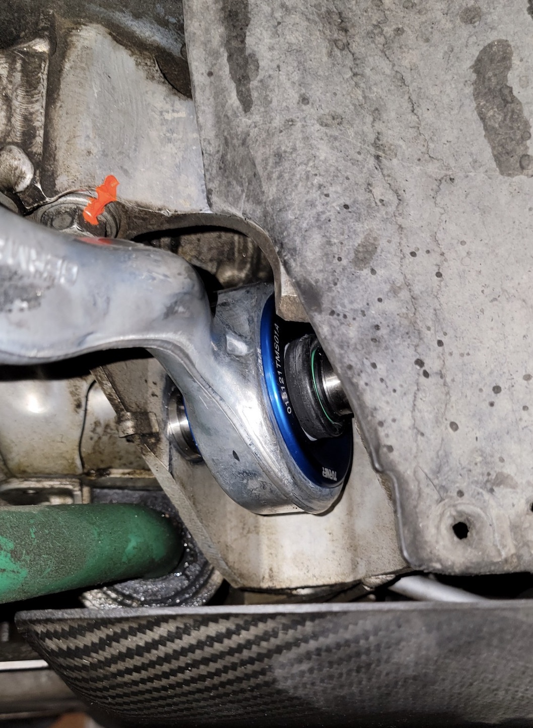

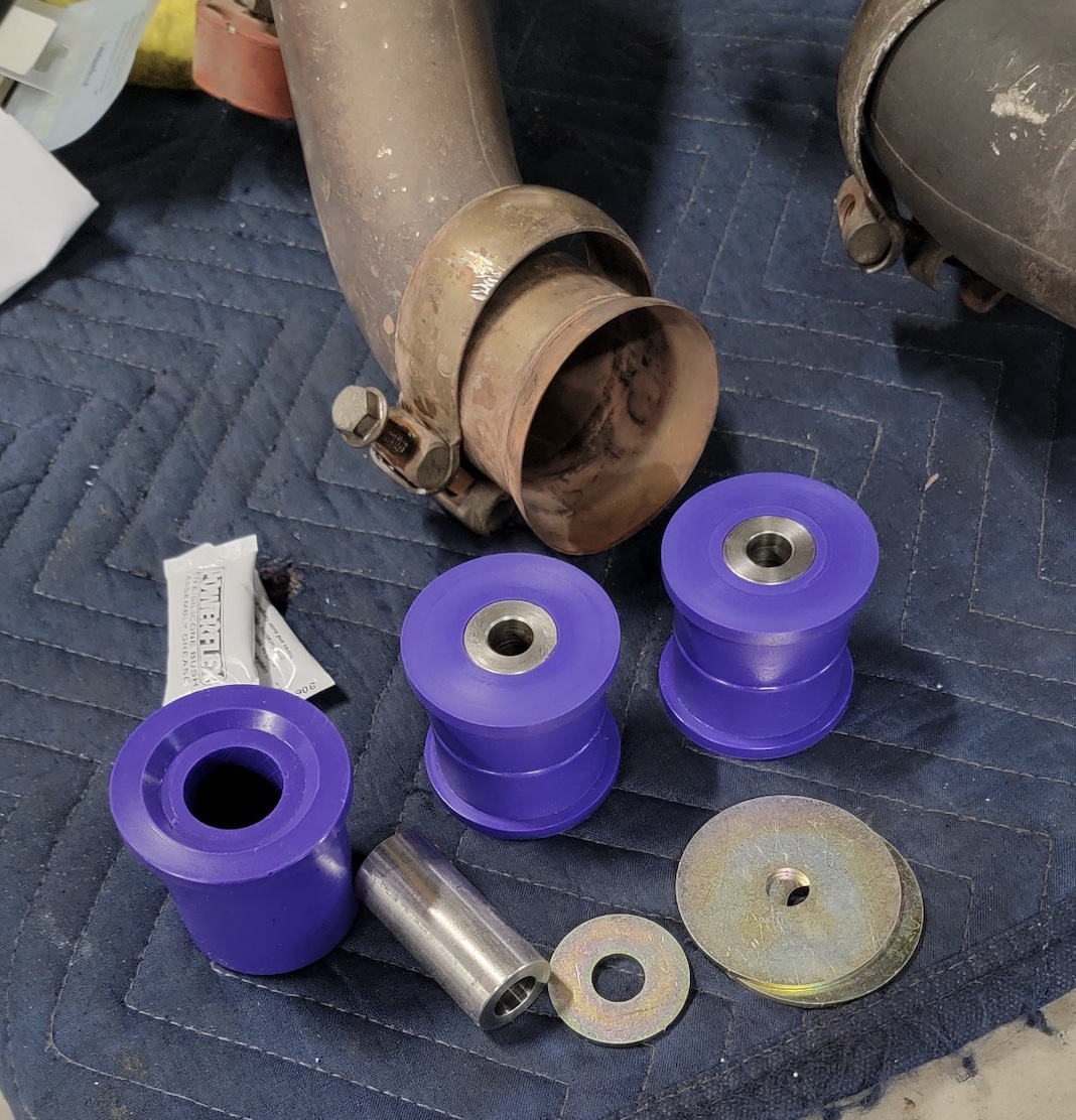

A few updates as we try to get the car sorted out:
-We received the new-to-me used transmission. EAS opened it up to inspect it. They said it was super clean on the inside. We decided to leave the stock clutch plates in it for the time being. EAS installed the trans and has run it around on the streets a bit. Seems fine so far.
- SYT_Shadow pointed me to remote coder SaNGRia who has an original unaltered GTS DCT file. My understanding over the years has been that there is a version of the GTS DCT file out there that has been detuned for street use. I did not want whatever that was. I think I have the detuned one in the E92, and I can tell you it doesn't chase the rev matching like the E90 does. So, that has been installed as well.
-In the interest of trying to stay ahead of problems, we have been eyeing control arms and bushings in the control arms. We have decided to replace most of the control arms with OEM replacement arms, and we swapped out the thrust arm bushing with a monoball Turner bushing. I had Powerflex in the tension arm previously. I'm not going with fancy aftermarket arms. And I'm still refusing to go full solid bushings in the rear of the car.
The Turner bushing:
-Diff bushings - Steve at EAS took a look at my OEM original diff bushings and said they were cracking. So, we're going with some PowerFlex diff bushings.
The diff bushings:
With all the control arms being messed with, I will go to Chewerks and get an alignment.
I have signed up for the SoCal Drivers Club Buttonwillow day on Dec 17 to test the car. Dec 18 is a Bimmer Challenge day with Speed Ventures. If the car works on the 17th, I'll most likely stay for the 18th as well.
In 2021, I've had quite a few track days where my car simply did not work (just ask fsmtnbiker who's had the great fortune of witnessing my car hard-parked in TX, CA and CO). Rolling up to a track not knowing whether your car works or not is a weird and frustrating feeling----you just can't know if the car works unless it is driven hard. You want to be excited about the track day, but you know it could be a very short day before you're packing up and running back to another shop. In my case, because I don't live in CA, I can't just hang out all day and be social if the car doesn't work; I have to get the car back to a shop immediately before I leave town. And the shop has to be willing to hold the car for potentially several weeks if not a month or more. Dec 17 will be another one of those track days---hoping the car works, but no idea if we found the problem. Ah---motorsport.
