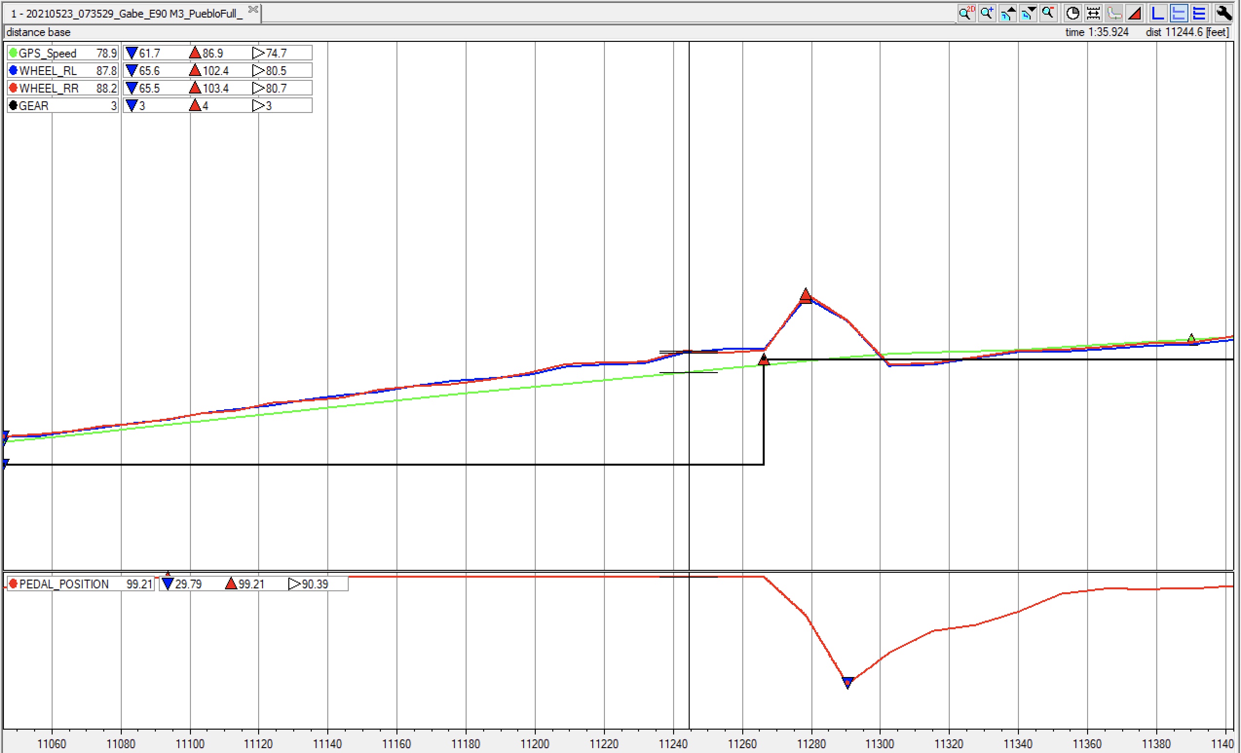

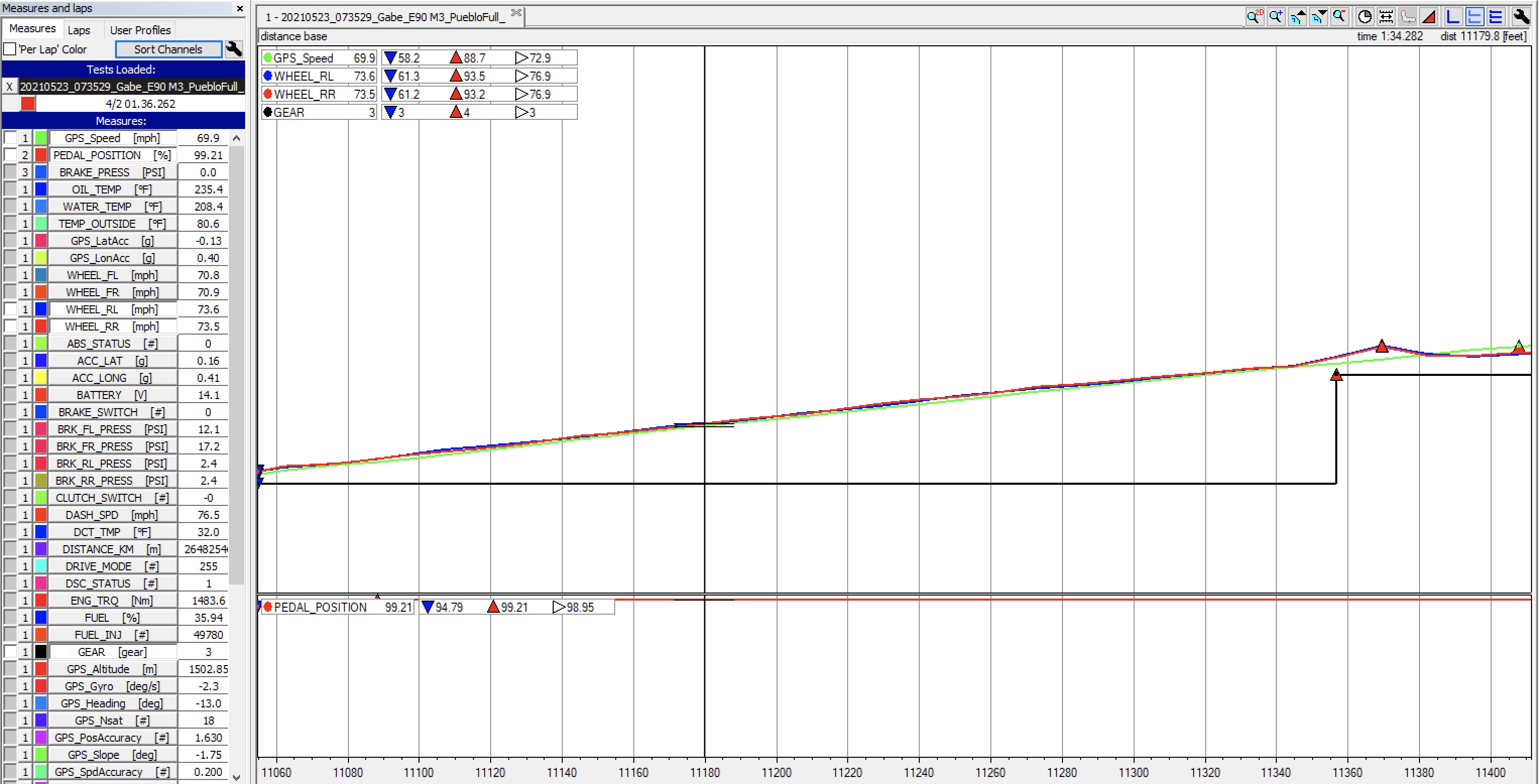

Let's file this one under.....yeah, screw that Pueblo prepped rubber. I don't care what anyone says.....the data doesn't lie.
In my write up of Pueblo, I mentioned how Turn 10 was funky when I got on the prepped rubber. I decided to do a bit of homework and dig into the data to see if what I felt could be observed in the data. The answer is yes.
First, I looked at the GoPro video, and the car does wiggle a bit when I upshift. It doesn't look like much in the video, but you can see it.
Next, I went to the data, and it shows my rear wheels spun up on the rubber during the upshift quite a bit more than they do on the concrete. But that's not all----remember when I said the rear end got light before it wiggled? Yeah, the data shows that too. Time for some AIM screen shots! (Geez.....can I tell you how happy I am to have AIM data back? So nice.)
First, let's setup the data we'll be looking at in these pix.
Top half of chart:
-Red and Blue lines that are on top of each other are the Rear Left and Rear Right wheel spinning speeds in MPH. These speeds should be very similar to each other because I'm 100% on the gas which means the diff should be locked.
-Light Green line is the GPS Speed. GPS Speed usually reads lower than what the car reports on the speedometer and what it shows as wheel spin speeds. No big deal here.
-Black Line is what gear I'm in.
Lower chart:
-Orange line is the Gas pedal position.
This first picture is of my fast lap of the day. On this lap, I stayed away from the prepped rubber.
In this pic we can see a few things:
-At the point where I upshift at 11360ft down the track, I get a modest increase in the wheel rotation speeds--from 88 to 93MPH---around 5 MPH.
-Before the gear change, we can see the delta in speed between the GPS speed and wheel rotation speed is steady. It stays consistent around 3-4 MPH.
-In the lower chart, I stay 100% on the gas the whole time.
Now let's look at when I get on the prepped rubber surface:
-At the point where I upshift at 11260 ft down the track, I get a much more dramatic spin up in the wheels---from 88 to 103MPH----around 15 MPH. This was when the rear end wiggled.
-Before the gear change, while accelerating, look at the delta between the wheel spin speeds and the GPS Speed. The delta is changing and gets wider the faster I go. This means the tires are spinning up on the rubber surface and showing faster speeds than the GPS speed as I'm accelerating, and the delta is growing as I get faster. It got as wide as 10MPH before the upshift. In my book, this is no good. I sensed the car starting to feel light. Here's the data show what was going on.
-In the lower chart, as I upshift and the car wiggles, I back off the gas.
So, the data is showing that, while I'm accelerating down the straight, my wheels are spinning up more on the rubber compared to the concrete. And the difference in surface grip is highlighted by how much the wheels spin up on the rubber during the upshift---an additional 10 MPH over the tires on concrete.
How was lap time affected by this? Lap time-wise, it is slightly faster to take the wider line through Turn 10 and get on the prepped rubber. I gained 0.1 sec by getting on the prepped rubber compared to my fast lap of the day. However, the gains didn't carry on down the track into the next lap because I momentarily got off the gas when the rear end wiggled.
And it's worth noting that this was done on the A7 tires at the end of their second hot lap, so I know the tires were plenty warmed up.
In the end, the 0.1 sec is worthless to me if the car is gonna act like this on the prepped rubber. It feels like too much risk. I had theorized that I was losing 0.2 sec by tightening the turn. If I could stay on 100% gas, I'm guessing that's probably a pretty good guess. But if you have to back off on an upshift, then the gain probably really is only 0.1 sec. Yeah....I can pick that up somewhere else. Now maybe a car with less power won't have this drama, but for me, I think I just need to stay off it.
