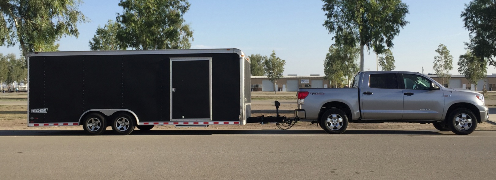

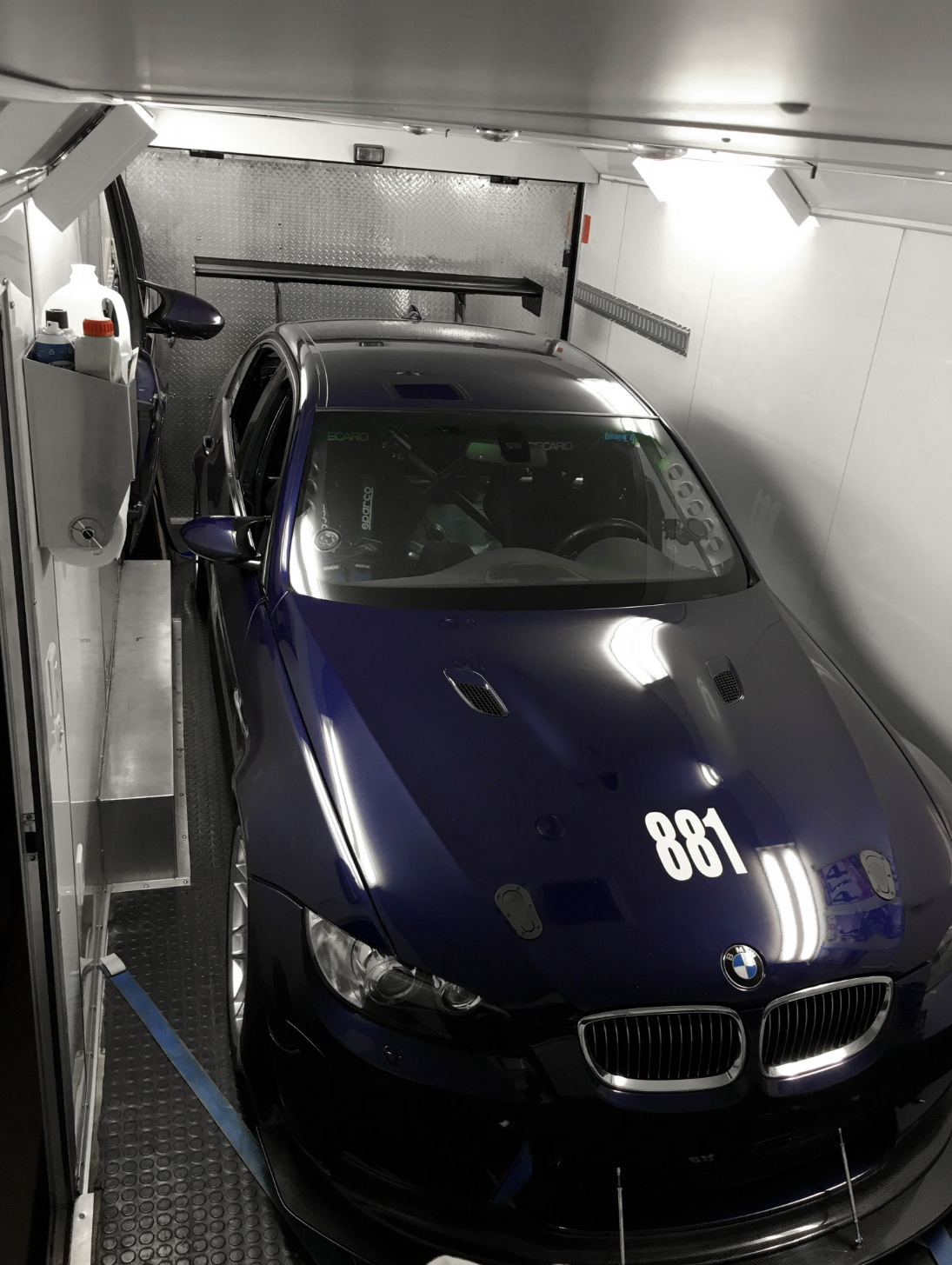

Oh boy, did you just ask me a question about trailers? hehe now you've done it….my track buddies are all running for the hills! No sir, I don't any opinions on this topic at all! Let's see where do I start?
Here's my short thought on trailers: Trailers require more work overall, but allow you to do less work at the track and just enjoy the track day more.
Long thought:
When considering trailers, I was trying to figure out what I wanted from a trailer setup. I actually bought a trailer while the car was still a street-going vehicle. The trailer was mainly for safety---a reliable way of getting home. However, the big question was: do you just get a simple open trailer for the sole purpose of transporting a car? Or can a trailer, whether enclosed or open, add to the convenience of the overall track experience?
I looked to the day when the car would no longer be a street car. I could see a future for the car when it would no longer have side windows. I could see using the trailer for multi-day trips around the Western USA which meant overnight stays in random places. I could see the trailer as being a convenient place to store all kinds of stuff like wheels, tools, fluids, nitrogen setups, etc.
So, after a long consideration process, I decided I didn't just want to toss a car up on a hunk of metal and drag it to the track. If I was going to go through the trouble of trailering, I wanted convenience.
Let me go through a laundry list of thoughts and observations that have come up over the years:

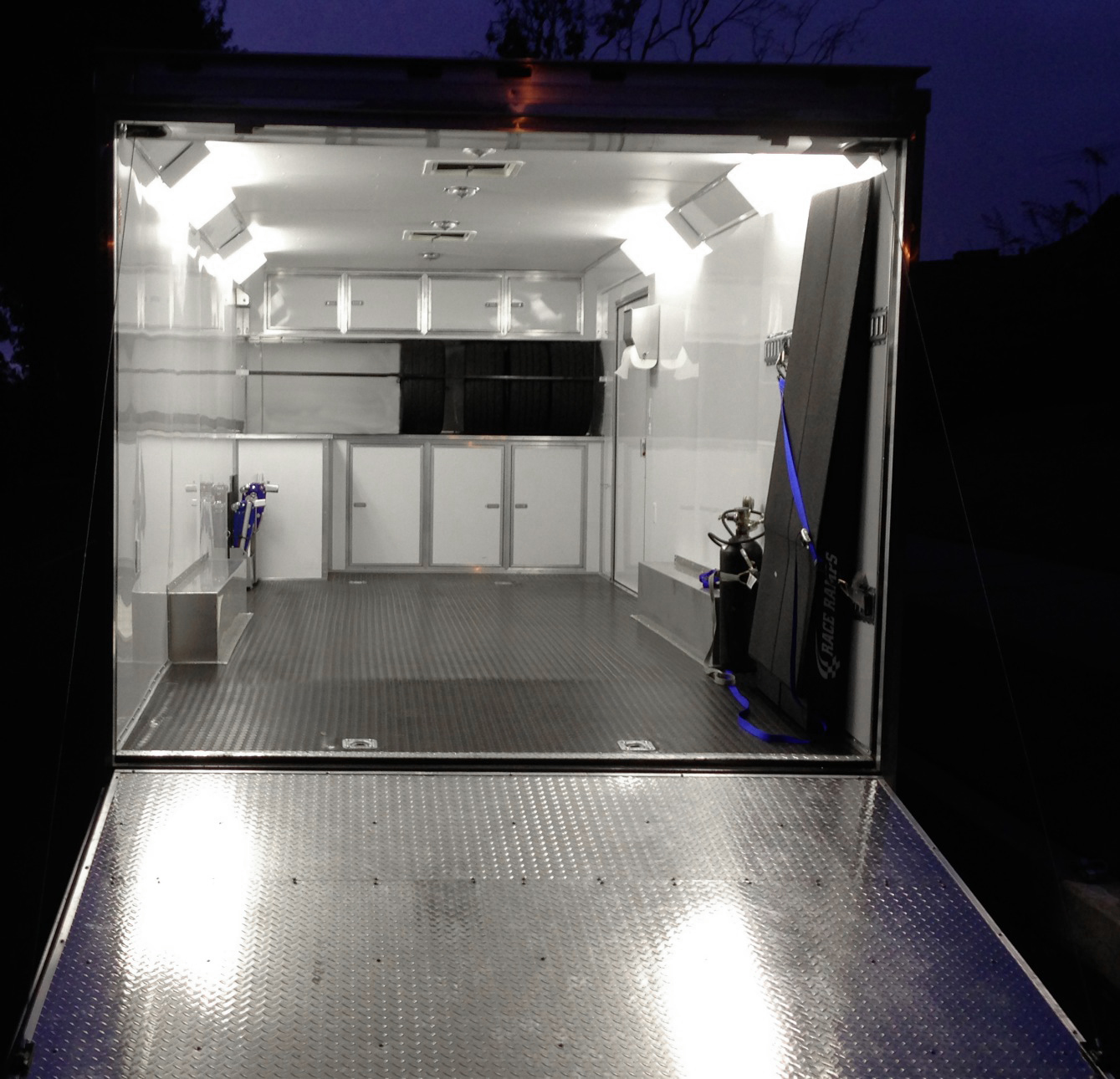

-Storage: Before I owned a trailer, I had to stuff my M3 with a crazy amount of crap when I went to the track---2 jacks, a set of wheels, full tools, all gear.... It took forever. And then once at the track, you had to unload everything, switch wheels, and then when you left you had to switch wheels again put it all back in the car, and then when you got home, you had to take all the crap out of the car and put it back in the garage….sound familiar? I made the decision that I wanted a trailer to just have ALL the stuff I needed for the track stored permanently in it. I wanted to reduce the amount of loading and unloading. Now, I just have three small bags I can carry to the trailer in one trip---they contain the race suit, shoes, helmet, cameras, etc.
-My enclosed trailer has a full set of top and bottom cabinets in the front. This makes it EXTREMELY convenient for storing everything I want to have at the track.
-I created a simple tire rack that holds two spare sets of wheels on the cabinetry's front counter top. I leave the tires in there all the time, and it's perfect because they're stored out of the sun. I love not having to move tires all the time.
-I committed to buying another set of tools. Often times, I don't bring my trailer rig home; sometimes I just take it straight to storage with the car in it. So, if I had only one set of tools on a rolling cart, I would always have to come home and get that thing out of the trailer otherwise I wouldn't have any tools at home. If the trailer had a basic set of good tools, it would save a lot carrying back and forth, and would reduce the problem of forgetting things in one place or the other. I also live on 7% grade hill. Moving a huge rolling tool chest would be a pain in my situation. I can't back my trailer onto my driveway so dealing with that monstrosity on the street and trying to get it up the driveway would suck.
-Tool duplication is only part of it. I keep all kinds of things in there: jack stands, two floor jacks, nitrogen rig, box fan, fluid pans, all kinds of batteries, lights, funnels, ground mats, fluids like oils, windex, WD40, distilled water for my misting system, brake kleener, knee pads, work gloves, ear protection, propane torch, paper towels…...the list just goes on and on….and it all sits quietly in the trailer all the time.
-I like the fact that I can leave the car in the trailer at the trailer storage place if I want to. I would never do that with an open trailer. Sometimes I plan on visiting a shop a few days after the track event. It makes life easier being able to leave the car in there, and just pick up the rig and go, instead of having to get the trailer, go home, pick up the car and then go to the shop and then come home and drop off the car and then take the trailer rig back to the parking lot and then go home……less running around.
-My car no longer has side windows. Trailering in the rain with an open trailer would require covering the car, which just sounds like a pain in the ass. An enclosed trailer makes this a non-issue. I always laugh when we get to a track after driving in the rain and my friends' cars are trashed and my car arrives shiny!
-The thought of staying overnight at random motels or anywhere for that matter with a car on an open trailer with no windows did not excite me. An enclosed trailer offers better security and lowers the risks when dealing with overnight parking.
-When doing multi-day trips at a track, I leave the car in the trailer overnight at the track. At some tracks like Laguna Seca, the dew in the morning is INCREDIBLE. Again, with no windows this would be a pain in the ass. Not with the enclosed trailer----I pull a nice dry car out and I'm ready to go.
-Great for hanging out: At certain tracks, there's not a lot of shade. Southern California can get pretty toasty. My trailer is usually set up with a number of chairs and a bunch of guys hide from the sun/wind/rain in it. We meet new people all the time at the track who come to the trailer and hang out. It's a great social tool!
-My trailer has lights in it which power off the 12-volt batteries, which is great at night. It also has a 110v connection, so if I get a generator or hook up to a 110v power source, I have fluorescent lights and power outlets. That is REALLY nice.
-I generally do not leave my race suit on all day. I definitely do not like to change wheels or work on the car with it on. The enclosed trailer gives me an easy, semi-private place to change quickly.
-On multi-day track events at the same track, everyone throws all their gear crap into my trailer at night. Super convenient.
-Everyone ignores me on the freeways. My friends with open trailers get endless looky-loos. I just want everyone to leave me alone. And they do. I could be carrying a shipment of flowers in my trailer as far as anyone is concerned.
-Open trailers don't offer anything in the way of convenience unless you start adding on a bunch of tire racks and big boxes, etc. And those add ons get expensive. And even then, it's not ideal storing tires in the sun all the time, so you're still schlepping tires around constantly. And you can't carry the amount of crap I carry in those boxes. So, then you're still jamming up your truck or SUV with gear. My friend's Silverado is always JAM PACKED FULL of track stuff. But his open trailer sure is light and clean!
Downsides:
-My rig is large/long/heavy. Too large/heavy for a regular SUV smaller than a Suburban to tow. So, it requires something with a long wheelbase that can tow 10,000lbs. For me, that was a Toyota Tundra. It does a great job. But let me tell you, it's a good bit of work for the truck to drag that whole rig over the Grapevine on I5. You go from sea level to over 4000 ft both ways.
My friends have Trailex 7541 aluminum trailers. The 7541 weighs 845lbs. If an M3 is 3700 lbs., that's a whole trailering setup that weighs less than 4600lbs. Pretty much ANY SUV can haul that. One friend hauls his Trailex 7541 with a Porsche Cayenne diesel that has air suspension. Now THAT is the luxury trailer rig. He doesn't even feel the rig back there. And he's getting like 20mpg while towing…..hehe not me. I'm getting less than 10mpg.
-Big trailer rigs can be susceptible to high winds and even buses/big rigs passing you unless you commit to setting them up properly. I use a weight distribution hitch that includes sway control. It's called "The Equalizer". That is the BEST DAMN THING for keeping the rig under control in high wind conditions. We were driving to Chuckwalla one morning and the wind was HOWLLLLLLLING. There was an 18-wheeler rig blown over on it's side because it was howling so bad. My rig shook under the force of the wind, but it was COMPLETELY 100% stable. The Equalizer is amazing. (It creaks and clicks in low speed turns, but who cares….it works awesome.)
-The trailer needs to be stored in a dedicated facility. I can't have this thing stored at my house. This costs money and increases the amount of time spent on dealing with trailer logistics. It's great if you can find a 24-hour-access facility. I wish mine was 24-hour…..Anyway, getting ready for the track day and wrapping up after the track day take more time since a special trip is required to pick it up and drop it off. Most of the times, it spills over into another day because I get home too late to drop it off. And it's not worth paying and extra $40 to do it after-hours.
-People who I don't know are constantly coming up to my trailer asking to borrow stuff……I haven't said no yet, but sometimes I have multiple tools out at the same time. I like to be helpful, but it does seem a bit much sometimes.
Couple other thoughts:
-If you get a heavy trailer, get air springs for the rear of the towing vehicle to help prevent sagging. My Tundra was sagging a lot. Firestone Ride-Rite air springs are great. They completely cured that issue. The rig sits SO much better since I put those on. I have eight wheels plus all the tools in the nose of the trailer so there's a lot of tongue weight.
-Get a strong electric tongue jack for raising and lowering the rig on the hitch. The manual spinning handle thing SUCKS. On a heavy rig it's impossible.
-Don't run a trailer tire that is more than 5 years old. You CANNOT judge the condition of a trailer tire by looking at the tread. Trailer tires NEVER wear out the treads within 5 years. But after 5 years, they can start to bubble. You don't want that. The trailer I bought was 5 years old. I took it straight to the tire shop after I bought it. The tire guys showed me that 2 of the tires were bubbling.
-Trailers need annual maintenance if you want them to run properly. The brakes wear out, things need grease and tweaking.
-Reliable high volume compressed air setups can be a nice addition. I have yet to do this, although I'll probably pull the trigger soon. For 4+ years at the track I have used a simple Craftsman C2 battery powered air tool. It works great for a few psi on race tires. But it's not ideal for filling trailer tires or pickup truck tires that need large amounts of air.
Anyway, the topic of reliable air setups is probably the BIGGEST running joke that me and my track buddies have. My little $40 air gun is the CAN-DO air gun. It just keeps working and working flawlessly year after year. And my buddies who have dedicated air systems are always putting the hate on that little air gun----BUTTTTTTT----THEY ALWAYS NEED TO BORROW IT BECAUSE THEIR FANCY SETUPS NEVER EVER WORK! AND I MEAN EVER!!!!! Holy shit. It just happened this past Sunday. My buddy's air rig didn't work because his 12-volt battery died. There he was, borrowing my air gun. This is the longest running joke we have. I am merciless about it too! They have these tanks and compressor units and for a variety reasons, they NEVER work. And then the next thing I see, they just sneak in and take the air gun and use it with their heads hanging in shame because they were just making fun of my air gun. They don't even ask because they know I'll just be merciless about making fun of them. I even take pictures of them using my air gun with their non-working air setups in the background just to shame them as much as possible! hahahahahaha I am sitting here laughing my ass off while I write this!! Good times!
Anyway, their air rigs are on their open trailers. For an open trailer, I don't think this is the best setup for a variety of reasons. Even though I have an enclosed trailer, I plan on putting my Firestone air compressor rig on my pickup so that it ties into the Firestone air springs and can inflate and deflate them as needed. And then I'll always have air with me, and then I'll run a fixed air line under my trailer so I just connect it to the truck and then I'll have a quick disconnect at the back of the trailer so I can just run a short air hose to the car. I'm trying to avoid the hassle of having to wrestle a 70 foot-long air hose from the back of the pickup truck all the way to the rear tires of the car. I measured it one day. It's like 65 feet when you take into account the trailer, the rear trailer door, race ramps and length of car sitting way back there. Honestly, sometimes I think I'll just keep using the air gun on the race tires because it's so easy and I never need much air volume and just use the pickup's air system for truck and trailer tires and air springs.

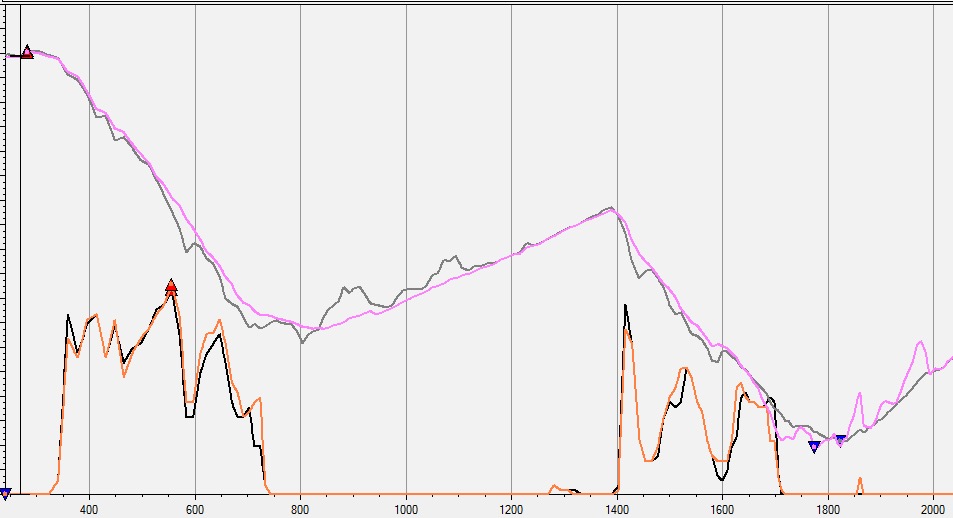

does your new differential trip your euro MDM any more or less?
Interesting question. Sunday was the first time I drove with Euro MDM on and the new diff. All my days at Buttonwillow with the new diff were with DSC-off. In looking at the AIM data, my conclusion is that MDM in general allows the wheels to spin different speeds in turns. The stock diff is a speed sensing unit, so it relies on different wheel speeds to transfer power. In my AIM data, with MDM on and stock diff, I can still see the inside wheel spinning up quite similarly to when DSC is off.
My understanding is that MDM kicks in when the car is sensing a slide from accelerometers, yaw angle, etc. I'm guessing that it understands that the wheels need to spin at different rates for the diff to be able to do it's thing. As long as the car isn't going sideways, or at a funky angle, it seems that MDM stays out of the way. So, I don't see MDM doing much to stop the wheels from spinning different speeds.
In the picture below, we're back at the Sunrise and Off Ramp corners at Buttonwillow. MDM is on. Stock diff. This is a 1:51.5 lap, so we're on it pretty hard here. The Pink and Gray lines are the wheel speeds. The Orange and black lines would be the two rear calipers. You can see the Orange and Black lines are working from 375-775ft as I slow for Sunrise. Then as I accelerate at 800ft, you can see the wheels drift apart in speed. If you look at the calipers at 800ft, they are completely inactive. MDM is doing nothing to prevent the wheels from spinning different speeds. About the most I could see MDM intruding on the whole lap on acceleration as far as self-activating the rear calipers is at Off Ramp at 1850 ft. You can see a slight touch of caliper around 1850ft. But even that is quite a small activation and doesn't do anything to prevent the spin up at 1900 ft. Throughout the rest of the lap, I don't see the rear calipers activated by MDM. (I can tell what is MDM braking and what is me braking because I can show the brake press parameter, and if I'm not pressing the brake, but the brake is activating, then MDM is doing that.
i'm curious if the tighter differential causes less cut-in because of the less difference in wheel speed.
Again, I think MDM is looking at other things. So it doesn't seem to care that much about the wheel spins if the car isn't getting crazy.
The OS Giken can send the car sideways quicker than the stock diff if I mash the gas, so in theory, the new diff could trip MDM quicker. But that's because the car is going sideways at that moment.

Here's a few random trailer pix. The trailer is fairly modest---it has no bling factor whatsoever, but it is very handy. It's a Haulmark Edge. I found mine used on racingjunk.com.
Picture 1: shows how level the rig sits with the air springs in the truck. This car is in the trailer in this pic. Without the air springs, the truck really sagged in the back. And I'm not pumping up the air springs very hard at all. I could go much firmer. I don't feel it's necessary.

Picture 3: Car in the trailer. Shows the driver door on the wall. With the cage, if a driver door is in place, it is VERY VERY difficult to get out of the car inside the trailer. Yes, I have a winch, but driving it in is SO much faster. Removing the door makes it very easy. Of course, a trailer shop had to make that as a custom piece. They made it so both hooks on the hinge side sit in a mount and the latch end of the door latches onto a mount they created. So as far as the door is concerned, it's exactly like being connected to the car.
Picture 4: One more shot of the car in the trailer. Again, you see the door mounted.
