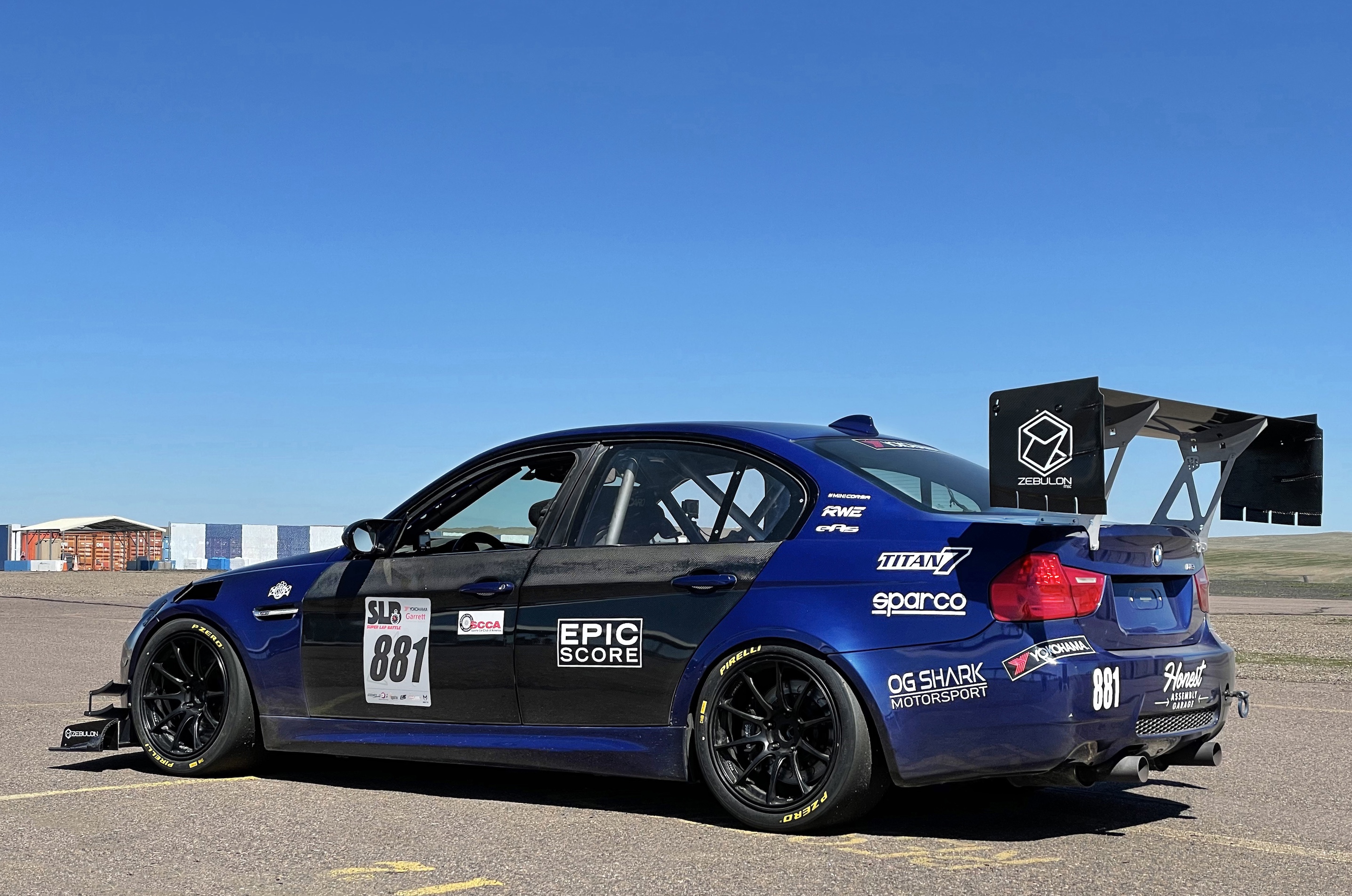

So you were within 1sec of the Pirellis with the A7's - but with less track time on them and still getting yourself & the car dialed in... interesting. Think you can turn a 1:48.xx on the A7?
Ought to be comfortably in TT1 with a bit of room to spare if you use the avg whp vs the peak.
I know we talked about it the other day but just wanted to say again the car looks freaking awesome.

This things starting to look like a serious Time Attack car now
On a better day, with a less green track, you got a 47 in you for sure!
Thanks man! Hey wait a minute——-you’re only saying that because your logo is on there!!!!
I believe both tires can go faster than what I did, but it’s a start. Not sure if A7 can go under 1:49.....
TT1 is definitely the goal. We'll see.

Never noticed how low the car is
