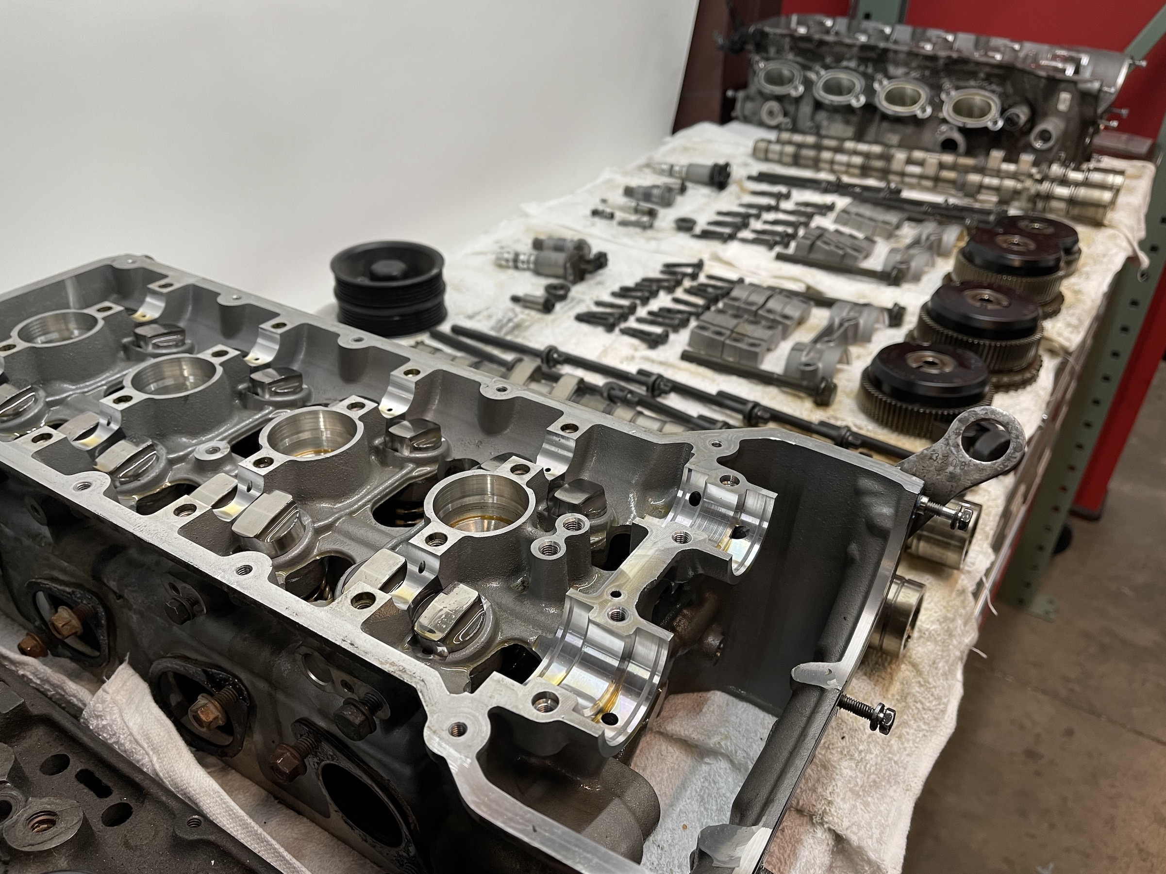

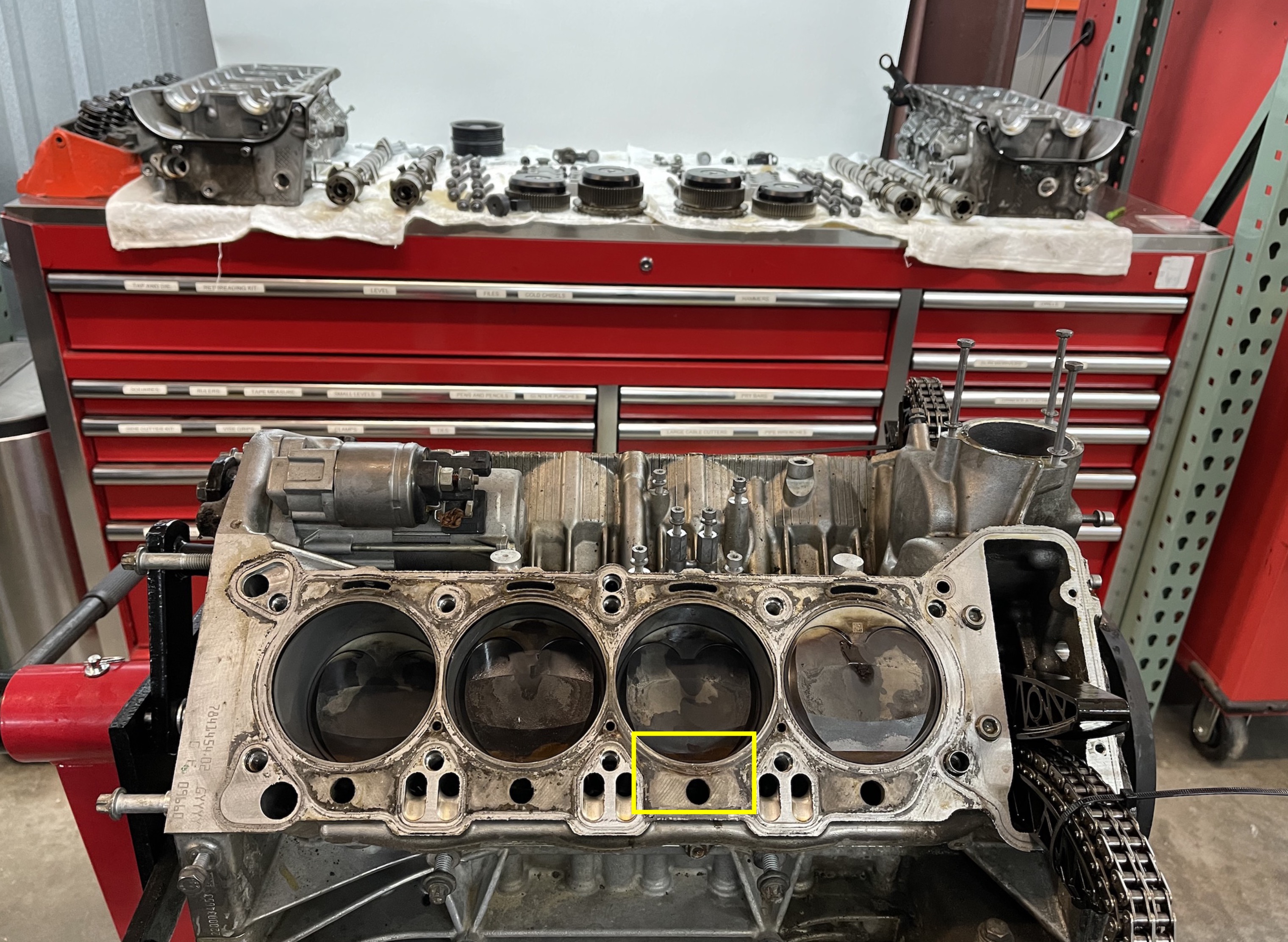

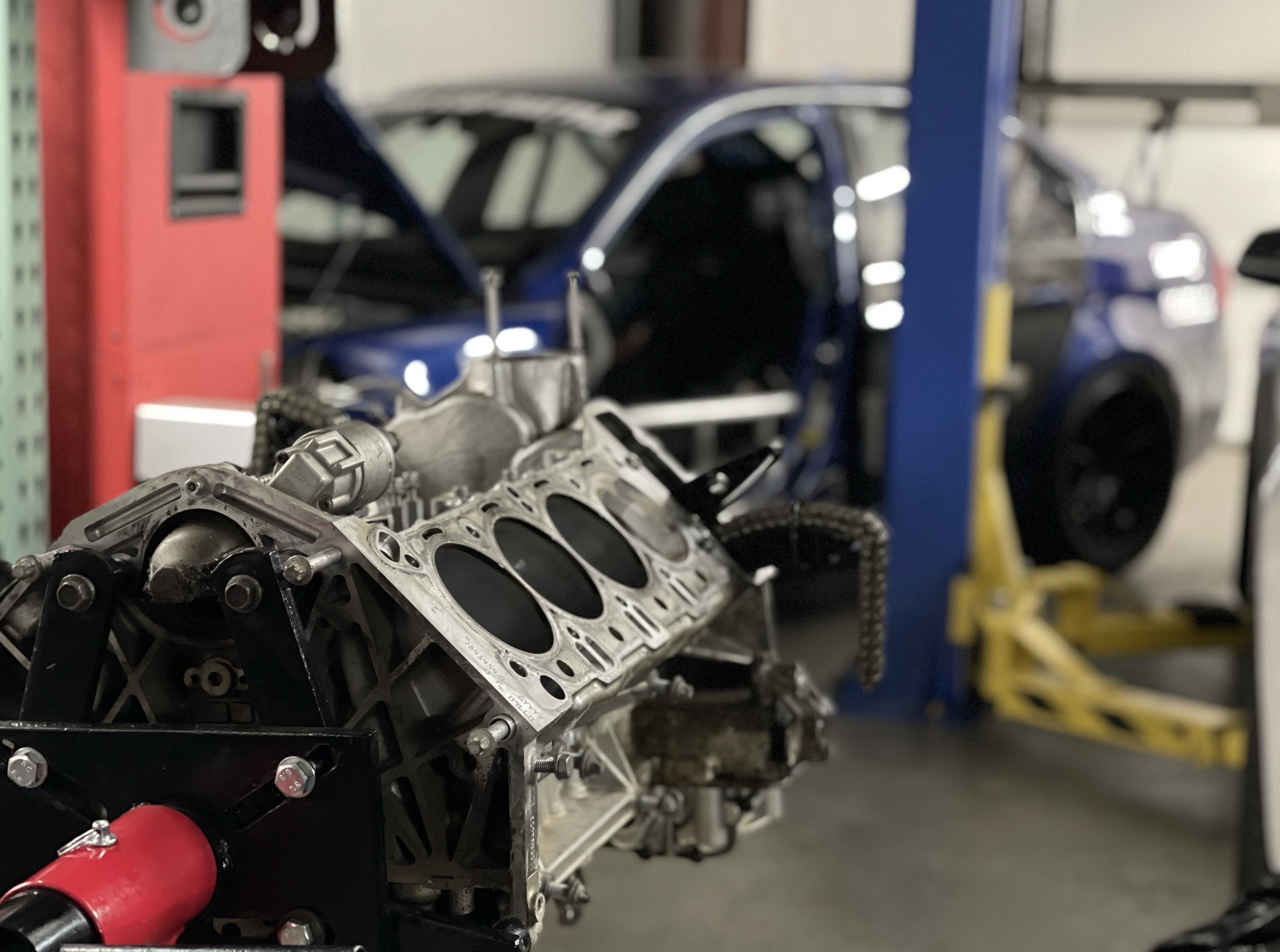

Cory sent over some nice pix of the E90 motor tear down.
The yellow rectangle shows where the head gasket was failing. Hot fuel and air were forcing their way from the cylinder, pushing through the gasket and into the coolant hole at the bottom of the rectangle. I'm being told the pistons look really good and the cylinder walls are super clean.
Haven't gotten to the main bearing yet. Curious to know what that will look like. Also, we will have an opportunity to see what the replacement rod bearings that EAS put in look like after about 4000 miles of track-only use.
