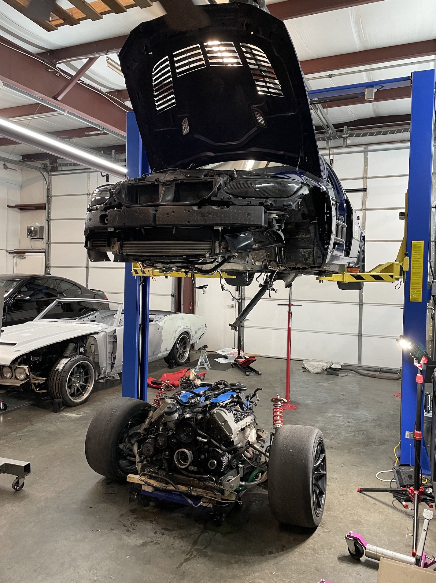

I went to the shop to be Cory's assistant last night. I've been interested in the process of how the engine comes out. I learned a lot! I pulled a bunch of bolts and lines, worked the lift, dealt with floor jack positioning, etc. We worked late into the night last night and got the engine out of the E90. We eased it out the bottom without a hitch.
Here's how things looked when we were done.
Here's how I imagine the E90 would look if I had a lift kit on it......

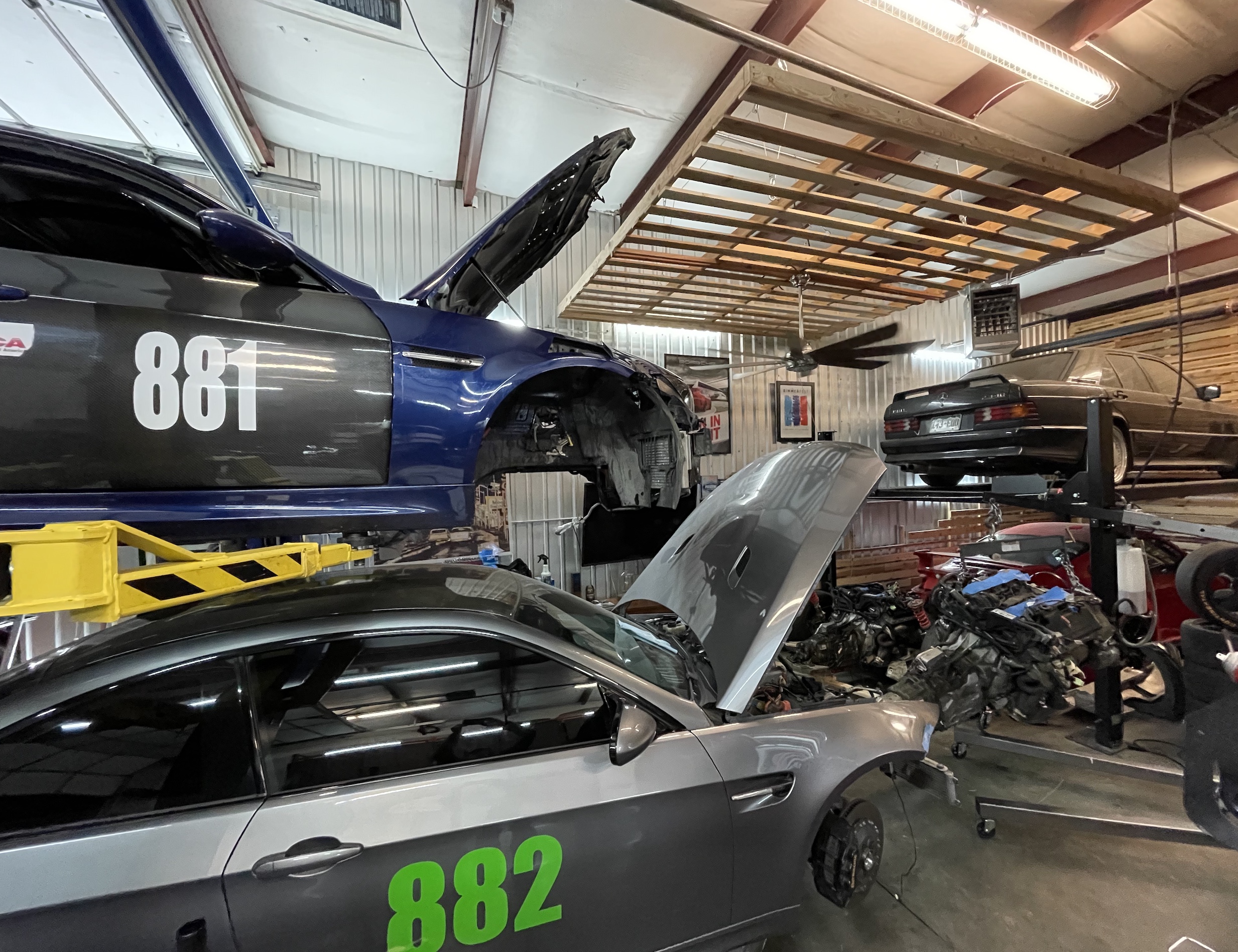

Today the teardown of the E92 is going to be high priority. My understanding is that three guys will be on the task today. We've ordered a bunch of parts that should arrive today. I'll be running around town to pick some stuff up.
So, everything is moving along!

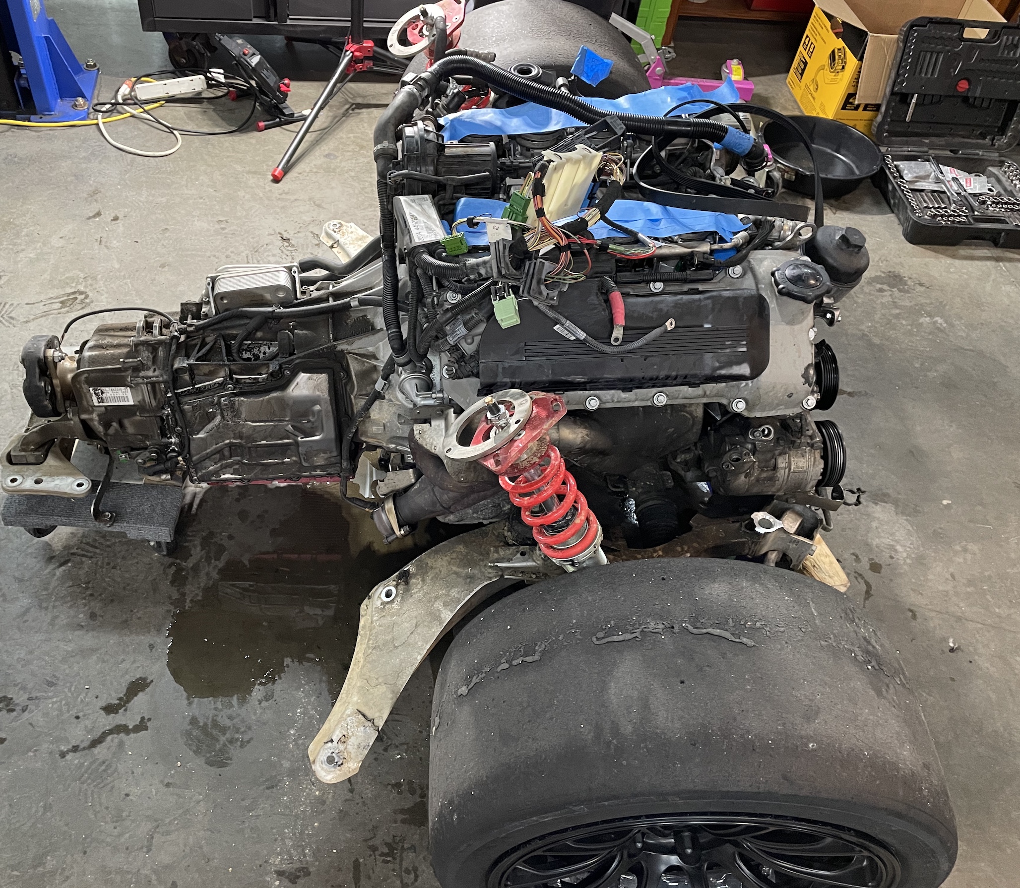

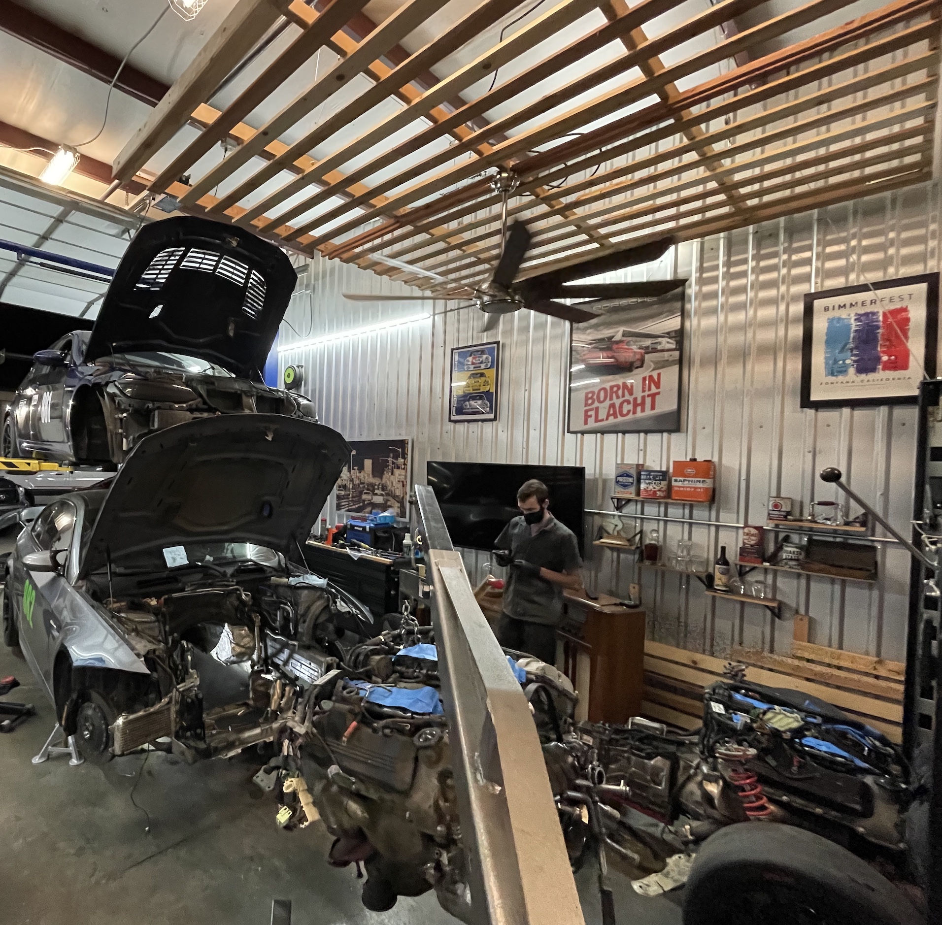

Things continue to progress. The second engine came out today. This engine was pulled out the front.
Looking pretty crazy right now.
