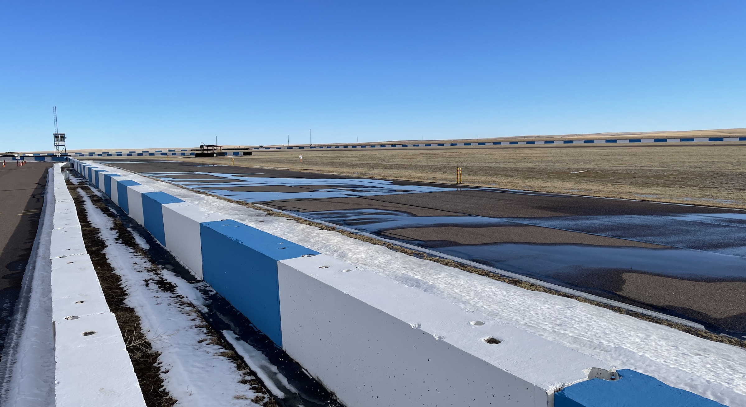

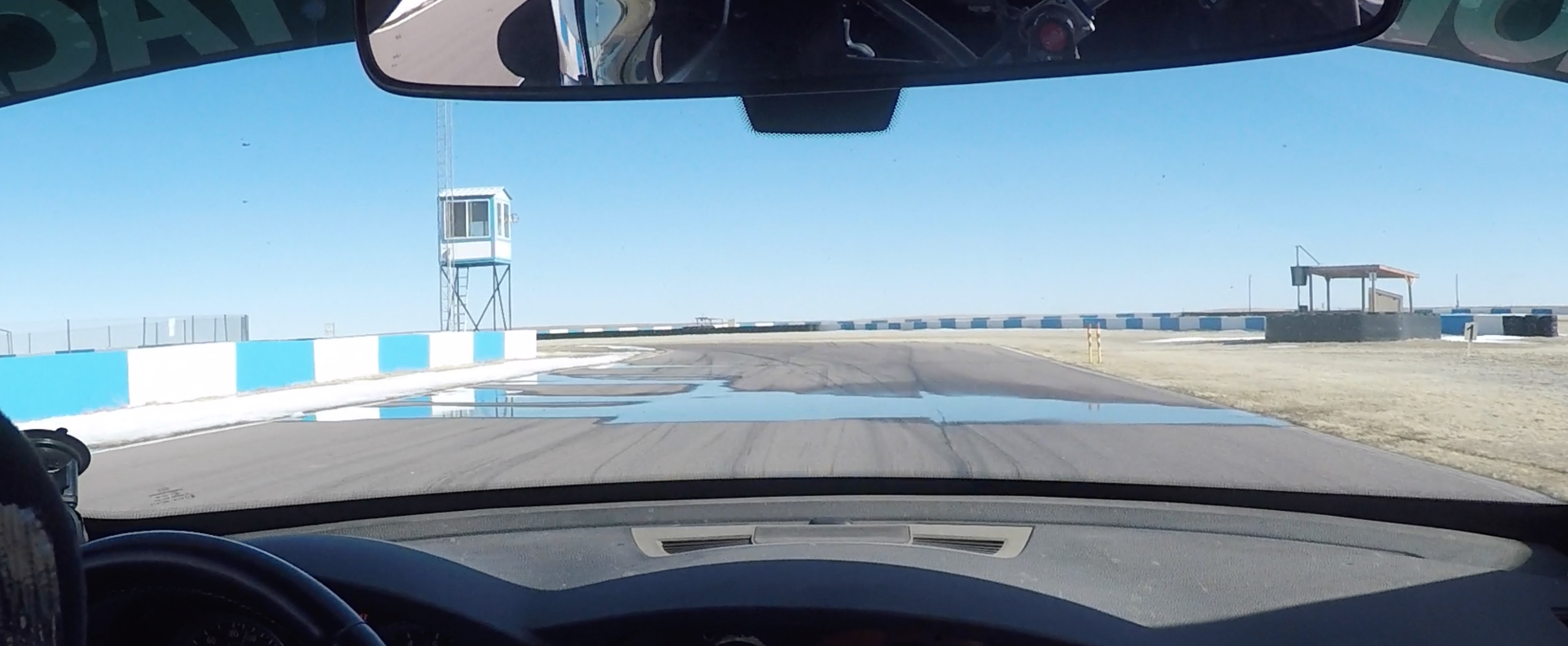

Let's file this one under: Enough with the wind already!!! And seriously?.....the melting snow is doing what?
Went to High Plains Raceway on Saturday. Air temps were looking great, so I was excited to get a full day in with the new splitter along with changing the AOA of the wing and experimenting with some other damper settings.
On the way to the track, the wind started howling. There were dirt clouds blowing across the landscape.....I was hoping that maybe the track would have less wind. haha no. It was howling at the track too. Usually I ignore wind in the paddock but this was so bad and it was cool enough that I kept hiding in my pickup truck between driving sessions.
So, it was hard to get a real sense of the splitter because the car was getting tossed around. On Friday, there was no wind and, for the couple laps that I had before my coolant issues surfaced, I felt like there was some really good stuff going on. But the wind on Saturday was tough. So, I don't have any splitter report yet. I'm trying to get back to HPR before I go to COTA, but we'll see.
The day's format was open track.....which did not work in my favor. There were some very slow vehicles on track including an SUV.....
The most frustrating thing of the day was that snow was melting on the side of the track on the front straight, and was slowly creeping across the track. By early afternoon, it was all the way across the pavement and in the braking zone for Turn 1. SUPER sketchy. Was gliding on it like ice with my slicks. And then as you entered Turn 1, the tires were still wet......ooh yeah, fun. I quit early because of that.
This is never a good sight in your braking zone:
The other bummer was that I went off track once. As I was going off, I thought it was no big deal, but then once I was off the track, I realized it wasn't dirt.....it was mud.....the car was trrrrrrasssssshed with mud. I spent some time at the track cleaning it, but then once I was going through the water on the front straight, the car was trashed again.....Took me 4 hours to clean it today. It's sparkling now though!!
Anyway, regardless of the wind......I believe the wing and damper setting changes were for the positive. That's what I was focusing on----trying to understand the feel of the car.....I was very close to my PB which, given the conditions, I was happy about. Lap times were not my focus yesterday.
Also, the new coolant reservoir seemed good. Max water temps were 213ºF. So, I hope that funkiness is behind me.
On the topic of weather----the day was sunny and 50ºF. I returned the trailer to the parking lot and picked up dinner by around 6PM. As I was pulling into the driveway, there's were a few snow flurries starting to fall. By 8:30PM, it looked like this......3-4" of snow had fallen.....I wasn't aware that we were even getting any snow....glad I was able to sneak the track day in before the storm hit!
