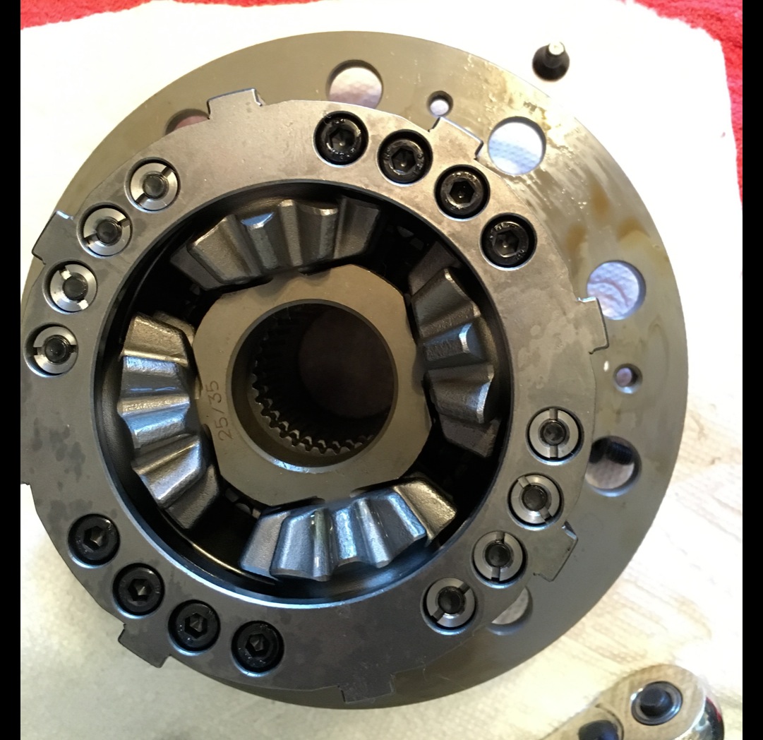

Yes I was referring to the number of plates that are activated. I found that I liked 7 plates activated since it still gave me adequate lockup and didn't get my rear tires as hot. But different car with a different unit so it's not a direct comparison.
A good differential really does make a noticeable difference in the way a car feels and responds. Great build!
Thanks!
Yeah I was interested to learn that some OS Giken Superlocks for an E9x M3 have 7 clutch plate sets per side. I have 5 per side. I wonder if that's part of the custom setup, or have they modified the general design? Something has to change if you have less clutch plates. Is it the housing case? I don't know….

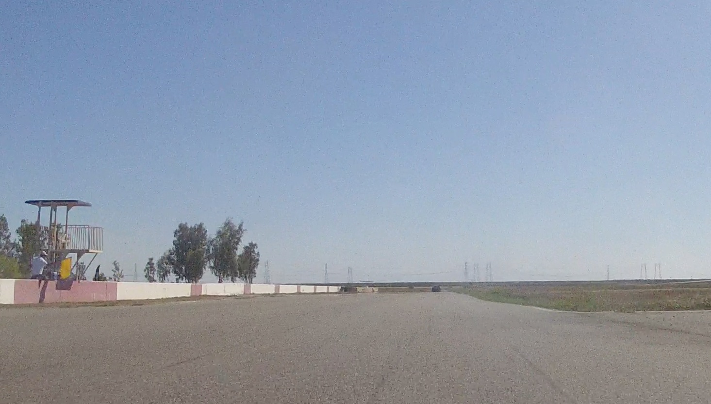

During the event, the Start/Finish-line flag worker caused some chaos in one of sessions…..We had just finished our warm up lap and were supposed to be on our first hot lap and as we were coming through the Start/Finish Line to start the first hot lap, he was stretching his arm out over the wall holding a Yellow flag…….
Well, some saw it, others didn't, and for several of us, it was confusion out there and so some people were trying to pass while others thought we were under Yellow. It turns out he was mistaken and there should NOT have been any Yellow flag on course. It's a shame the flag worker hosed that session because it was an early session when the weather was nice and cool and I had fresh brand new tires. That should have been the session to drop the hammer. But instead, that session was a waste….I ended up driving my fastest lap during the last session of the day when my car said it was 80ºF out…..

What percentage lockup did you set it to? I had a clutch type differential on a previous car and took it apart 3 times to flip clutch plates before I found my preferred settings.
I don't know % lockup. OS Giken decided all of that and didn't tell me. They purposefully remained vague about some of the details saying that some of the setup info is proprietary and is based on their database of all the race cars they have setup over the years.
Is % lockup something that can be calculated based on number of active plate sets and ramp angles or some other parameters? The OS Giken unit in particular is a little unique from what I understand because it has different Pressure Ring Tuning Spring options in the 16 holes in the Pressure Rings (mine is pictured below). Those, along with different Cone Spring options and the setup as far as pre-load goes starts getting to be a little "Black Box-like"…..
Here's all I know. Maybe you can tell me the % lockup based on this? I would love to know…..
-1.5 setup
-Ramps: Based on Y-axis---35º on Power, 25º on Decel. (On X-axis: 55º/65º)
-All 10 clutch plate sets are active.
-There's "hardly any preload" is what I was told. (whatever that means)
