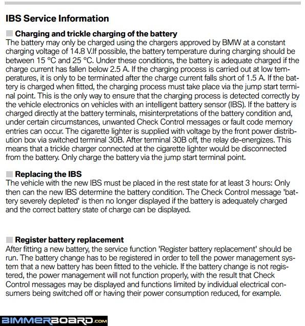

I would be extremely suspicious about having battery issues after The Stealer has done the battery cable recall. The recall involves disconnecting the original cable from the fusebox, cutting the old positive battery cable to remove the old ring connector and splicing in a new section of battery cable with a silver ring connector. This is done to remove and mitigate any corrosion. IF the cable splice is not done correctly (read immaculately) I would suspect this as the culprit. Moreover, at the other end on the negative cable is the Intelligent Battery Sensor (IBS) connector that doesn't seem to like voltage spikes. A bad positive connection behaves similar to a bad ground. When the stater 'asks' for maximum volts and current any extra resistance will cause a voltage drop. Take a video of what is happening and show it to the Service Advisor. Once he has evidence of what's happening he should act to remedy the situation or at least check the work that was performed by them. Put a volt meter across the terminals under the hood and record the voltage during a start cycle to see if it drops significantly. This is just what I would do.
File Type: pdf Intelligent alternator control IGR used on 2007 models and onwards.pdf (2.86 MB, 3 views)

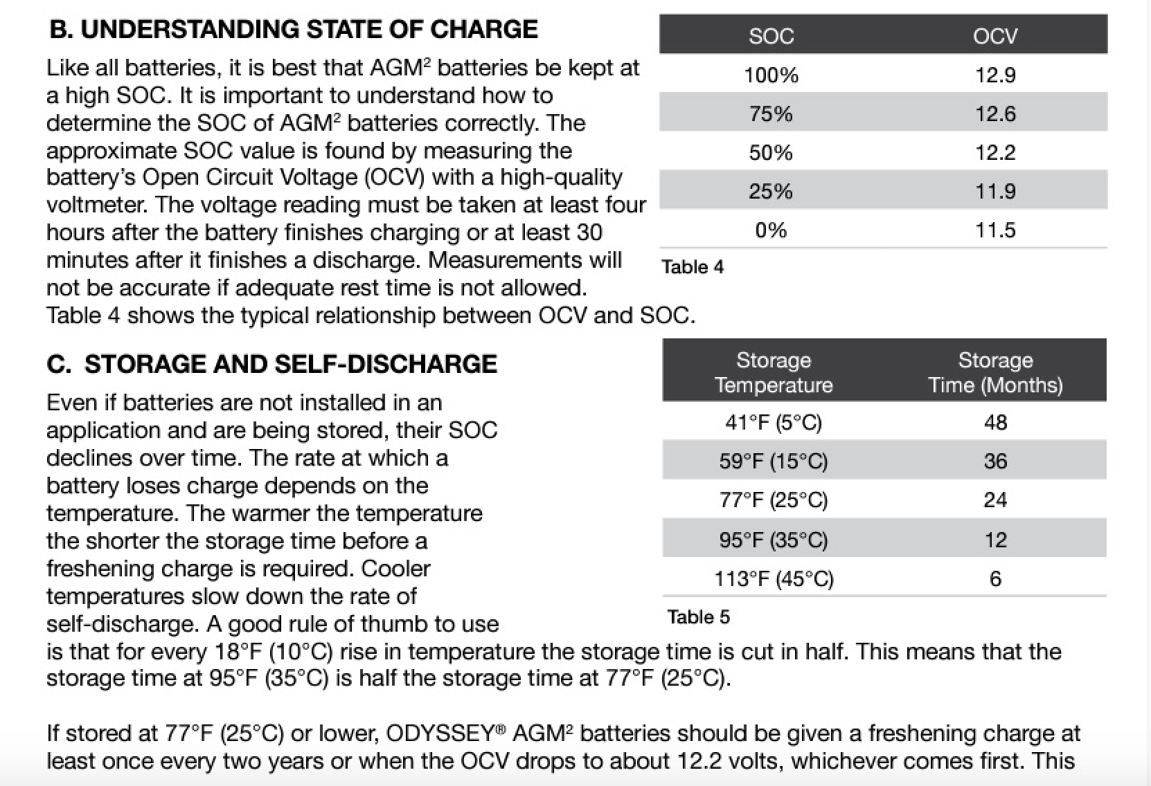

Just to confirm it isn't my LiPo battery, I swapped in the AGM with the same results. I also took video of the start cycle with my multimeter attatched to the under hood terminals. Voltage was 12.3 at rest and dropped to 10.2-10.9 while cranking. I knocked around the fuse box a bit and pushed the connector on the top left of the fuse box again and on the next start, it ran but quickly died so it really seams like there is a loose connection somewhere. Reached back out to the service manager earlier but got voicemail again, about to call again.
The surface charge voltage on a fully charged OEM AGM battery is about 13.0V to 13.4V at rest. 12.3V shows the battery is partially depleted and may not start the vehicle. A loose connection is very probable but the issue could also just be a bad or depleted AGM battery OR both.
I do think the AGM battery is partially depleted, it would only charge to 72% on my charger before it went into trickle/maintain mode. the LiPo battery was showinig 13.1 when I checked it out of the car. I'd be curious what the voltage shows on the AGM when the car is asleep.

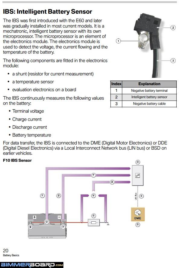

Check the IBS (Intelligent Battery Sensor) blue connector plug is properly seated. Check the alternator output when the engine is running (it should be about 13.4 to 14V output and see the Intelligent Alternator Control manual attached). Then clear the codes, take the car for a longer drive e.g. 30 miles or more and see if the codes resurface. If they do, the list of codes smell like a bad ground, or possibly the battery cable recall splice still not thoroughly debugged yet. Be patient. A list of codes like that is typically caused by low voltage gremlins while driving. There is a way to monitor the voltage when driving via a hidden menu accessed through the BC column stalk. I don't recall how to access that hidden menu but YouTube will. Sorry you're having so much trouble. It's a long shot but the non OEM battery could also be contributing to the problem(s).
Edited: Added video and IBS/IGR Manual attachment.
