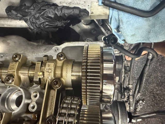

Had been fighting bank 1 VANOS codes in my car since picking it up cheap a few months ago. Finally got everything else fixed enough that it is time to dive into the engine. Doing the full cooling system, all the drive belts and pulleys, valve covers, oil filter housing gasket, and throtte actuators all at once. Actually just pulled the crash bar off the front to make it nice and easy..
Here is what I found under bank 1 valve cover.. The intake is obviously different than the exhaust side. While I dont have a great understanding of how this one works yet, I rebuilt the vanos in my e46 a few years back so im somewhat competent with it. If you notice my ISTA screen shot, I did at one point when I first got this car have a code for both bank 1 vanos, but as of recent it was just the intake. Is this gear just stuck out? I mean I do think this car sat for quite some time.. I know e46's get sludged up and have issues because of that. Or should I be thinking about just ordering a remanufactured vanos adjuster? I have the timing tool, and did purchase stainless vanos spring caps and new bolts from NRW when I got the valve covers..
Just want to hear yalls thoughts before I tear into it too far over the weekend
edit- didnt realize that picture is so bad. Codes were 00275f vanos max limit position intake and the same thing for exhaust, 002760. The exhaust seems to have went away but still had the intake code at time of tear down.

This is probably one of the more difficult VANOS issues to diagnose on the S65.
From what I've seen, the Vanos adjusters themselves rarely fail. More often, the problem ends up being one of the supporting components like the VANOS solenoids, O-rings, seals, or another issue affecting oil control.
The S65 also uses a relatively low-pressure VANOS system compared to the S85, so adjuster failures aren't nearly as common.
If the adjuster itself is at fault, I'd be more inclined to suspect debris or contamination causing it to stick rather than an outright mechanical failure.
As a first step, I'd swap the VANOS solenoids from bank to bank and see if the fault follows the solenoid. That's a quick, inexpensive test that can help narrow things down before replacing more expensive parts.

That might have been the check valve that you cleaned. If they were in the V side of the heads. Dirty or damaged solenoids may show up as a cam being a few degrees off or behind the other in a test. Great idea to swap banks and see
What shakes out.

I had a similar code on bank 2. 2761: VANOS maximum stop inlet bank 2.
This post details some of my troubleshooting and what ultimately fixed the issue (replacing VANOS adjuster).
https://www.m3post.com/forums/showthread.php?t=2225537
Any indication that this engine has had bearing failure in the past? I found from my research that these VANOS adjusters rarely fail but when they do, it is often because of fine particles jamming up the really tight tolerances that these adjusters have. I'm pretty sure thats what caused the issue for me.

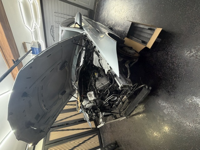

Just wanted to post a little update here- I pulled the valve cover off the drivers side too, and the intake camshaft looked exactly the same position wise as the pass side. Now, correct me if I am wrong, but all 4 should look the same as the exhaust cam in the picture I shared- correct? The gear I am pointing to in my first post should be adjusted all the way towards the timing chain as it is on the exhaust?
It seems to really properly diagnose this I should have ran a VANOS test before I tore this car apart- I just knew I was doing valve covers, and vanos caps that required re-timing the car and using new bolts in the adjusters and everything- so my thought process was who cares, I have to re time the cane no matter what.
I also retract my previous statement about the solenoids being cheap lol.. That was just from a quick google search and it was not for an s65. Looks like its about $900+ PER SIDE if I replaced exhaust and intake solenoids both, or like $550 a piece for a single intake solenoid. Rebuilt adjuster is $550 as well.. So I might pump the brakes on just throwing money and new parts at the car to fix it. Really pinpoint the issue- I did see that ECS had a Vaico intake solenoid I could get for $120 or so. Tempted to try it, but not sure if anyone has experience with these cheaper replacements vs OE? I know that is a no-go for the coil packs.
To answer your question on if this car had a rod bearing failure I cannot say... I know it came with a receipt for having them replaced by Off Camber Racing in Rockway, NJ back in October of 2020. I will say this car strikes me as having NO maintence done to it. Just incredibly poorly taken care of (least they kept the interior nice).

A full set of re-man VANOS adjusters w/ bolt on vanos caps is around $2,200.
Replacing the VANOS solenoids is definitely the cheaper route if we had ran a vanos test prior.
Right now, though, we don't really have a confirmed root cause, so you'd be shooting in the dark. It would've been nice to buy a single VANOS solenoid and swap it between banks to see if the issue followed the solenoid before deciding to replace the rest.
Replacing just one VANOS adjuster doesn't really make sense if you're already going down that path, especially since we don't actually know which adjuster is at fault. If it does turn out to be an adjuster issue, I'd rather do the full set.

Originally Posted by HDdave View Post
Okay- so got home and checked timing and its dead on.
So pretty much ready to start putting everything back together now, I am just curious what yall think of my exhaust adjuster on bank 2? I forgot to attach the clamp to that one when I was re torquing it down- in my defense TIS never shows it on that side in the instructions..
Everything rotates just fine- honestly I think these splines were sightly off when I took it apart too. But I am not sure if you can tell from the pictures- bank 1 is absolutely perfectly in line and bank 2 is just slightly off. Again everything rotates just fine.. But my OCD is arguing with me now.. I did order 4 new bolts when I thought I had f'd up the timing, but I can return them... Would yall loosen this one, clamp those splines perfectly straight like bank 1, and run that same bolt back in? It has already been stretched once then final torqued... Or I could wait a few days and do that and install a new bolt. Or just put it all back together beecsuse its fine and im being crazy?
There's an easy way to check if your anti-lash springs are appropriately tensioned- get an eyeball on the hole where you put the M5 screw to lock the two halves of the gear together. You should be able to see most of the threaded hole in the spring that lives in there.
There should be a LOT of spring force between the two halves of the gear.
