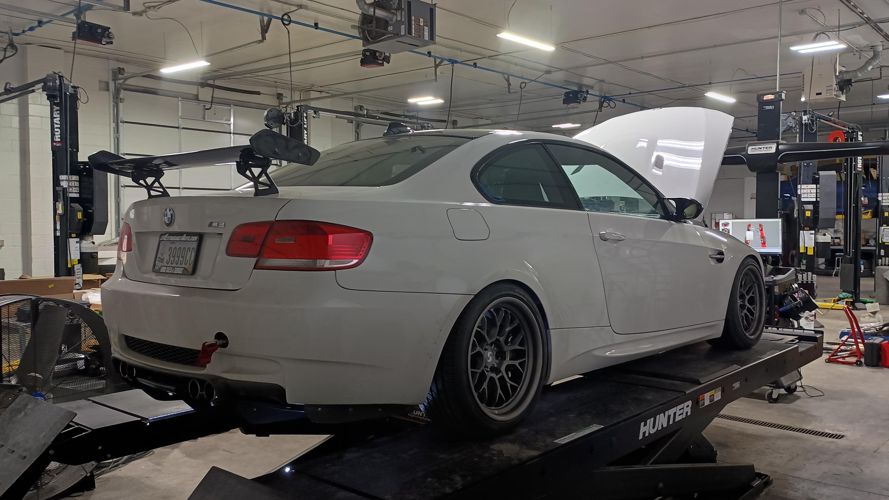

See pictures for current ride height.
wait you bought Jimmy's e92 m3?
if that's the same car, that's a really dialed in build.

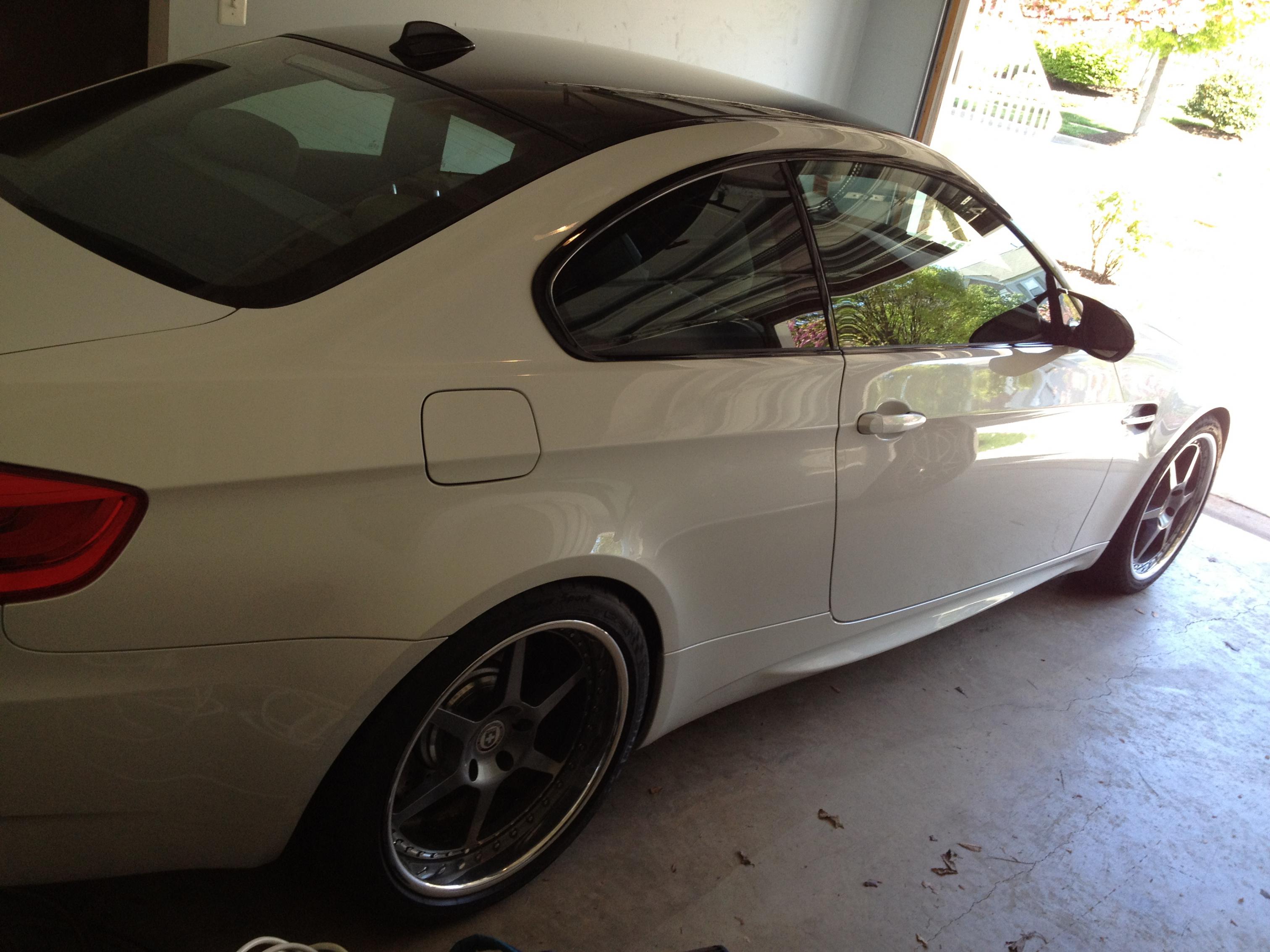

I found a picture on the forum that’s very close to the forward rake for a e9x M3 (e90 in this case). My f82 pic was taken on an incline so the rear is raised a bit. It would look similar to this on a flat surface.
Very helpful!!! Hopefully you can see how low my car currently is. This is making me feel much better moving forward with the new/reco'd setup. I am heading to Barber in February with Chin and that track you need your setup to be in the right window as the back part of the track is fast with lots of elevation change, especially turn 11.
Front physically looks higher than the rear even though you reco it to be 3/8th to 7/16th lower than the front. Is it just the way the fender is cut?
If you’re talking about the e90 M3 then, yes, the front is a bit too high but it’s a decent representation of how you’ll end up having what appears to be a higher front gap compared to your closely equal front and rear gaps. I’ll see if I can find a better image. It’s also a bit deceiving because the front wheel fender cutout diameter is larger than the rear wheel fender cutout diameter which can alter the way the two fender gaps end up looking relative to each other. My f82 rear sits lower and is close to being tucked compared to what is shown in the picture I included. Also, once you set the forward rake using the two jack pad chassis points, the cross weight correction could turn each height adjuster a different amount, for example +/-1/4 turn to +/-1 turn at the rear (the front height adjusters may have more turns than the rear divorced height adjusters due to the different motion ratios). Once the cross weights have been dialed in, you’ll most likely have different ride heights on the left and right sides.

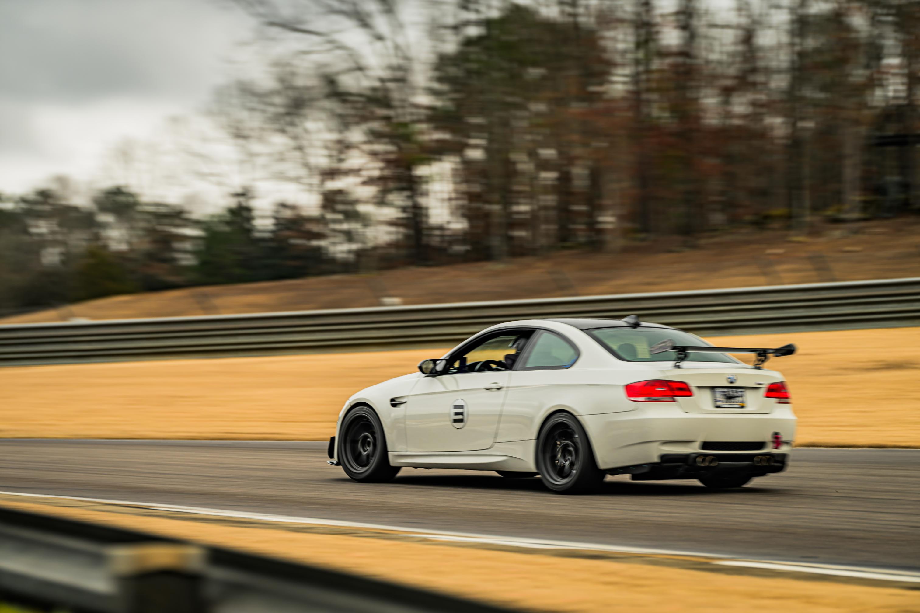

Back from Barber and wow the car was SO much happier with the ride height. Car performed splendidly and had zero issues all weekend. This track really shows the need for stiffer springs but I already knew that was an outage to be tackled this offseason.
Video and pics will be incoming, can't thank all of you enough for the help and engagement!
Rubin
      02-25-2025, 09:47 AM   #20
former 240 s14
former 240 s14's Avatar
559
511
Join Date: Jan 2007
Location: Cincinnati Ohio
Rear facing video:
Front facing video:
Great weekend, the rear facing video truly shows the need for stiffer springs but the improvement by just adjusting the ride height and shocks was unquestionable.

Wow, I never actually realized how much angle of attack the front canards have. For some reason, I always thought they were way less aggressive in terms of angle.
Car looks great out there, and the videos are awesome!
Thank you! In response to the canards........I see all sorts of angles but any more aggressive than this setup bring little to no value IMO.
Car ran 1:38.x's all day long with traffic and very cool temps (mid 40's Sunday with heavy wind and cloud cover.) The brakes had a hard time staying in their operating window (DTC-60 and AP Essex kit) but luckily I am very aggressive in brake zones naturally, which helped.
