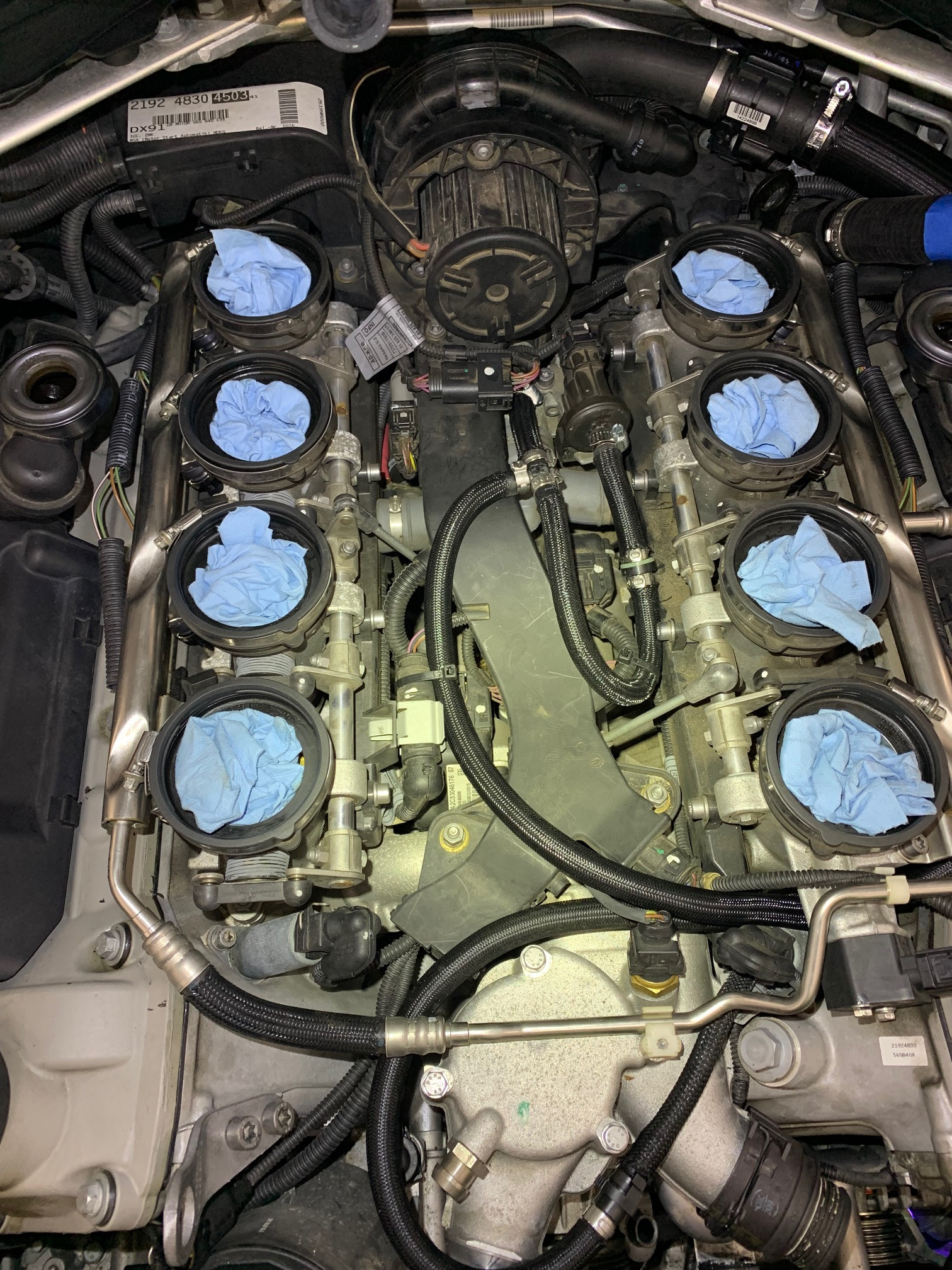

Pre Installation Prep:
Take your time, removing the intake box and plenum was straight forward. Disconnecting the Idle stabilizer from the intake manifold can be tricky but just keep at it.

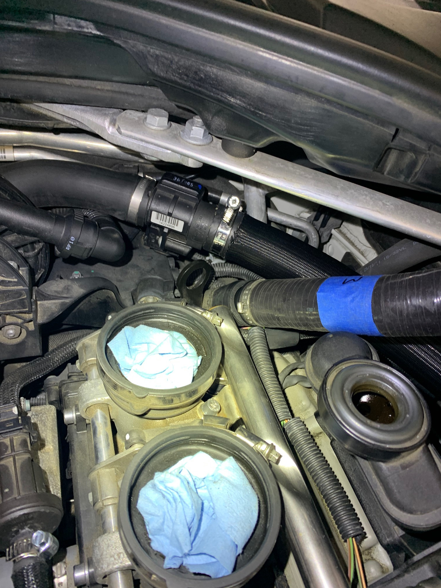

Separating the snorkel in the back from the air pump at the pressure sensor was tricky, a lot of people end up removing it and find it easier to work on. I used a blow drier and was able to remove the hose after some finessing.

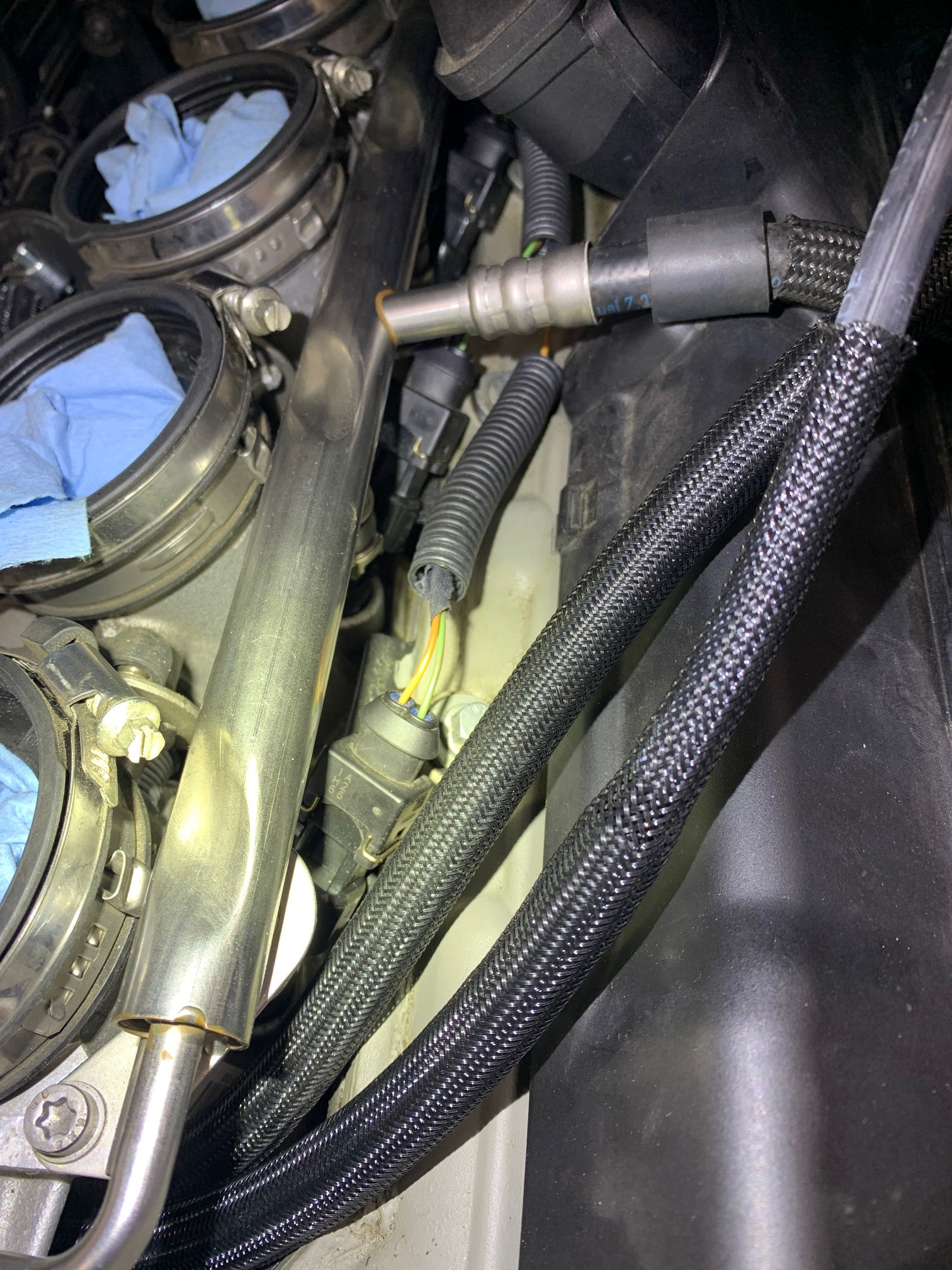

ID1050 Install
I wasnÂ’t able to find much help on this install so I just kind of used my imagination. The injectors I got were plug and play so hooking them up was no issue. However I couldnÂ’t plug them in due to the plastic covers on the plugs preventing me from pivoting the wire. I just removed the plastic covers and was on my way.
Putting the plenum in place with all of the hoses behind it was a little tricky, I just shoved hoses back behind the air pump without kinking any of them and then gently used a mallet and placed the plenum in place.

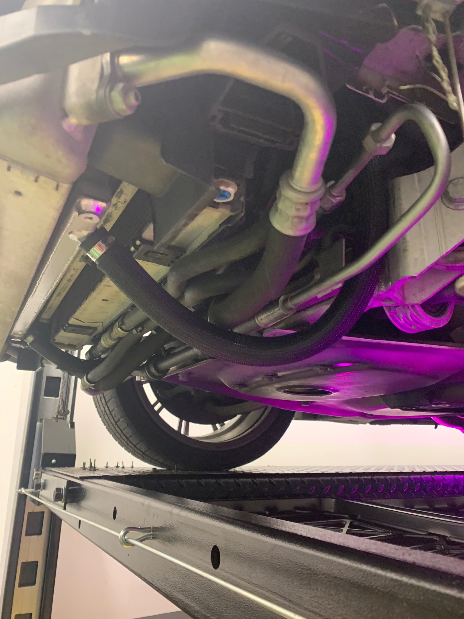

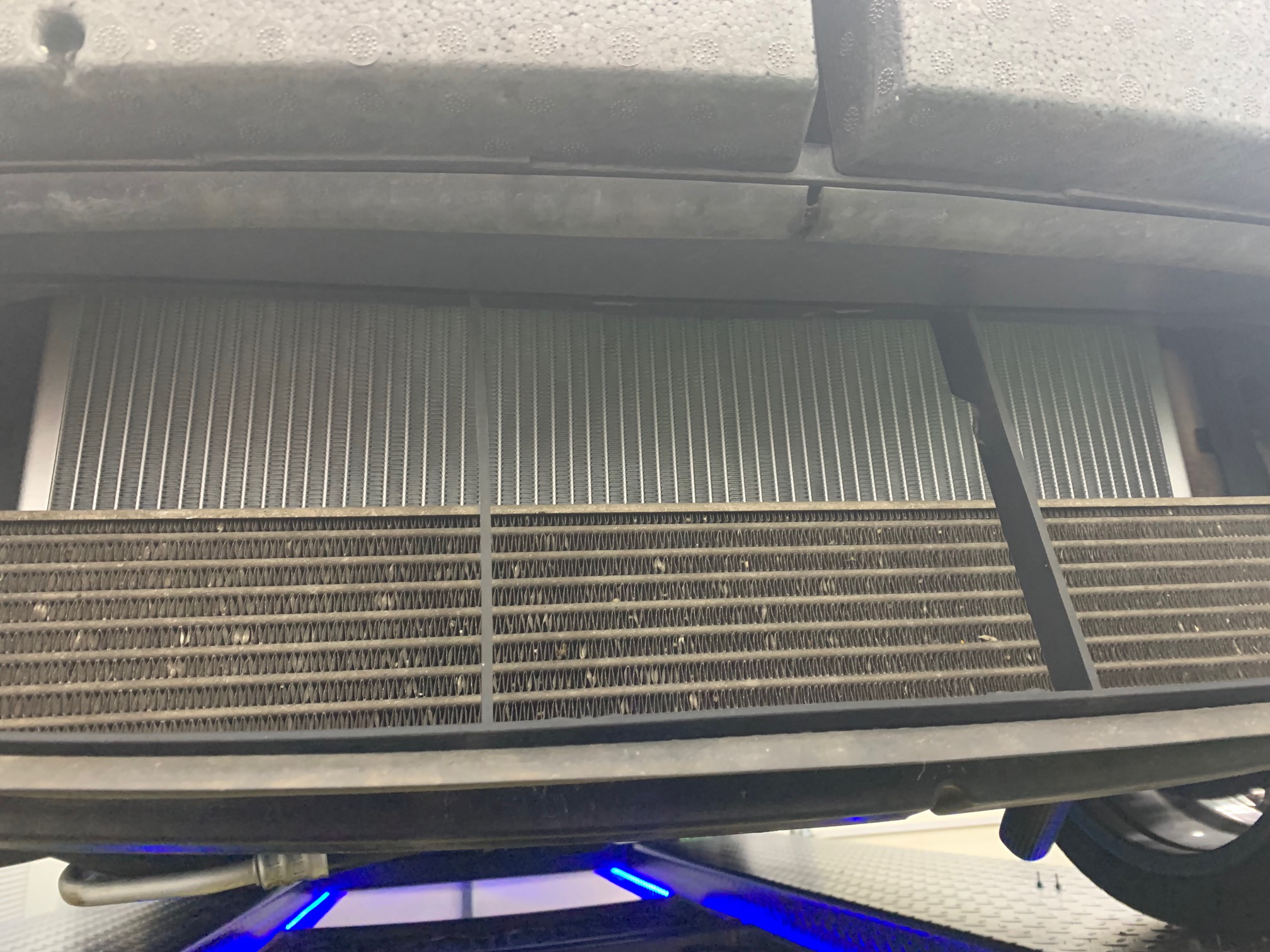

Mounting the Race cooler wasn't too bad. The bolts and bracket VF sent me were too small (maybe they fit better on a e92). I used longer bolts and spacers to make it all work. Mounting the hoses to it was a little tricky trying to get them not to kink. IÂ’ll probably add some more zip ties to keep the hoses from moving too much or rubbing too much.
