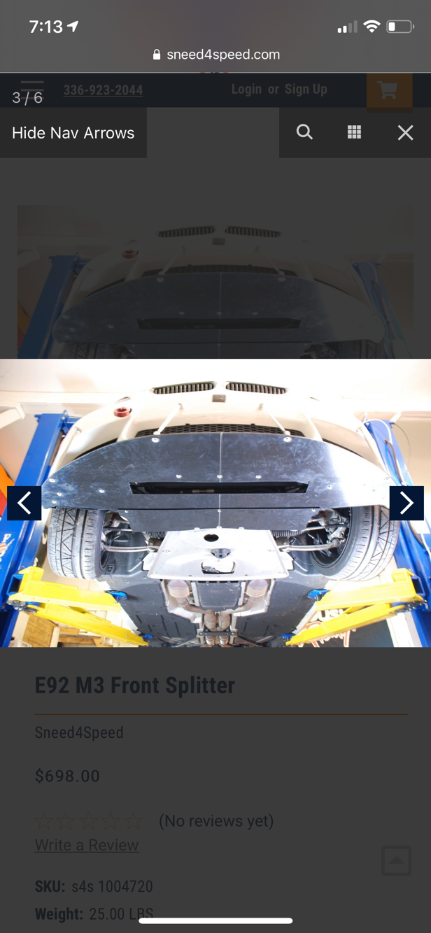

Anyone have any experience with their wing & splitter. Claiming over 400lbs of downforce on a 63" 3D wing, and 3" splitter. Seems like a well balanced and purposeful aero package and they have access to a wind tunnel.

it doesn't look terrible, but i'm a little skeptical of the "400lbs of downforce" claim. its not chassi mounted and the stanchions only mount to the plastic bumper. you're also loosing a significant amount in the gap it creates in the lower curves of the bumper.

I sent them an email about the efficacy given the gap, and to get more specs on the wing to compare to APR. I'd assume most of the referenced downforce is generated at the rear?
The splitter bolts quite far down to the aluminum engine shield cover and replaces the under tray. While not chassis mounted my Mporium under tray is pretty rigid / secure. I'd imagine all those bolts are more than sufficient to effectively support the generated downforce?

those gaps are what i dislike the most. once you lose the seal that the undertray provides, you introduce pressure behind the front bumper and i feel like you would lose some efficiency of the oil cooler and main cooling system.
when i had my apr front splitter, i went through the front bumper for supports and used large washers to spread the load, and they were mounted in the direction of the pull, rather than the 90* mount on the front face of the bumper.
the problem i had was my flat apr was a similar design, and i was running an older oem undertray. once the undertray was just a little compromised, the air pressure between the splitter and the bumper took care of the rest and destroyed it completely. after this, i've been pretty mindful of the gap.
i'm running a cheap gt4 splitter without any brake ducting until i return to optimize the front aero of this car again.
i'm probably not going to run a gt4 style lip, but instead run a gts style lip that seals the gap and construct some kind of 911 style scoops for front brake cooling.

Air is a fluid though, it should get pushed up by the splitter and then through the holes in the bumper. I doubt the little gap will be a problem, but I am not an engineer in that sense

its relative, i suppose. this becomes hair-splitting and nit-picky... if i could chose not to have the gaps- i would chose to not have them.

Agreed! I think a lip or brake duct solves that.

Majority of that downforce claim, regardless of it's accuracy, comes from the rear wing. A splitter that size contributes little to that total claimed amount.
And it sure ain't worth 700$ LOL

Pass. Weaksauce for that amount of cash. The splitter doesn't even have tunnels. What self-respecting shadetree aerodynamicist builds a splitter without tunnels these days??
Also, without a lip to act as an air dam at the leading edge of the bumper your highest pressure region (where the air meets the surface which stops it) moves back into the gaps and to put it simply - it pushes up on the bumper and down on the splitter. So the highest pressure region effectively cancels itself out in terms of vertical force. You want to keep the high pressure region out on the splitter where there is only open air above it, thus giving you downward force and no upward force.
