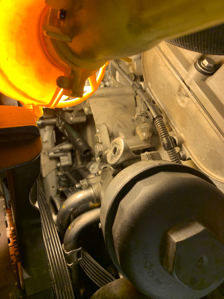

Got it close, but I'm not clever enough to get the PS pump all the way out.
The suction line is still attached to the pump and I can't tell HOW it's attached.
Anyone know the secret handshake to get the suction line to let go of the pump?

I did find that, but it doesn't have any details about the best way to get at that clamp (Item 3).
It is really buried.

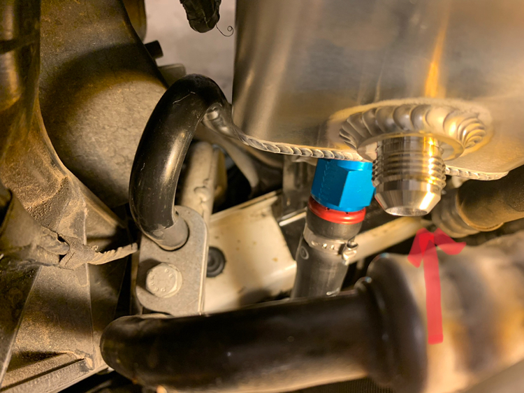

Maybe disconnect that line from the other end....
If you can't reach #1, then maybe try and disconnect from #2 (not sure how accessible this connection is) or #3 (this connection is under the PS reservoir)
I would "guess" #3 removing the pipe from under the reservoir body is the easiest solution. Although #2 has a bolt that will need to be undone somehow. Link to
bolt

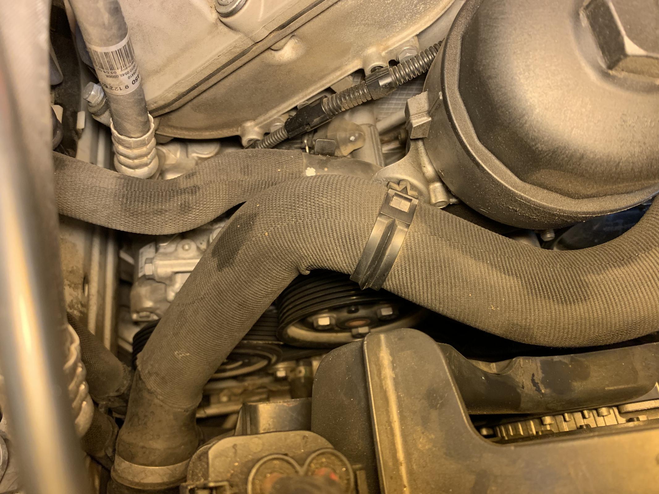

I got it.
I didn't realize that the A/C belt tensioner is what the pump was hanging up on.
Once I removed the tensioner, I was able to get at the clamp.

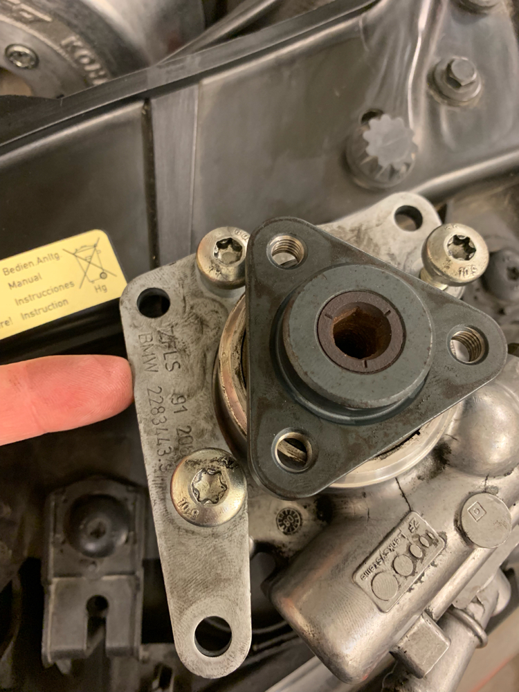

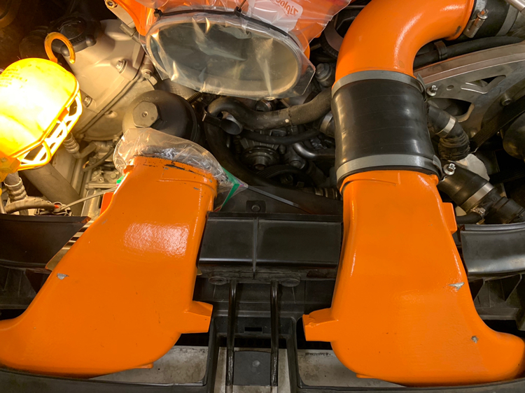

I had to remove the pump mounting bracket (held onto the pump by 3 torx fasteners) in order to wiggle the pump out the bottom of the car.
Slight points deduction against G-Power for their 1 piece intercooler design. Impossible to remove the fan assembly with the intercooler in place. Can't remove the intercooler without pulling the front structure off the car.

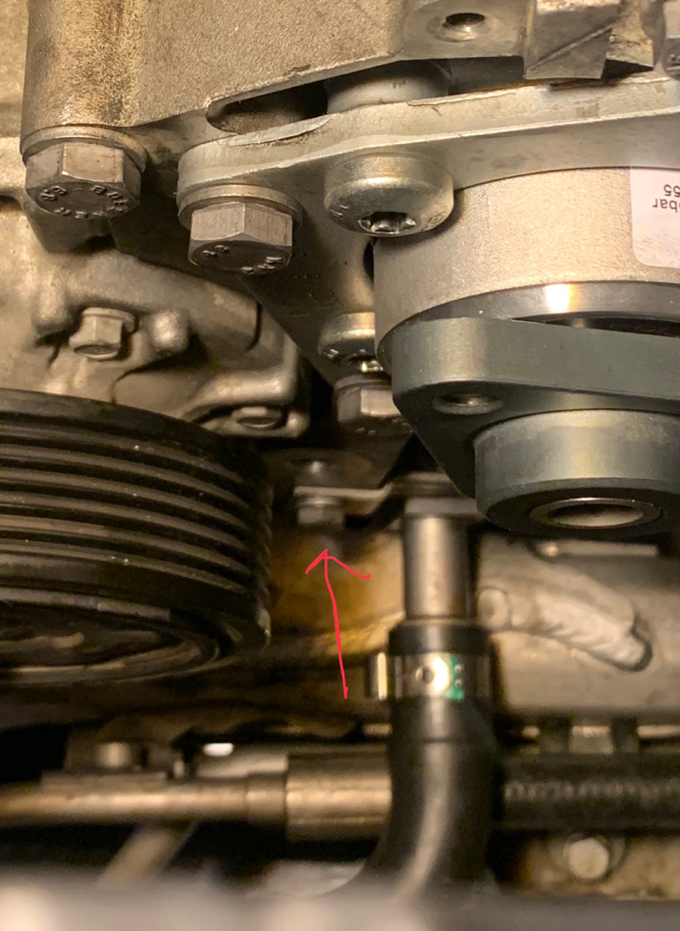

After I got the pump out, I removed this fastener and pulled the Suction hose assembly out of the car.

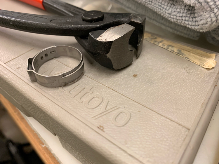

I removed the pump mounting bracket (3 Torx fasteners) from the new pump.
I used a 24.1mm Oetiker clamp to attach the Suction hose assembly to the new pump.
Chris,
2008 E92

Then was able drop the entire assembly in from above, past the fan.
Wiggled the pump/Suction hose assembly into its approximate place, then re-installed the pump mounting bracket onto the pump with the 3 Torx fasteners, then bolted the pump mounting bracket to the engine.

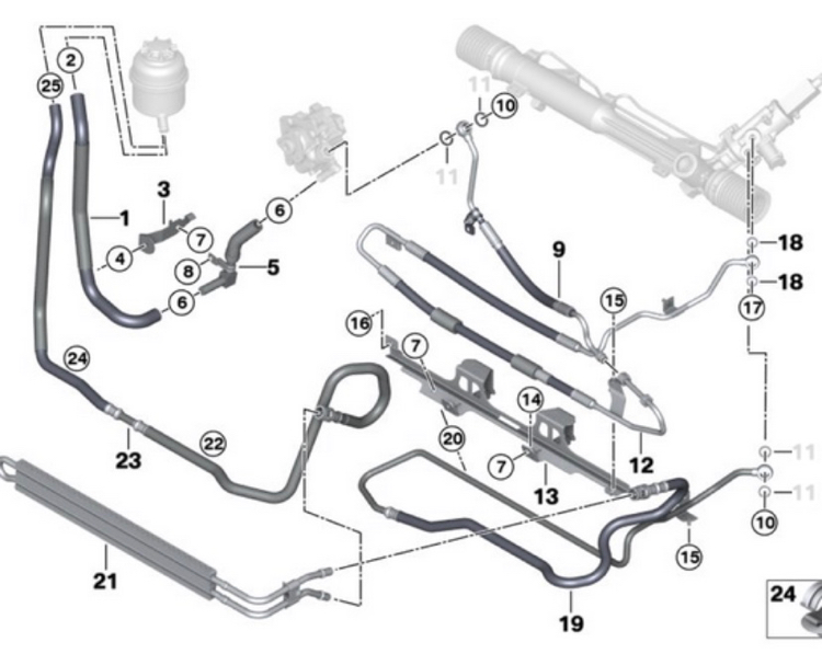

9) Disconnect PS pump suction line (4) from the reservoir (use your oil catch pan).
Disconnect the PS cooler return line (24) from the PS reservoir (totally baked on Mofo).
Unclip both lines from each other and under the front of the chassis and let drain into oil catch).

14) Remove the HHCS (8).
Remove the banjo bolt (10) and the two crush washers (11) from the pressure port of the PS pump.
Remove the three Torx fasteners that retain the PS pump mounting bracket to the pump.
Remove the three HHCS that retain the PS pump mounting bracket to the engine.
Remove the PS pump/Suction hose assembly.
(It was necessary for me to remove the mounting bracket from the pump in order to wiggle the pump out past the fan assembly)
15) Note the orientation of the suction hose assembly relative to the orientation of the pump.
Remove the clamp (6) that retains the suction hose to the pump and remove the pump from the suction hose.

Using the tensioner, reroute and install the A/C and PS pump belt. (I found it easiest to have the last loop be over the A/C pulley).
Tighten the three HHCS that retain the PS pump pulley to the pump.
8) Reattach the radiator hose clip to the oil filter housing.
Reattach the radiator hose end to the water pump housing and clip into place.
Reattached water hose end to the expansion tank and clip into place.
Reinstall the blue radiator drain plug.
Refill cooling system.
Install the intercooler/intake boot.
9) Test: Even though I went thru the PS flushing process and topped off the PS pump reservoir, I wanted to fire the engine and cycle the steering hard stop to hard stop to work out any air that might still be in the system. The level didn't noticeably drop, so 2 thumbs up on the flushing process by Bushum.
I also wanted to run the car to check for any PS fluid or coolant leaks.
10) Reinstall the aluminum skid plate, the nose, fender liners and front wheels. Remove from jack stands, torque the lug bolts, and test drive.
Recheck fluid levels after test drive.

New pump is on but om still getting a leak I believe its from (10) in the picture above. Does anyone know the torque spec for 10?
