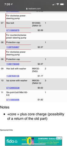

2011 BMW M3  [9.34]
I think this is what you are referring to

There is something I didn't tell you, so write it down.
I'm using an underdrive pulley(TMS).
If the steering pump before 05.2008 is used, the diameter of the underdrive pulley that rotates the steering pump can be used in a smaller size like the pulley that rotates the alternator.
The underdrive pulley for PS pump after 05.200 is actually a half underdrive pulley. Because the diameter of underdrive pulley that turns the steering pump is the same as stock.
