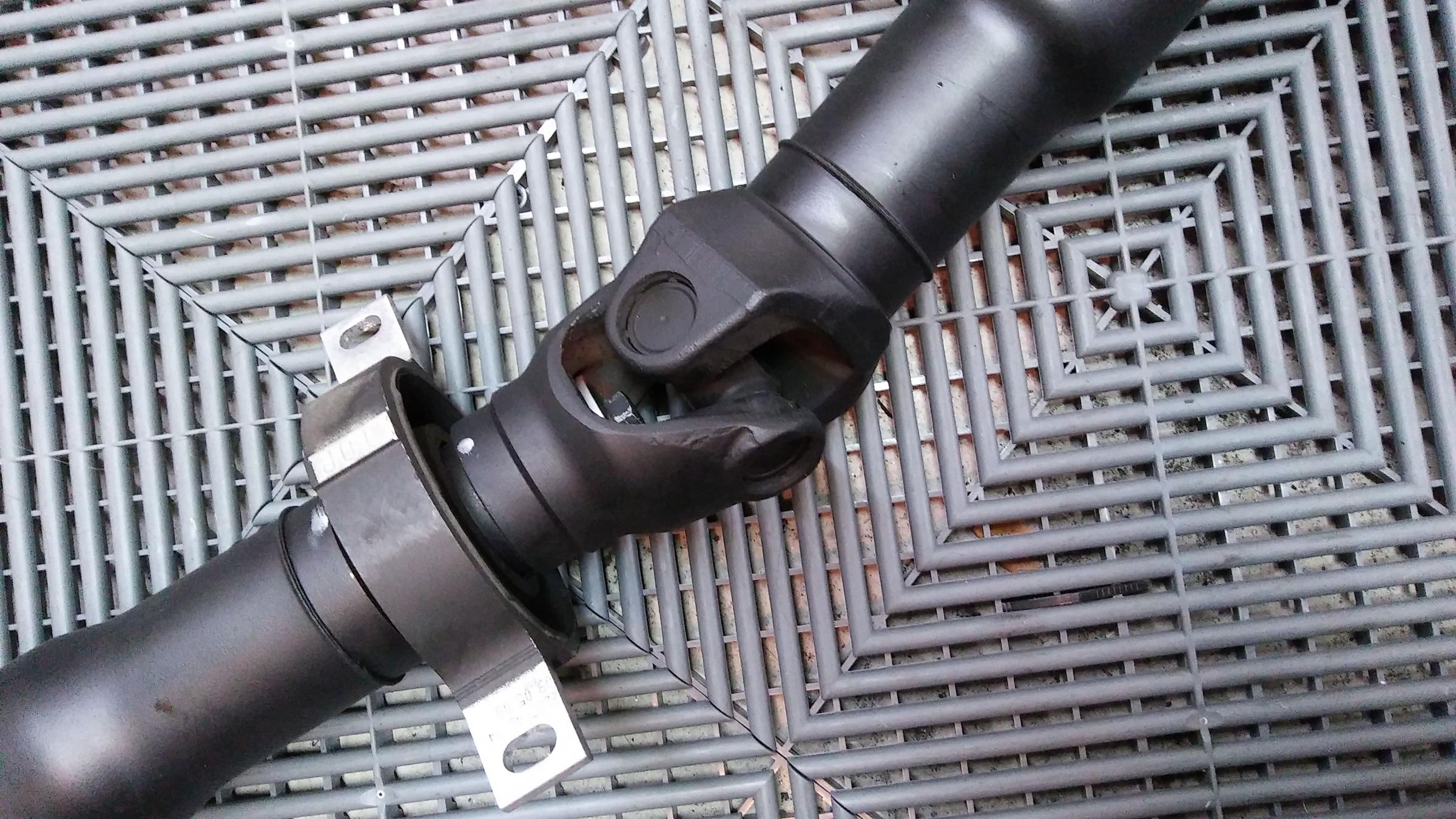

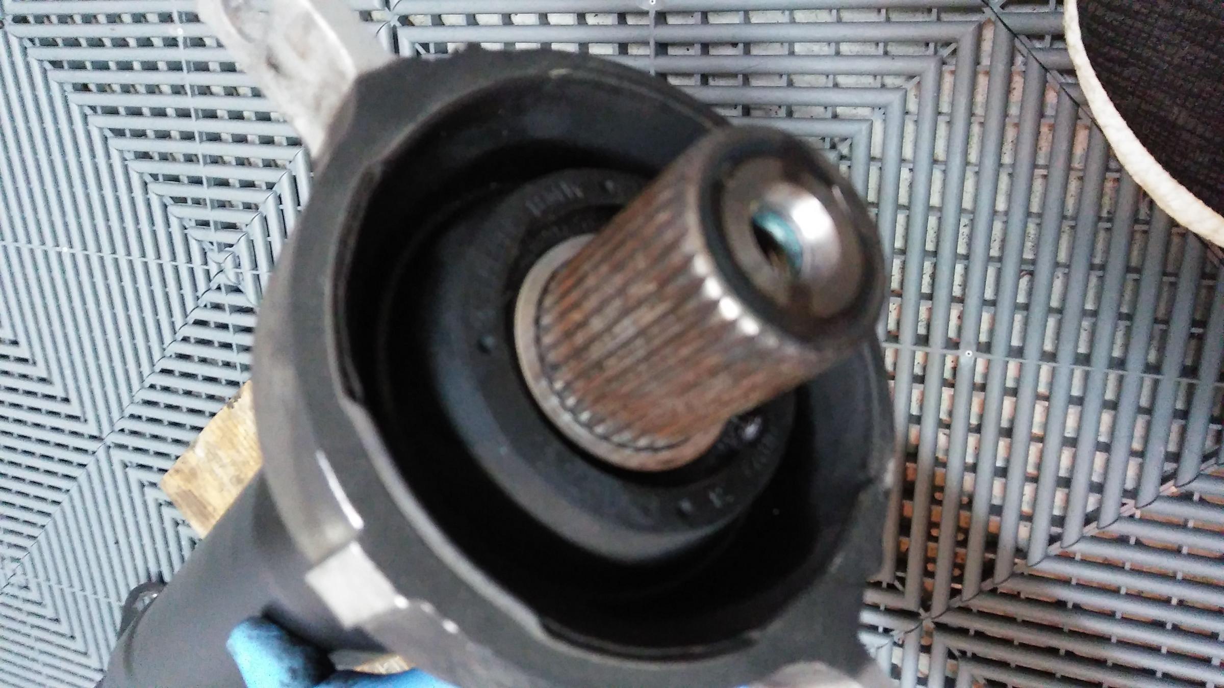

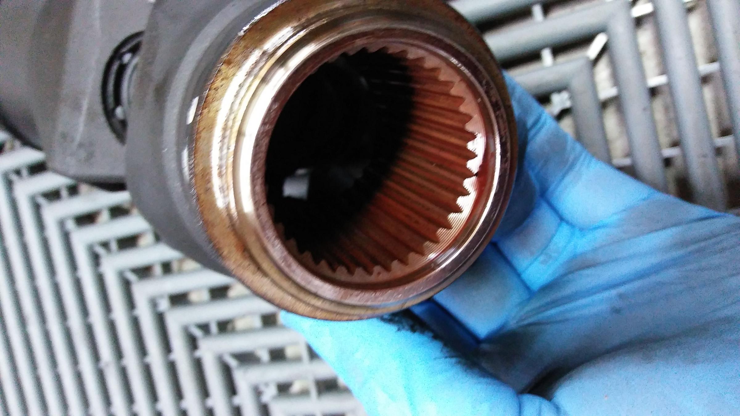

Hey guys,
Let me start with how the driveshaft start making the noise at 42k first. I had a Differantial input seal leak and I bring my car to my very good friend Trevor to fix the issue. I nail the seal with the soft hammer to align perfectly and I realized after a week that leak is still there which means i didn't align perfectly : ) and I decided to get this amazing tool (later on I got couple of them and give away for my very lovely BMW tech friends) the Miller Pinion Seal Installer 8891.
And yeah it fixed the problem, But after the fix I start getting this driveshaft tickling sound real bad. It ticks everytime I engage the 1st or 2nd gear. Or Reverse! So it really gets annoying!
And one of my very experienced friend Talha from Turkey mentioned to me that, if it is tickling there is an easy fix!
He told me you need to remove the nut that is located U Ball joint area and separate the driveshaft from the half and heavily grease and put it back together. (Note : The most important thing in this process is put a mark between this 2 piece and put it back to same exact place otherwise you will get vibrations, If you look at the first picture you will see the white mark on both side, later on I also put another one to make sure it will go back to same place)
Well, that's it. It is brand-new again! Noise is gone and beast is all quiet except V8! (Driveshaft looked literally brand-new when I removed)

Great. Looks like it was dry in there.

Yes it was just dry and I don't know if it comes from the factory greasy or not. But I am glad my u ball joints was just fine and the problem related to this little guys!

Can you elaborate or be a little more specific with: "remove the nut that is located U Ball joint area and separate the driveshaft from the half and heavily grease and put it back together."
Also, the links to your pics are missing. I have my DS exposed. I'm installing a short shifter kit, but glad I remembered about this thread. I did an initial check of the DS and didn't feel any play. I plan do a more thorough check and also grease it regardless of finding play or not because I won't be replacing it just yet if there is play. I figure the grease would at the minimum be an interim solution.

Photos re-uploaded! You will see the nut at the first picture that needs to be removed! And other pictures show you where to grease. #Cheers
