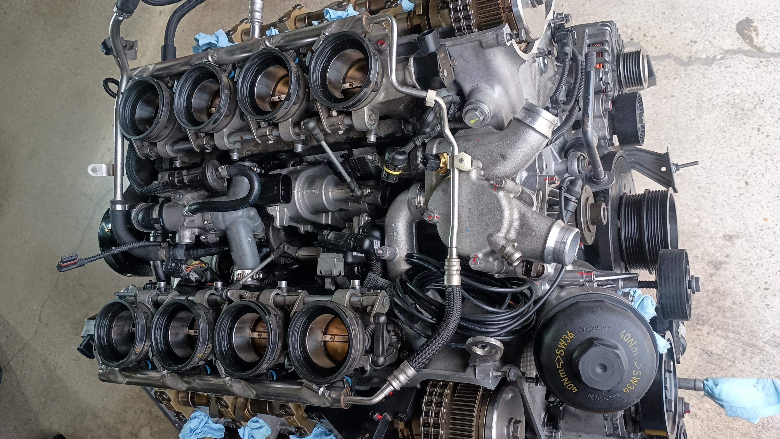

I did this with my new build. I have the BW Oil Distribution Block, Lowdollar Motorsports Pressure Sensor and harness, and AEM Oil Pressure Gauge.
The aftermarket pressure sensor will fit right behind the water pump pulley, no worries there. You will need to clearance the plug of the OEM dummy switch to ensure it fits.
