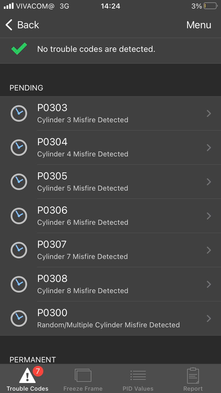

Missfire
I have the same problem only on low trottle but with interval of 300km 400km.
When i off the car and all is okey after 300km 400km come again and evrytime same cylinders .
In my case are 4 5 6 7 8 cylinders.I think maybe is exhaust gasket.
