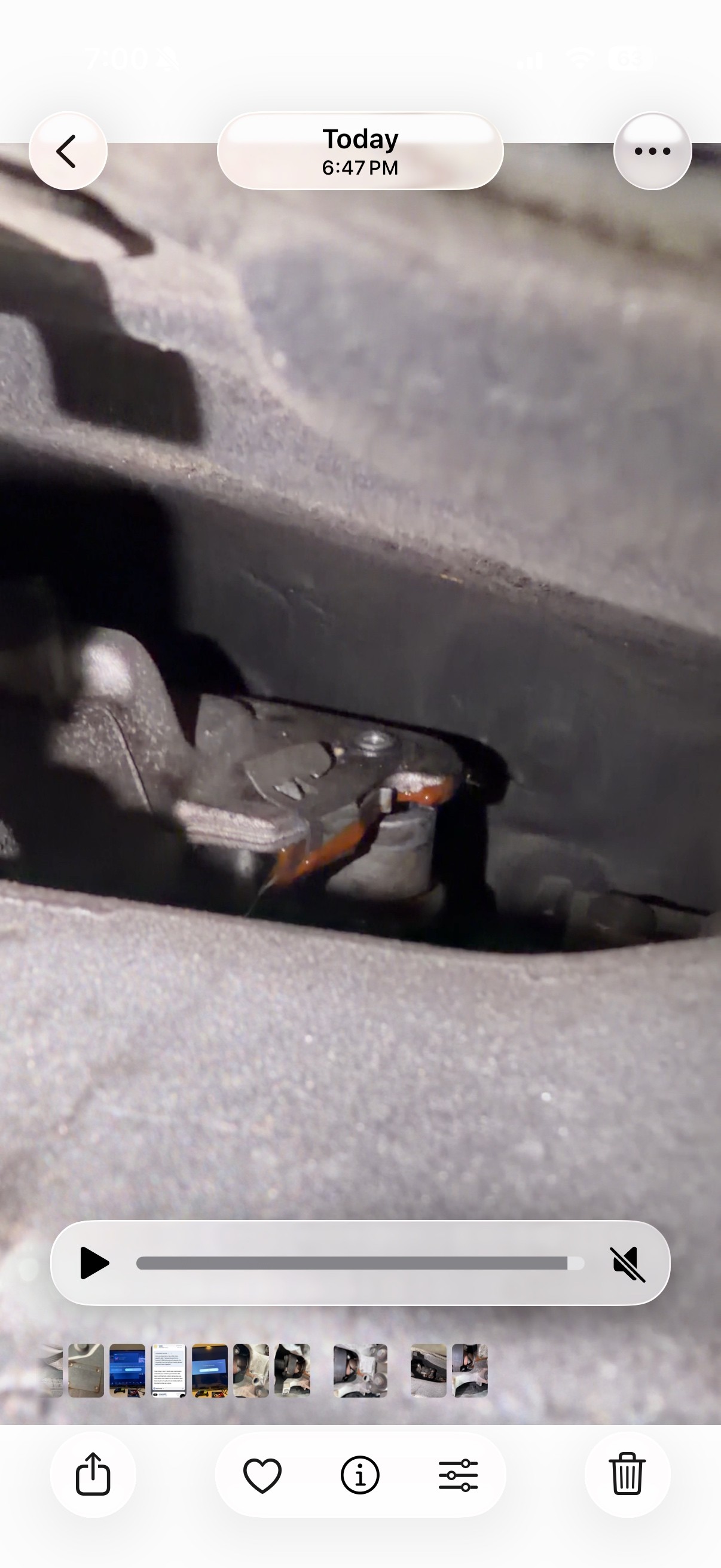

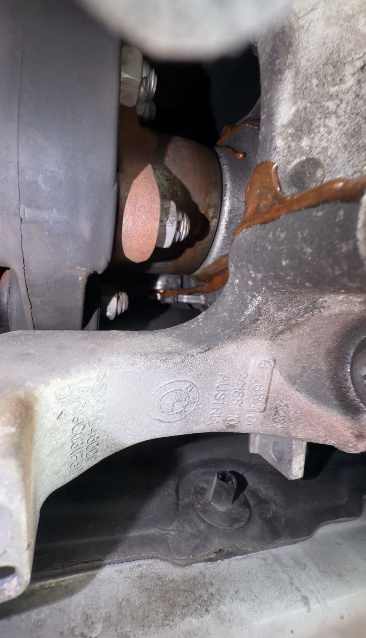

Bringing up an old thread. Is this what is leaking on mine? Was switching out trans mounts when I noticed some brown goop on the inner part of transmission cover and then saw this ooze. Looks like it wraps around both sides.

Nevermind it appears to be some sort of adhesive that PO put on to prevent shifter linkage from backing out or something.
