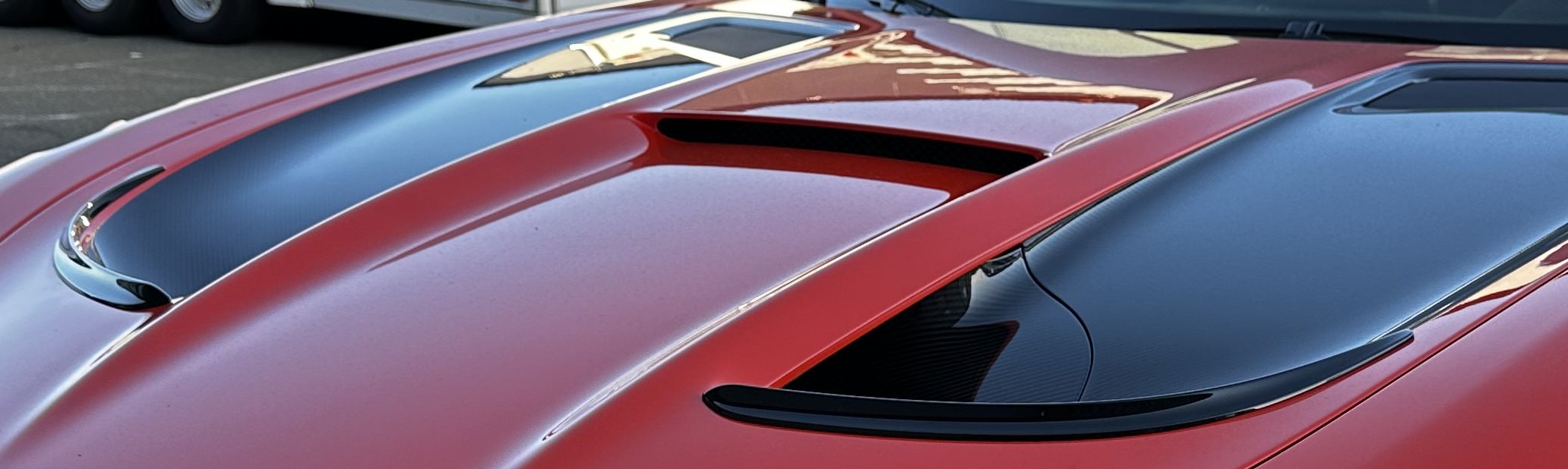

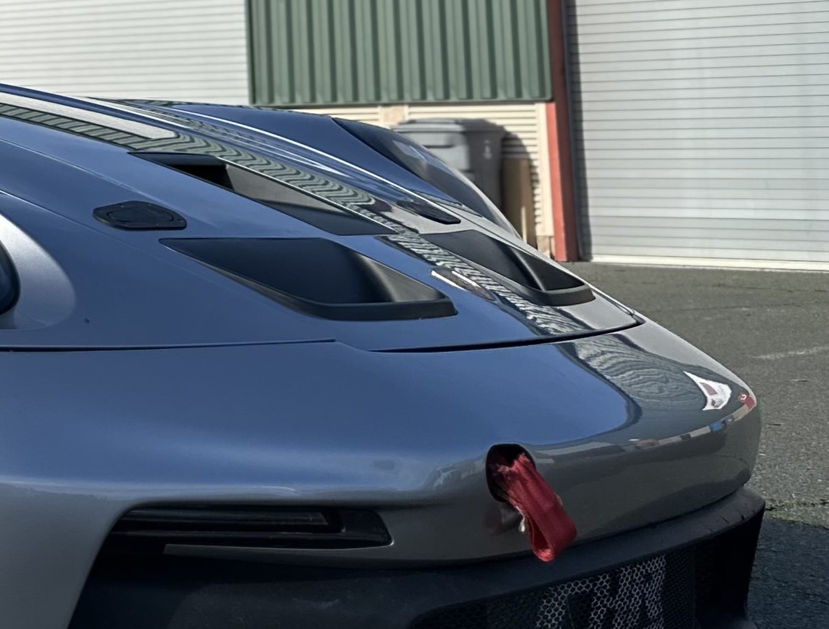

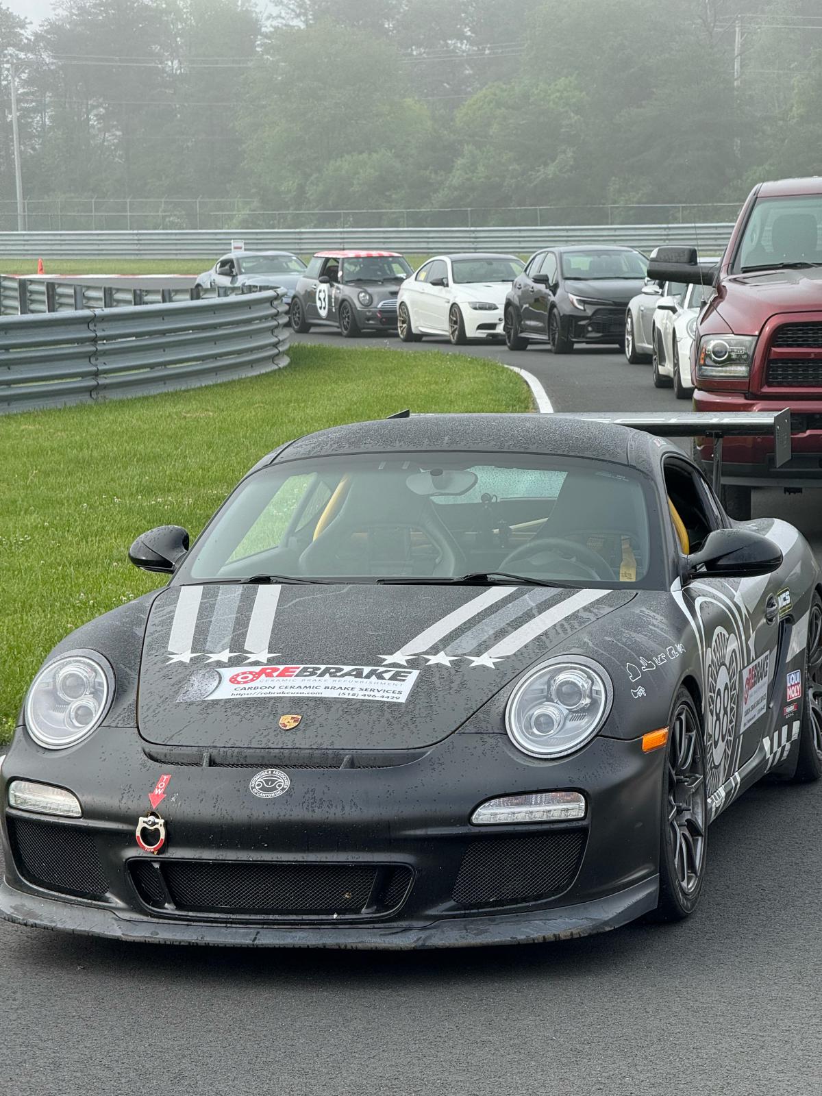

Why the one over the other?
because race louvers have more R&D and are more efficient. I don't mean this condescendingly but go to a GT4/3 race paddock and you'll see almost all of their hood vents have gurney lips at the leading edge of the vent to promote ventilation. Even on some super high end street cars you can see this, like the black series in the photo or the new GT3RS. The cup car in the photo has these lips as well.
Trackspec vents look better imo but don't have the lip and their actual vent design seems generic, compared to the louvers which have more angle as you move across the vent.

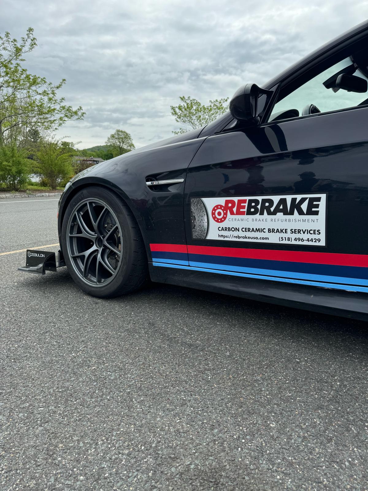

Reveived the car from Autocouture and being doing test drives to get familiar with the new suspension after JRZ rebuilt.
Feels good. I was supposed to do a first trackday April 6th at PMP but hurt my back and had to give that one up.
My first test on the track is then setup to be April 22nd at LRP.

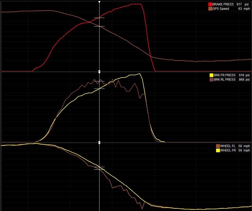

In addition to overall shaking down the car, I am also testing Rebrake Friction Layer (RFL) on my front left. The front right is the original carbon ceramic (Brembo CCM-R)
So far it looks like the RFL is getting to ABS sooner than the original CCM-R. At about 700psi.

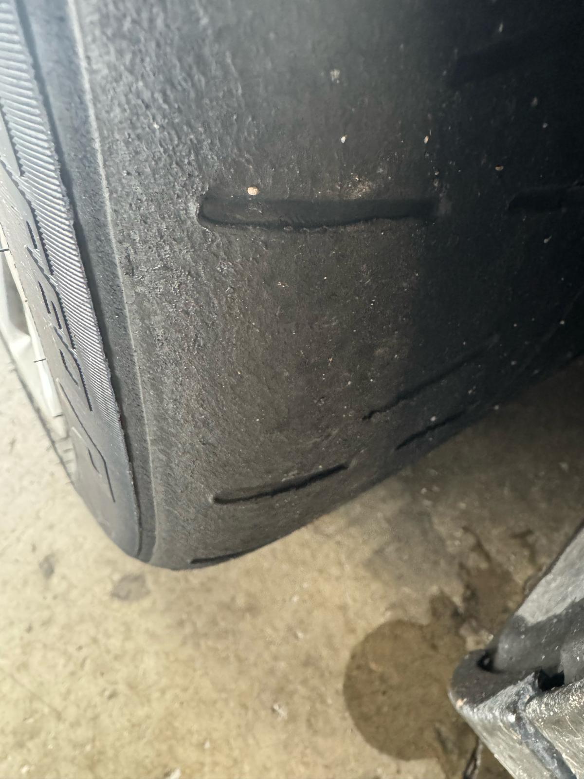

The 7 days at WGI and 1 day at LRP were on last year Pirelli Corsa 305/30/19 and 285/30/19. I like both the size and the Corsa Asym 2.
2 days at LRP on 2017 MPSS 295/30/19 and 285/30/19 were fun but not quick. 61-63 range
1 day at LRP on 275/35/19 PZC4 and 265/35/19 Trofeo R was fun at LRP and got into 59sec range. But the driver side front wheel bearing was toast. Got a new one from Core4 and installed already.
The current issue being chased is a small coolant leak someplace that requires adding coolant after a track day. No leak or evidance as to were it is going. ACM is investigating.

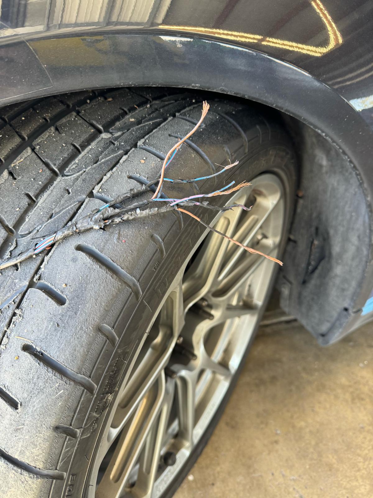

The 265/35/19 Trofeo is a monster size and it ate the harness that connects to ambient temp sensor and horn. I can do with out until ACM will deal with it after the coolant mystery is solved.
In the mean time I am enjoying driving other cars such as Cayman S, Cayman GTS, Cayman Clubsport, Cayman GT4 and Mustang. all different and all fun on their own right. But my love is reserved for the E92 M3.
Some pictures to enjoy

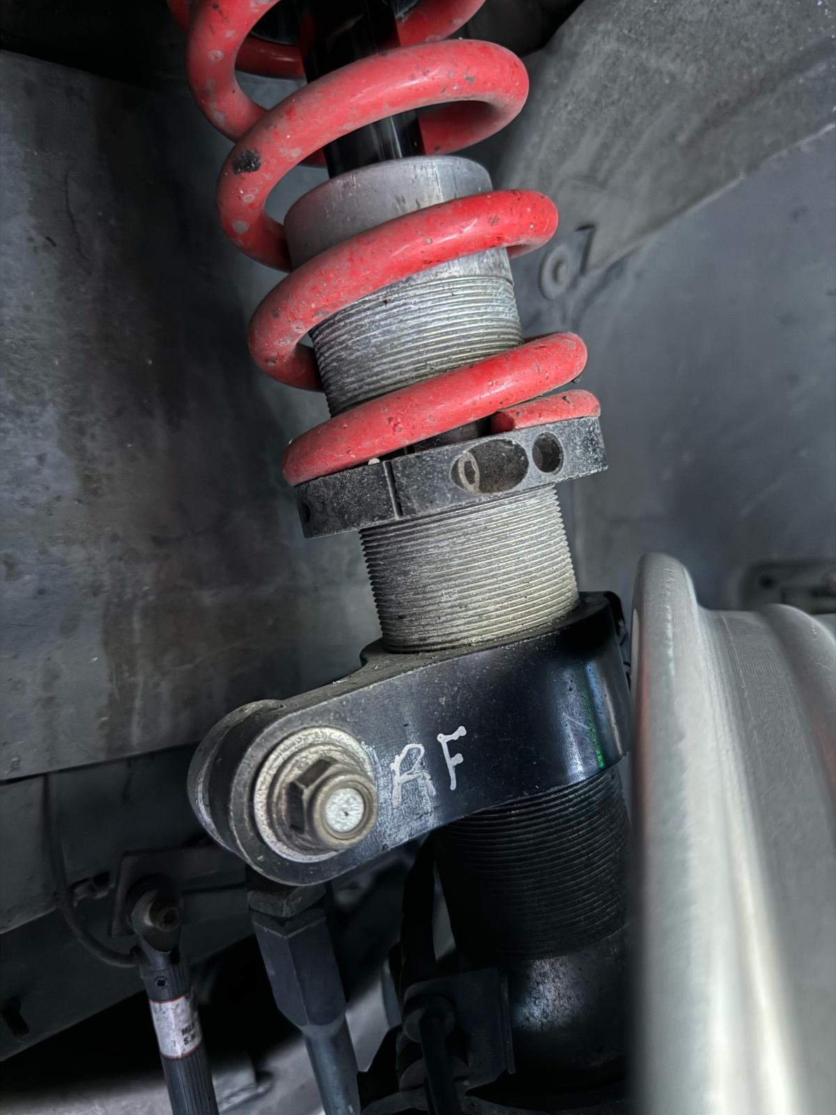

19x10” fits.
Formula 1 tolerances
No rub so far
I have 3mm spacer on standby, just in case
