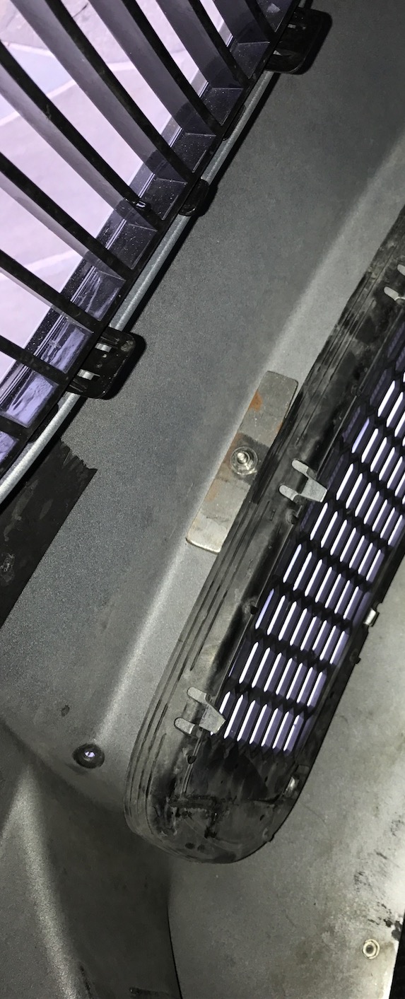

Finally getting to add some front aero to the car. T1 in SCCA does not allow more than 2" past the vertical plane of the bumper or dive planes - unless the car came from the factory with them installed. This means that I pretty much cannot run any front aero during those races - but all the factory race cars can (and do). At least in NASA we get to run both a decent size splitter and the canards.
The material we are using is Tegris with a thickness of 0.250". This thickness does seem like it will be rigid enough but have yet to test it out. If need be we can go to 0.400" in the future. It's light and easy to work with, so hopefully we are happy with the results.
As of right now we are avoiding mounting to the chassis. We feel like we can secure the lower splitter adequately without have to go that direction. Had a good chat with dogbone about this and we are hoping to replicate his positive experience with the splitter mounted in this fashion. The main reason we are trying this first is to hopefully limit the amount of collateral damage in the inevitable event of breakage.
Shape and length are also a work in progress. Our highly scientific and 100% infallible testing method with a smoke machine and an air gun has provided valuable insight up until now - so needless to say we need to get out on the track and see what happens.
*Don't mind the angle of the canards - they are not completely fastened down yet
**Also updated the OP with the current build specs
Looks great! Splitters are so beautiful when they're new!!! Mine is beat to hell......but that is a testament to the fact that it actually has actually survived since 2015! And that means going off track many times. I'll replace it after the East Coast journey.
Not sure if you sorted out the details for the splitter support rods, but the top end of the support rods on my setup are supported by a metal bracket on the inside of the bumper to help spread the load out.
This is what my friend's looks like on the inside of the bumper. I just saw the inside of my bumper at COTA when we installed the headlight blanks. My metal bracket may even be wider.
With that front aero, you will start dealing with the bumper pulling down to some extent. I highly recommend those AeroCatch latches I have between my fender and bumper and get rid of the thin metal hanger clip between the two. Mine bent down at high speeds and started grinding the tire. Since the AeroCatch latches went on there----no issues.
I mounted my supports to the carbon crash beam. Also, I'm not using solid support rods. Went with cable so it would allow flex upwards without breaking the splitter (think about unloading from a trailer or going off), but still strong enough to support the weight of downforce
Why not attach things to the chassis versus big washers and backing plates? You could go a little further and attach to the rigid bumper support. It's all right there. Not much work to go a little further and take all the load off the flimsy front bumper.

i did a similar thing when i had that apr splitter. worked well, but i think dogbone is due for a front aero revamp (yea, i build out other people's cars in my head).
but yea, i plan on using the crashbar as well in the future, its right there.
