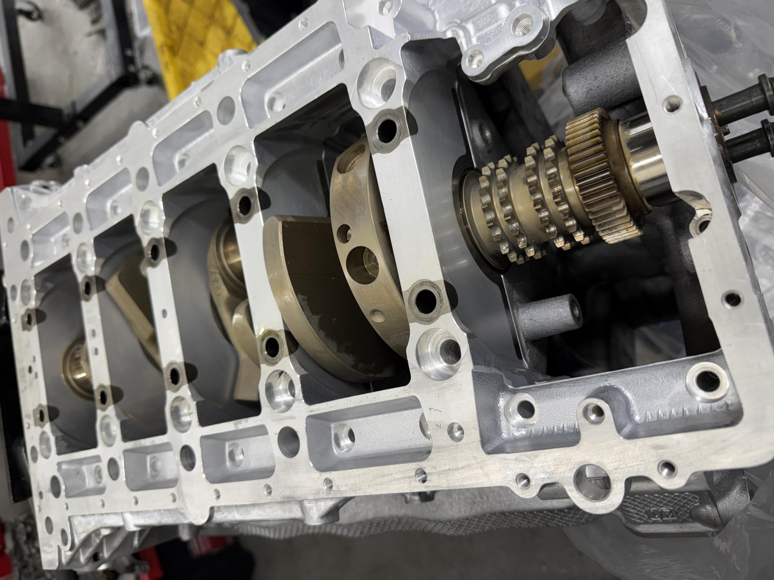

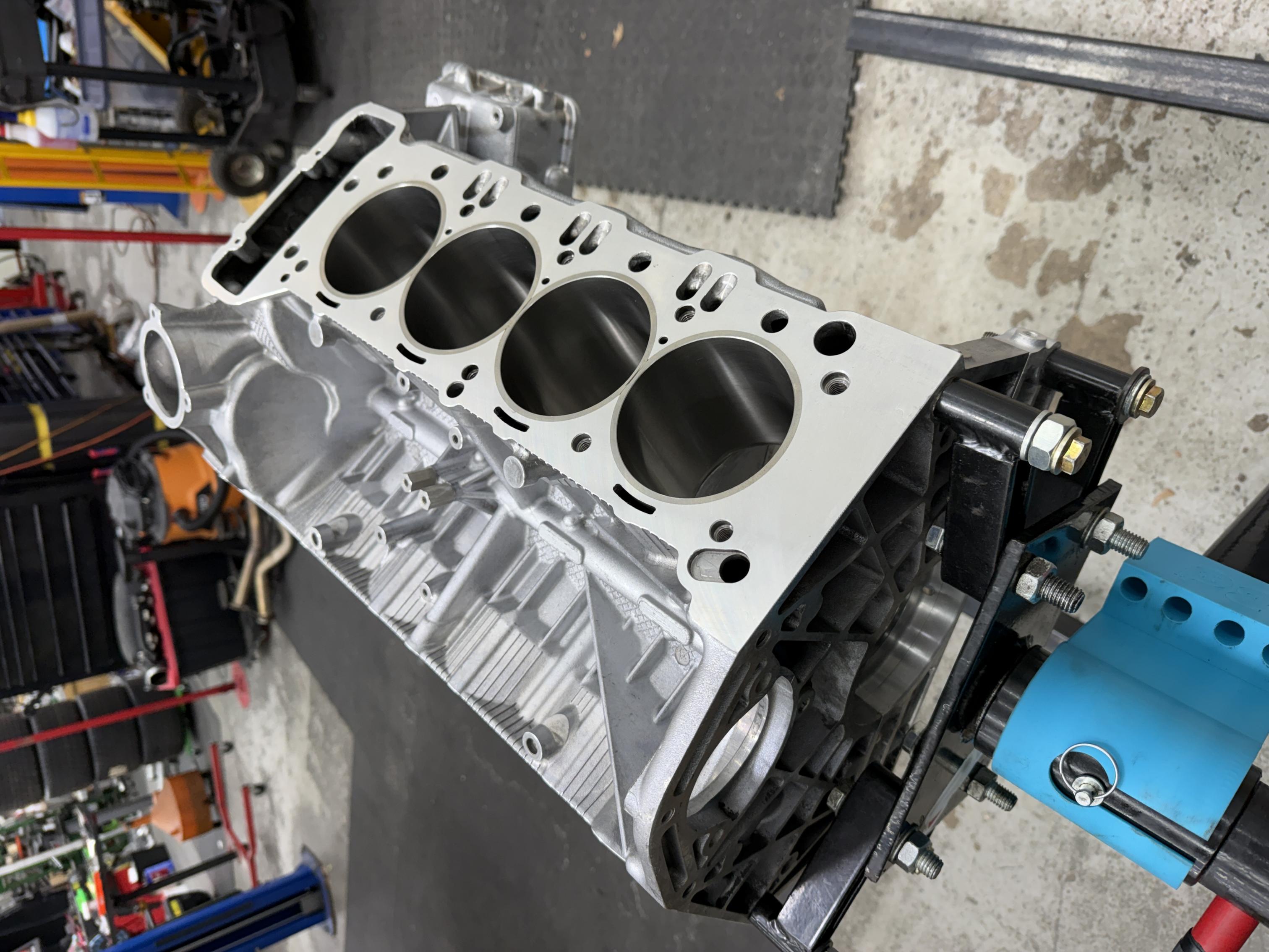

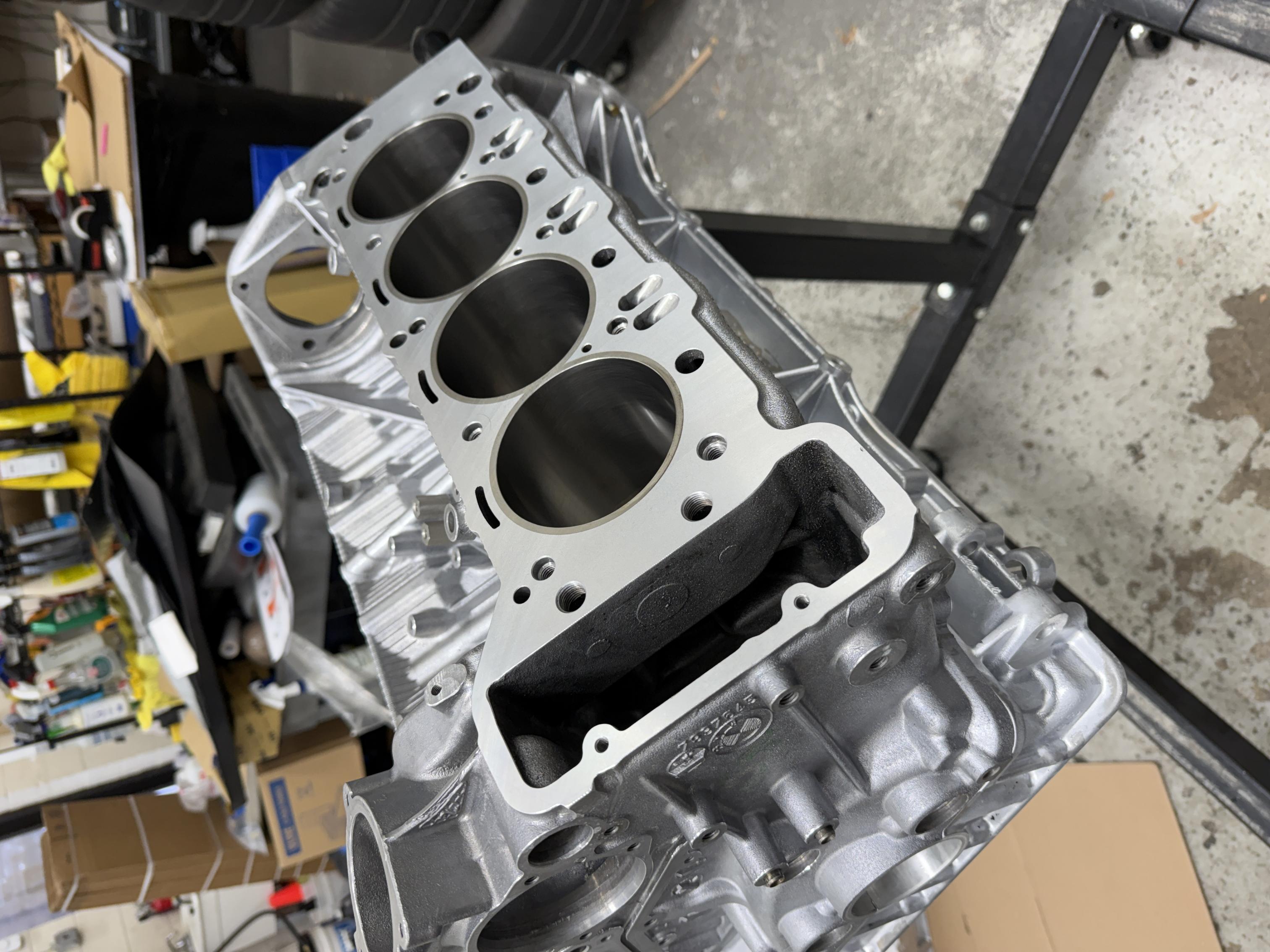

Great news! The engine has arrived to Rogue for assembly. The block and sleeves look gorgeous from what I can see. Forged CP Pistons 12.5:1, OEM Rods, and custom matched ACL (Race and Standard) bearings for mains and rods, and SRD oil pump gears. Once the short block is assembled there Ben will ship it here for us to put the heads and accessories on. More pics to come but I couldn't wait to share the news.

      02-20-2026, 09:22 AM   #79
former 240 s14
former 240 s14's Avatar
559
511
Join Date: Jan 2007
Location: Cincinnati Ohio
Build in progress at Rogue. More pics to come.
F4rmost239.50
jmeenach219.00
kolosy3480.00
PAM3Guy984.50
      02-24-2026, 08:30 AM   #80
DrFerry
Field Marshal
DrFerry's Avatar
10036
2,641
Drives: 2008 E92 M3
Join Date: Jul 2010
Location: Greenville, SC
Good luck with the build. I saw some marks / crud on one of the crank journals. Whatever it is should probably be cleaned off.... See photo screen shot with comments below.
      02-24-2026, 10:23 AM   #81
Brandoch
Brandoch's Avatar
2077
1,536
Drives: 2009 E93 M3 DCT
Join Date: Dec 2017
Location: BC Canada
That's not a journal, that's part of the long snout.
DrFerry10035.50
      02-24-2026, 10:48 AM   #82
DrFerry
Field Marshal
DrFerry's Avatar
10036
2,641
Drives: 2008 E92 M3
Join Date: Jul 2010
Oh, okay. Thanks.
      02-24-2026, 11:42 AM   #83
Brandoch
Brandoch's Avatar
2077
1,536
Join Date: Dec 2017
Location: BC Canada
Oh, okay. Thanks.
This is what I believe is a large factor in #1 main bearing failure. After #1 main you have 2 double row timing chains (BMW usually only does single row chains), then the oil pump gear, then that portion that you pointed out, then the harmonic balancer, then the crank pulley driving 2 belts.
That is a long distance without being supported with the load of the timing system and the ancillary systems.
DrFerry10035.50
      02-24-2026, 01:03 PM   #84
DrFerry
Field Marshal
DrFerry's Avatar
10036
2,641
Drives: 2008 E92 M3
Join Date: Jul 2010
This is what I believe is a large factor in #1 main bearing failure. After #1 main you have 2 double row timing chains (BMW usually only does single row chains), then the oil pump gear, then that portion that you pointed out, then the harmonic balancer, then the crank pulley driving 2 belts. That is a long distance without being supported with the load of the timing system and the ancillary systems.
Very good points and I'll add on top of all of those challenges that IMO the main bearing shells are narrow and somewhat small in terms of bearing surface area - especially for an engine capable of such high RPM and high compression. Then there's the start/stop theory mentioned above where the chain tensioners hold the timing chains in tension for about 2 mins before residual oil pressure bleeds down possible causing #1 main bearing wear in start/stop situations shorter than about 2 minutes.
