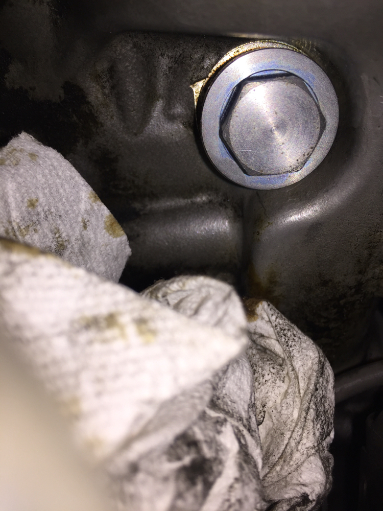

Here are some pics. The one on the right is the driver side. The driver side tensioner was shot, it was way easier to compress than the other one that came out of the passenger side.
That baffles me. No way in hell mine was going in by hand, at all. Makes me think the plastic guide inside the engine is not right, which is what is probably causing my noise. Might have to take in to BMW for diagnosis. Thanks for following up!

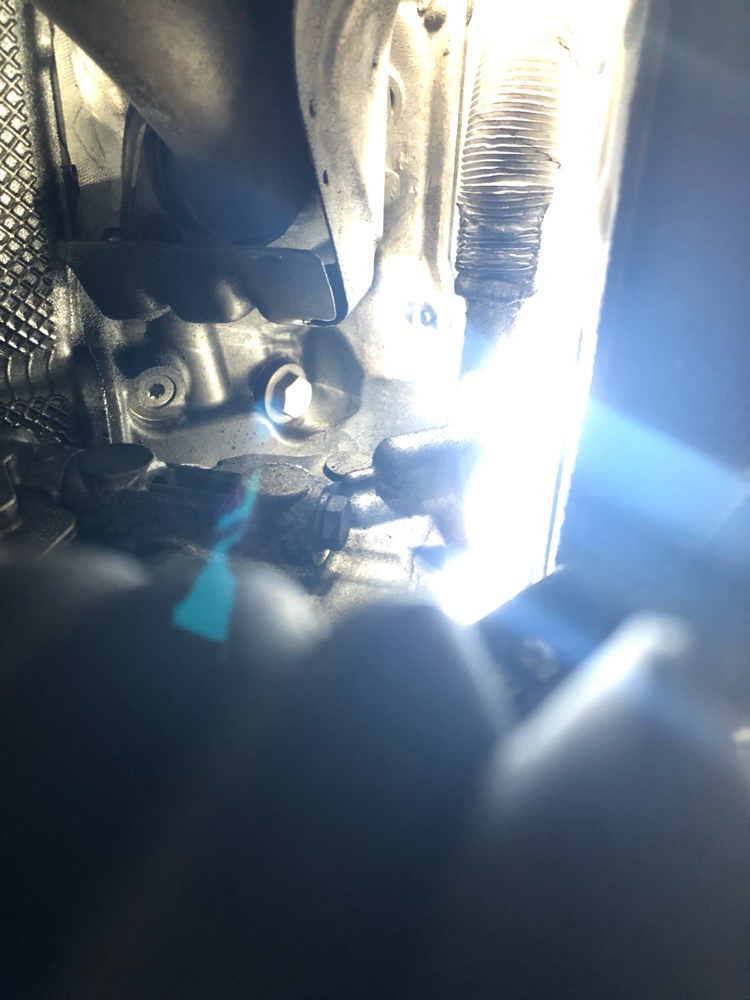

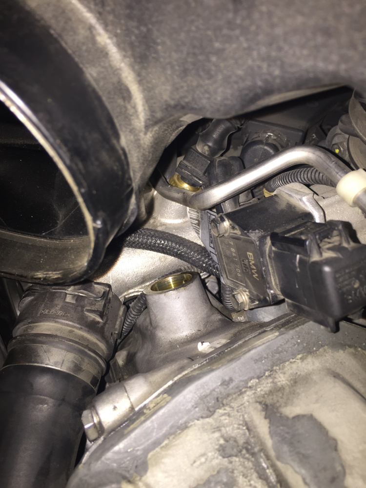

Good news! I did a little recon today. I agree that there is a ton of crap in the way going in from the top. However, invert, invert, always invert!
Straight shot from underneath the car. A/C lines are no where near it.

UPDATE: Removal from underneath isn't too bad, I can get it with a short 17mm socket, universal, and about two feet of extensions.
Installation: Can't get my hand up there because the steering rack is in the way. I might take out the coolant reservoir, or at least move it to get the new one started by hand.
