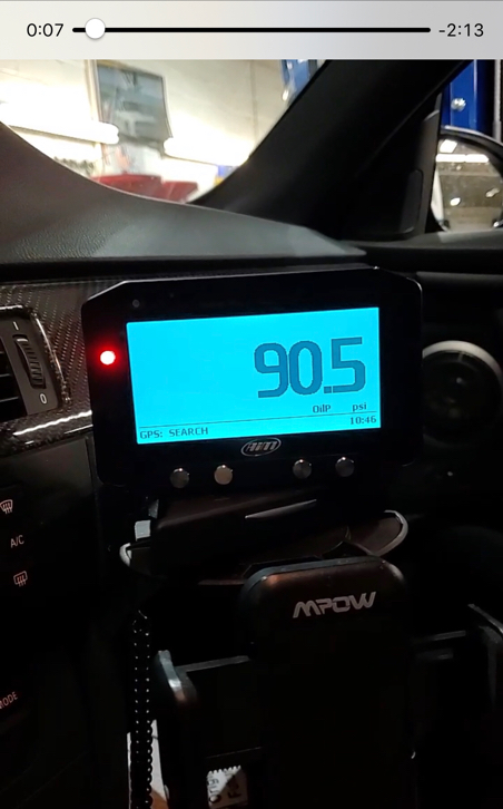

Originally Posted by dparm
Can you post a screenshot of the AIM data from when that happened? Show the speed, accelerator, brake, and steering angle channels. If you can also do yaw, that would help.
Here you go:

Here you go:
Can you post a higher resolution picture?

Cool!
Oil Pressure is added to my EVO5 GS display
Alarm set to "less then" 30psi
Still troubleshooting the alarm not going off.
But I could not wait to share
Many thanks for Autocouture for adding this feature. I can't wait to add DCT temperature when I can find the DCT Boss part.
Car is running cold in the picture, not sure what it will be hot.
The goal is to trace oil pressure as I go through corners
