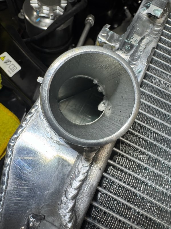

just installed DO88 radiator
after doing research on cooling system upgrades, it appears DO88 mentioned a lot in this forum, so I bought they're radiator and oil cooler. Upon installing the radiator I notice there's excessive welds on the inside of the lower neck. Other than that the fitment was good, and no issues so far on both the oil cooler and radiator.
It probably have no effect on the performance, but I was just expecting the quality to be higher than CSF, since it's made in Sweden. I have CSF radiator on my E46 M3 and the welds seemed nicer.

I bought their radiator pack two years ago and the radiator was leaking from one of those side welds.
Did you contact DO88 about it? Just curious about their warranty and if they give you replacement ?

No, didn’t bother just had it mended.

We stopped selling D088 due to the issues. It didn't used to be this way- they were very good, but now it seems like Every. Single. Unit. has some type of defect. Usually it's mounting tab issues or fan retainers being mislocated, but we've had to repair welds on the last radiator and another pinhole in a defective weld in an oil cooler. On the radiator they literally forgot to finish welding a bead on the side tank!
We've sent them emails every time but they don't seem to have done anything about it.
Having to inquire about a warranty replacement is a huge waste of time. These issues aren't usually discovered until the car is immobilized, in pieces, and a remedy is required right then and there. They may send out a replacement, but then you're doing the job twice. It's easier to handle it in the moment, and I suspect DO88 is happy to count on the end user handling the defects.

I wasn’t impressed with a recent install I helped on, making CSF look better and better.
