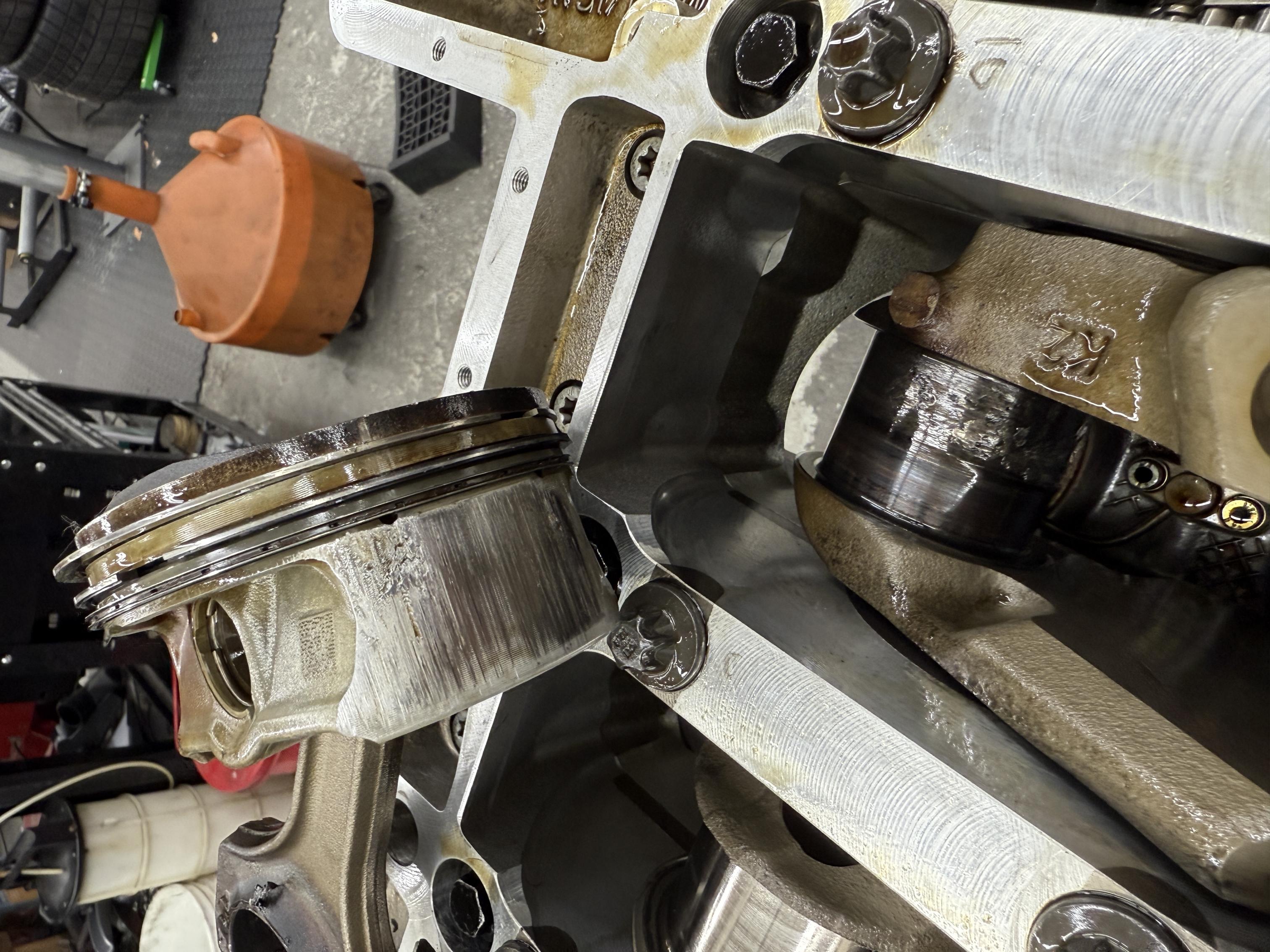

Rod Bearings Inspection

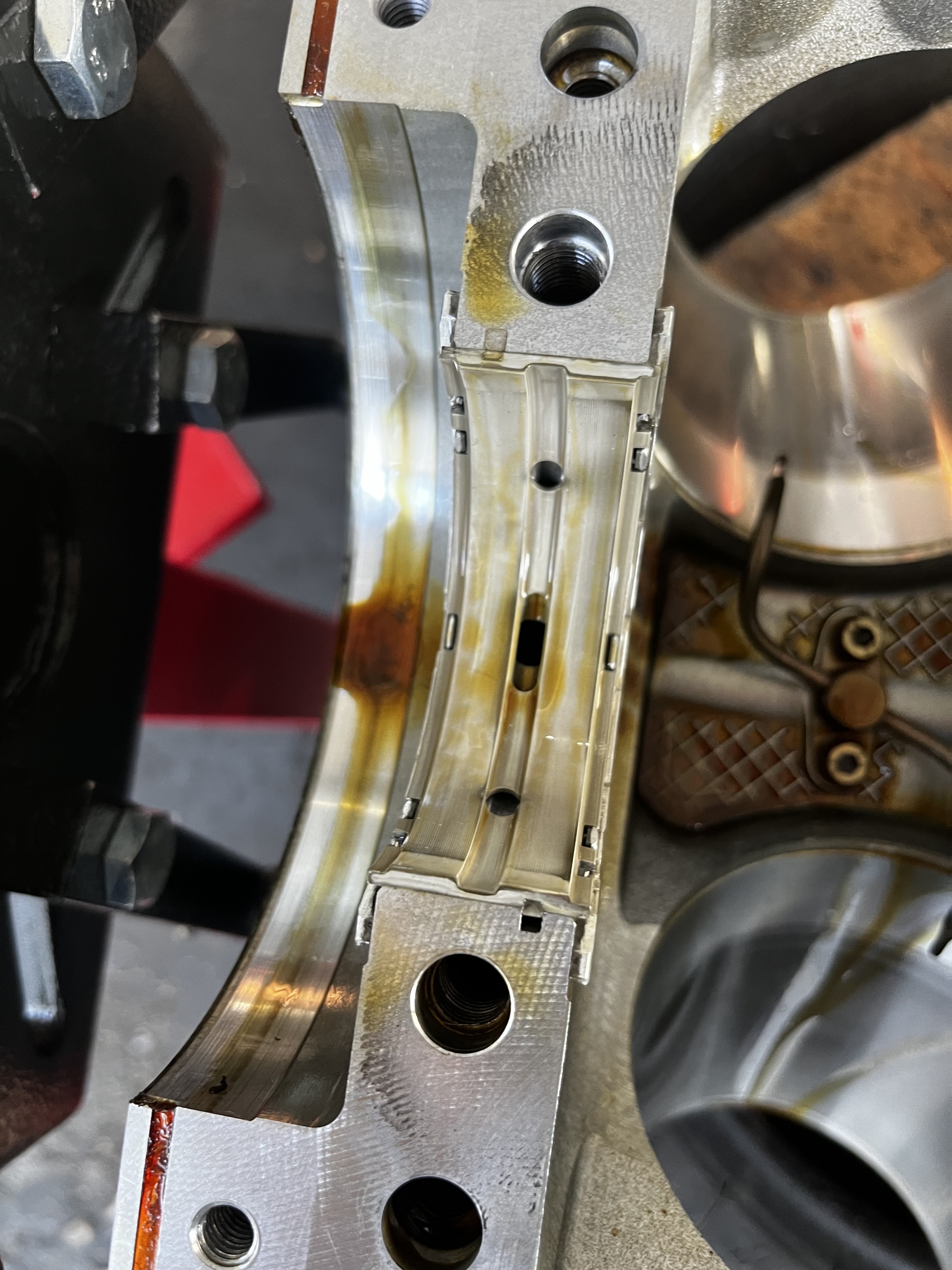

Bought a used engine with about 150k miles. Doing basic maintenance and improvements ie. WP, Spark Plugs, VANOS Cups, etc.
Decided to inspect the Rod Bearings to make sure. It has ACL Hx with ARP 625. Looks good…Should I replace them or just ride with them?

If you're that deep I'd just replace em with BE. They are the HX extra clearance ones and do look fine to my untrained eye.

Being a ACL HX/ARP625 driver since july 2018 - with no knowledge about what it currently looks down below - I'm happy to see your photo. Any more on the other?

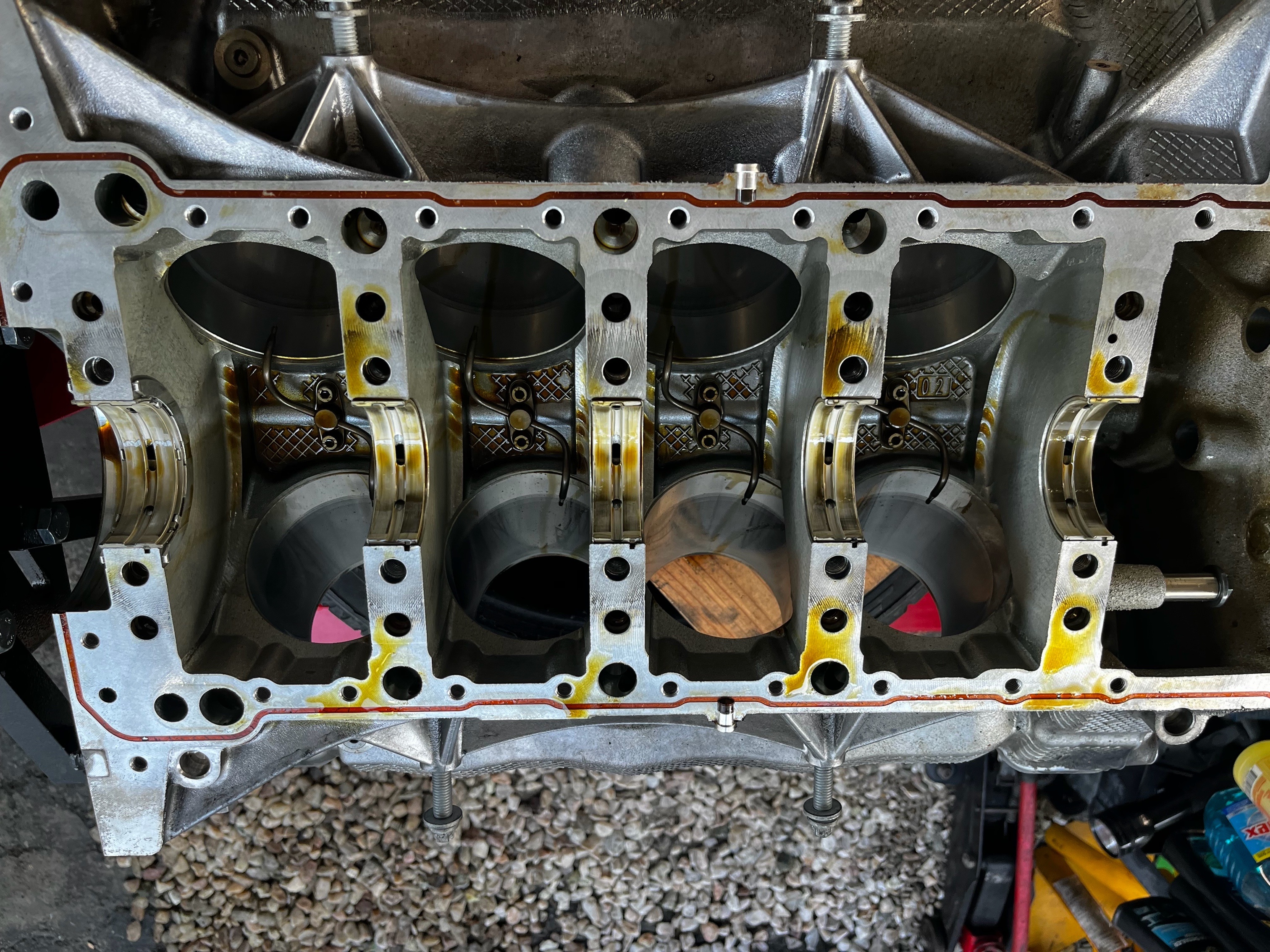

If the engine is out already then for sure pull the bed plate and crank and do mains too

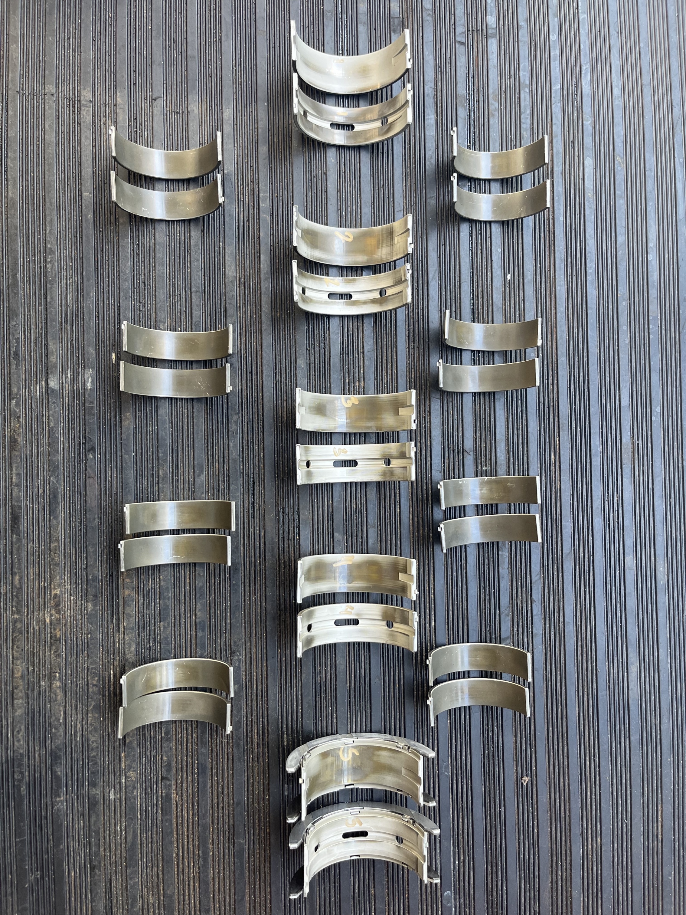

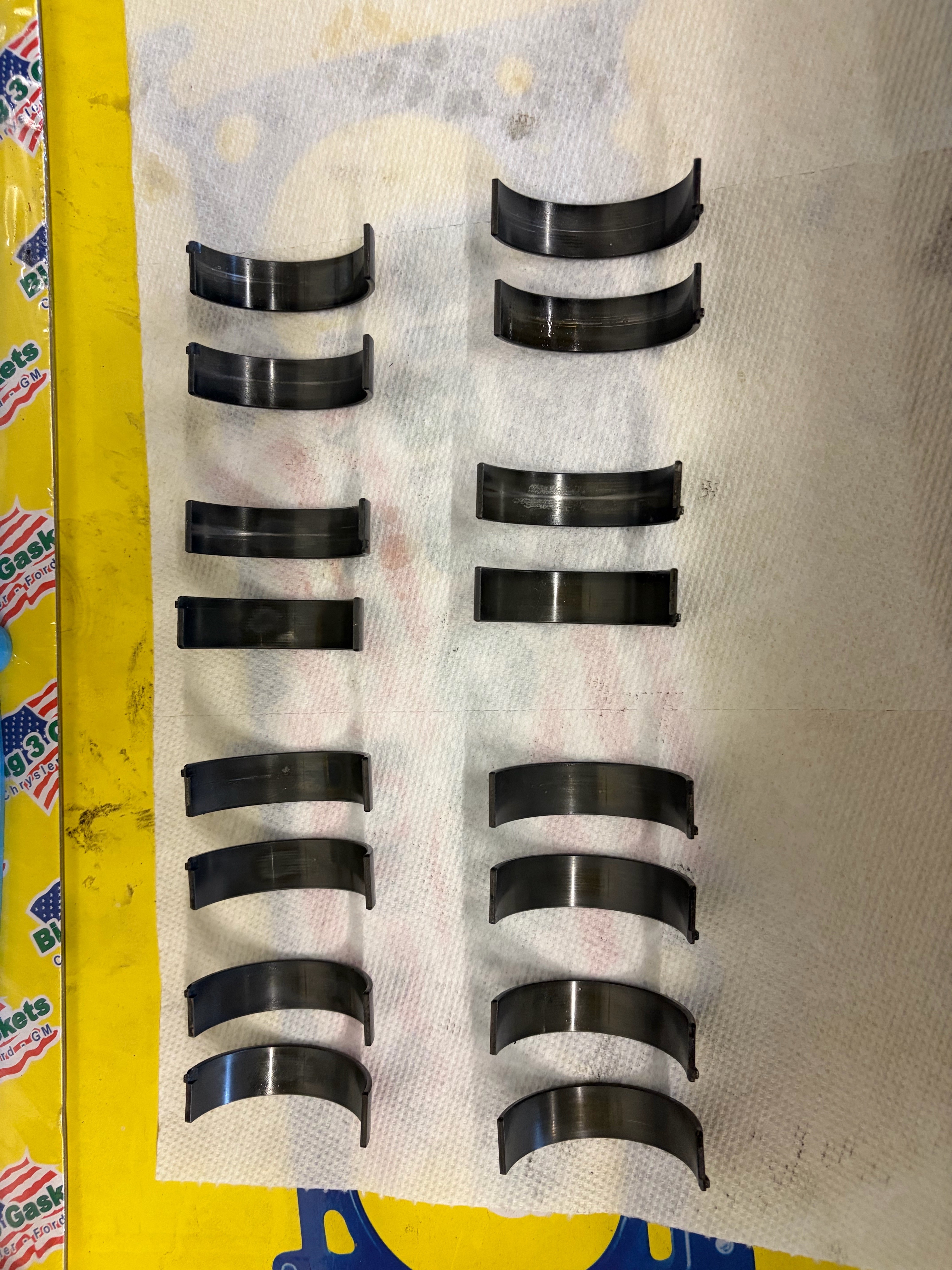

Decided just to replace them for peace of mind.
Left side is rod side. Right side is cap side. ACL HX top and bottom.
Don’t know when the previous owner of the engine replaced the bearings but engine had 155k miles.

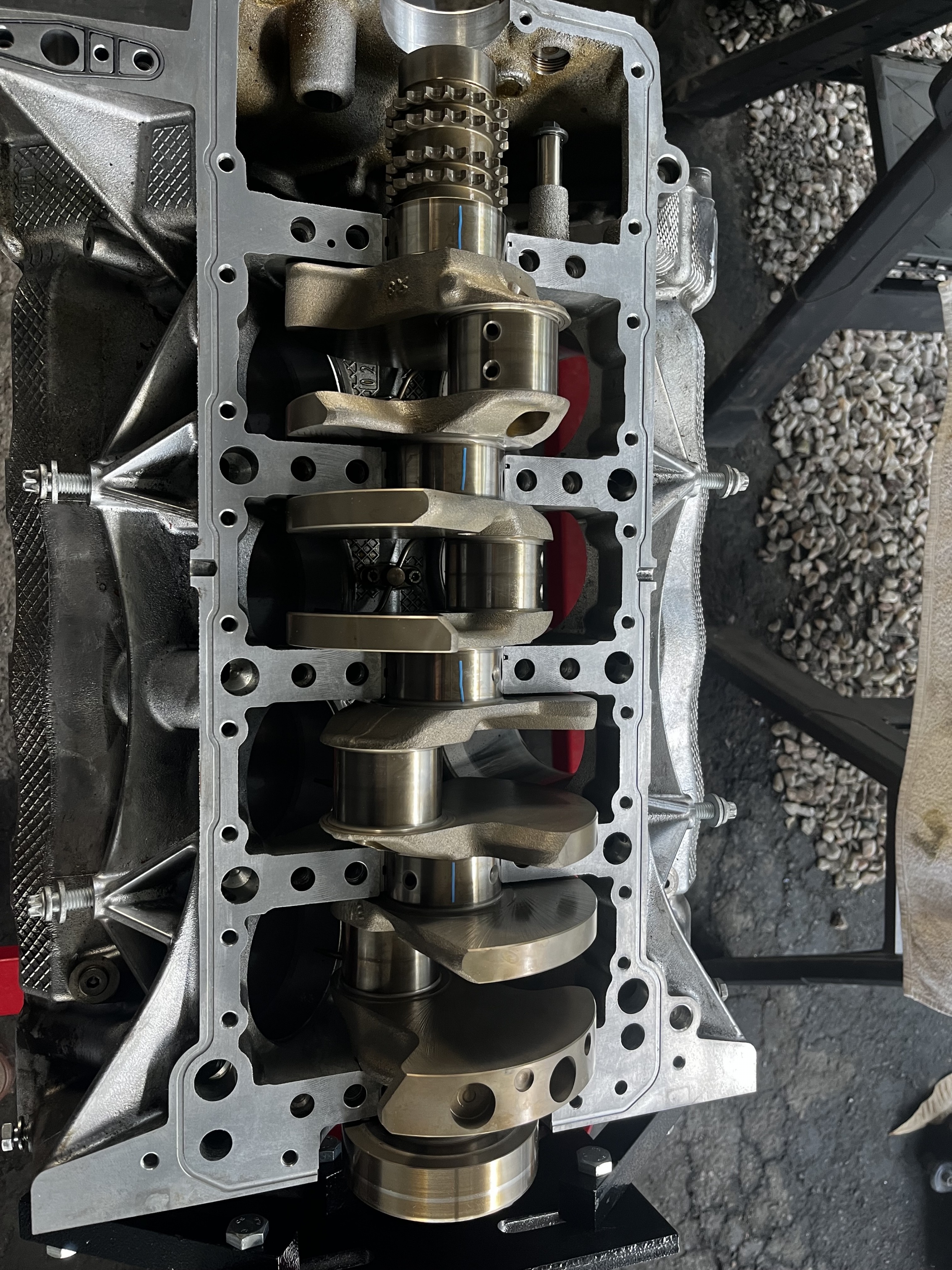

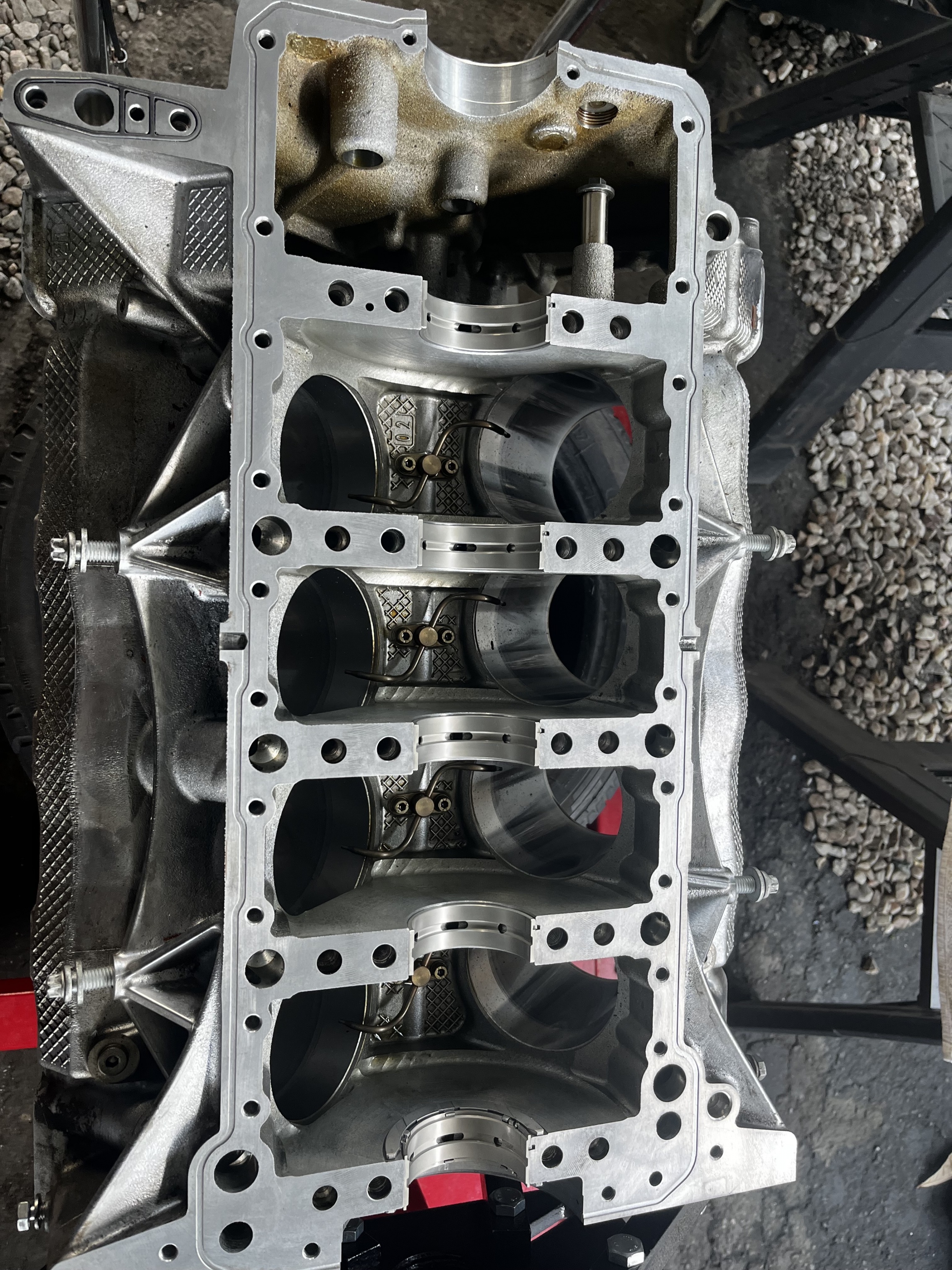

Couple of recommendations from a guy who is knee deep in a rebuild after a total catastrophic engine loss.
1. Do the main bearings NOW. The engine is out and it is JUST as important as the ROD bearings. If number 1 main bearing spins you nuke the rest of your engine as the oil passage hole on the crank gets blocked.
2. As someone else said, do the SRD gears for sale from Rogue. $400 is good ensurance to bump up your oil pumps performance.
Good luck with the rebuild!
Rubin

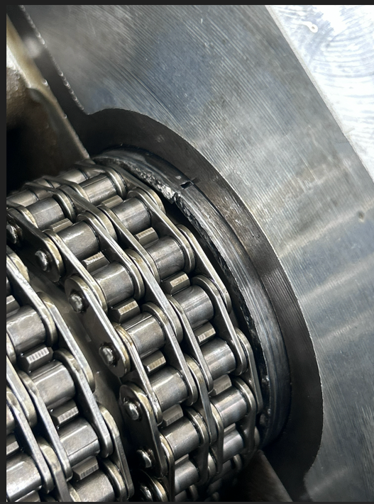

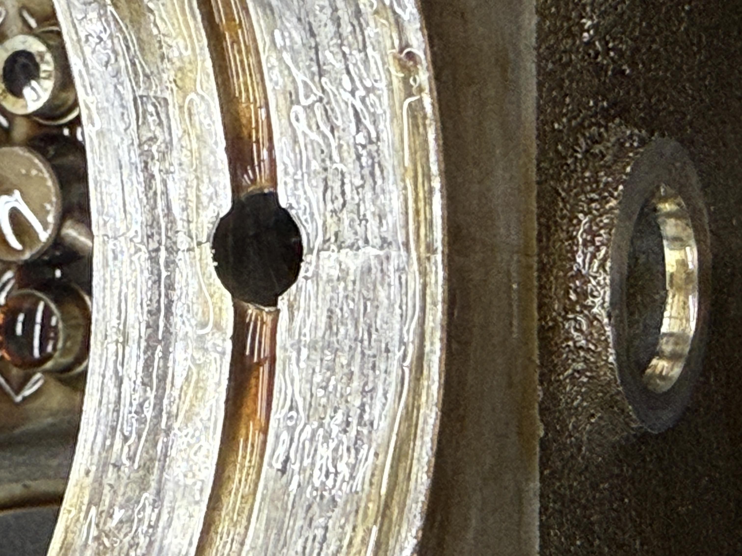

I don't have pics of the full set, but here is a snapshot of the spun #1 bearing and what the journal looked like after.
The engine had just been rebuilt for $20k (although poorly) 14k miles before it's death.
Rubin

Yikes! What caused that? Apparently not age and mileage!
Rubin
Dangit!
Notice tho the crack at the #1 oil feed hole. I've seen this countless times on failed main bearings.
$20k for a rebuild you say? Did that include labor R&R of the engine/powertrain into the vehicle?
A few different things led to its demise. I have a thread about it here: https://www.m3post.com/forums/showthread.php?t=2210858 .
Cliffnotes:
1. Poor quality rebuild
2. Oil Starvation under high G braking and turns
3. Design of crank and double chains
4. Oil Pump design flaw for track use
Rubin
