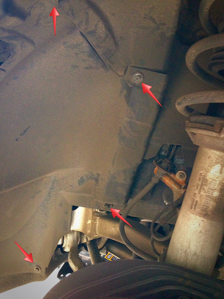

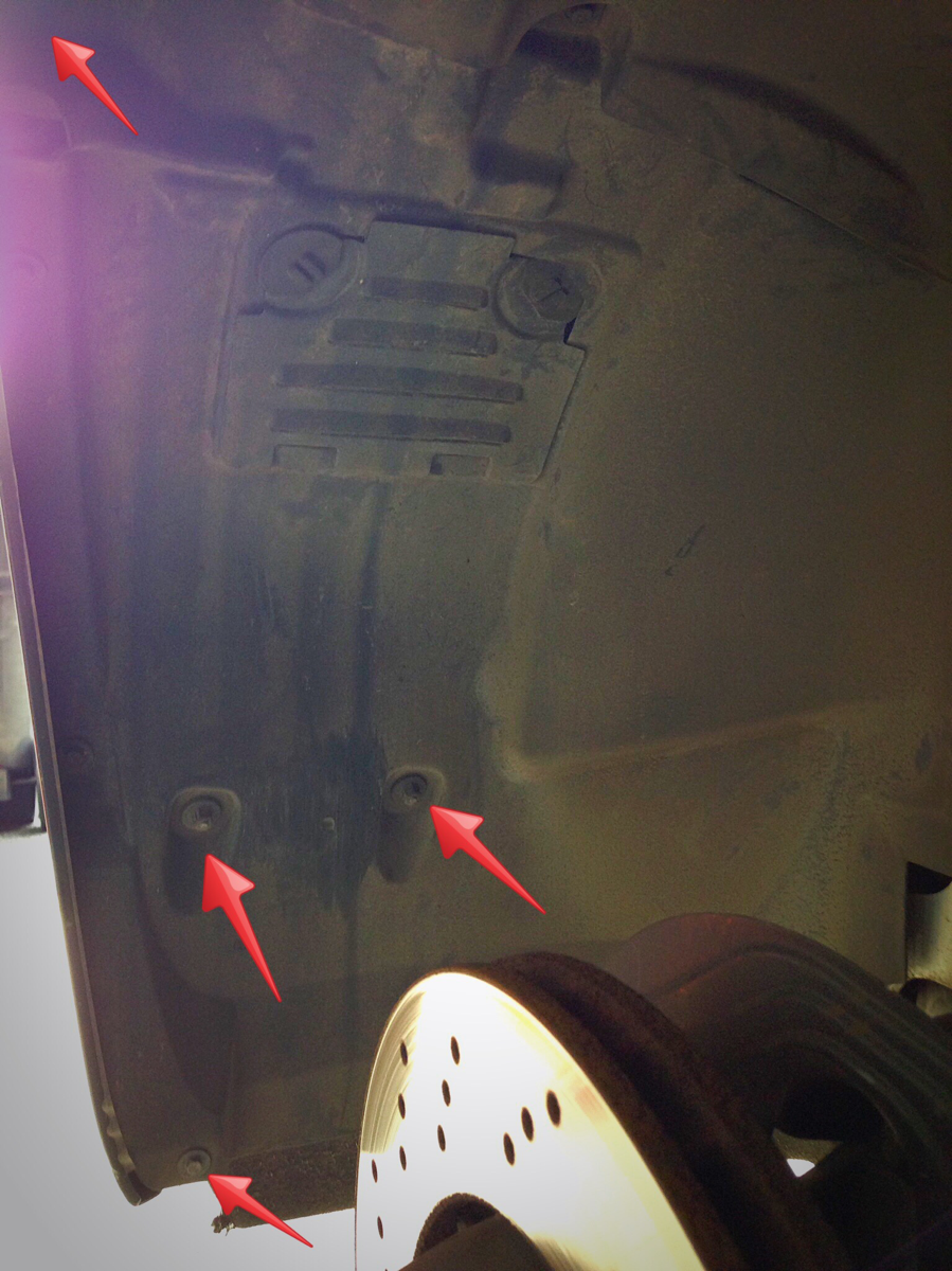

3. Remove front wheel liners. There are about 10 or 12 plastic bolts to remove. Most are 8mm plastic bolts, but some at 10mm. There are bolts to remove at the bottom of the liner, next to the wheel arch, at the top of the liner, and behind the wheel assembly. You can see most of them from the pictures below, and you will easily be able to find one that you've missed as you start pulling the wheel liner... The liner comes out easily. The pictures are from the driver's side, and the procedure is pretty much identical on the passenger side.

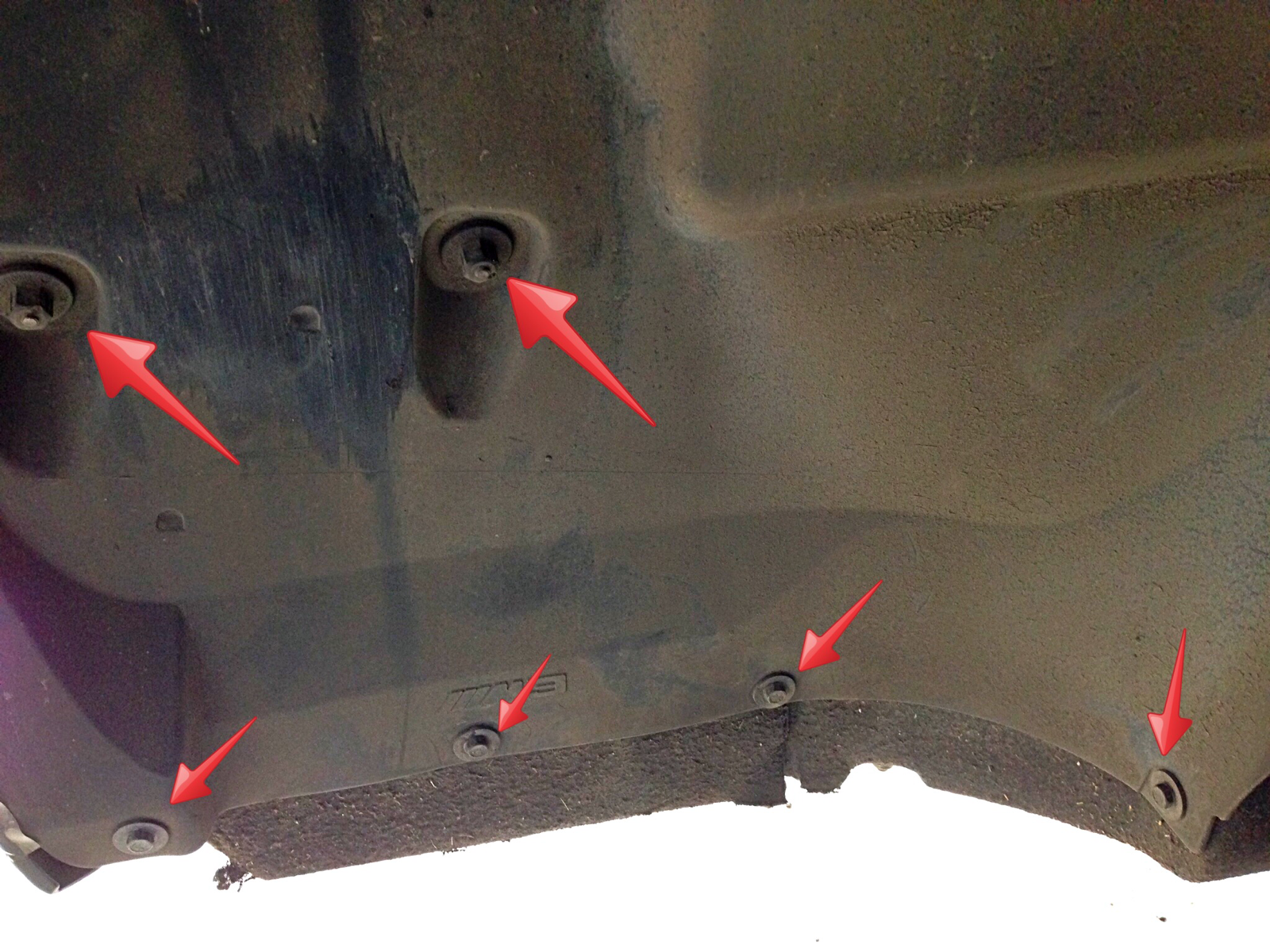

5. Remove under bumper screws. There are 7 I think...
