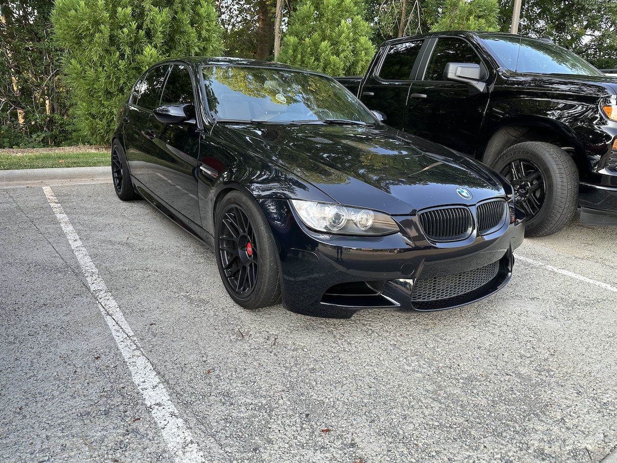

A little backstory -- I've puttered around on track a few times over the course of the last 10 years or so (maybe 3 or so events) before getting my E92. Then I went to a Porsche 2 days school down at Barber, caught the bug and with the E92 in hand went to the track. Did 2 more track days, and realized that the things I paid for in that car (low mileage, great condition, clean carfax) didn't make sense if I was going to put it on track regularly. Off to BaT it went, and was replaced with the new kid.

2011 non-comp with too many owners and too many miles for a market price, but an excellent binder of service history, rod bearings, throttle actuators, water pump, vcg and oil filter gasket already done.
this week i installed the new bbk (370mm paragon kit with ferodo ds1.11s all around), flushed the brakes and took it to Blackhawk Farms with the WI BMWCCA chapter.

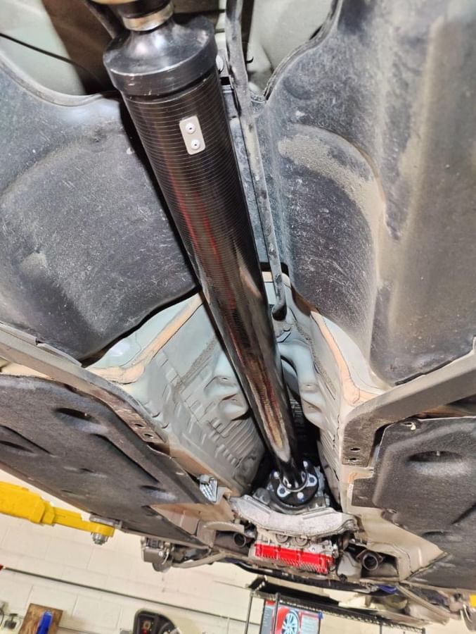

- MFactory CF 1-piece drive shaft. Again not really needed, but it's making the cowbell noise, and given the age of the CSB I'd probably need a new one anyway. Good deal popped up in FS at the right time so I snagged it

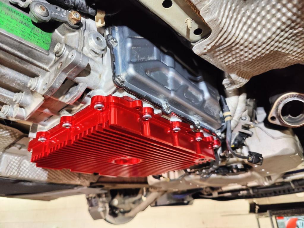

- VTT DCT aluminum pan. Current one is leaking pretty badly so in this goes.

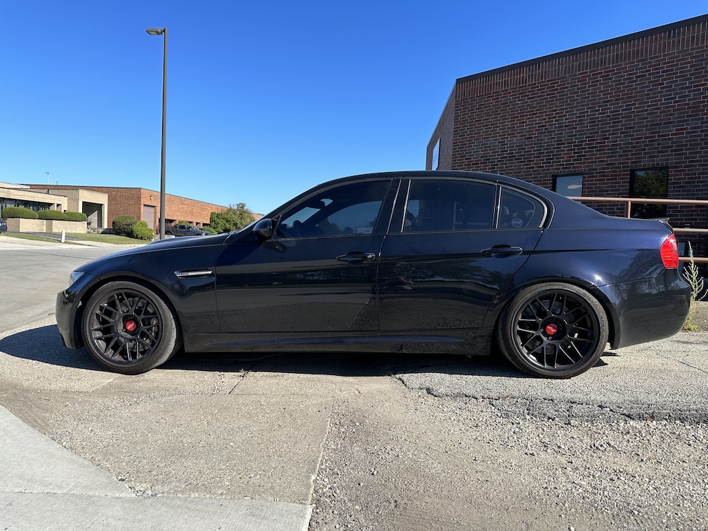

Alright, car is back from the shop with some new jewelry.
Ride height looks a little weird to me (slammed in the rear, normal-ish in the front), but Barry from 3DM responded with "that's about right, but change it if it looks weird to you."
Was blown away by how well it rode on the street though. I guess it really is about matching springs to dampners, not just maxing one or the other out.
685lb springs in the front, 880 in the rear. We'll see.

A lot of people misunderstand the wheel gap. Even with that stance your car will still have rake from front to back. Measure at the jack pads and you should see the rear slightly higher. You need bigger gap up front to accommodate turning of wheels. I’m at GTS ride height and have similar wheel gap, not a problem.

you also need to remember the front fender arch is a lot larger than the rear as well. so it looks weird.
I once had too much rake down on the m3 and i was rubbing the top of my fender liner under braking.
BMWs with a MacPherson strut design (almost any non-SUV BMW has made in the last 40 years) have about 1/2" to 3/4" of ride height drop before the suspension geometry is compromised. Going any lower will result in more body roll.
9 out of 10 BMWs I see are lowered too much. Then the car rolls too much and then they put stiffer sway bars which causes more understeer. Then they dial in more compliance which results in more roll and then they increase the front spring rates which causes more understeer.
So kudo's to Barry at 3DM for knowing what he's talking about. Well setup BMWs with the stock suspension geometry are always setup with no rake or even slightly higher in the front.

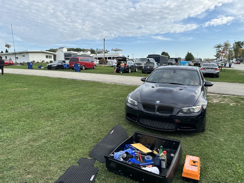

just got back from OctoberFast, a 2 day event with the WI chapter of BMWCCA at RoadAmerica. Car did great, having the Catalyst with me is magic and I got moved up to intermediate!
At the end of day two, once I got moved up and set loose on my own, I did 2 predictable things -- 1, I PR'd, and 2 I started chasing times and faster cars, and my line went to sh*t. Had to recombobulate myself and focus on the driving. The garmin is awesome, but I think at this point I need to run it turned away from me so I can review the data later, instead of seeing the red screen in my peripheral vision and try to "make it up" by doing something stupid later.
Some thoughts:
- I wish this wasn't the end of the season, I probably would have gotten into the 40s with another day. Looking at the lap times thread here, a stock (engine-wise) E90 should be able to turn 30s (though my corvette-racing instructor thought that a 45 would be a good time). Without traffic, I started the weekend at 2:59, and closed it out at 2:52, with a 2:49 optimal per the garmin. I think another day would've put me firmly into the 40s.
- I still need better cooling. It was warm for October, topping out at 84F, but that's not that hot by summer standard. I got a coolant warning halfway through the day and had to back off a little. This is with a CSF oil cooler, but stock everything else. DCT did better than at blackhawk though because it's a longer track so it didn't get as abused.
- I need to keep working on threshold braking. On one of my last runs of the weekend, I blew T12 by not braking enough. Thought there was something wrong with my brakes and reviewed the Garmin data later, comparing it to my PR. G force topped out at the same 1G or so as it did for that lap, but... waaay too late, though I started to brake at the same point.
Gonna try to sneak one more day in somewhere before the season really ends, and then it's off to Porsche school in December!
Stupid seasons.

well that's a wrap for the season, folks. at least for this ride -- I'm going down to the P-car school at Barber in December, but the M3 is going into winter cleanup + hibernation.
Good last day at blackhawk. Last time I was here I was stoked to crack 1:28 and get moved up to intermediate. Today, I was running 1:25s, with a 1:24.9 PR. Consistent 1:24s is what they want to move you into the advanced group. I'm no hurry for that, but it's nice to know I'm on pace.
The yokos are beat to sh*t, so I think I'm going to go to something else for next season. I like the idea of Cup 2s, but also want to learn to drive with less traction first, then add it later. Maybe I'll get some PS4s or something equivalent, not sure. Also have some work to do on the brake system. The stopping power is there, but I've got more pedal travel than I'd like and I'm going to look into an ISTA reset procedure Ximian pointed me to, and possibly get a used master cylinder to swap out the 150k one that's there now. We'll see.
All in all, super happy with how the season's gone and how this 150K mile, 10 owner beater has held up.
