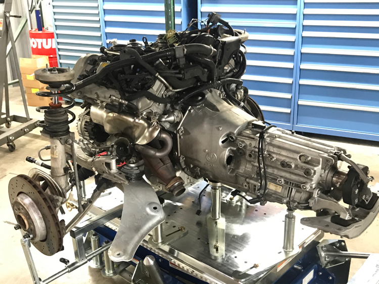

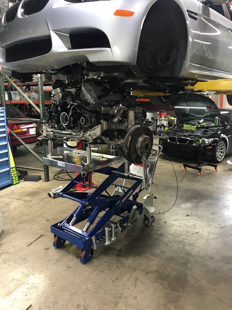

The fastest way is from the bottom. Modern BMW powertrains are designed to be installed this way.

Nice lift cart!
