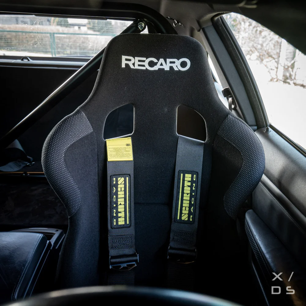

Hi. I'm going into direction of M3 GTS. I switched my leather sofas to Recaro Profi SPG XL's, as is M3 GTS. Did rear seat delete and installed Wiechers Sport roll bar. Installed Schroth harnesses, 4 point 3 + 2 in. Retained original belts for convinience. I use 4 points harnesses on track only.
More here: https://www.expressivedrives.com/blo...ar-seat-delete
