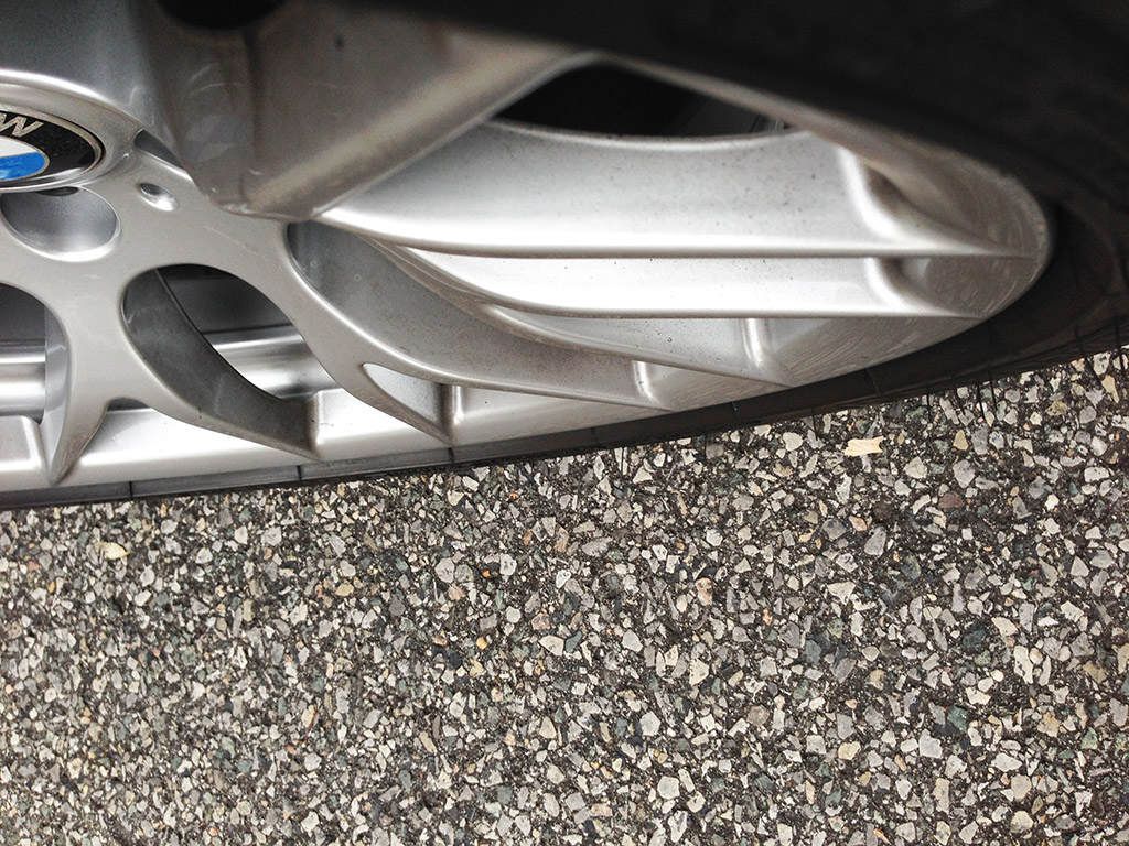

You know what is wild, I saw a guy local that had the same 305 on a zcp wheel. The sidewall looks totally different on the 305 vs the 295. The 295 has a bulge on the 10" wheel but the 305 does not. Not sure about proper support but the 305 looks better.

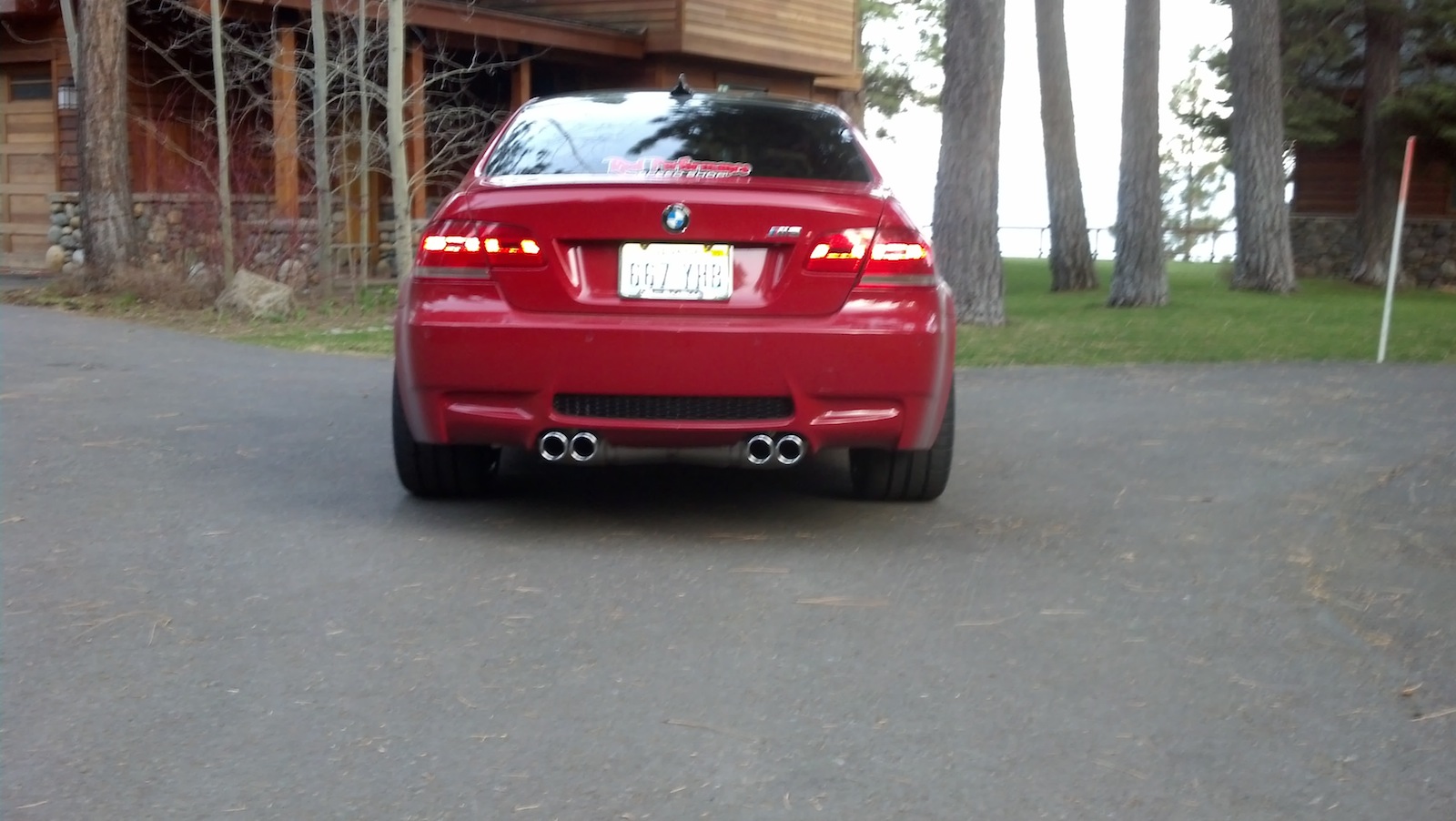

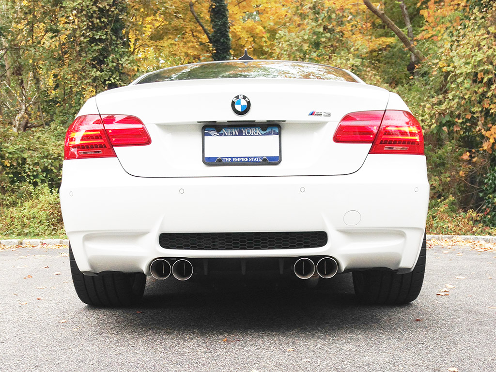

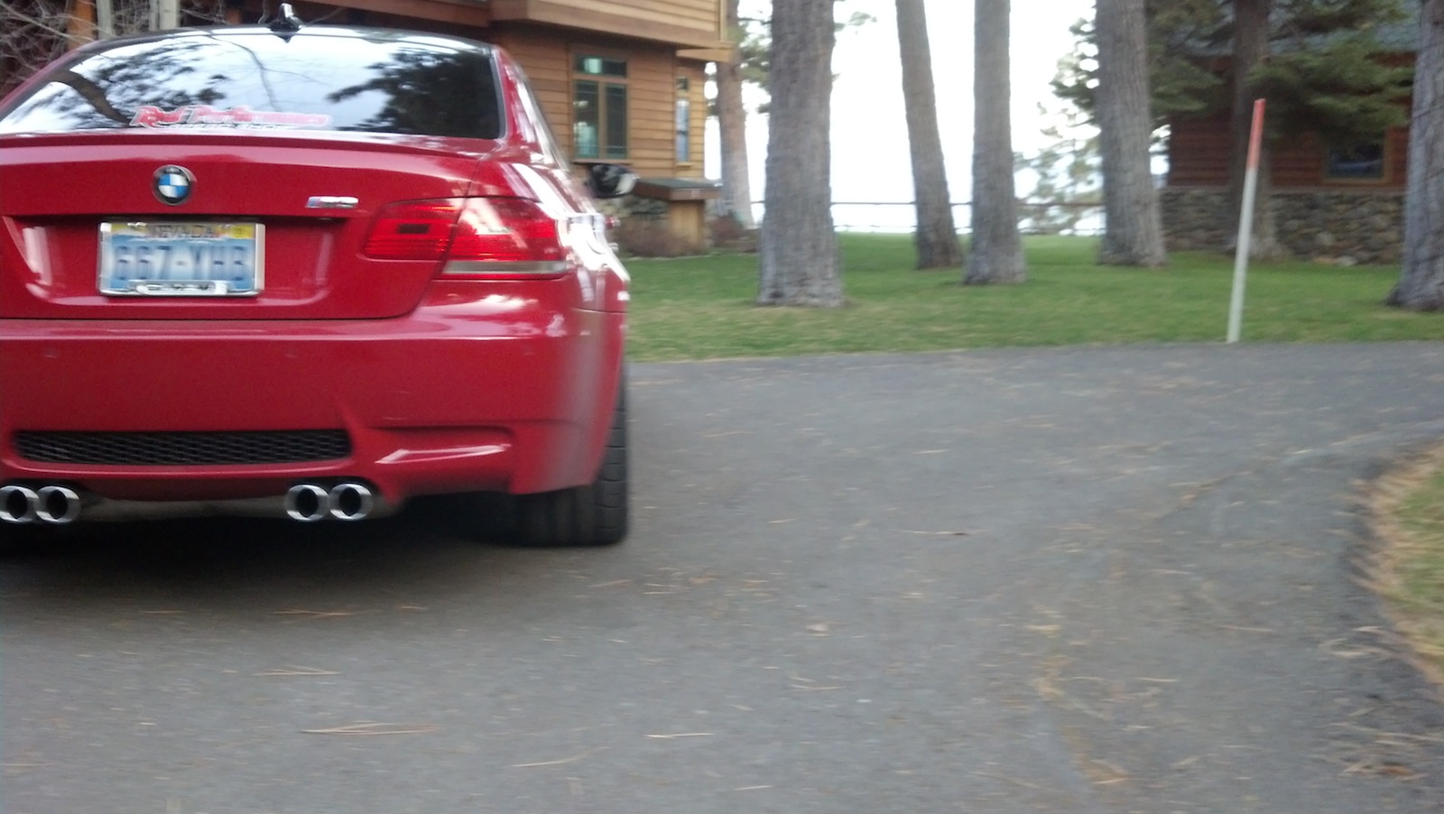

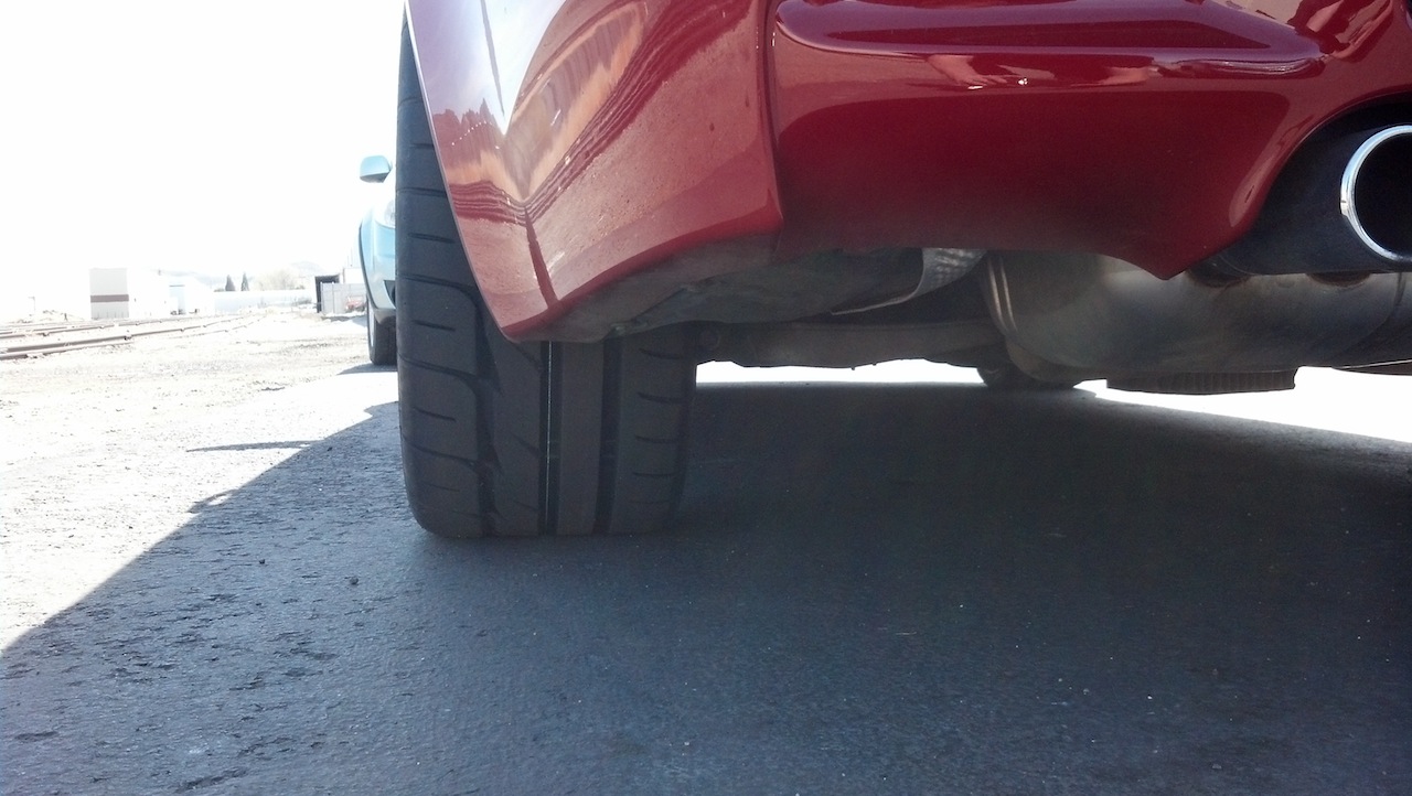

Do you have any pics from behind the car so I can see the total width?
Yes those are Re11s. Would you like an overall width of the tire photo? To be honest photos dont do it justice but I'll get one.
RenoE92M3 wroteYes, just an overall pic of the whole rear of the car please! I'd like to see how much wider the track of those tires is versus the PSS.Yes those are Re11s. Would you like an overall width of the tire photo? To be honest photos dont do it justice but I'll get one.
Is this what you wanted? Its before I lowered the car.
Sorry these suck I took them months ago and the car is up for the winter.
RenoE92M3 wroteYes perfect, thanks! They really don't look much wider (if at all) than the 295 PSS. The PSS seems to have slightly more bulge to the sidewall too, though that might just be its design versus a testament to width.Is this what you wanted? Its before I lowered the car.
