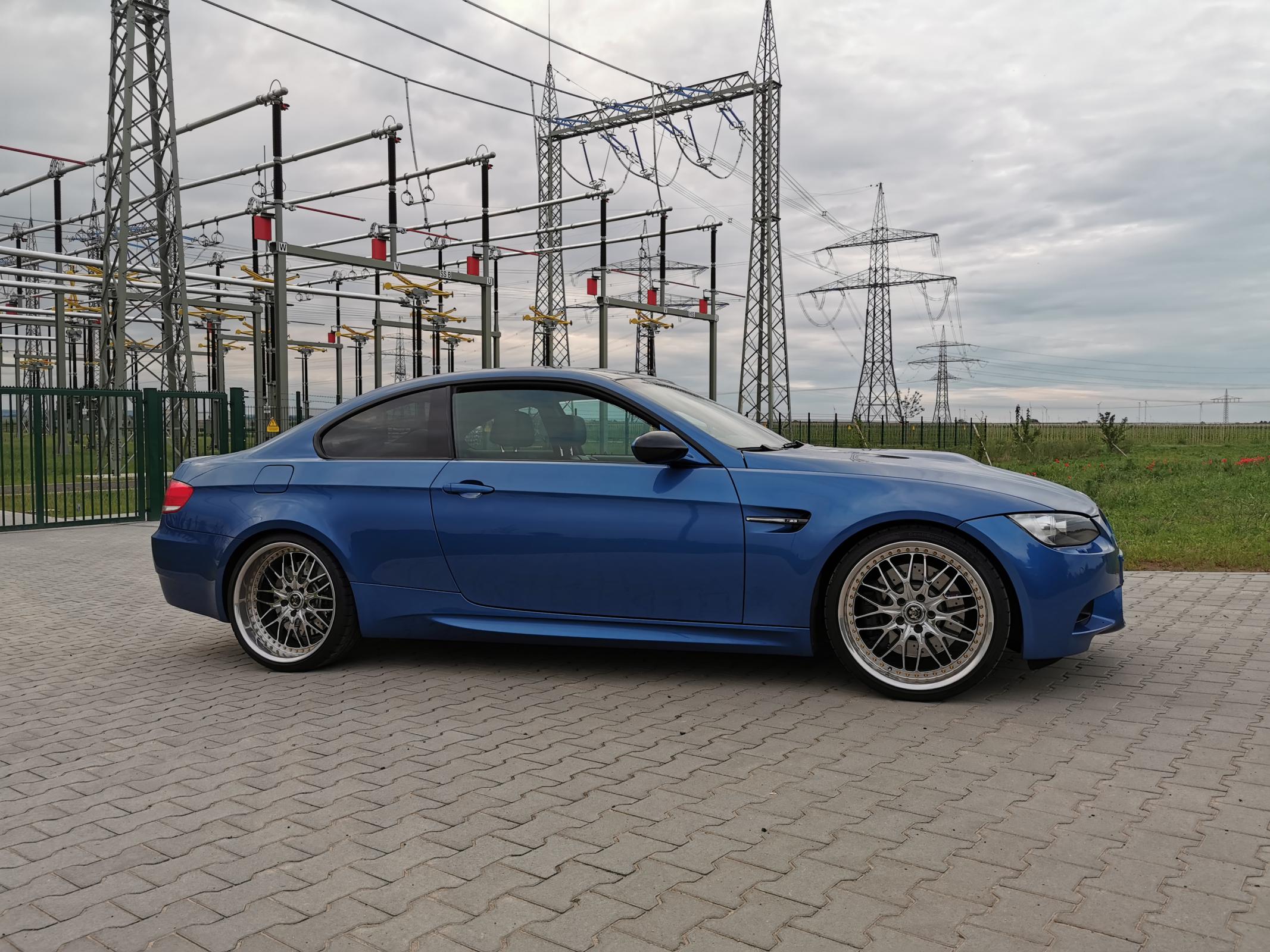

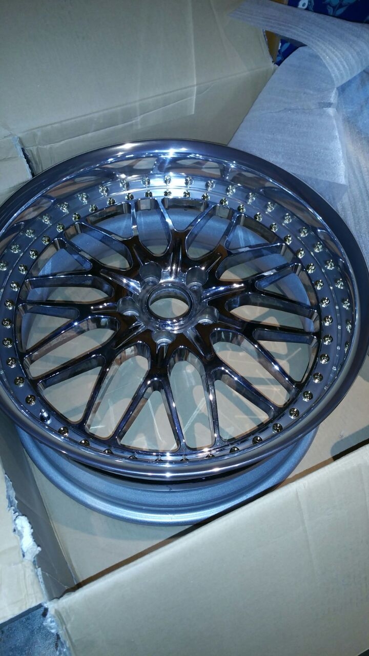

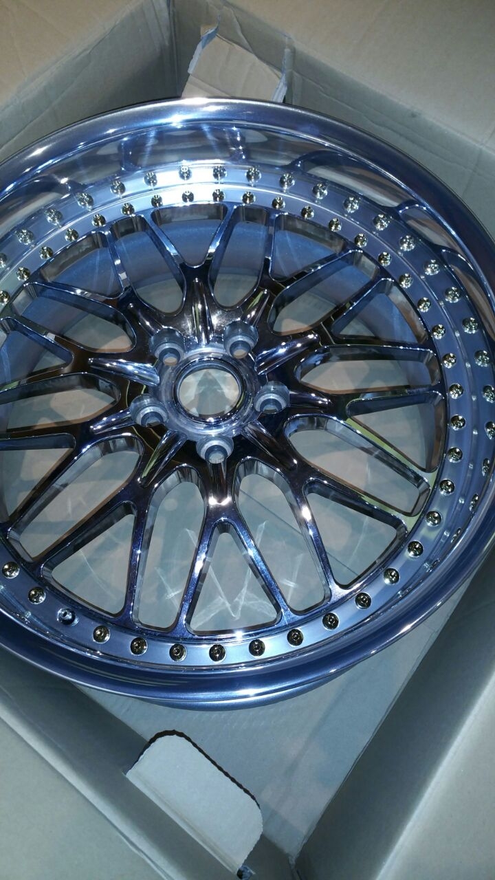

I customised Work Rezax 2 :)
I only use Redline 10W60 Oil for the engine, im totally in love with this oil :)

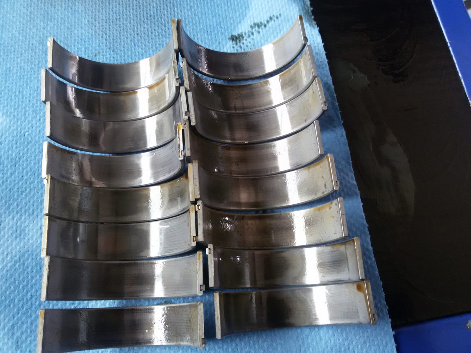

Hi,
a little bit maintenance was done ;)
- road bearings replaced after 84.000 Kilometers / 52.195 Miles (Picture below).

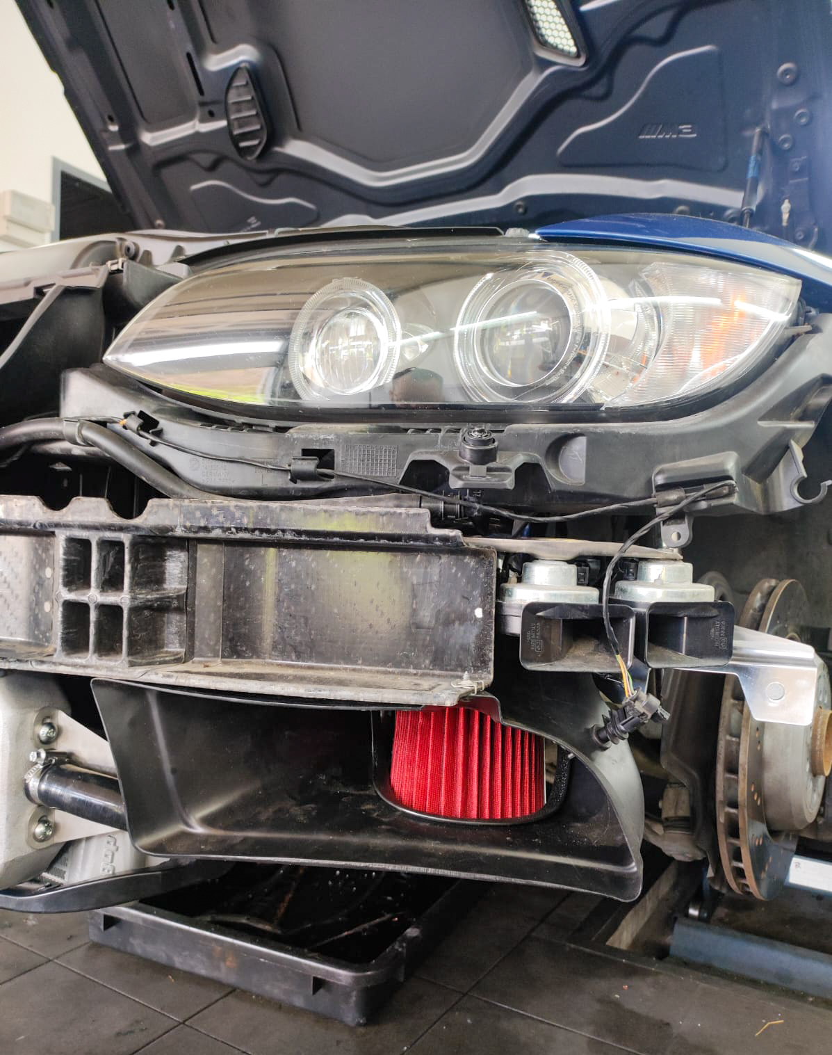

- Eventuri Intake

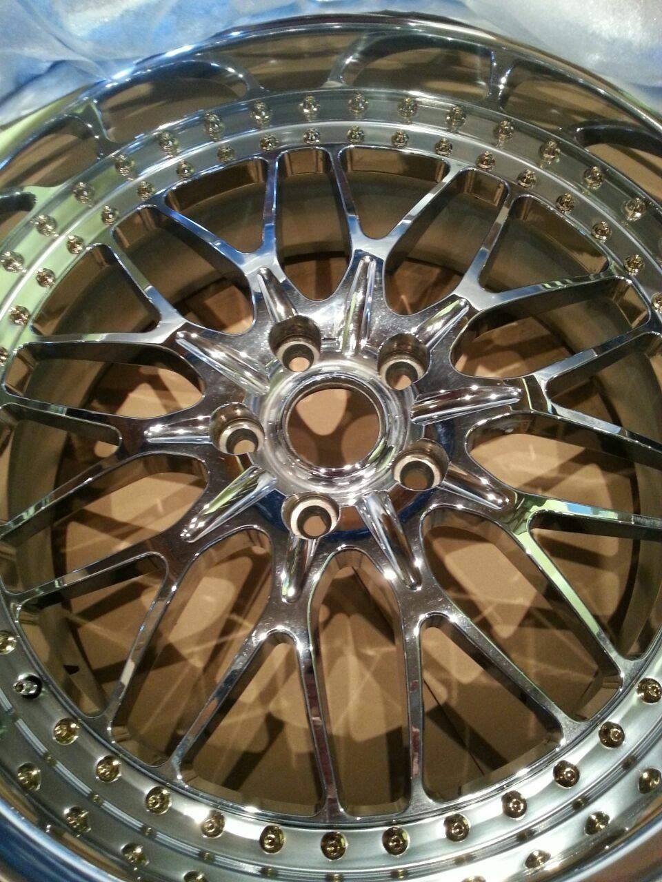

- Wheels w/ Offsets: Wheelforce CF3 UC - (F) 20x9.5 +16, (R) 20x11 +32
Spacers: Rear +5mm H&R
Tires: Nankang AS-2+ - (F) 245/30/20, (R) 295/25ZR20

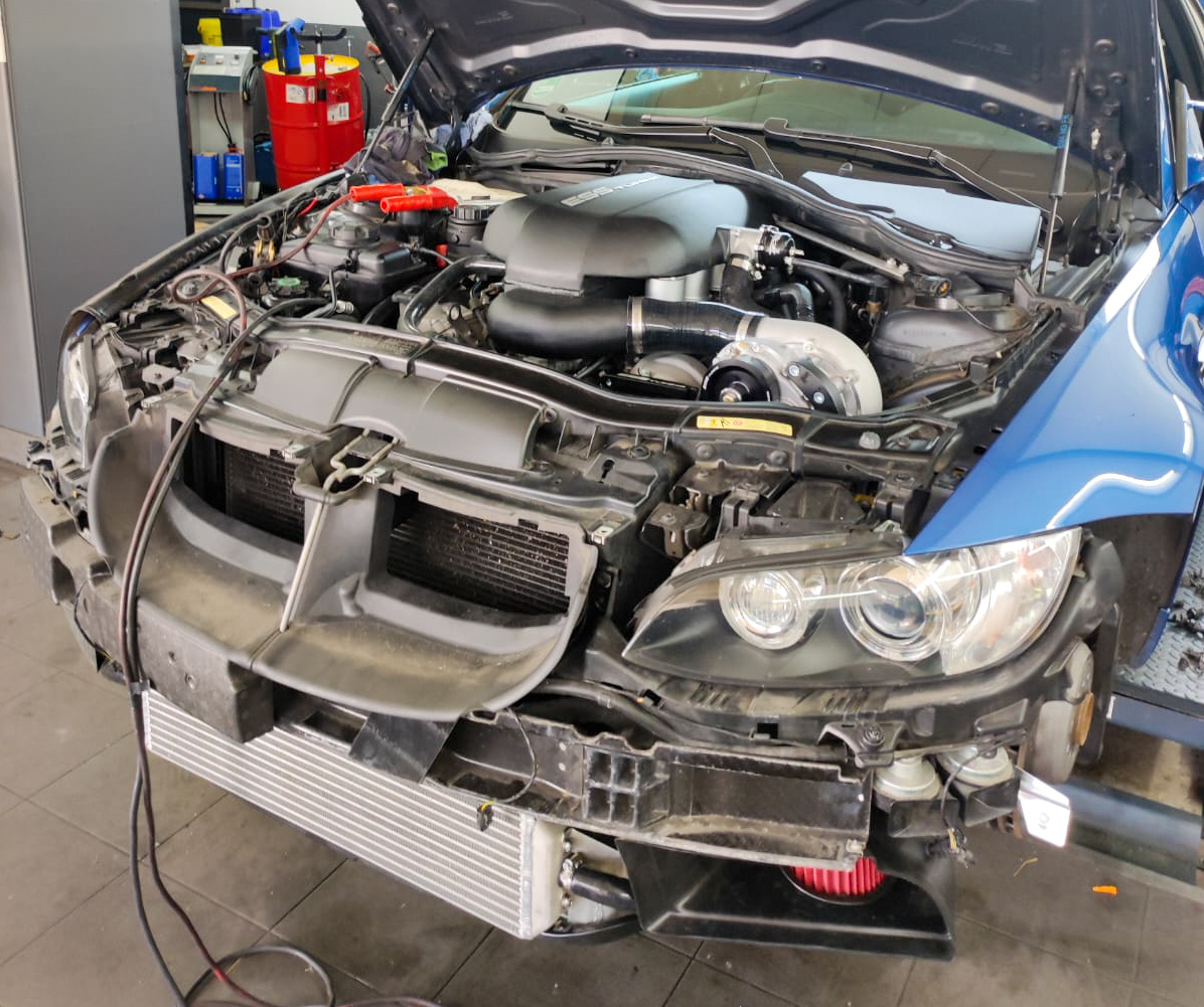

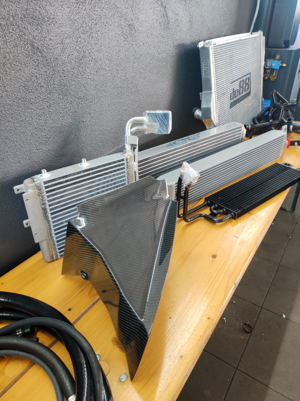

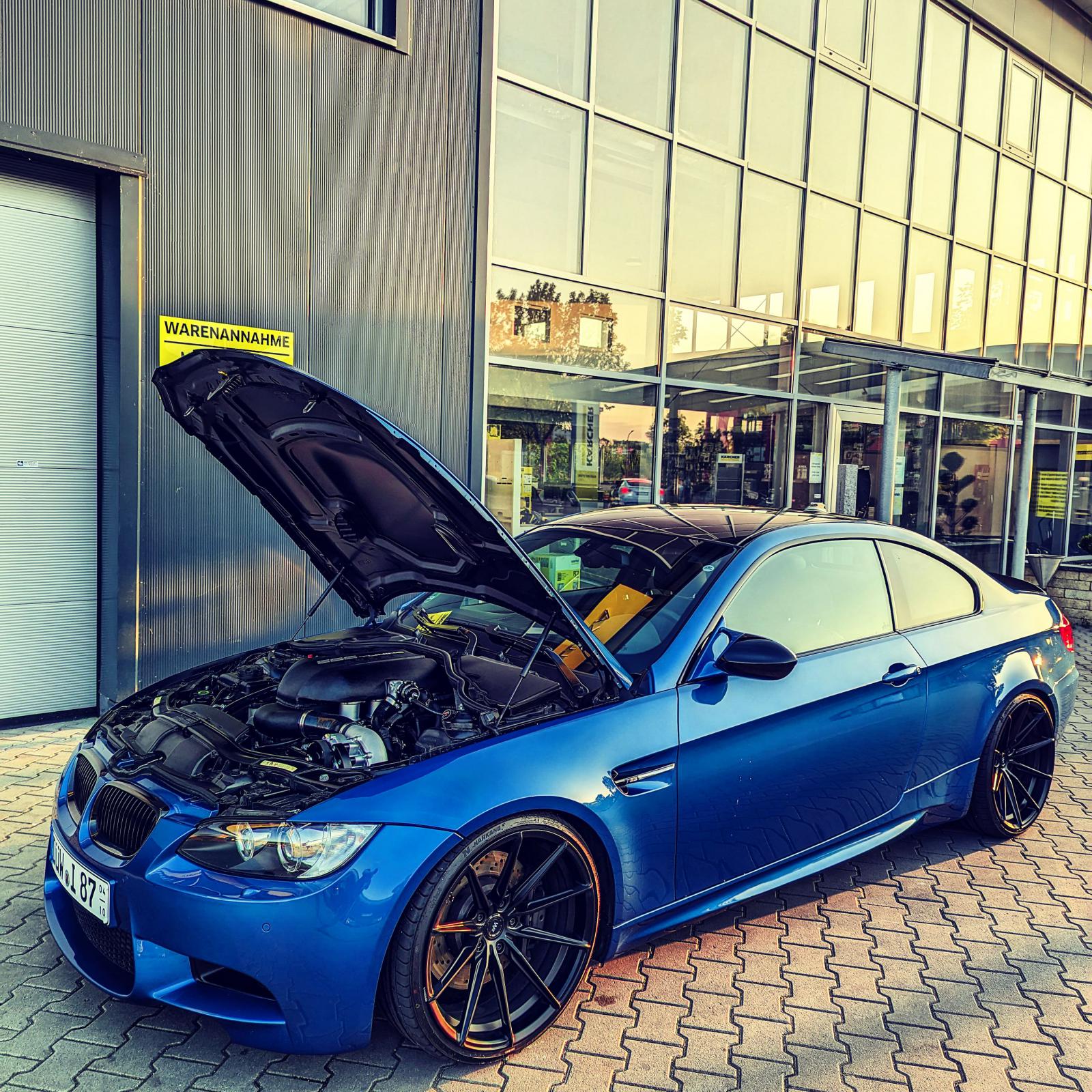

Hi,

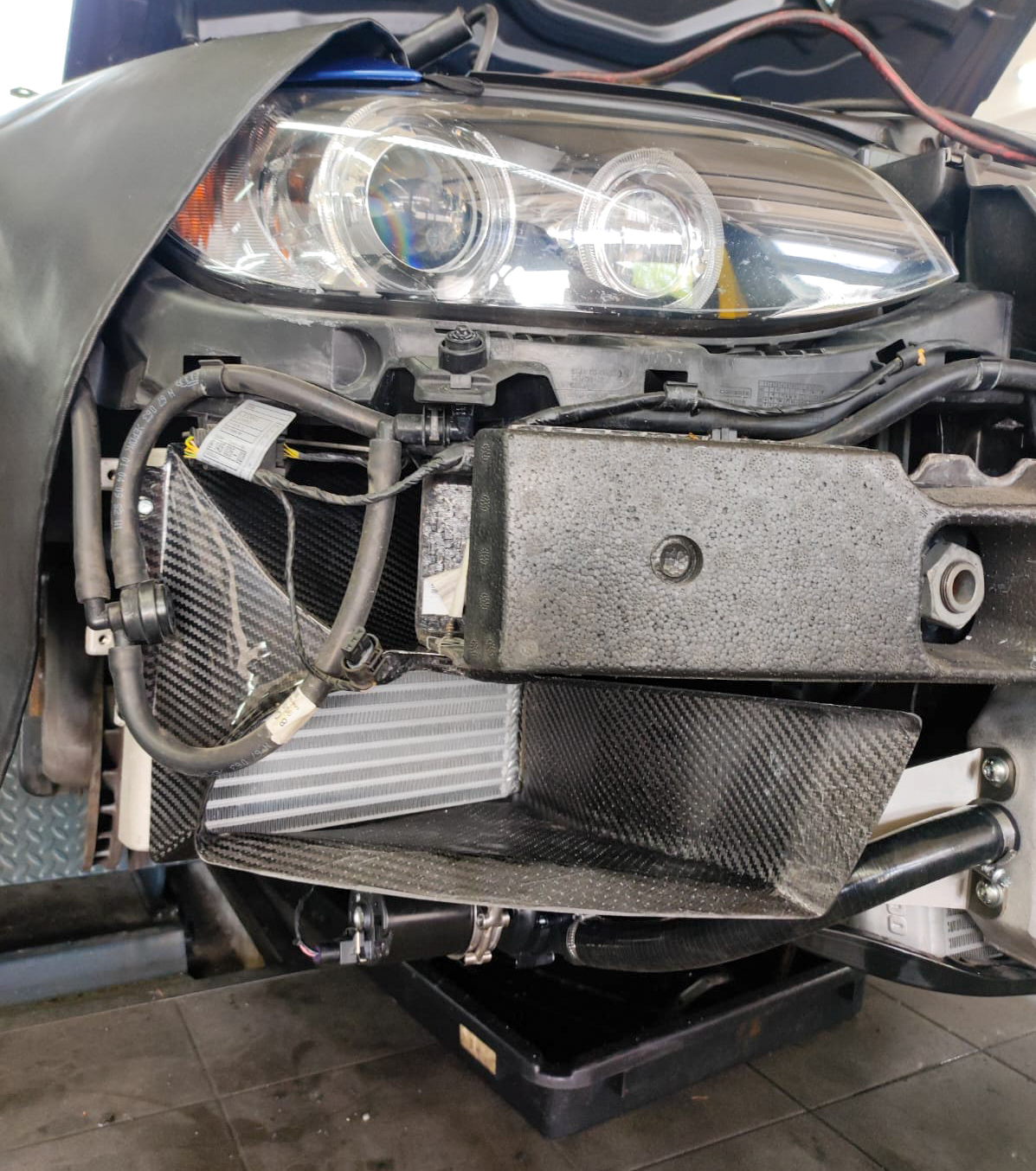

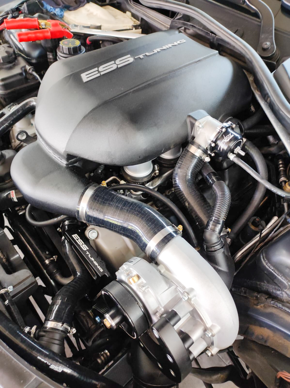

ESS G1 is running and will get its final tune. I think in the next few weeks I can slowly get a feeling for how everything works 😄, how the temperatures behave and how the 15w50 300v will perform.
Car is ready absolutely fun with the Supercharger. 👍🏼🍻

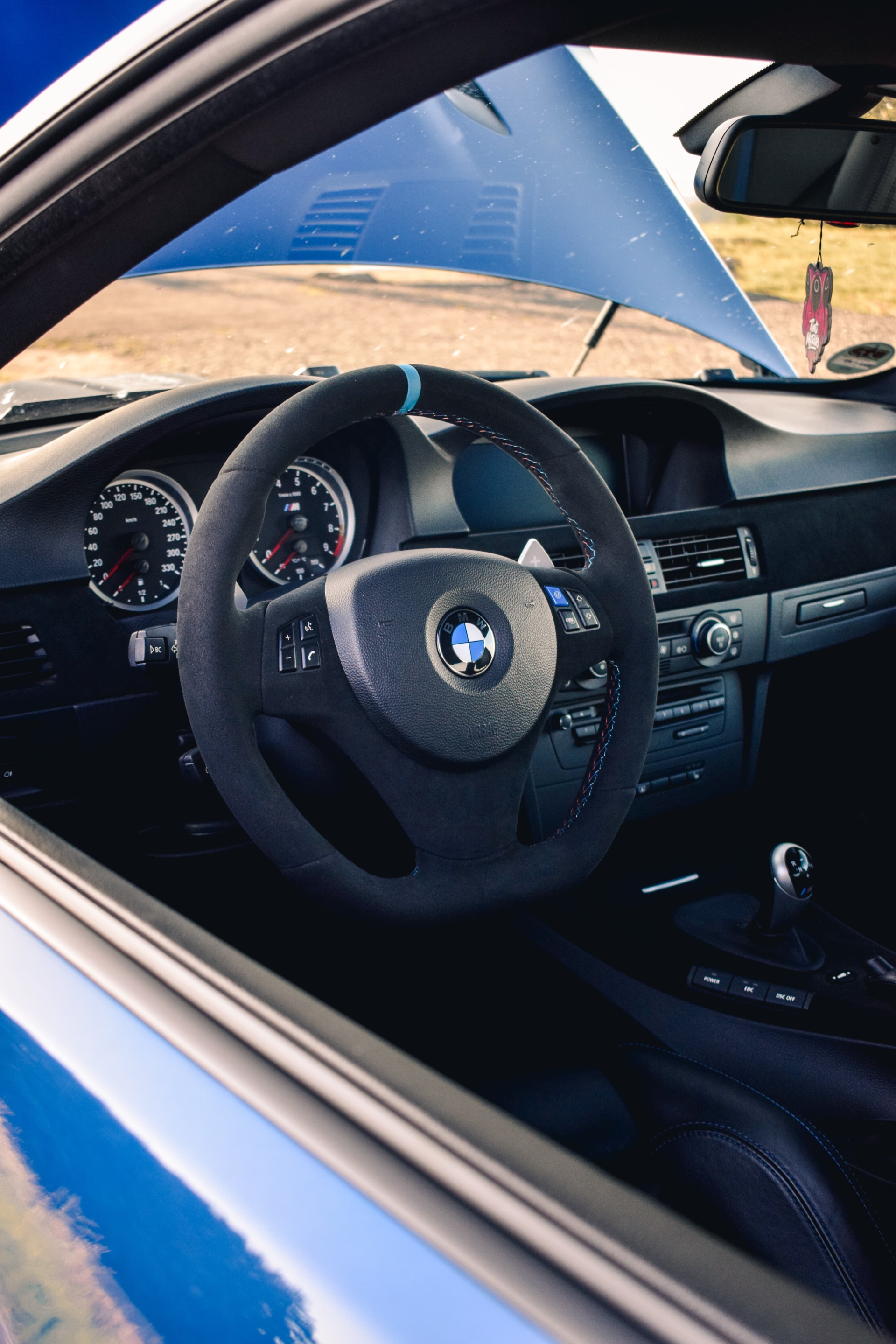

- Alcantara trim strips in the interior.
- OEM BMW Performance steering wheel.
I haven't had any problems with the supercharger kit so far and it performs as it should.
Thanks to the large cooler package (DO88) and small modifications such as increasing the oil level in the DCT.
There are no temperature problems in street use :)
In the future I will try a shorter V-belt that I use through the 94 pulley, in the lower gears it sometimes slips slightly.
I also keep an eye on the valve covers, they are currently still in good condition, but as soon as I see with the endoscope that the inner coating is peeling off I will get some from NRW or something similar.

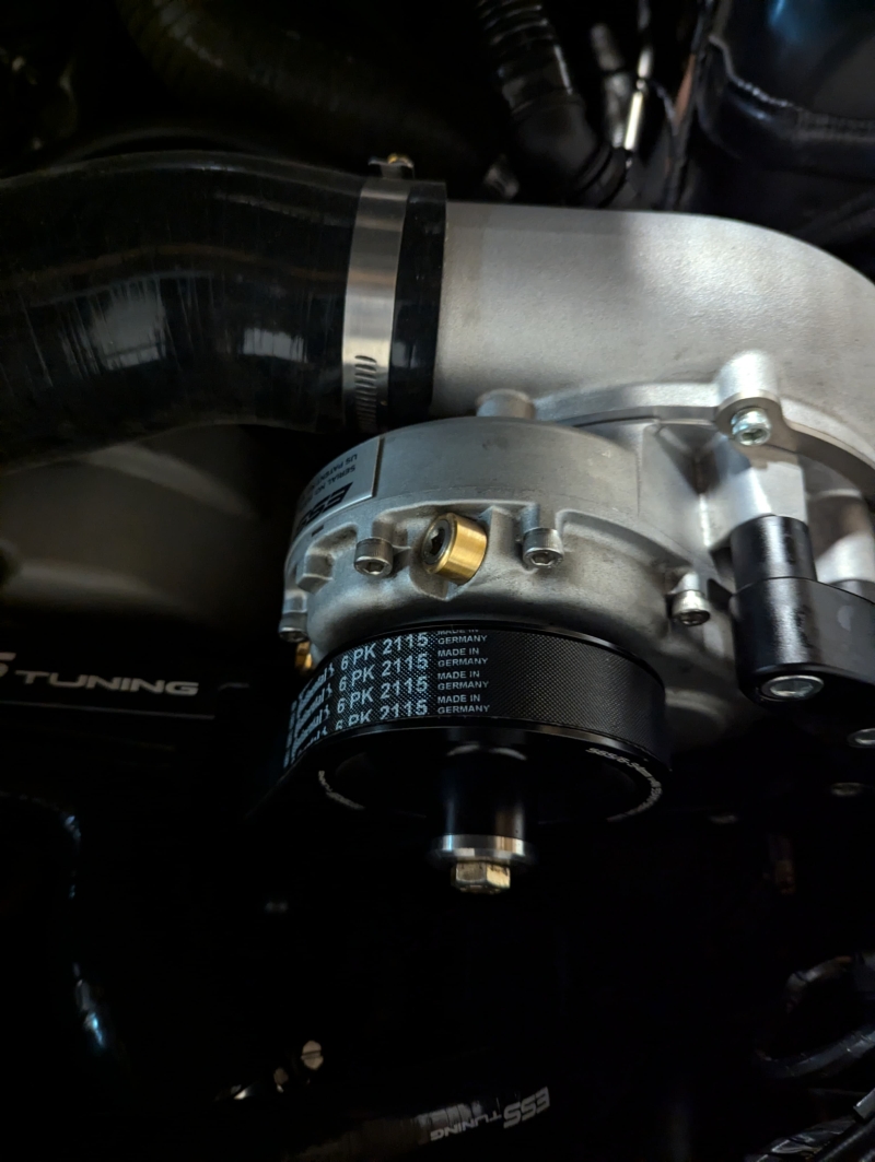

Small Update – might be interesting for some ESS supercharger drivers.
Sometimes i had a squeaking noise during gear shifts and occasionally during acceleration not often, but it was there.
I had already replaced the belt tensioner, but the noise persisted.
You can hear the sound here starting at 1:39–1:40.
The only thing left to check was the serpentine belt.
The included Gates belt has a length of 2220mm. I switched to a 6PK 2115 Contitech belt, and the noise disappeared.
From what I can tell, the Gates belt only has one "grippy" side, while the other side is smooth. The Contitech belt, has both sides grippy and is 5mm shorter.
I think if you're running the 94mm pulley, you can go straight for the Contitech belt.
The Gates belt might work fine with the "stock" 98mm pulley.
