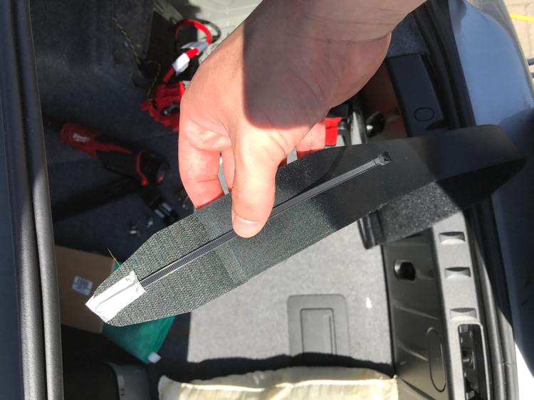

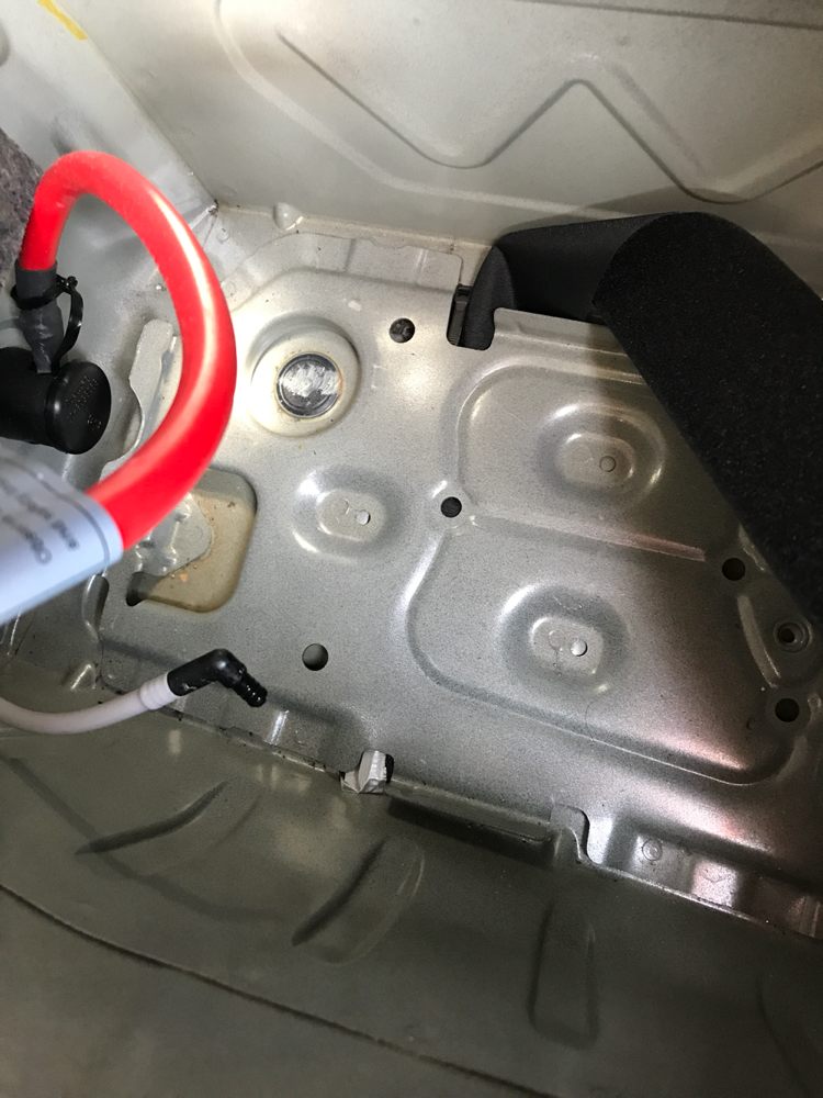

I lined the bottom of my vph900 with adhesive backed Velcro. Two 3x4" strips of it was perfect. I fed a Velcro strap under the oem battery tray as well. It worked out really well and it definitely isn't going anywhere. So I stuck it down and strapped it. The Velcro underneath it also reduces vibration.

roastbeef wroteI lined the bottom of my vph900 with adhesive backed Velcro. Two 3x4" strips of it was perfect. I fed a Velcro strap under the oem battery tray as well. It worked out really well and it definitely isn't going anywhere. So I stuck it down and strapped it. The Velcro underneath it also reduces vibration.
Sounds like a good way to go.
