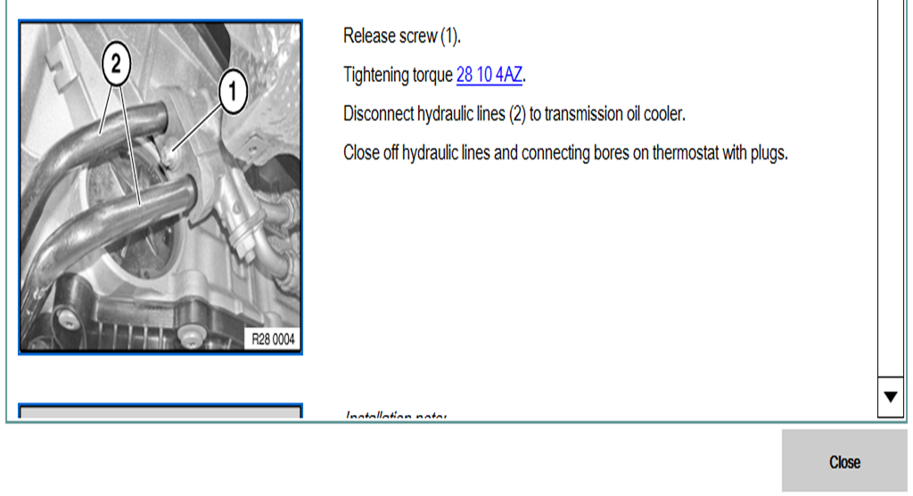

When replacing the "Pressure Filter" (28107842840), does anyone know a seal part number (or sizes if they are o-rings) to be confident no leaks occur after reinstating the "Hydraulic Lines" removed during the "Pressure Filter" replacement procedure?
Please see the attached ISTA screenshot.
Or is a compression fitting used by the "Hydraulic Lines" instead, that can seal without new parts being required?

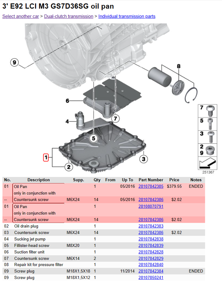

Also, has anyone confirmed with Getrag that the "Suction Filter" (28107842828) is a service item before I spend money on a new DCT Sump Pan - mine wasn't leaking last time I checked (see attached for schematic)?

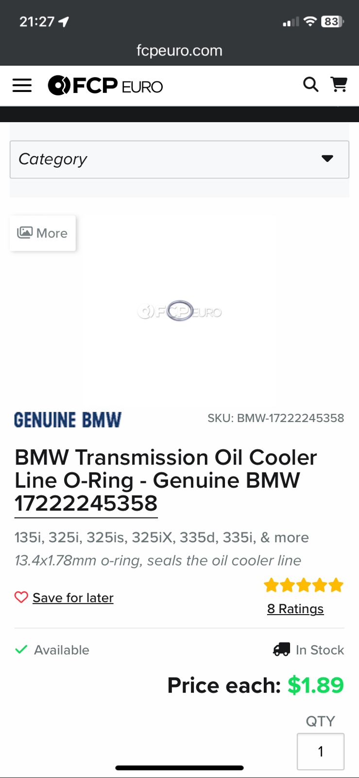

Go to fcpeuro.com and look at their DCT service kit for the part numbers you’ll need. Then find the o-rings for the tstat lines you’ll need to remove to access the pressure filter.
