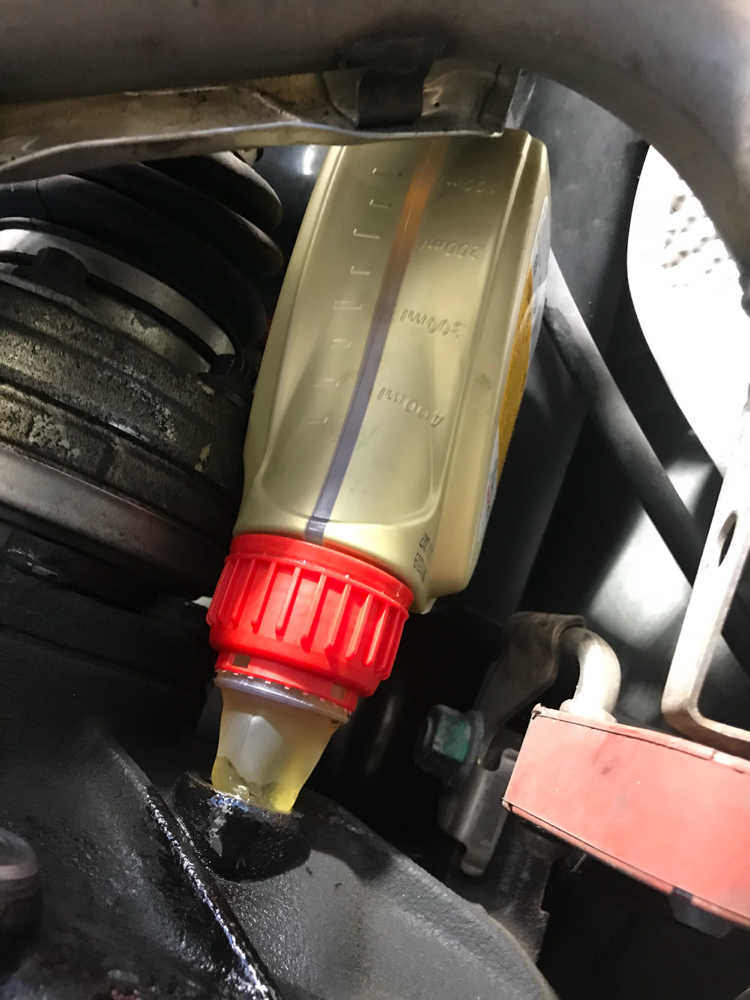

The 500ml Castrol MBZ spec bottles work great. No oil pump needed. They fit right up in there and you can walk away while they drain.

Just did the change for the second time. On the first time I used a pump and had all 4 corners up and leveled. This time I did the following.
Jack passenger side up and place stand.
Remove fill bolt followed by drain bolt.
Lowered car.
Jack driver side up and place stand.
Have a beer while it drains.
Lowered car.
Replace drain bolt and torque to 60nm.
Fill Diff with nearly 3 bottles of Castro's Syntrax.
Lower car.
Allow overflow to come out of the fill hole.
Have another Beer.
Replace fill bolt and torque to 60nm, clean off diff.
Lower car.
Have another beer.
Much easier and less clean up then my first go.

I just changed my diff fluid with this method. Drivers side lifted first will let more pour out of the drain side, passenger side up in the air will allow you to pour all 3 bottles in while lifted without pouring out. Then you drop the passenger side, let it all drain on even ground (it took about 5 minutes to stop dripping) then re-lift the car and pop in the fill plug. Done.
Only catch is on the last step my oil drain pan was too high to rest under the car to drop the car completely and let the diff fluid pour out evenly and settle, so I had to use a cardboard box instead cut in half to catch the 1/2 bottle as it settled.
I tried to think of everything, but now I need a low profile drain pan next time!
