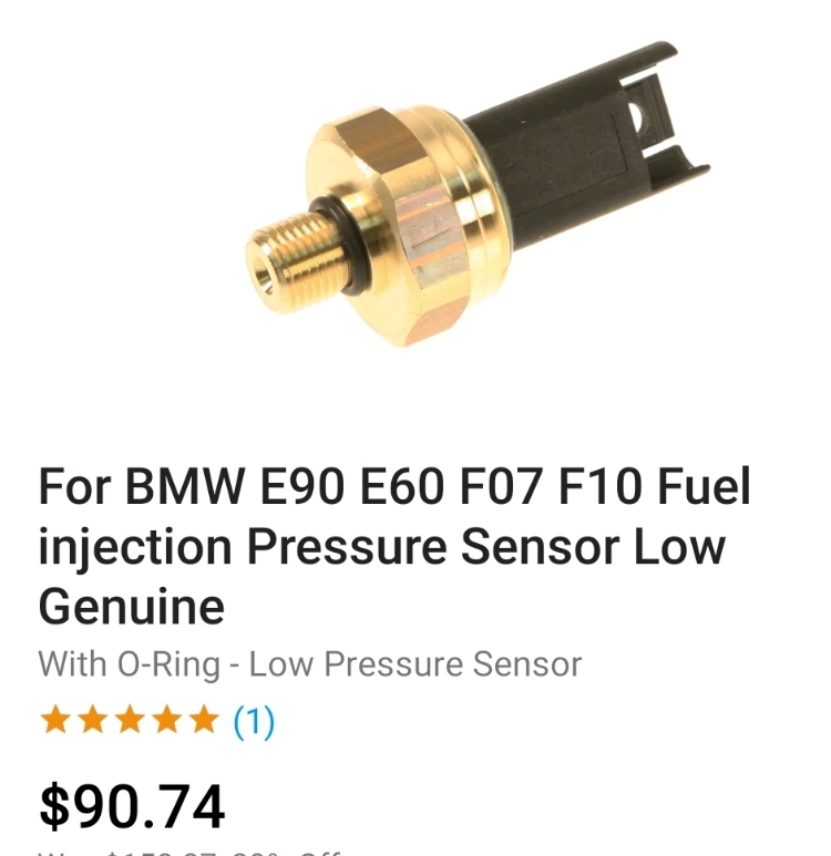

Pulled my codes, did my research and found this tread. I purchased this part from ebay:
http://www.ebay.com/itm/272130064094
It has the same model number, even tho its listed as an "X6 part"
Getting it this weekend and will install. Keep you guys updated. If it works, its quite cheaper than the OEM price.

Magnetic Fusion wroteI know I’m quoting an old post, but just wanted to report that the silver LPF sensor listed on RealOEM (p/n 13537622231) does in fact work on the M3 assuming you also order the adapter and o-ring. I don’t know why the part is different than what came from the factory, but for those of us that ordered the part and were surprised to see it was different.... it works. I thought I’d put this out there since I couldn’t find any posts where someone successfully installed the silver LPF sensor.For the Low Pressure Fuel Sensor what part number did you use? I think I ordered the wrong partI ordered P/N 13537622231 Which says "Low Pressure Sensor. I saw someone order 13537614317 (But it says for 335i/ix). I checked for a 2008 E92 M3 and I got the diagram for the part I ordered. So I think I ordered the correct part but I want to make sure.
13537622231 (silver) is listed on RealOEM as being the proper part for the E9x M3. It is cheaper than 13537614317 (brass) which is listed for use on the N54 335i.
So I am now totallllly confused. I ordered the part recommended from RealOEM via FCP Euro (and I got o-ring 13537559991). It is the silver Bosch part.
So - just to be 100% clear, the 13537622231 part is a direct replacement for the 13537614317 low pressure fuel sensor that mounts just behind the air-box on the S65 V8? Some posts discuss some "adapter" but the threads look the same (have not removed old sensor yet - just looking at photos).
Thanks for any info on this.
Cheers,
Cheers,
Pig Farmer wroteWhat adapter is required?I know I’m quoting an old post, but just wanted to report that the silver LPF sensor listed on RealOEM (p/n 13537622231) does in fact work on the M3 assuming you also order the adapter and o-ring. I don’t know why the part is different than what came from the factory, but for those of us that ordered the part and were surprised to see it was different.... it works. I thought I’d put this out there since I couldn’t find any posts where someone successfully installed the silver LPF sensor.
Scharbag wroteThe adapter is P/N 16124800029What adapter is required?
The threads do look the same, and I don’t know if it would work without the adapter, but the silver sensor is cone shaped at the bottom like an AN fitting and may protrude into the fuel line. The adapter is flat at the bottom and raises the sensor up about 1/2”.
Here’s the link to RealOEM...
https://www.realoem.com/bmw/enUS/showparts?id=WD93-USA-09-2008-E92-BMW-M3&diagId=16_0596
I changed mine with the brass one. Figured If the brass one was what was already there from the factory, brass replacement should go back in. Direct replacement, exactly the same.
