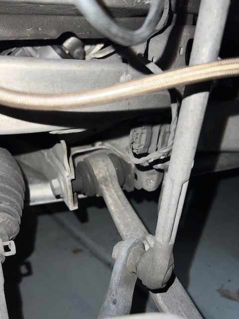

Hi Everyone,
I'm having a difficult time trying to source some sort of monoball/spherical replacement for the rubber bushing in the front control arm (not the tension strut).
The only thing I can find is a replacement for the entire arm (SPL).
Is there such a thing, or am I forced to replace the arm with an SPL type unit.
Thank you,
Steve
Thank you,
Steve
sperkins wrotehttps://germanautosolutions.com/gas-store/bmw-e90-products/Hi Everyone,
Thank you,
Steve
derbo wroteThanks, but that's the tension strut. i'm looking for the other 'front' arm.
sperkins wrotehttps://www.hardrace.com/Product_detail.asp?id=2369&Car_Make=2&Car_model=5&Car_Type=8&MainType=Thanks, but that's the tension strut. i'm looking for the other 'front' arm.
ornicar wroteClose but not quite. The description says “not for M car”
sperkins wroteThe description is Not correct. They sell a version with the monoball ever fited in the arm. I advise you to choose it because the press fit in the arm is difficult and you can destroy the monoball.Close but not quite. The description says “not for M car”
sperkins wroteI'm a little confused cause the other front wishbone is all spherical. That's probably why you can't find one.Thanks, but that's the tension strut. i'm looking for the other 'front' arm.
You can see the spherical joint and the balljoint on the other side.
derbo wroteMaybe i'm confused. What i'm looking at appears to be a mushy rubber unit.
sperkins wroteIt’s a sealed bearing like the one used by BW in the LCAB:Maybe i'm confused. What i'm looking at appears to be a mushy rubber unit.
https://www.bimmerworld.com/BimmerWorld-Precision-Front-Upper-Control-Arm-Bearing-E90-E92-E93-M3-E82.html
as
M3SQRD said, that wishbone arm is a sealed bearing. You are welcome to replace with an OEM replacement if you are concern with its condition.
M3SQRD wroteI understand now. Thank you for clarifying.It’s a sealed bearing like the one used by BW in the LCAB:
