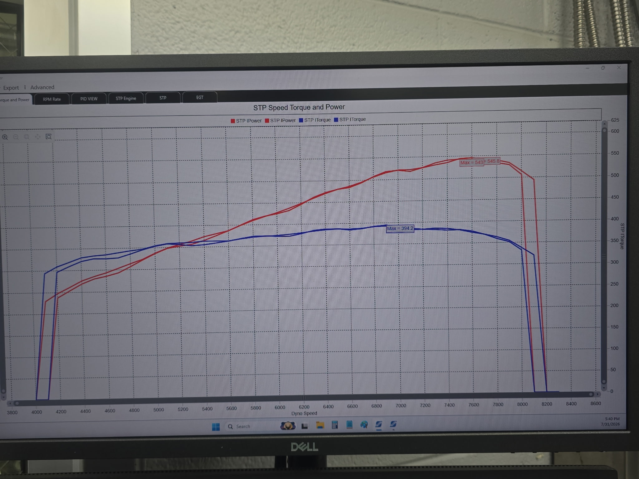

Title says it all. Matt Lambert, our in-house wunderkind tuner, just finished our first Motec tune of our 4.6L S65 stroker. 545 BHP, and I think it has a bit more in it. The 13.5:1 version on race gas should push 575-600. We shall see! Build terms can be reviewed in detail on our website, but here is the skinny:
Bore: 94mm--NBA (nothing but Alusil)
Stroke: 82.7mm
Custom Partee Racing 12.5:1 compression pistons made for us by JE
BMW S62 Rings
Stock length Carillo rods
ACL rod bearings with WPC treatment (couldn't achieve the clearances we wanted with BMW)
Lightly ported heads with Supertech valvesprings, retainers, locks and seats
Schrick 292/292 camshafts with stock hydraulic lifters
SRD oil pump gears
Stock injectors and coils
Tuned on a Motec M190 with full CAN-based control of throttle actuators and idle control valve.
