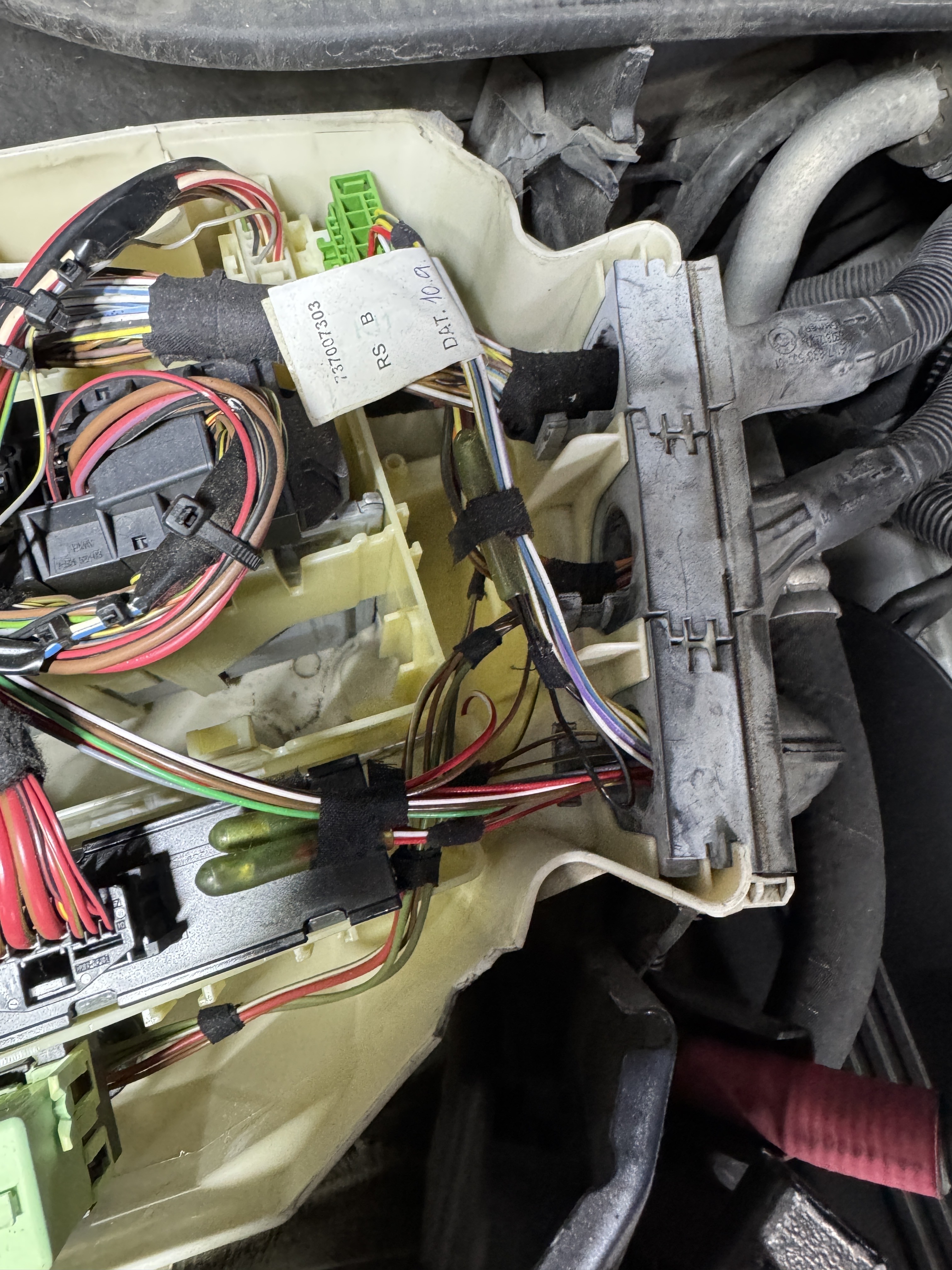

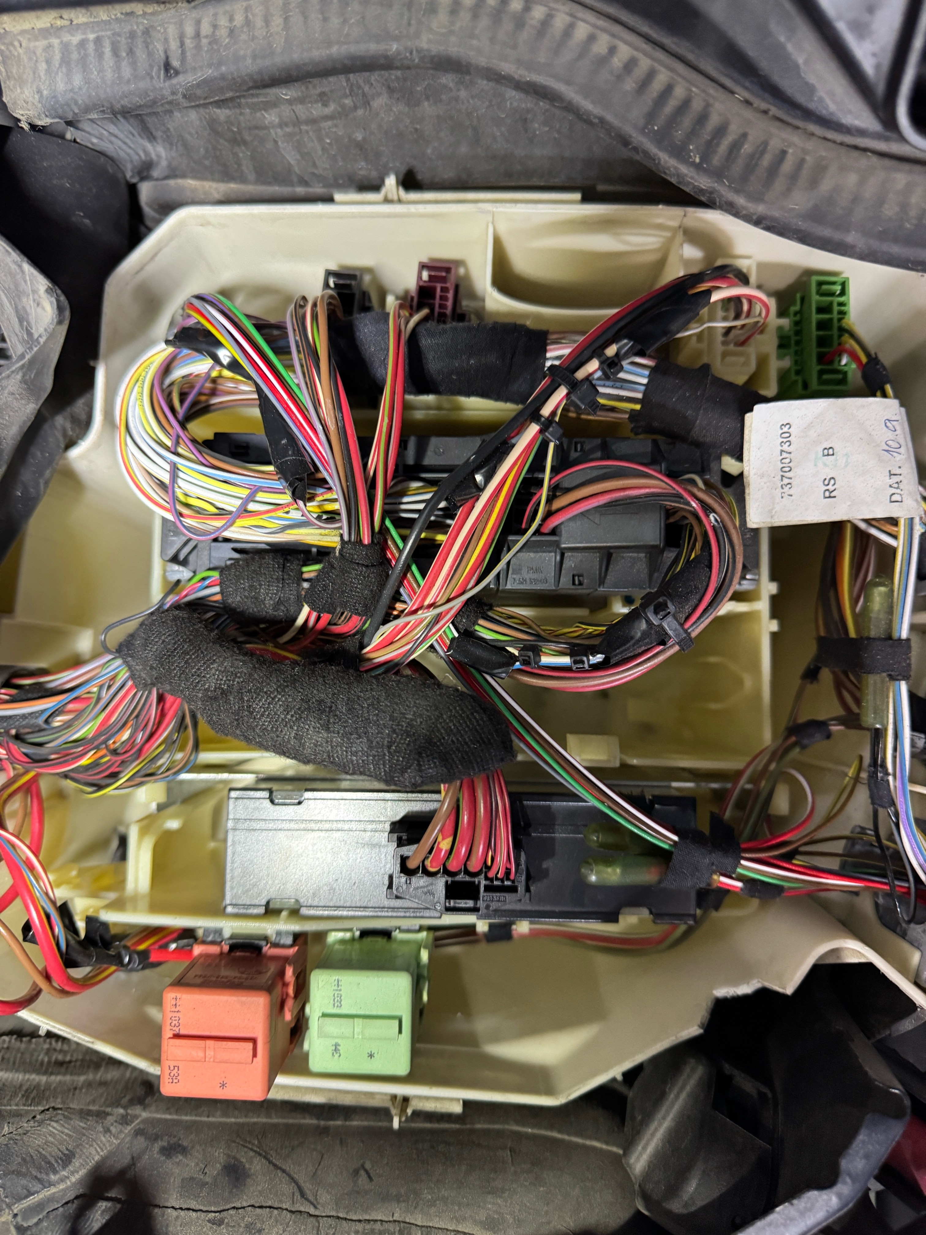

Can someone provide a picture of the Ecu sitting inside its compartment with all the wiring routed in its stock configuration. I took it out but forgot to snap a photo.

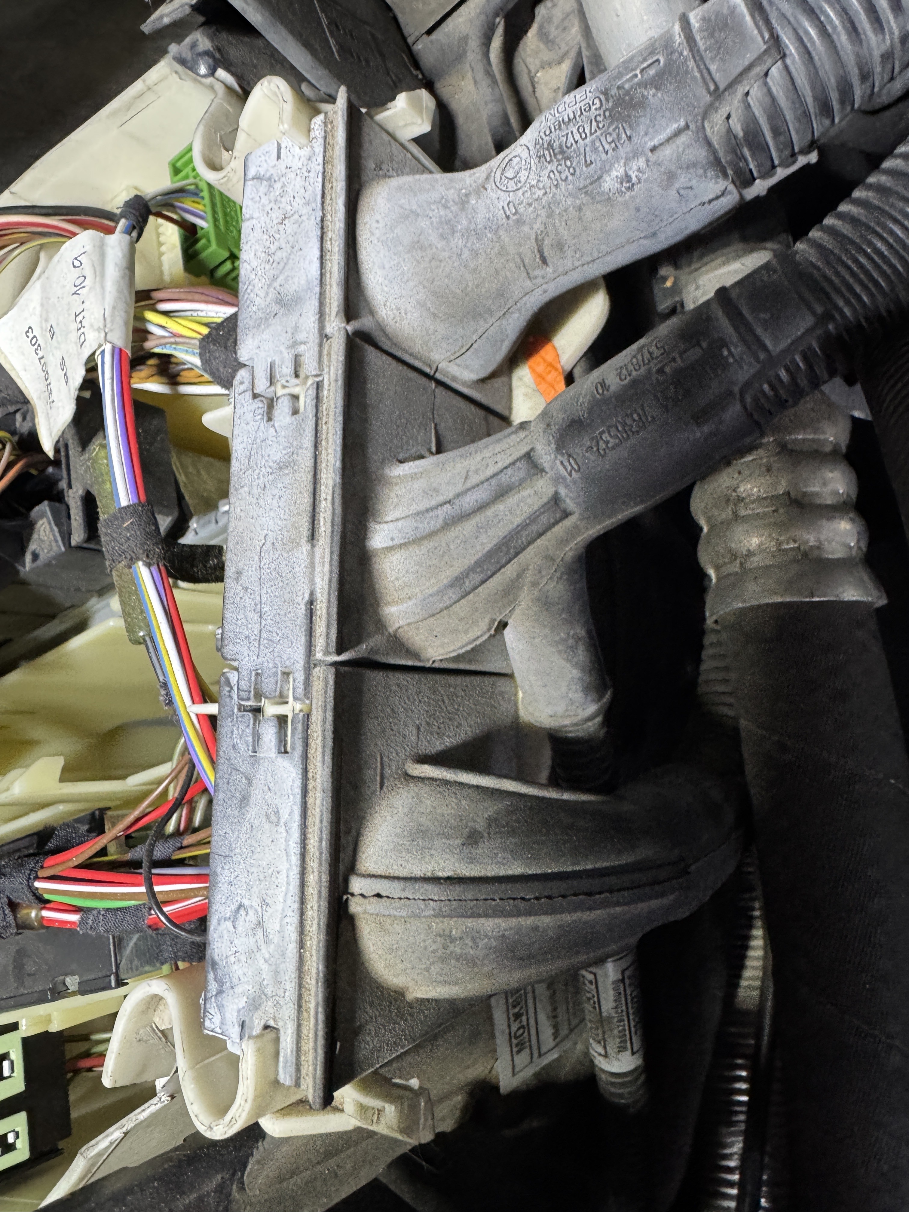

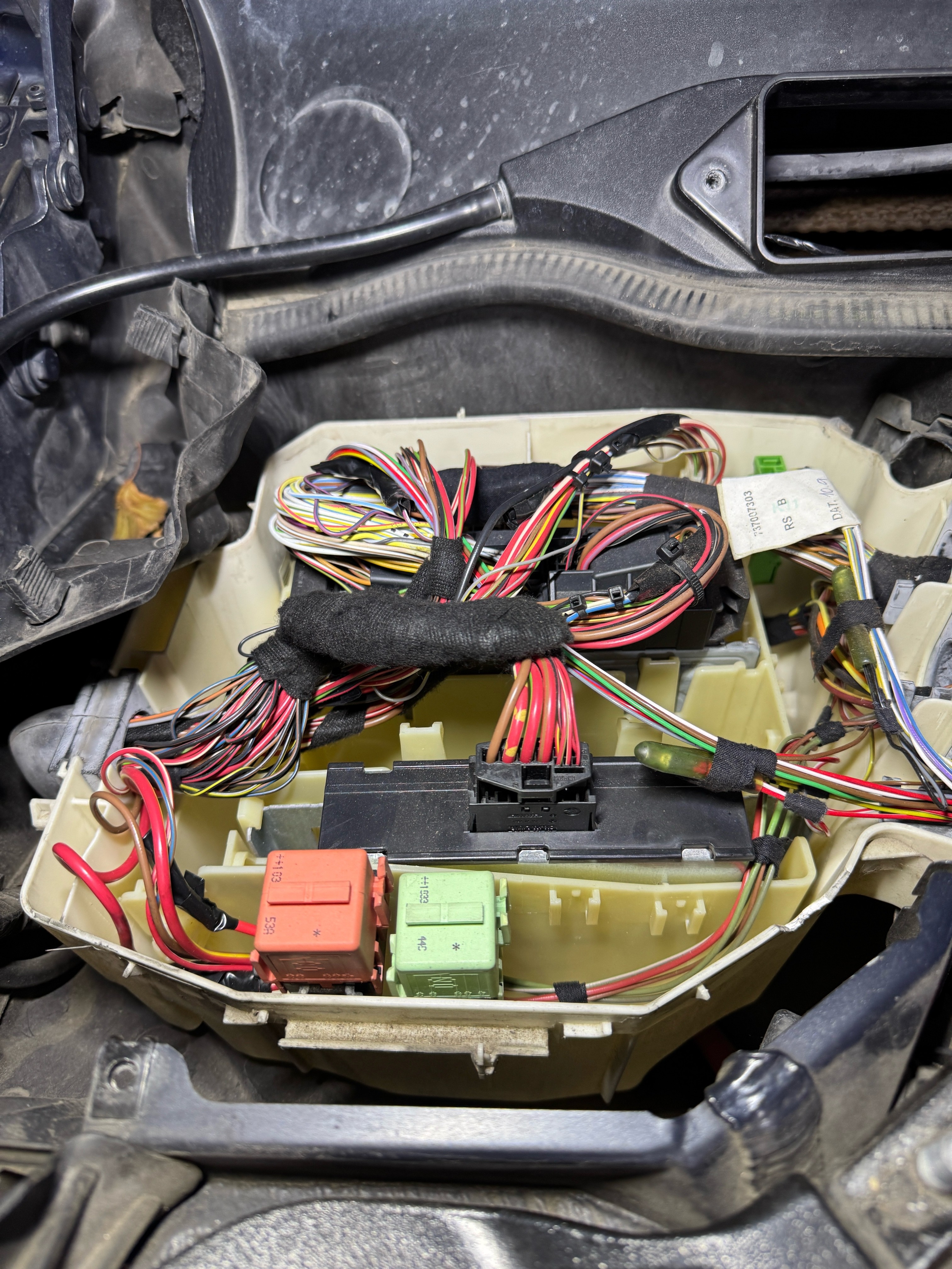

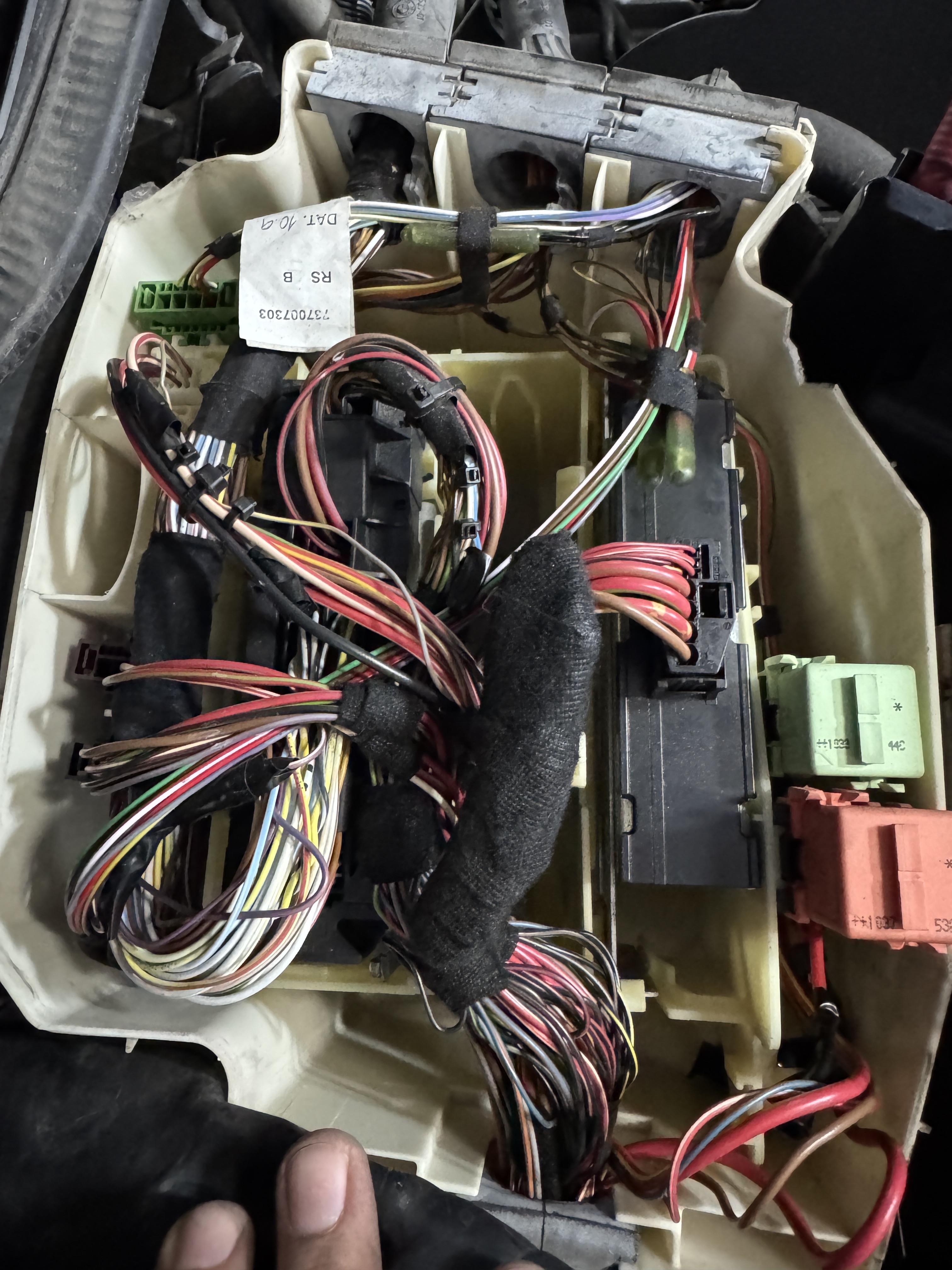

Here you go
I’m assuming this is a DCT car. It has a little more than my 6mt.

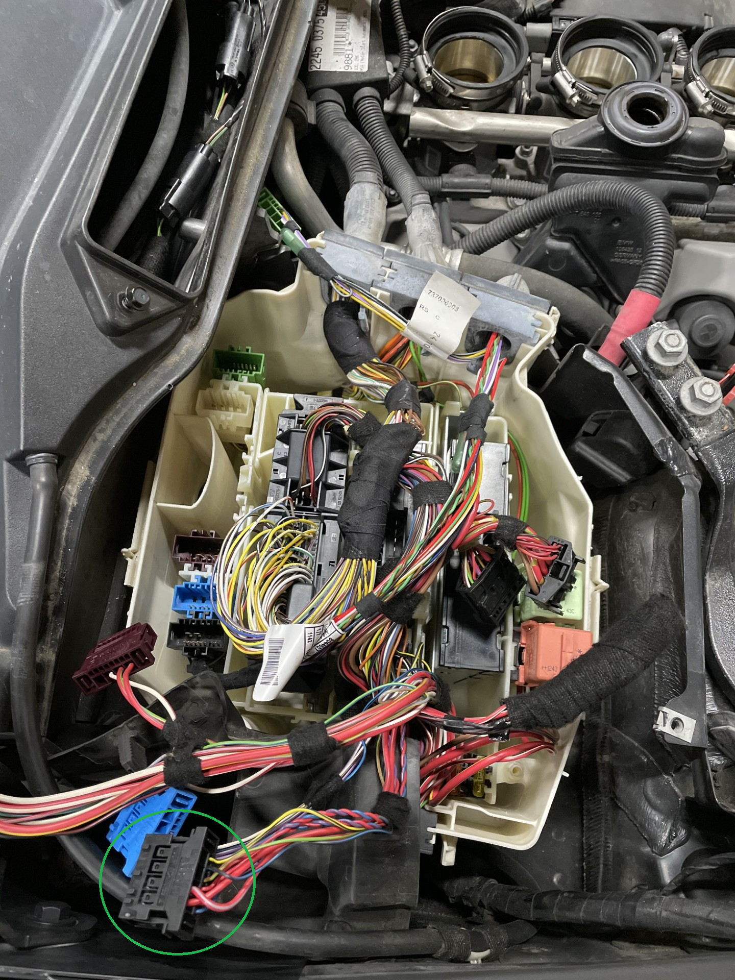

That doesn't appear to be a DCT. There were slight differences based on options.
DCT plugs (blue and black) circled here:

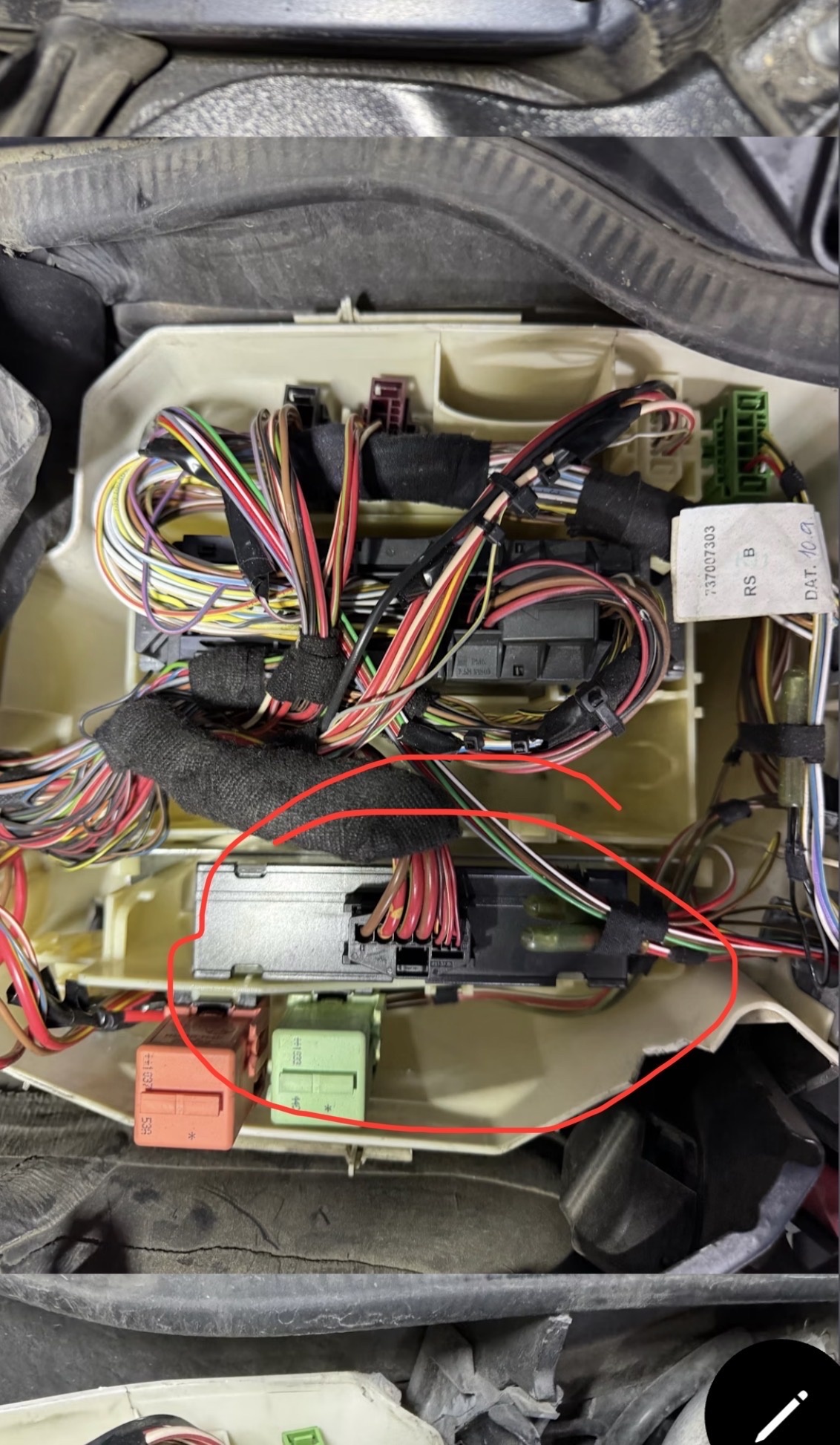

Just curious. What is the little black box parallel to the pcm?

PCM? The DME? (Engine computer?)
I think you're talking about the power supplies. Mine has two, the other pictures only have one. They provide a clean voltage rail for sensors and such.
My car does not have this
That's fine. Mine has two, Camas' has one. Like I said, there are many configurations based on options and build date.

It’s a manual transmission car, I don’t know what the module you circled is offhand.
that is the DC to DC “Wandler” Module - only equipped on cars with MSA (Auto Start Stop). Pre 2011.5 or .75 won’t have it :)
