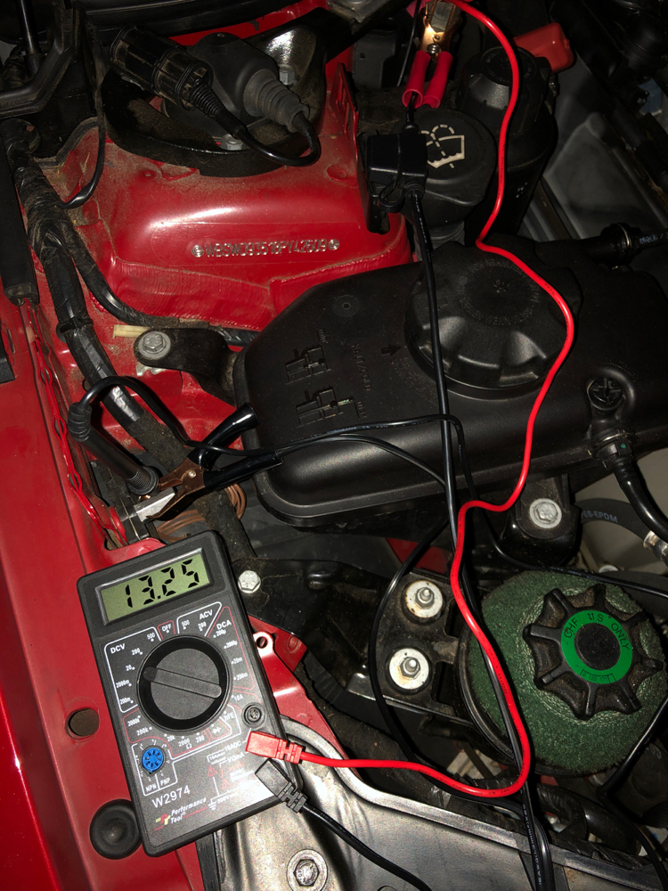

I also took video of the start cycle with my multimeter attatched to the under hood terminals. Voltage was 12.3 at rest and dropped to 10.2-10.9 while cranking.

Just to confirm it isn't my LiPo battery, I swapped in the AGM with the same results. I also took video of the start cycle with my multimeter attatched to the under hood terminals. Voltage was 12.3 at rest and dropped to 10.2-10.9 while cranking. I knocked around the fuse box a bit and pushed the connector on the top left of the fuse box again and on the next start, it ran but quickly died so it really seams like there is a loose connection somewhere. Reached back out to the service manager earlier but got voicemail again, about to call again.

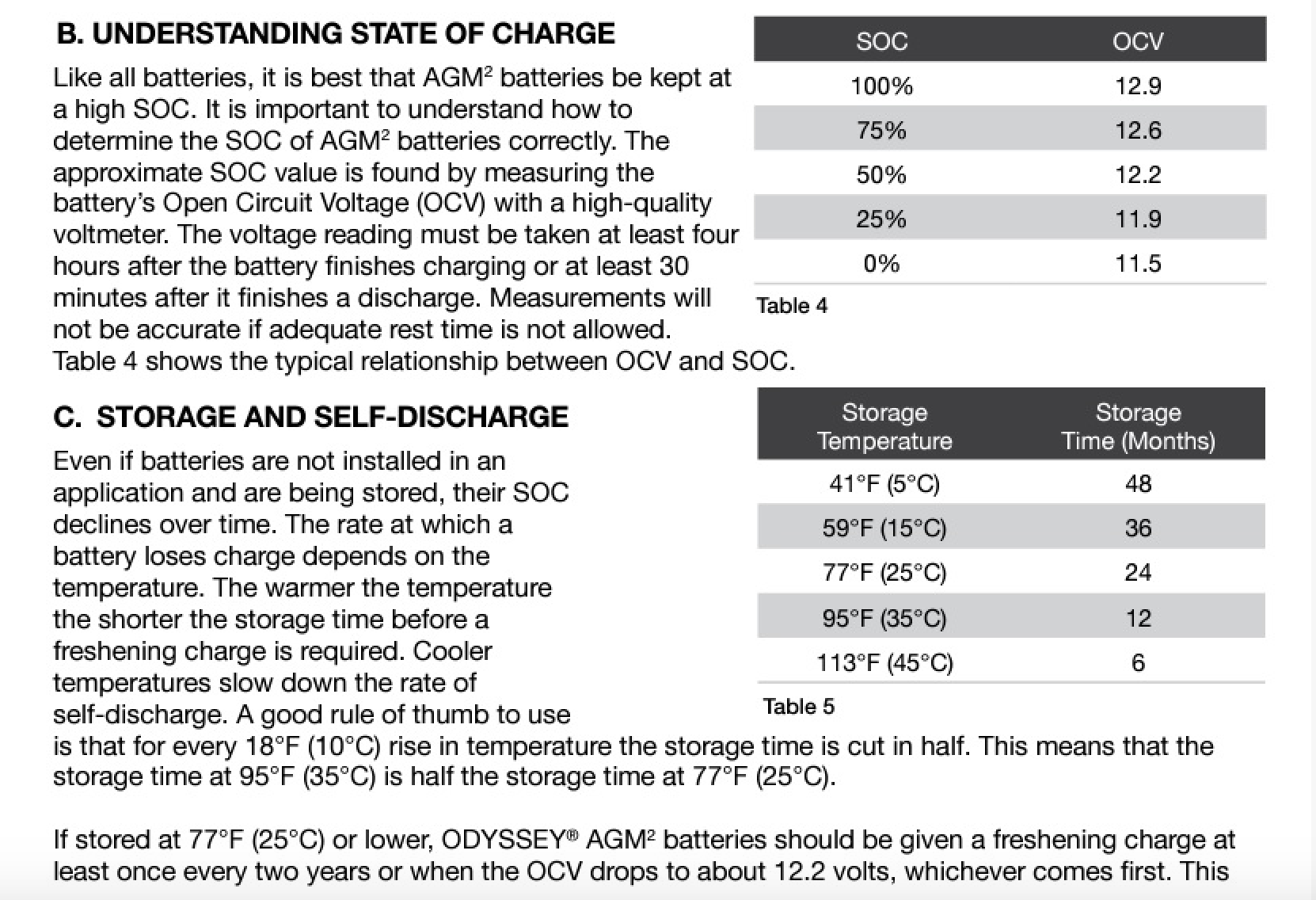

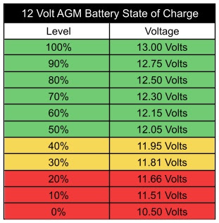

The surface charge voltage on a fully charged OEM AGM battery is about 13.0V to 13.4V at rest. 12.3V shows the battery is partially depleted and may not start the vehicle. A loose connection is very probable but the issue could also just be a bad or depleted AGM battery OR both.
I do think the AGM battery is partially depleted, it would only charge to 72% on my charger before it went into trickle/maintain mode. the LiPo battery was showinig 13.1 when I checked it out of the car. I'd be curious what the voltage shows on the AGM when the car is asleep.

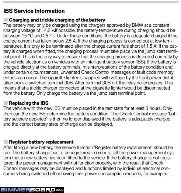

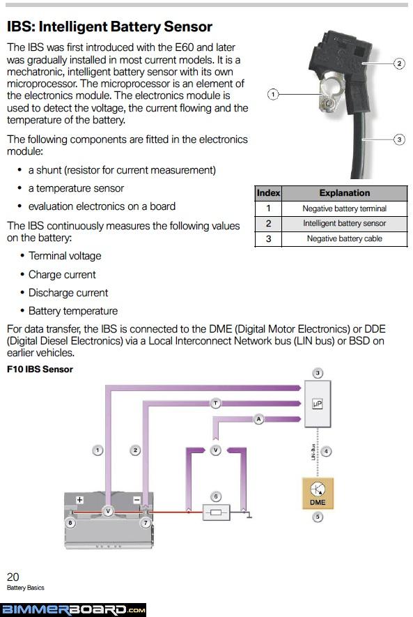

Check the IBS (Intelligent Battery Sensor) blue connector plug is properly seated. Check the alternator output when the engine is running (it should be about 13.4 to 14V output and see the Intelligent Alternator Control manual attached). Then clear the codes, take the car for a longer drive e.g. 30 miles or more and see if the codes resurface. If they do, the list of codes smell like a bad ground, or possibly the battery cable recall splice still not thoroughly debugged yet. Be patient. A list of codes like that is typically caused by low voltage gremlins while driving. There is a way to monitor the voltage when driving via a hidden menu accessed through the BC column stalk. I don't recall how to access that hidden menu but YouTube will. Sorry you're having so much trouble. It's a long shot but the non OEM battery could also be contributing to the problem(s).
Edited: Added video and IBS/IGR Manual attachment.
