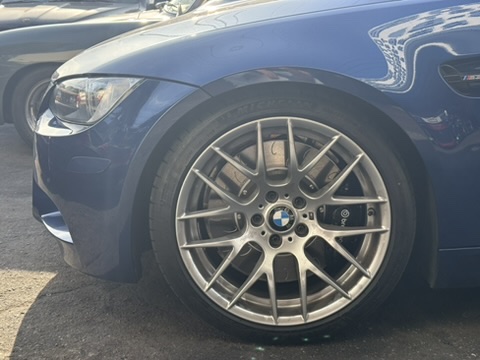

Fast forward to 2019 and I realized I wanted to get back into one and had been searching around for a while before I stumbled upon a 2012 Le Mans Blue E92 M3 comp with a six-speed manual that was a two-owner car with only 44,000 miles on it. It was the scariest but easiest spontaneous purchase I've ever made.
This time around I decided I wanted to stick very OEM Plus. So all I did was change the exhaust a few times and And installed some wheel spacers to set up the stance along with a shorter OEM M performance shift knob.

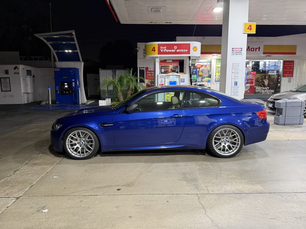

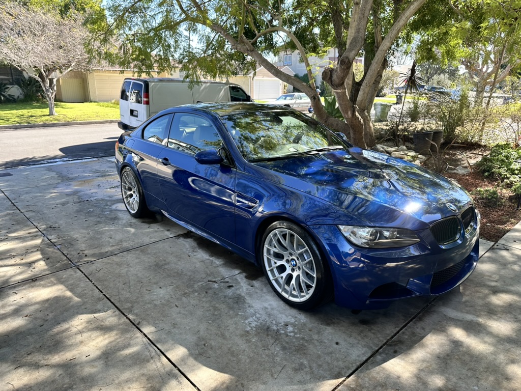

Fast forward another 11 months, and the same friend I had sold my first M3 to sent me a bring-a-trailer link to an E92. With the corresponding message saying, "Is this your old M3???". I couldn't believe it, but it was my exact car with only 400 more miles on it and a new set of rod bearings installed.
It truly felt like one of those once in a lifetime romantic car guy opportunities. And after pondering whether or not I should do something that felt insane for about a week, I decided, screw it, I'm going to get this car back.
https://bringatrailer.com/listing/2012-bmw-m3-coupe-52/
Yes, I probably overpaid for it, but can you really put a price on car guy lore? I think not. 3 days later it was being unloaded in front of my house.
It was exactly as I had remembered it, but was back in its stock form from doing the trade-in, so I had a clean slate to work with once again.

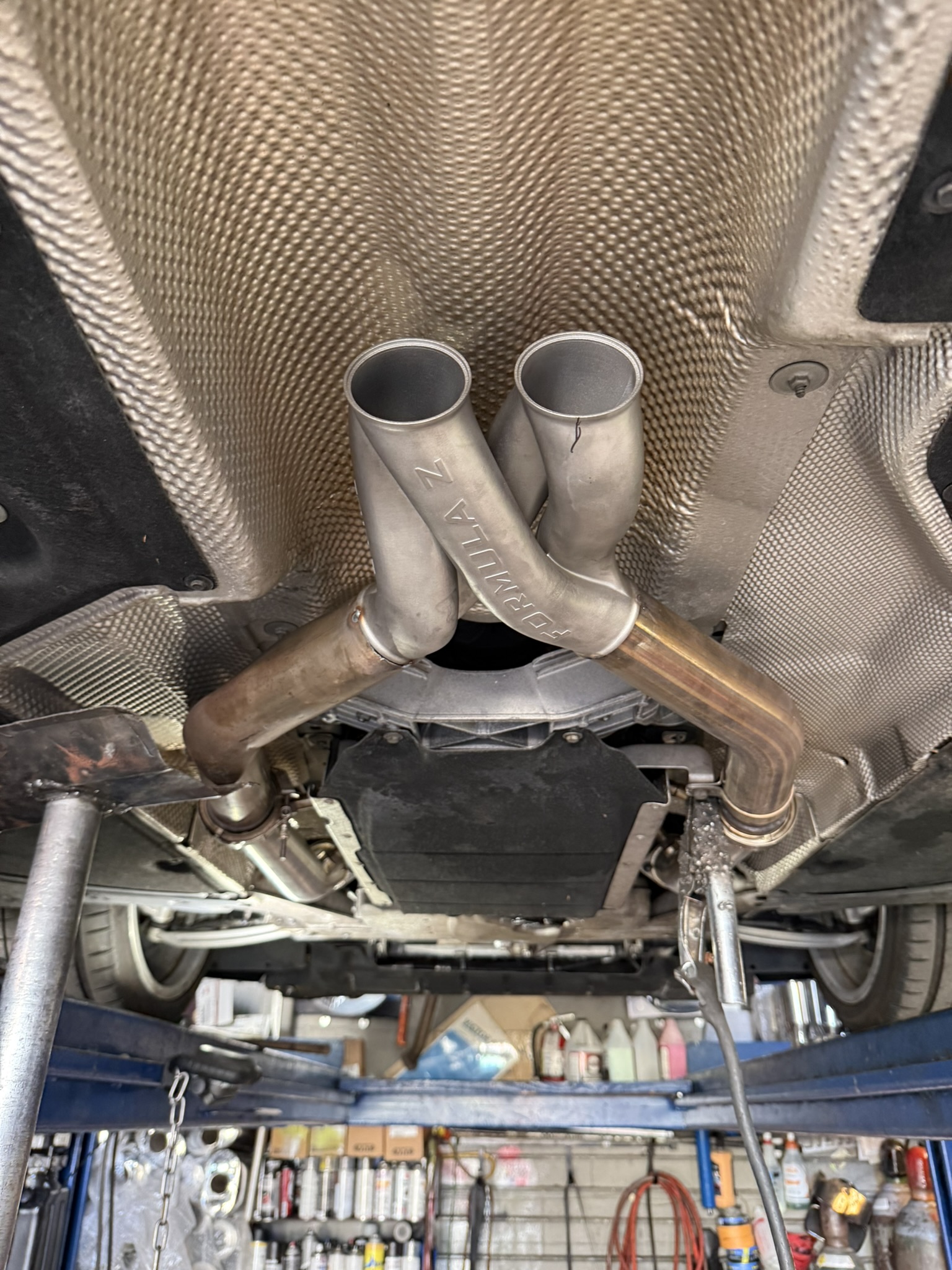

First order of business was getting an exhaust on the car again, as it had been put back to stock to do the trade-in. I've done probably ten different exhaust configurations on these cars between the two VINs, but I wanted to really push the boundaries of of what people were doing to these cars.

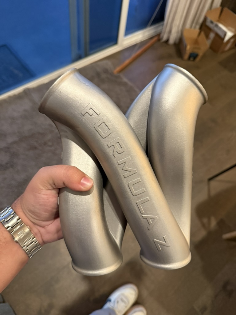

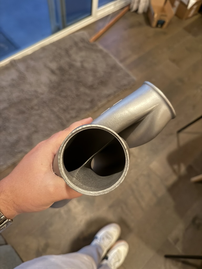

Around this time, the first Z-pipes were being manufactured, which for the uninitiated are 3D printed stainless steel crossovers that do perfect merging between the two banks. I decided I was gonna buy one and just make it work. Attached image
I paired this with a Borla Atak rear section that I actually still had in my garage from when I sold the car a year prior, but this setup was just insanely loud. While too loud, I could tell that the Z-Pipe had brought out a new tone in the exhaust. It had a new smooth high pitched scream to it that none of my previous systems had. I decided this time around that I wanted to do something with valves as my other cars had them and had grown to love the capability of switching between quiet and loud. The hunt was on for the perfect system to complement this new sound.

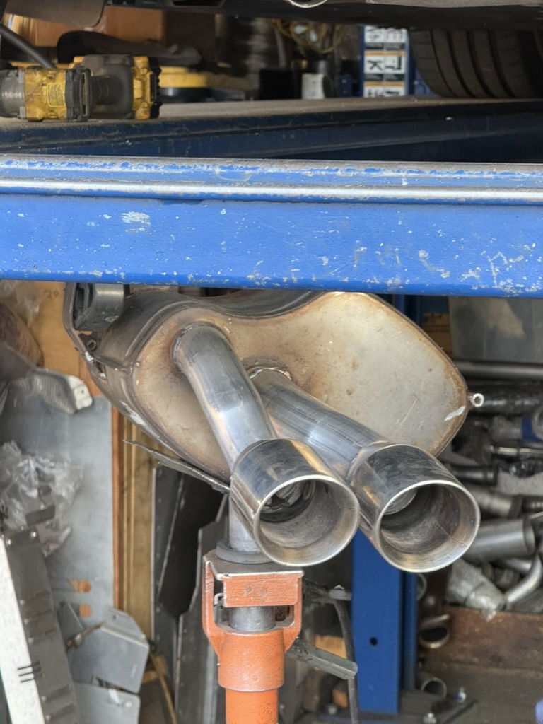

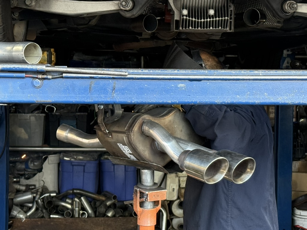

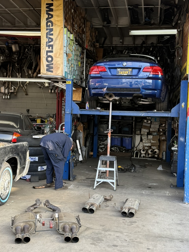

To me, one of the best sounding smaller displacement V8s ever made is the Maserati Gran Turismo 4.2 and 4.7 V8s. After a bit of research I discovered that the 4.7s all came with valved mufflers from factory that were actuated by vacuum. A quick trip to eBay revealed that these mufflers could be had for about $700 used. I also discovered that they use the same two and a half inch diameter piping and have two exhaust outlets per muffler. So it was possible that I could retrofit them theoretically.
At this point, I knew I was potentially going deep off the reservation into uncharted territory. But for $700, the risk felt tolerable with the opportunity to have something truly unique and at a cost comparable to even the cheapest of aftermarket systems. I ordered a set off eBay, and a few weeks later they arrived.
When I brought them to my local exhaust shop, the shop manager thought I was completely insane. But after going through the layout of the system, he conceded that it was potentially possible and got to work trying to implement it. I give them all the credit for making this Frankenstein system work.
To prevent having to fabricate up fresh connecting pipes, I brought an additional rear section that I had laying around in my garage and had them harvest the connecting pipes and exhaust tips from that system to graft onto the Maserati mufflers. They then fabricated small adapter pipes that connected the harvested connecting pipes to the mufflers as well as small connectors from the Maserati outlets to the M3 factory exhaust tip locations.
Much to everyone's disbelief, it actually all fit.

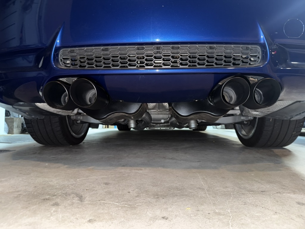

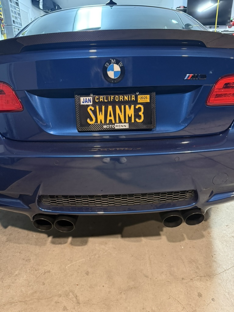

We then installed an ECS tuning universal exhaust valve actuator kit and hooked it up to the Maserati valve ports. I keep the remote for the valve controller in my center console and I think this is the first in the world E92M3 to use Maserati Gran Turismo valved mufflers and it somehow all works.
Now for the sound, it's absolutely insane.
With the valves closed, almost all of the lower register of frequencies is successfully cut out and doesn't drone except for a tiny window at 2000 RPM, as many E92 systems do, and the higher frequencies where rasp would be are completely cut out without killing the midrange tone. One of the things that I liked about the design of these Gran Turismo mufflers is that they don't simply choke the exhaust flow by closing a valve on the main exhaust path. What they actually do is route the flow through a muffling chamber that uses smaller diameter piping to both raise the resonant frequency and also reduce the overall volume of the sound without completely killing the tone that was coming through the system already. Interestingly, the harder you drive the car, the quieter the exhaust actually sounds as the extra gasses create turbulence in the system that washes out the sound. But when cruising around with the valves closed, you still get all of the tone that the motor produces.
When open, the car absolutely screams, but still has a refinement to the sound that, as cliche as it sounds, is nothing short of exotic but with a filled in meatiness down low. It is without question the best sounding car I've ever driven, and the best sounding system I've heard on an e9x. The open valve path in these mufflers still utilizes a small amount of resonation internally, so there's still a rasp reduction happening that smooths out the gnarliness that these engines are capable of producing, leaving a clean, crisp, wailing shriek.
I'll do a proper video documenting the modes both inside and out as I really think this is one of the best systems you can put together for the E9X platform.

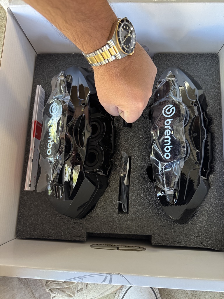

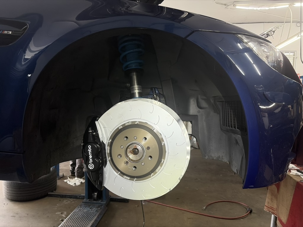

Now that I had the sound dialed in, it was time to make this car drive like the sharpened, aggressive streetcar that I wanted it to be. My goal could be summarized as wanting to achieve the visceral sharpness of a 997 GT3, wrapped in the body of an M3.

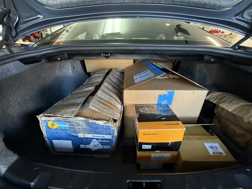

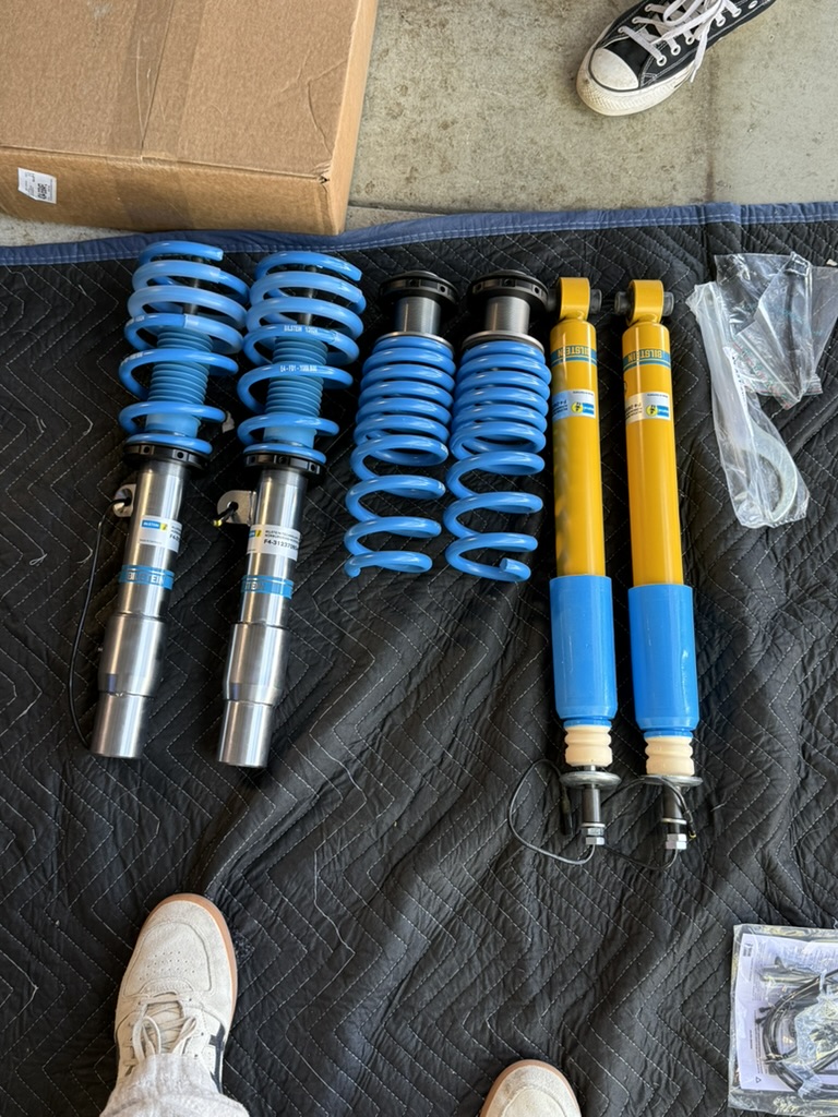

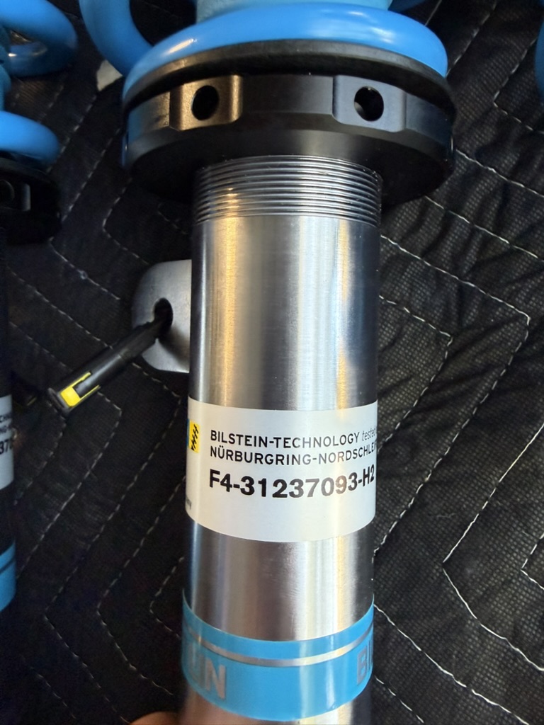

Santa sure knew what I wanted this year, and boy did he deliver:
  • OEM F80 M3 front & rear brake calipers & pads
  • O34 Motorsport 2 piece J Hook Rotors
  • F80 Front Spindles
  • Bilstein B16 Damptronic Coilovers
  • Syncro sealed monoball control arms
  • Millway Camber plates
  • SPL Adjustable Swaybar Endlinks
  • Turner Motorsport Aluminum Rear Subframe Bushings
  • Autosolutions SSK with intermediate hardness linkage bushing

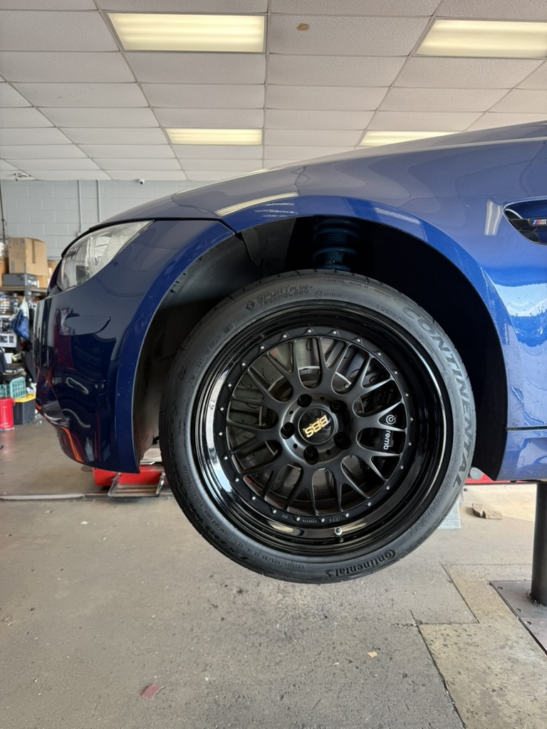

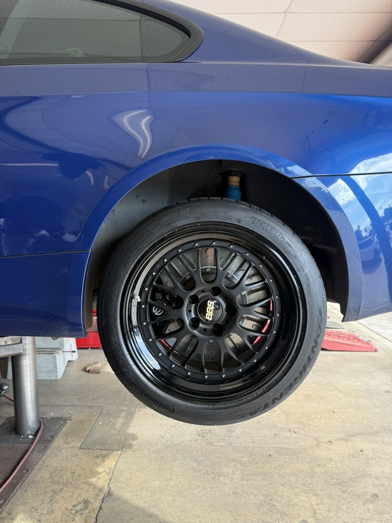

All of these parts were installed in one go at Star Autosport here in LA and the transformation from stock to current cannot be overstated. The car is now razor sharp and has a tactility that's unrivaled by any other modern car I've owned.

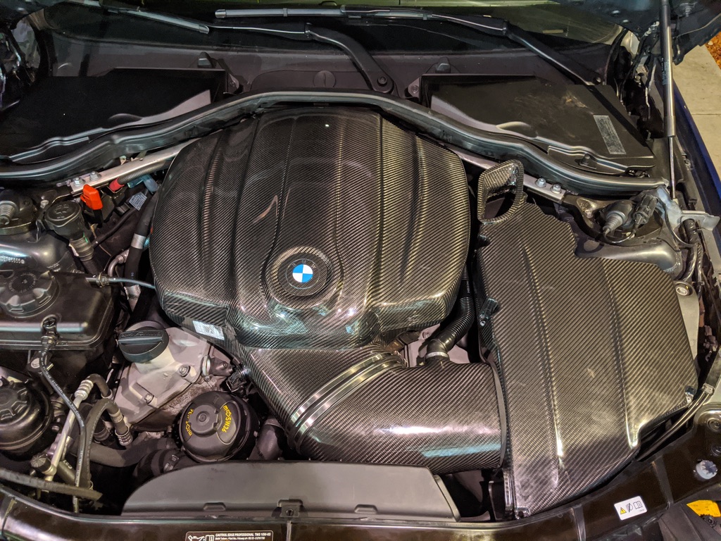

  • Karbonius Full Carbon Plenum & Intake
Between the three of these the car pulls noticeably harder through the rev range and the interior sound between the Karbonious and the full exhaust setup is just unbelievable. The larger internal volume of the karbonius drops the resonant frequency such that it sounds like it picked up a liter of displacement.

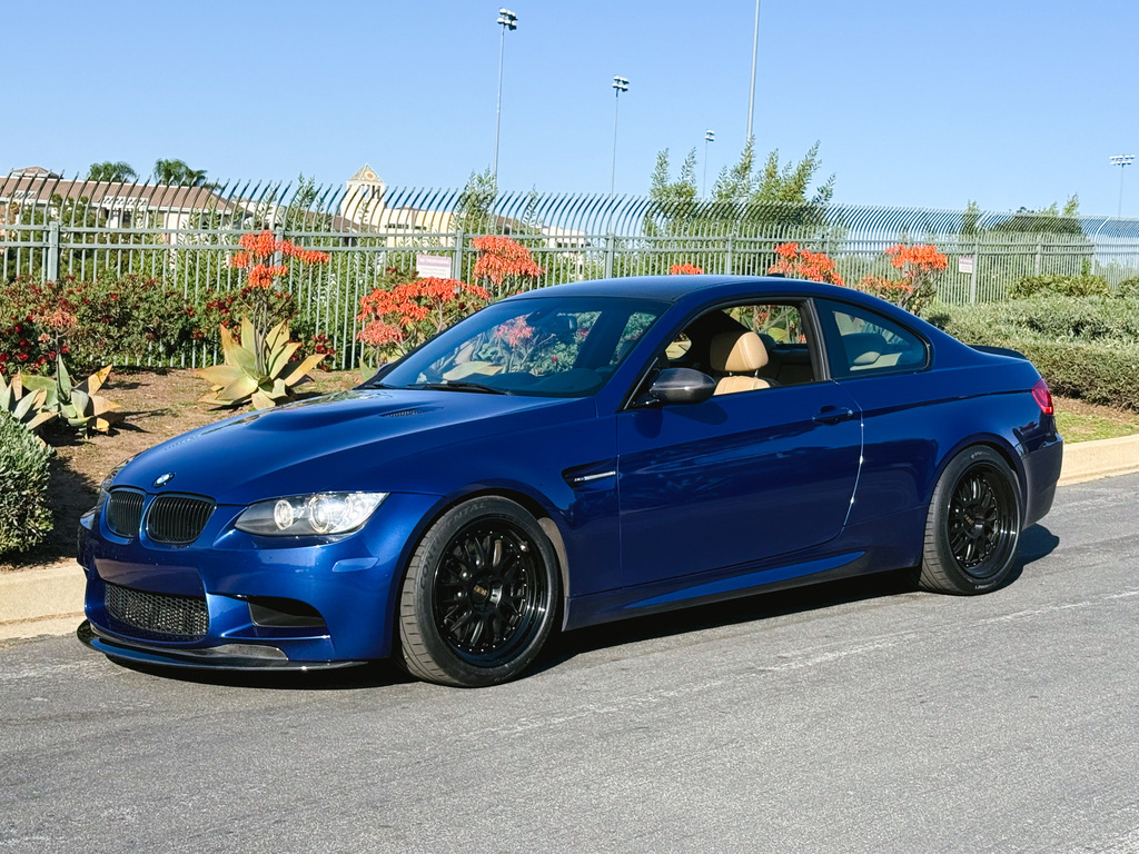

At this point the car drove and felt exactly how I wanted it to. It was just a matter of completing the visual package.

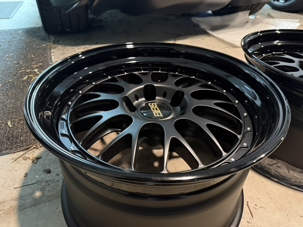

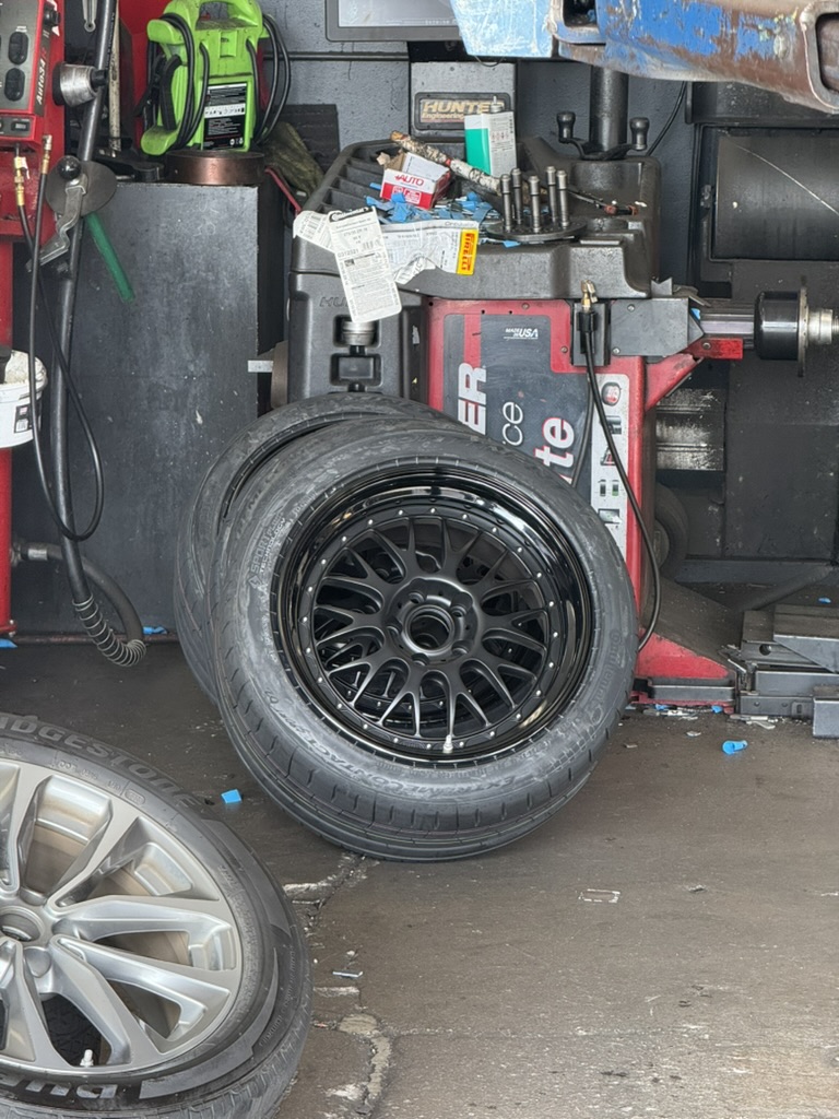

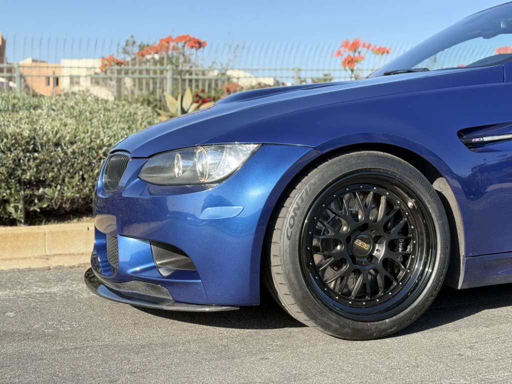

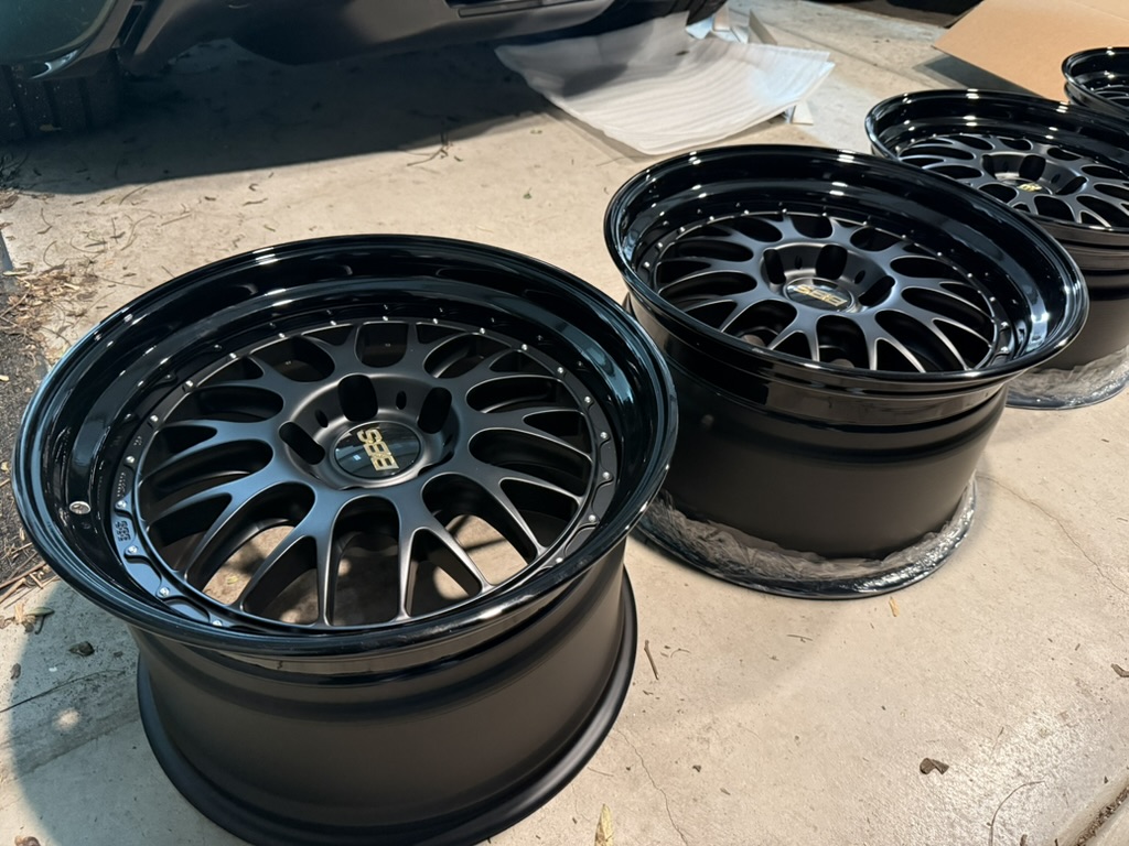

  • 18x10/11 ET25 BBS E88 wheels in satin black with gloss black lips and gold BBS center caps from Ehrlich Wheel Works
  • 275/35/18 & 295/35/18 Continental Extreme Contact Sport 02
  • RW Carbon GTS front lip
  • IND painted roundels & trunk badge
  • OEM Black Chrome side grilles with new LEDs
  • Autotechnik Carbon Mirror Caps
  • Custom leather wrapped M Performance Steering wheel
At this point I think the car is pretty much complete, but who knows, maybe I'll do some Recaros at some point in the future. It's been quite the journey, so thanks for reading and providing inspiration over all these years!
