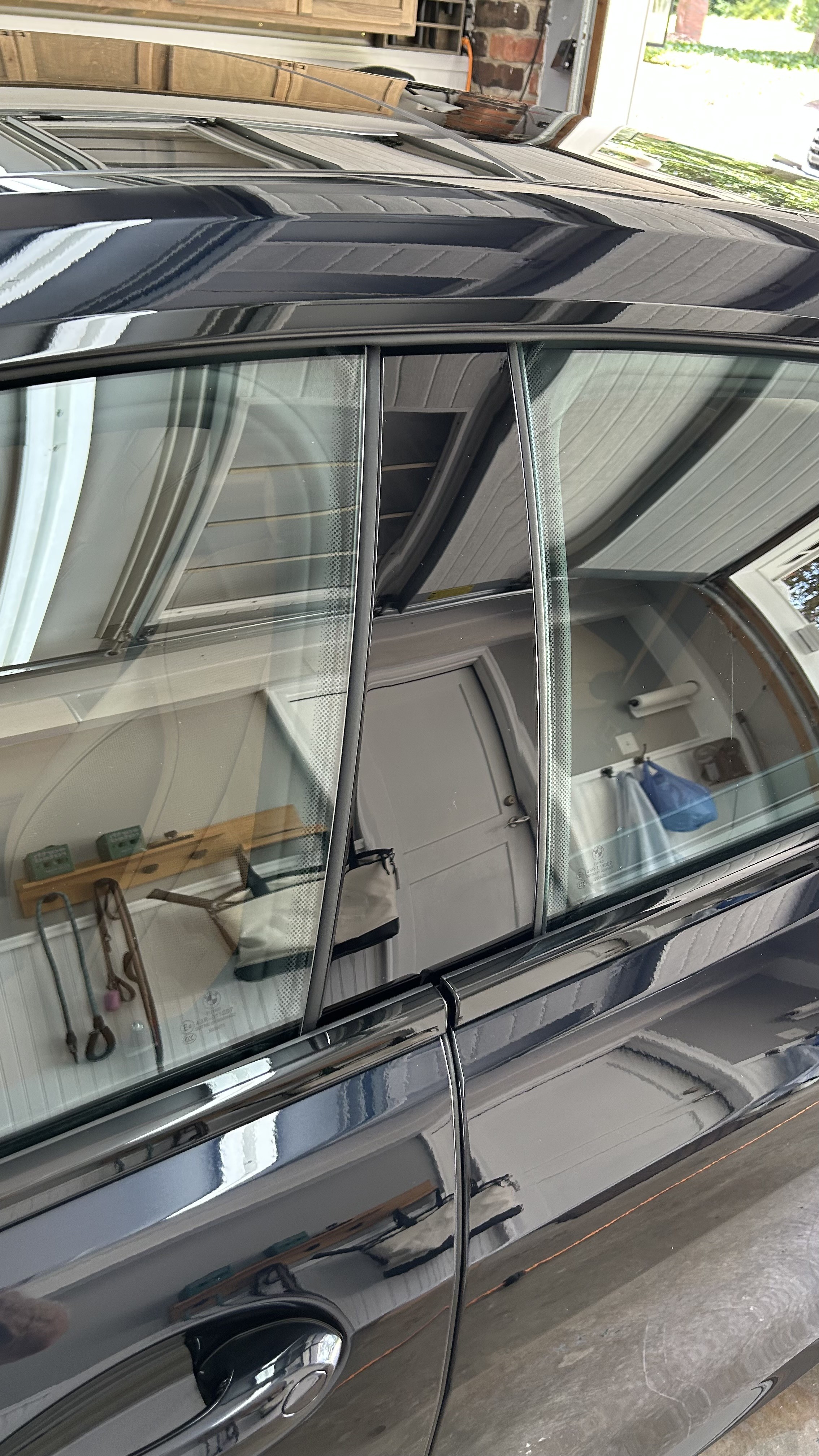

I just got the 840 a few weeks ago. Every time I walked up to the car, I couldn't not look at the fine scratches and swirls on the vertical panels between the doors. I started with Griot's perfecting cream and a black Lake Country pad. So that's a very mild correcting compound on a polishing pad. The next step was a ceramic wax on a black pad. It took very little to make the panels look new again.

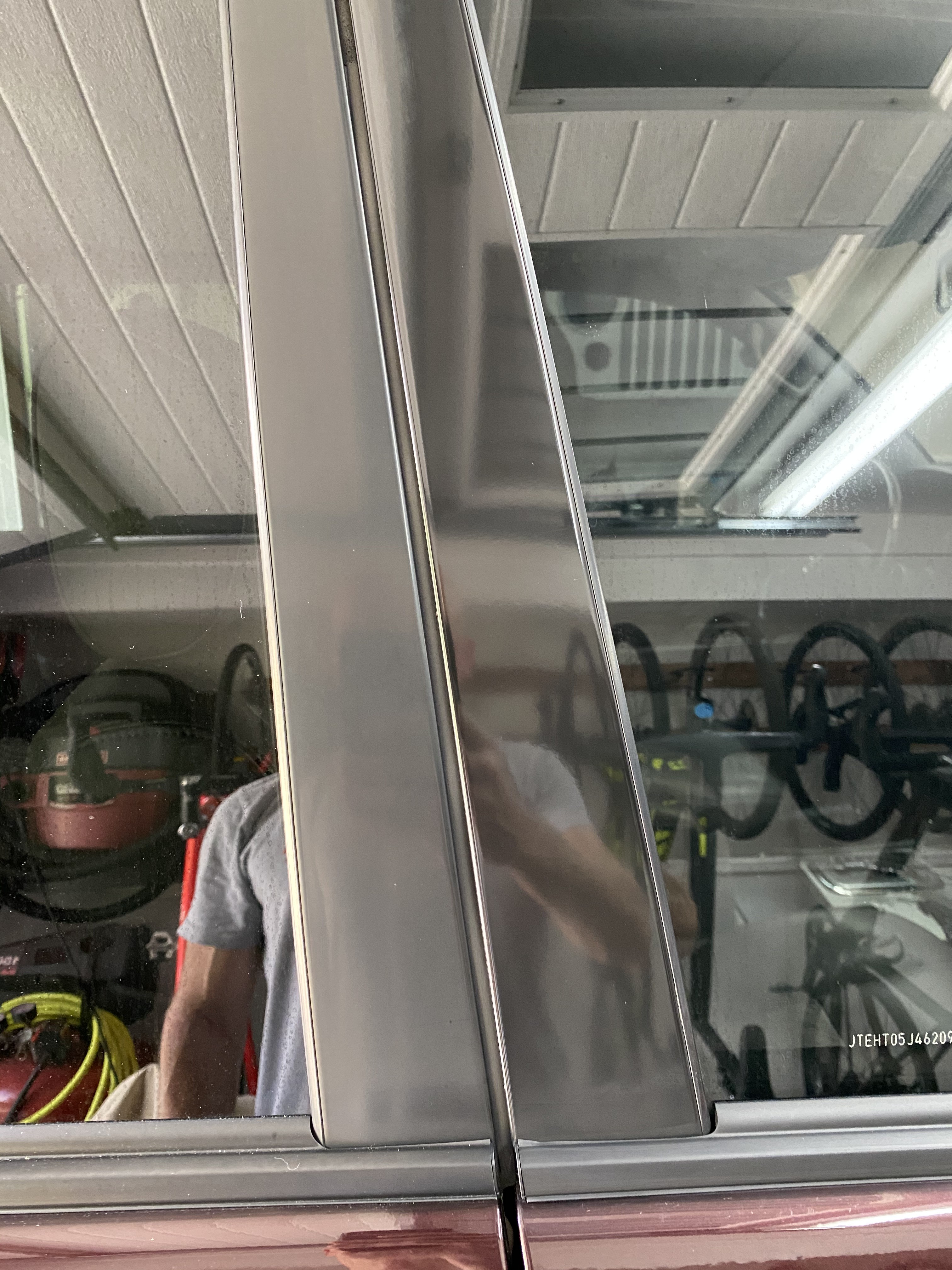

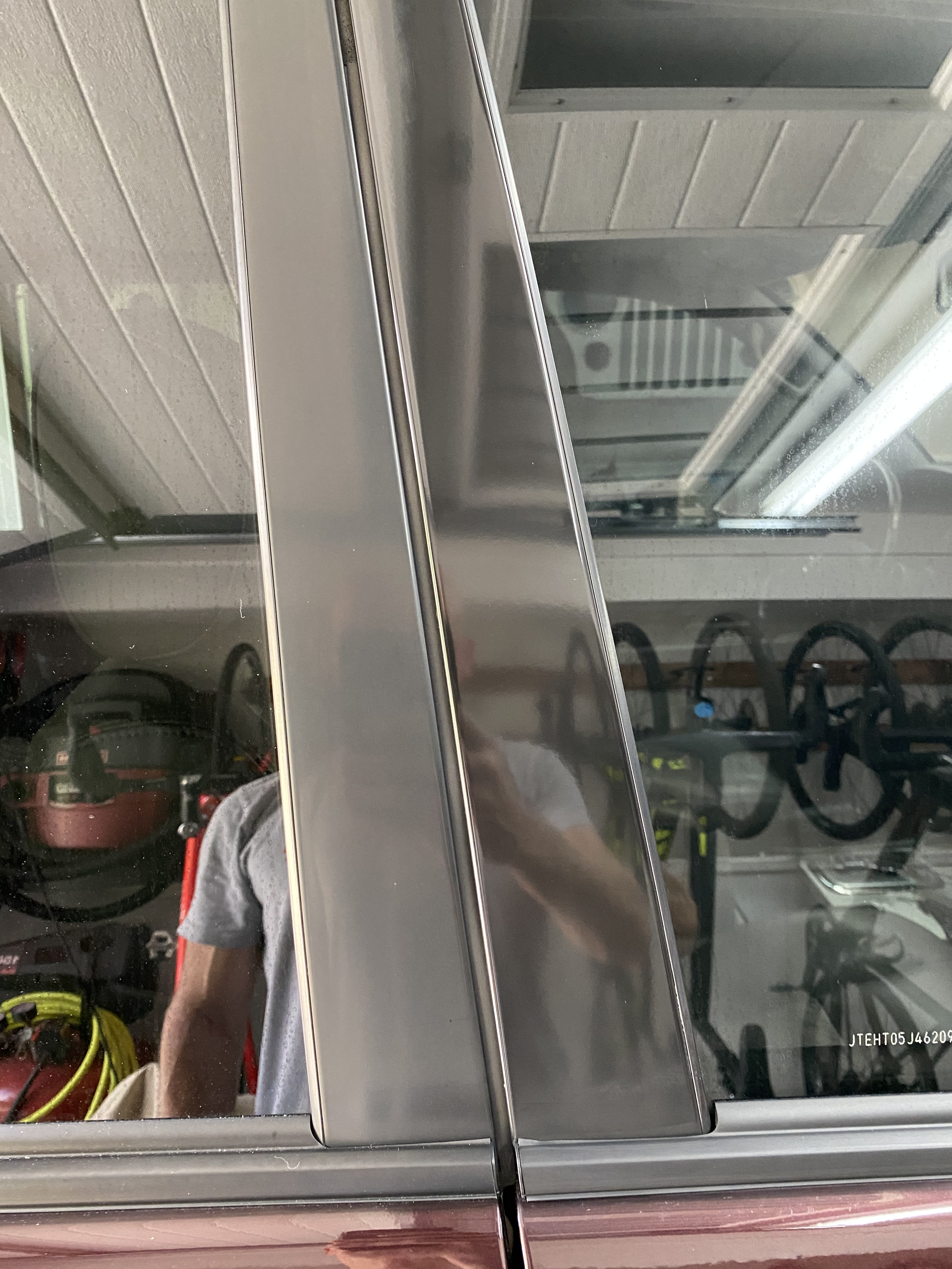

My Land Cruiser is 20-years-old and lives outside in the Atlanta sun. It's also seen lots of branches up close. I started with Griots correcting (not Fast Correcting) cream and an orange pad - both more aggressive than what I used on the 840. I worked my way up from there. And, I didn't try to match the finish on the 840. That pic shows one panel done, the other up next.
