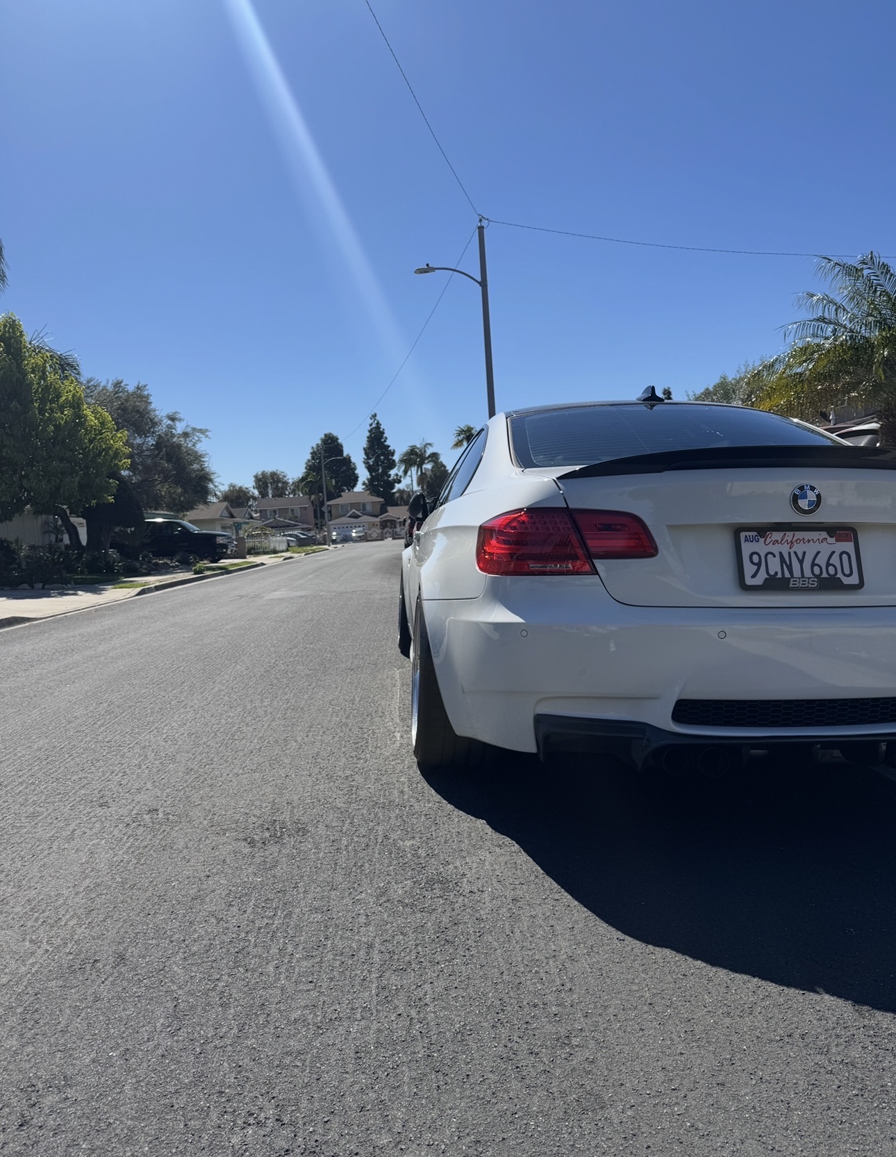

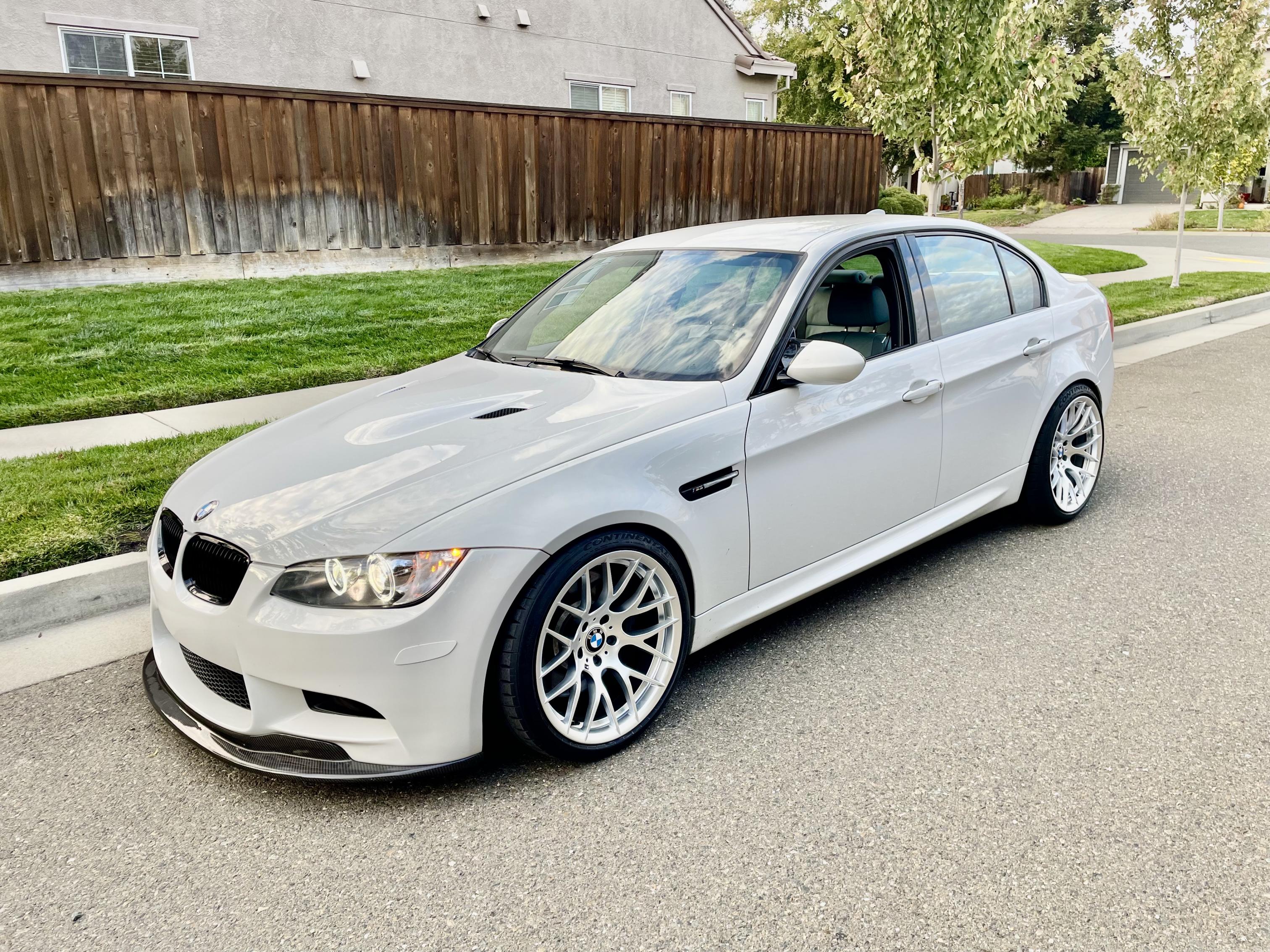

Im running 19x10 +25 w/ 12mm spacer up front and 19x11 +25 w/5mm spacer rear lowered on Ohlins running -3 degrees of camber front and -1.8 rear. The tire setup is 275/30/19 front and 295/30/19 rear. Slight rub on the front at full lock. No rub in the rear unless im 4 passengers deep.

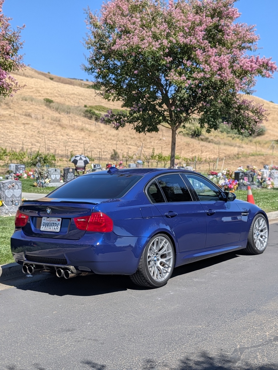

I'm on 18s but with pretty aggressive fitment.
First pic is 18x10.5 +22 w/ 10mm spacers front and rear with -3° up front and -1.8ish degrees rear on Fortune Auto 510s
Second pic was 18x10.5 +22 no spacers on edc with swift spec r springs.
Very clean! ijust picked up a set of Ohlins with camber plates. What lip is on your car?
I like the meaty look.

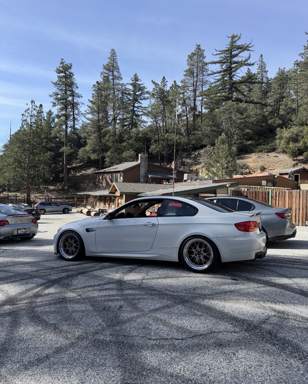

I am running BBS LM-Rs in 19x9.5 +13 and 19x11+19 with no spacers.
Tires are continental ecs02s 275/30/19 and 295/30/19. I only have a slight rub on full compression in the rear.
-3.2 camber front and -2.5 camber rear

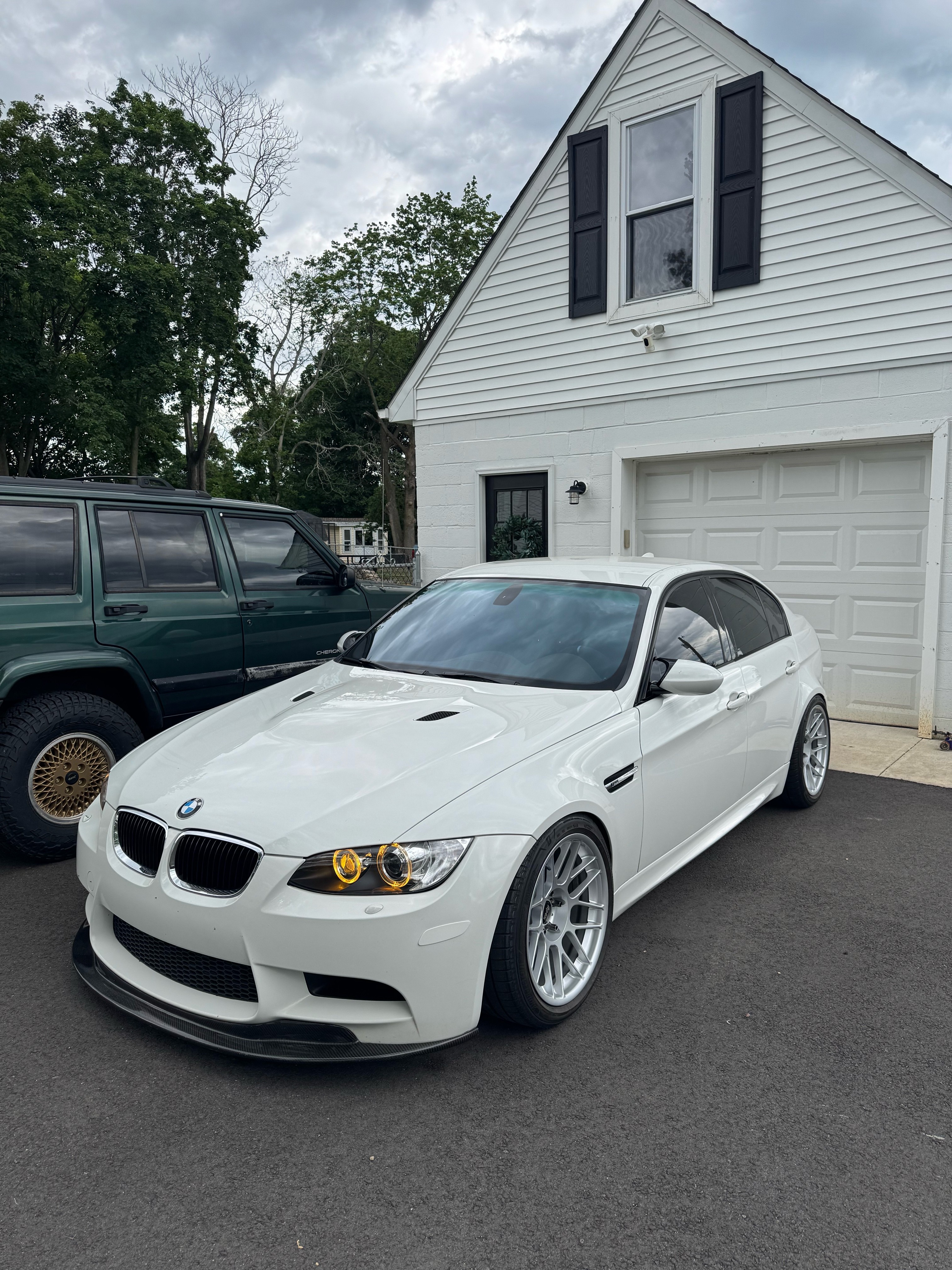

That looks very good. No rubbing in the front at full lock?

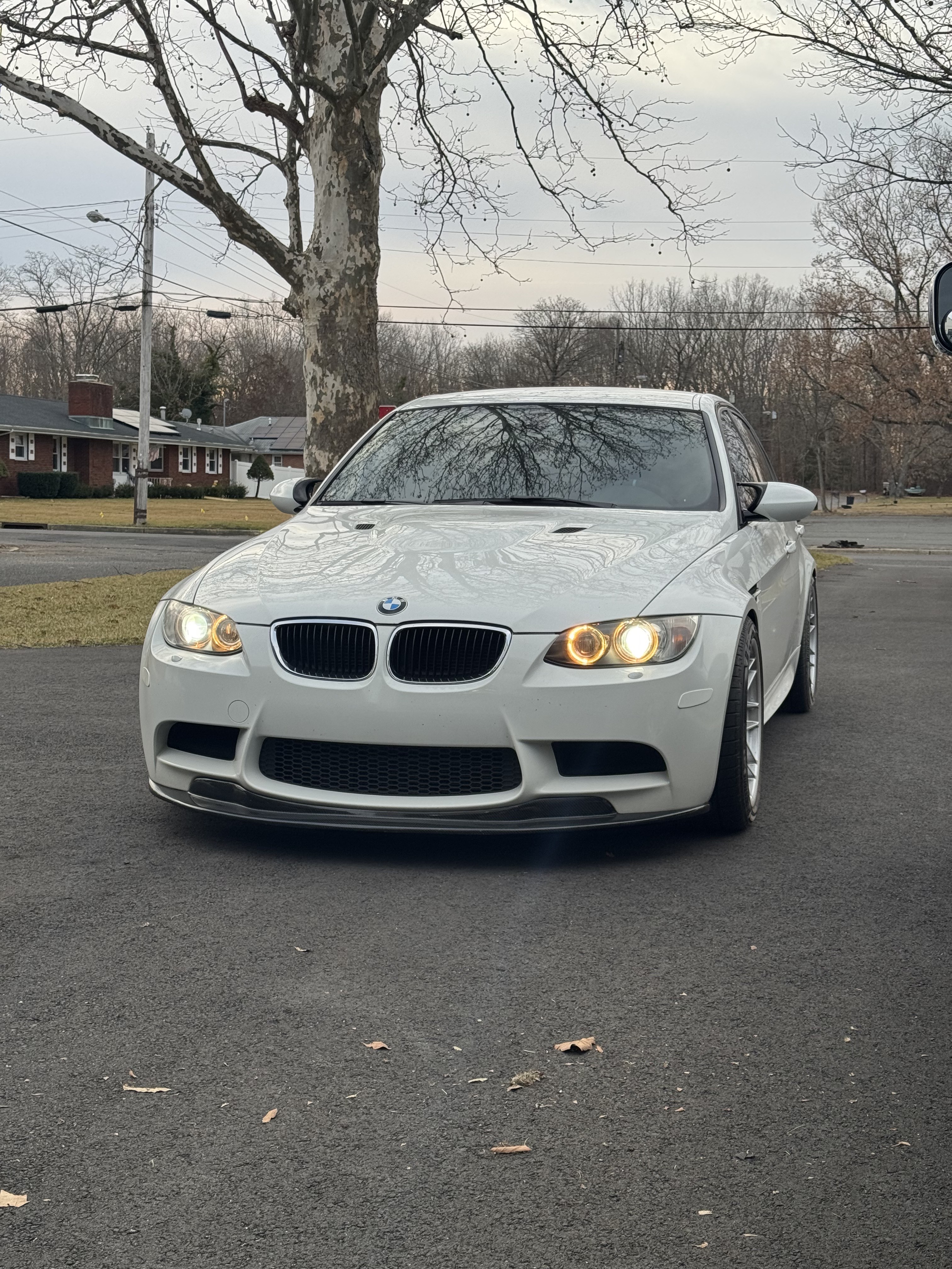

Theres a slight rub on the rear side fender liner at full lock in parking lots, but thats pretty standard with wider tires.
Thanks
Thanks! Pom Performance GTS1 front lip
